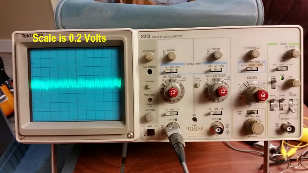

                I am having a similar problem with my Samsung LN40A500T1F TV. While it doesn't overheat, it will go through several reboots before it finally turns on. Once it finally comes on it seems to work fine. I replaced all the large electrolytic caps in the 5.1 VDC and 13VDC circuits. Attached is the schematic for the power supply board (BN4400199a) Also attached is a screenshot where I've highlighted all the caps I replaced.
                The 13 Volt supply will start at 14.1 VDC, then dip to 12.4 VDC and go back up to 14.1 VDC during the reboots, and will settle around 12.42 volts when the TV finally turns on.
                The 5.1 volt supply is at 5.07 VDC but seems to have a lot of noise riding on it. Attached are 2 photos from my scope: the first with it plugged in but powered off, the second with it powered on.
                So, my questions are: could this noise be causing my problem? If so, any suggestions on what else I should replace? If not, what else could be causing the multiple reboots?
                  Re: Samsung LN40B550 turning off after 5 min.
                  Try solder in 100uf 16V LOW ESR in parallel with C102.
                  https://www.badcaps.net/forum/showth...208#post525208
                  https://www.badcaps.net/forum/showpo...&postcount=129

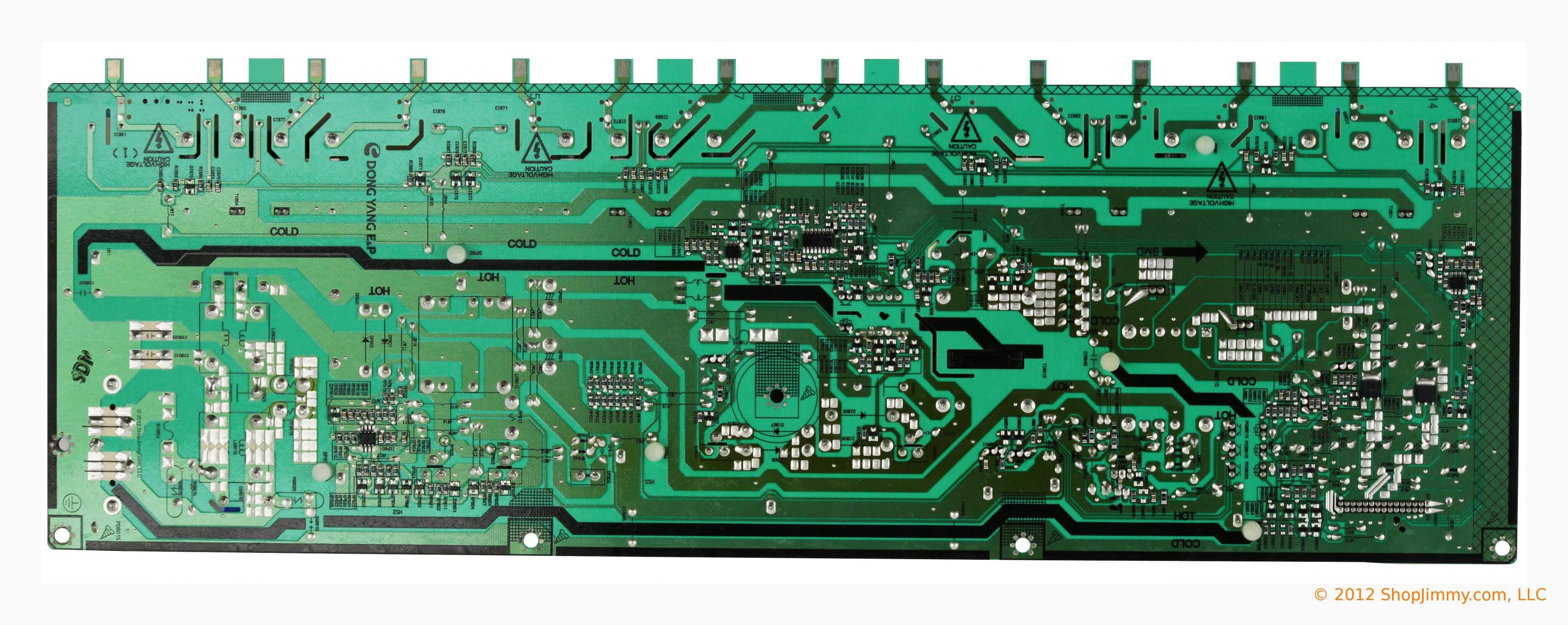

                              LN40B500P3F Question
                              Hi there, I don't know if this belongs here or in new thread.. I have a Samsung TV LN40B500P3F, and it doesn't turn on. Has power and Red LED blinks 5 times when hitting the power button.
                              Standby and all voltages I checked on board, seem to be within tolerance.
                              I tried disconnecting the T-CON board, and not luck. The same blinking ritual.
                              One of the inverter transformers has a "hot" spot on the outside. Secondary voltage are slightly higher than the rest of the transformers. The puzzling part is the "Blue Transformer" on the BN44-00264B power board. The lowest secondary windings seem to be open. I've seen others with the same reporting. Can anyone verify that you have about 1.2 k Ohm across each of the secondaries of that transformer? I can buy one and replace what I have, I'm just curious if it's worth the effort.
                              Any suggestions / ideas on where to go next with the troubleshooting?
                              I can't find the schematic for the BN44-00264B (I found the A suffix and I'm assuming they're similar? any one knows for sure?)

                                We need the pictures of the whole backside of the TV so we can see how all the boards are connected together and pictures of the suspect transformer.
                                  BTW, the blue inverter tranasformer only has ONE high Voltage windings, the other inverter transformers have TWO high Voltage winding.
                                  This is the board you have, right? Pictures provided by shopjimmy.
                                  'Standby and all voltages I checked on board, seem to be within tolerance.': And did you check all the command signals for the main board feeding to the power supply-inverter board, they are all OK? We need to see the readings.
                                  BTW: 'Secondary voltage are slightly higher than the rest of the transformers.' How did you manage to read the High Voltage of over 1000VAC on your meter?

                                    budm, thanks for the reply. I'll get the photos, but it's identical to the photos you kindly provided. I'll take more of the whole TV.
                                    I didn't measure the 1000V rather when the TV backlight is off, I measured the AC voltage out of the secondary of all transformers.. it was not 0V, rather, 2.3 VAC except the suspect transformer.. it was 2.5 VAC
                                    No, I have not measured any of the command signals. I was just able to read the part number of the main PCF controller, to be BD9893F I believe. Though I have the datasheet, it doesn't say a lot about the function of the pins. Not in details I am familiar with at least. Anything in particular you'd like me to measure?
                                      You can verify if the PFC Voltage booster circuit is working or not by measuring the DCV between the two legs of the main filter cap on the primary side, it should be close to 400VDC when TV is turned on.
                                      If you do have the boosted Voltage then you know the PS-ON is present.
                                        Sure, the voltage on the large caps is 392V when on
