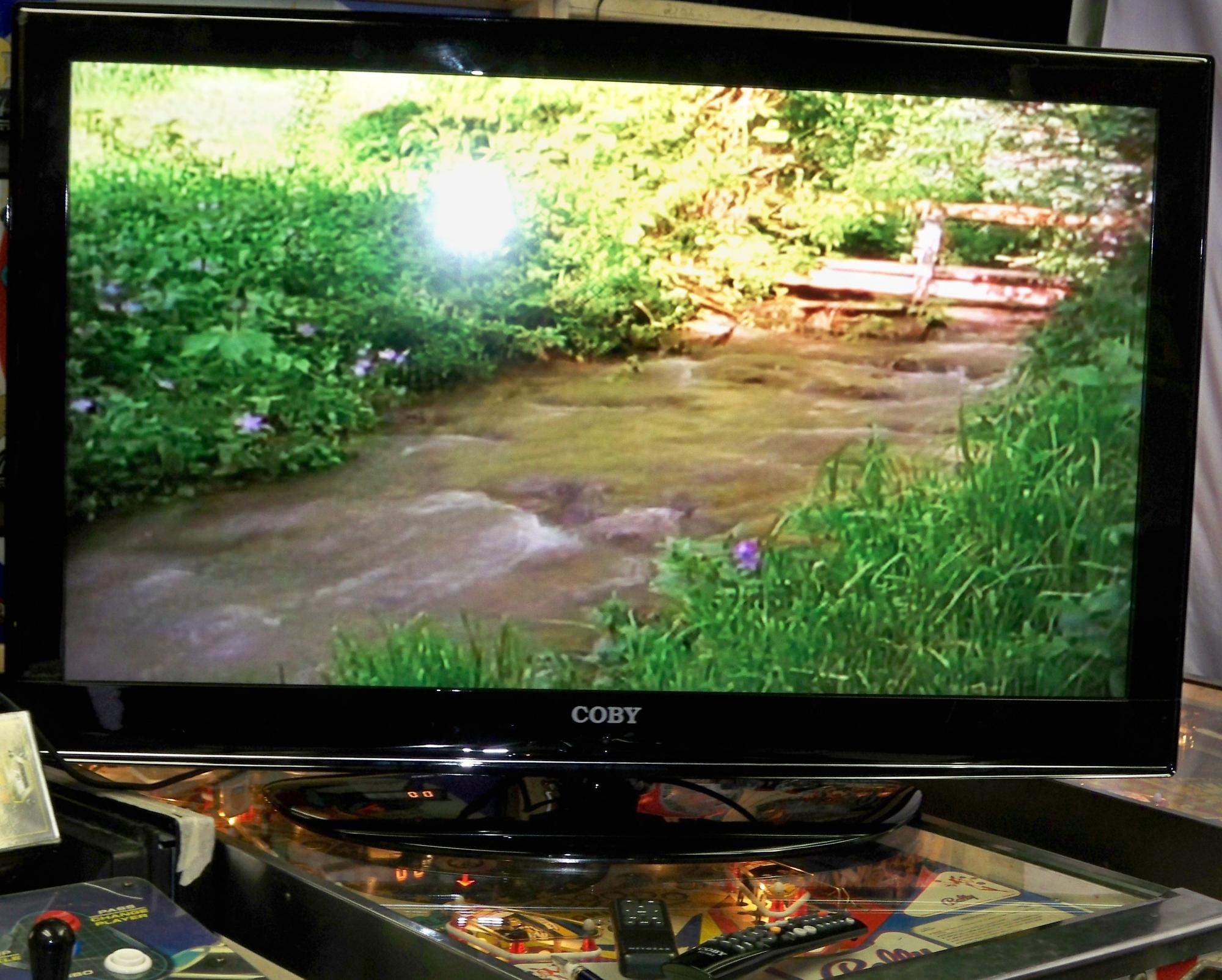

    Re: coby 40" lcd TFT V4028 no sound
    yeah baby!!! Its alive and working 100%.

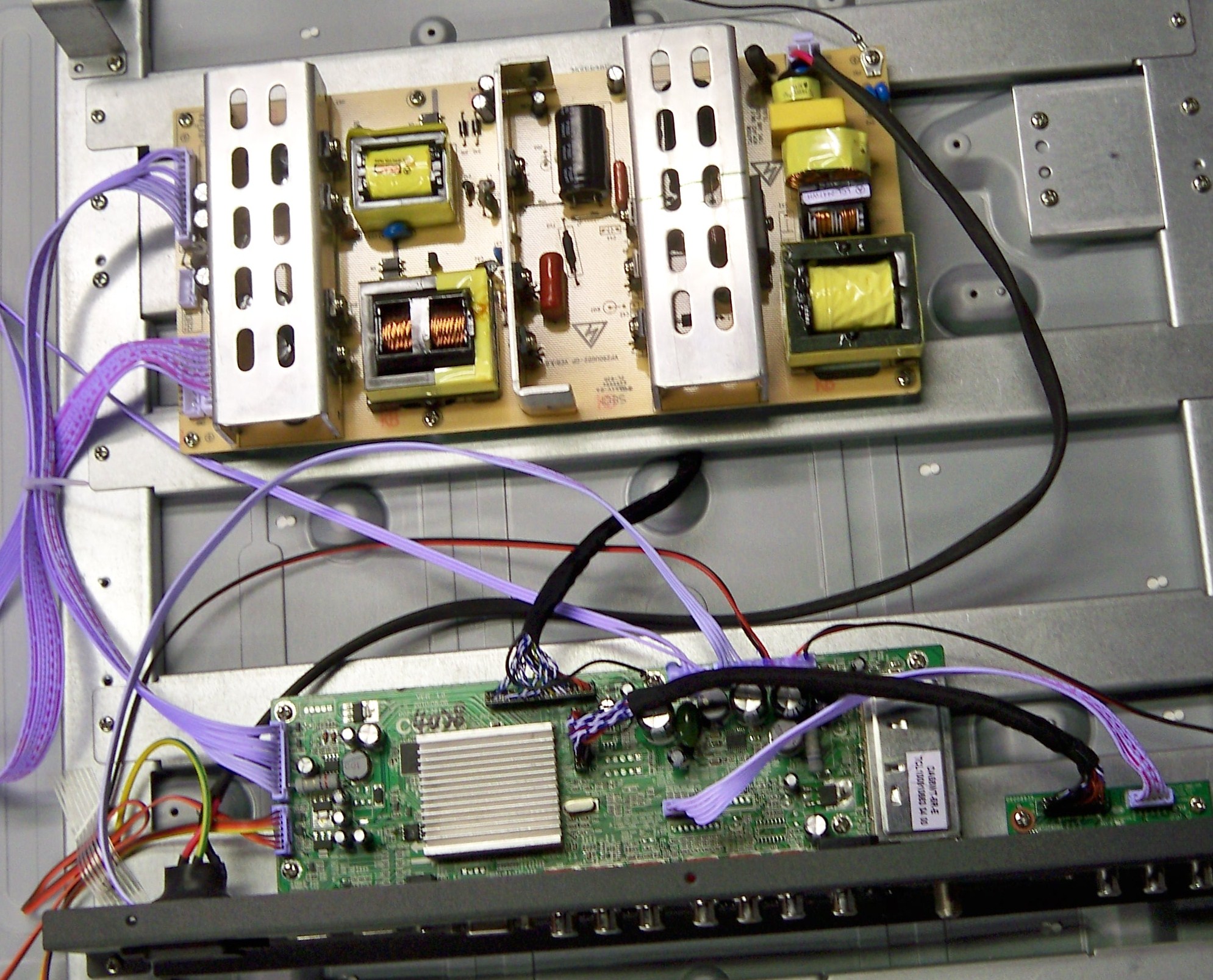

    I tore it down, caps are capxon( yeah i know) but none are even slightly bulged. As stated earlier this tv has only been used for approx 6 mos.
    Solder on ps wasnt too bad. I touched up a few questionable joints but did not find one bad screaming obious joint. I found that when whoever had this thing apart, they left the power cable off of the power supply. I straightned the bent header pins, reconnected, reassembled the set and voila. I like fixes like this. Nice and simple. My investment? $30.

                  Led light is on bright.(when working propetly this led is dim when set is in standby) no response. except now it stays broken.
                  5v ok at 5.05. 12v sucks 11.2v no ripple on either 12v or 5v lines found. caps still visual check ok but they are capxon so anything is possible.
                  If i unplug the connector off of the ps with the 12v terminals, and reconnect, the 12v will jump to 11.5, the led will go from bright to dim(standby) set will turn on and off like it should with onboard controls or remote, all is happy untill the set is unplugged. then the 12v goes back to 11.2 and the set will again have a bright blue led and no response.
                  SO my question to you guys that know way more than i do, will this low 12v be possibly causing the set from "booting up" and preventing standby when plugged in?
                  this set has a mainboard thats also av inputs video out and speaker amp in one unit. Im wondering if the board is seeing the 12 too low and stopping ther set from booting up sort of speak.
                  i believe im going to roll the dice and recap the whole damn ps, at least the 12v sections.

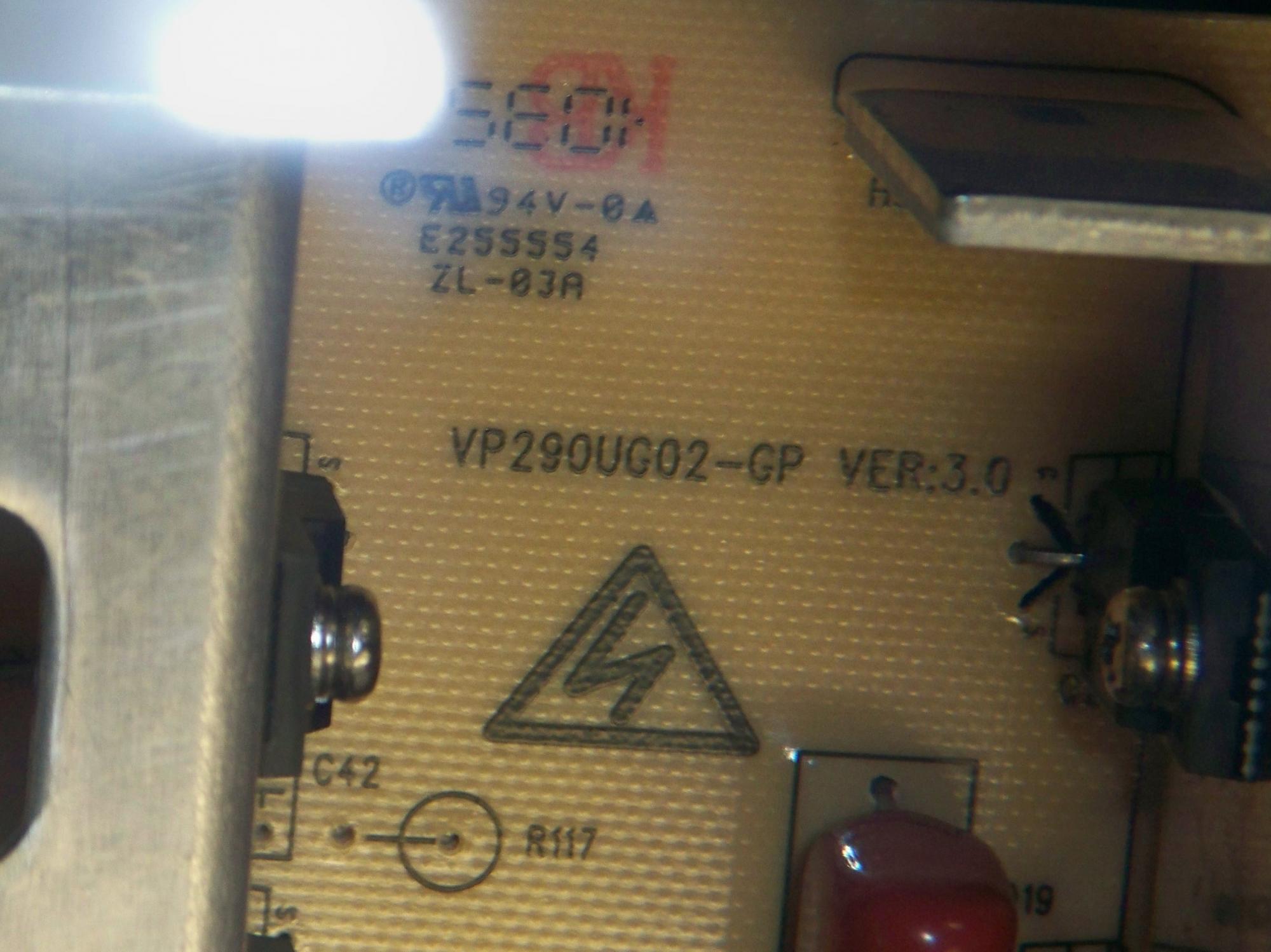

                  ***NEW DEVELOPMENTS..
                  sharing a trace with the 12v pins is r122. It is marked orange, orange, brown, gold. that should be 33.1 ohms correct? because im reading like 325 ohms.
                    Do you have a tattoo artist near you? Perhaps you should have one tattoo the resistor the color code on your arm. The first two bands are the significant figures, the third is the multiplier, the fourth is the tolerance. So that resistor is 330 ohms, 5%.

                      D'OH!! well i guess the hunt will continue.
                      I have a resistor color chart pulled from google but obiously i read it wrong or it lied to me.
                      because it was coming up as 331 x 0.1

                            Whew, it's worse than I thought!!! If a resistor has four color bands, it is 1st digit, 2nd digit, multiplier, tolerance. If it had 5 bands, you would have been correct.

                                Well anything to do witht he 12v was recapped. same..
                                heres what ive noticed. No matter what working or not powered on or not my ps on is 4.3v
                                with the tv on and working i have 11.2 v on my 12 line( i think new caps made it worse lol). WIth the tv working and switched off, i have 0vdc on the 12v line.
                                My 24v also switches has voltage on and none off...
                                Now if i unplug the tv and reconnect to "break" the set, somehow i have 11.2v on thr 12v line and 24v on the 24v line with the set off/not working
                                so its getting more interesting. Im having a hard time where to go from here. I dont know how to track down wether the ps is the issue (12v running when it shouldnt) or if the mobo is the issue, 12 is just not high enough,(perhaps its supposed to come up for a second then shutdown when plugged in as a test- voltage too low, tv sits locked up) or what i just dunno man.
                                      I'm trying to get my mind around this. For some reason the control that turns the main supply on / off is not working. That MUST be a power supply problem. But I can't figure out how that would affect the sound. Or has that been fixed?

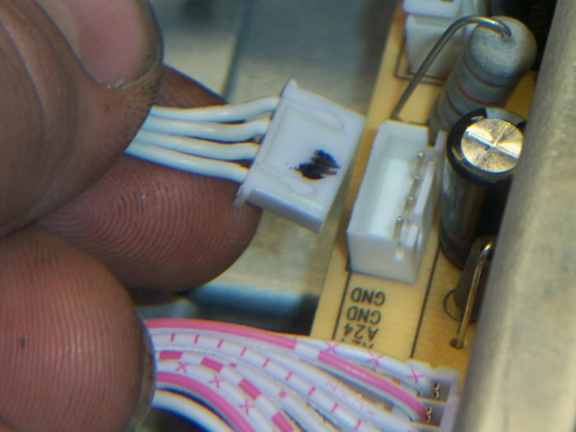

                                        The sound is fine. There was a connector unplugged from the power supply marked a24 or something like that.... apparently the audio runs on 24v because thats what it meters out at and thats the connector that was off..
                                        Im having a hard time wrapping my mind around how the power supply "knows" when to turn the 12 and 24v on and off. frickin weired.
                                        i will take and post some better pics of the power supply and connector designations...
