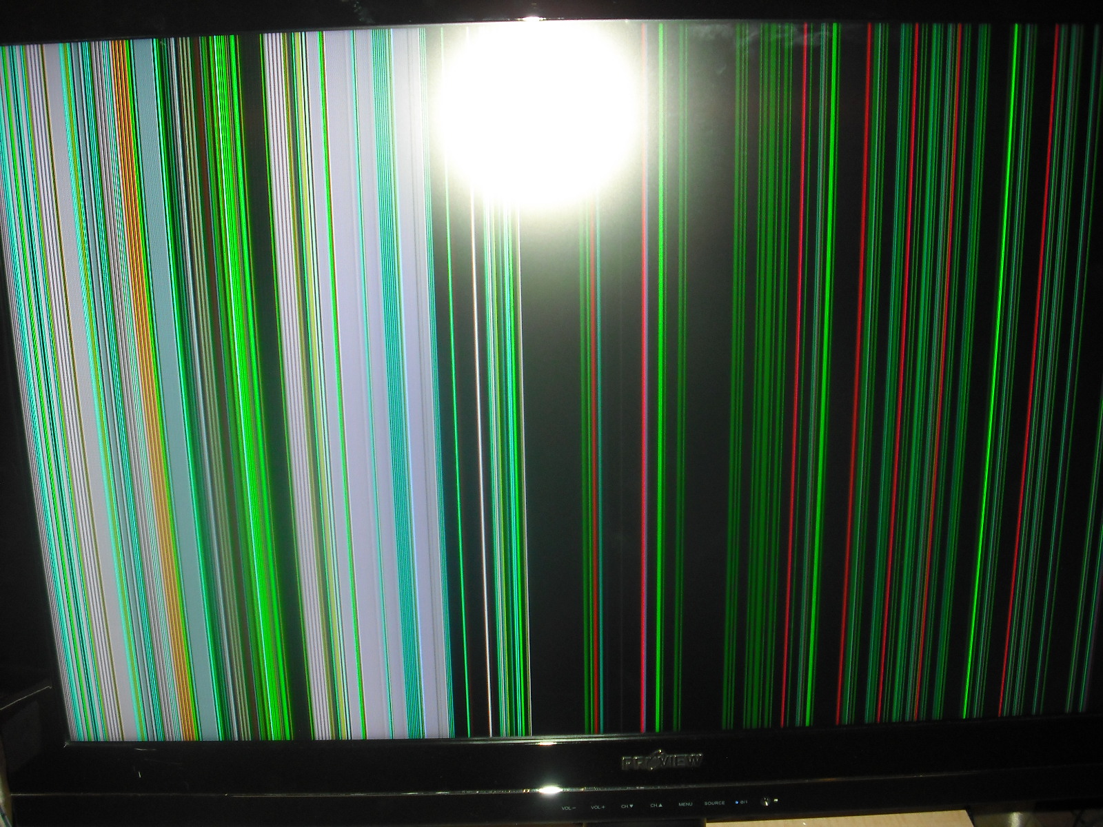

    Proview loud humming/buzzing sound
    I was just given a Proview PA-40JK1A 40" LCD TV. The giver didn't know how to fix it: The problem is....when I turn it on I get a menu picture telling me to scan for channels, but after about 2 minutes it starts making a loud humming and buzzing sound that lasts a few seconds then goes away and comes back again repeatedly. I never made it past the channel scan to see if I actually get a TV picture, but I noticed the center of the menu screen going all pixelated in multiple colors and lines. I don't believe the sound is coming from speakers as turning down the volume does nothing. Any ideas?

      Re: Proview loud humming/buzzing sound
      Now i'm getting vertical lines going through the whole screen!
        That means the problem is getting worse.
                      I checked all the solder points with a magnifiying glass and couldn't find anything suspect, I disconnected the 2 ribbon cables from the Tcon board and reconnected them and the tv worked again....for one day! Back to vertical lines again! here's a rundown of what's happening:
                      1. TV comes on with picture...seconds later the on-screen volume goes all
                      the up to max on its own.
                      2. The menu pops up and cycles all the way through all the settings like it's trying to do a self diagnostic or something.
                      3. Goes back to on-screen volume and then horizontal multi-colored bands across the top of screen - then spreads through the center.
                      4. TV stops responding to remote control and the touchpad panel on the face of the tv won't work....actually not sure it ever has since ive owned it.
                      5. Picture reverts back to multicolored vertical lines but still gets sound through the receiver - but if the detachable tv speakers were reconnected to the tv they would make a loud humming/buzzing sound.
                      6. Tried unplugging tv and plugging back in and sometimes it works, most of the time not.
                      7. Sometimes unplugging and plugging back in gets me a blue screen and sometimes no picture at all (black screen)
                      I'm at a loss here! Ive heard somewhere about a bad surface mount fuse on the Tcon board? Can anyone confirm this?

                                      • gorr35
                                        • Nov 2010
                                        • 127

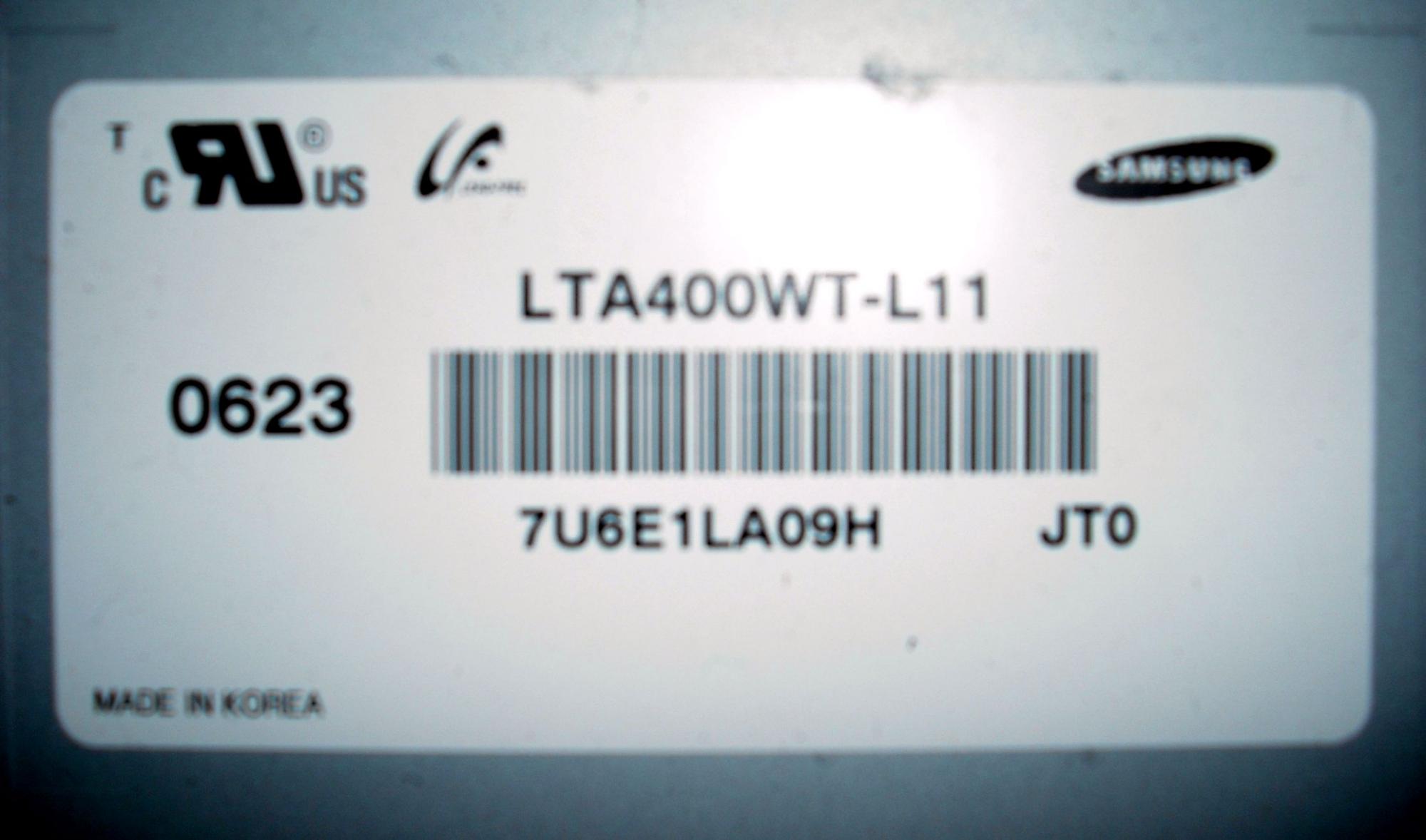

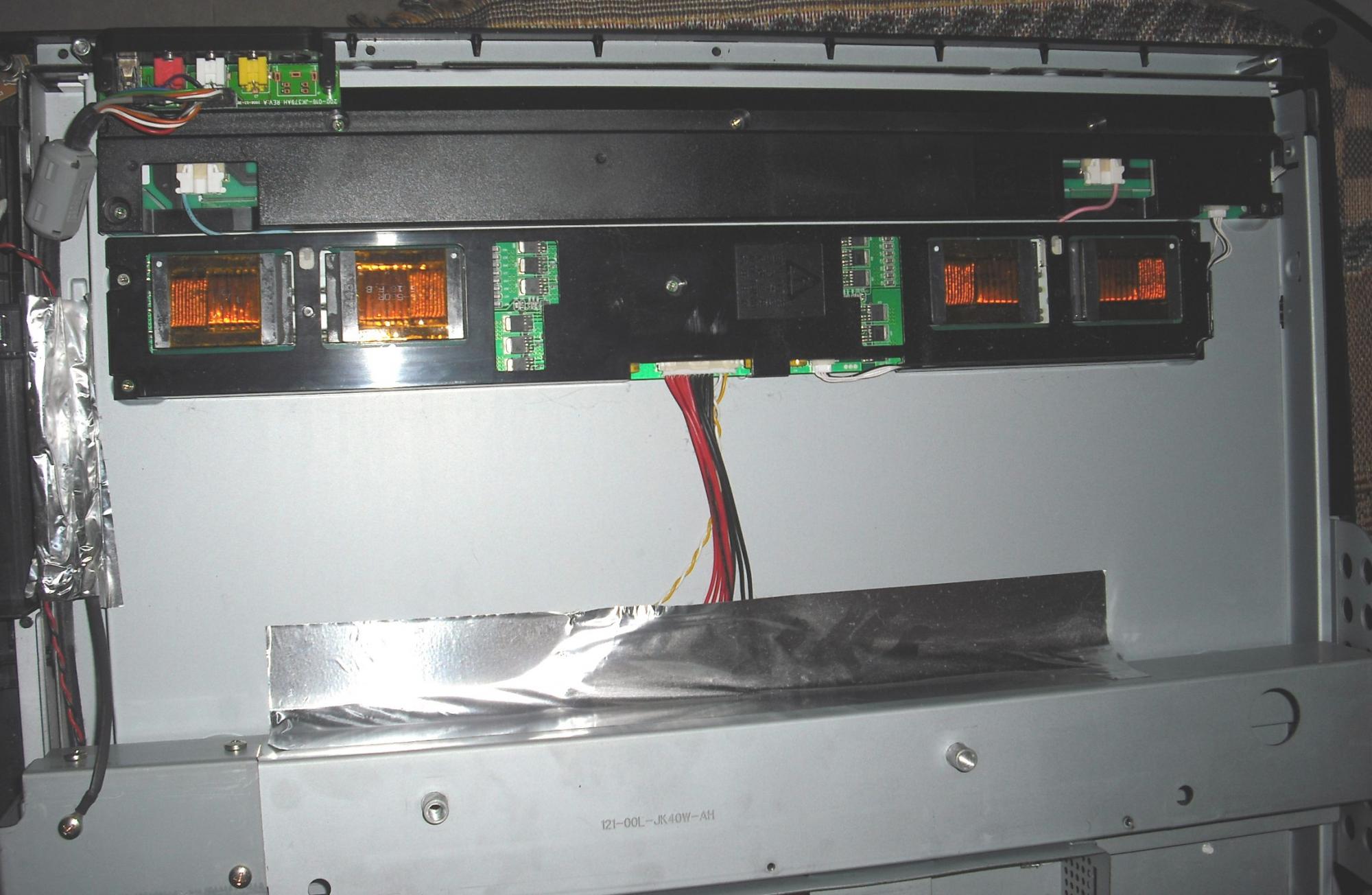

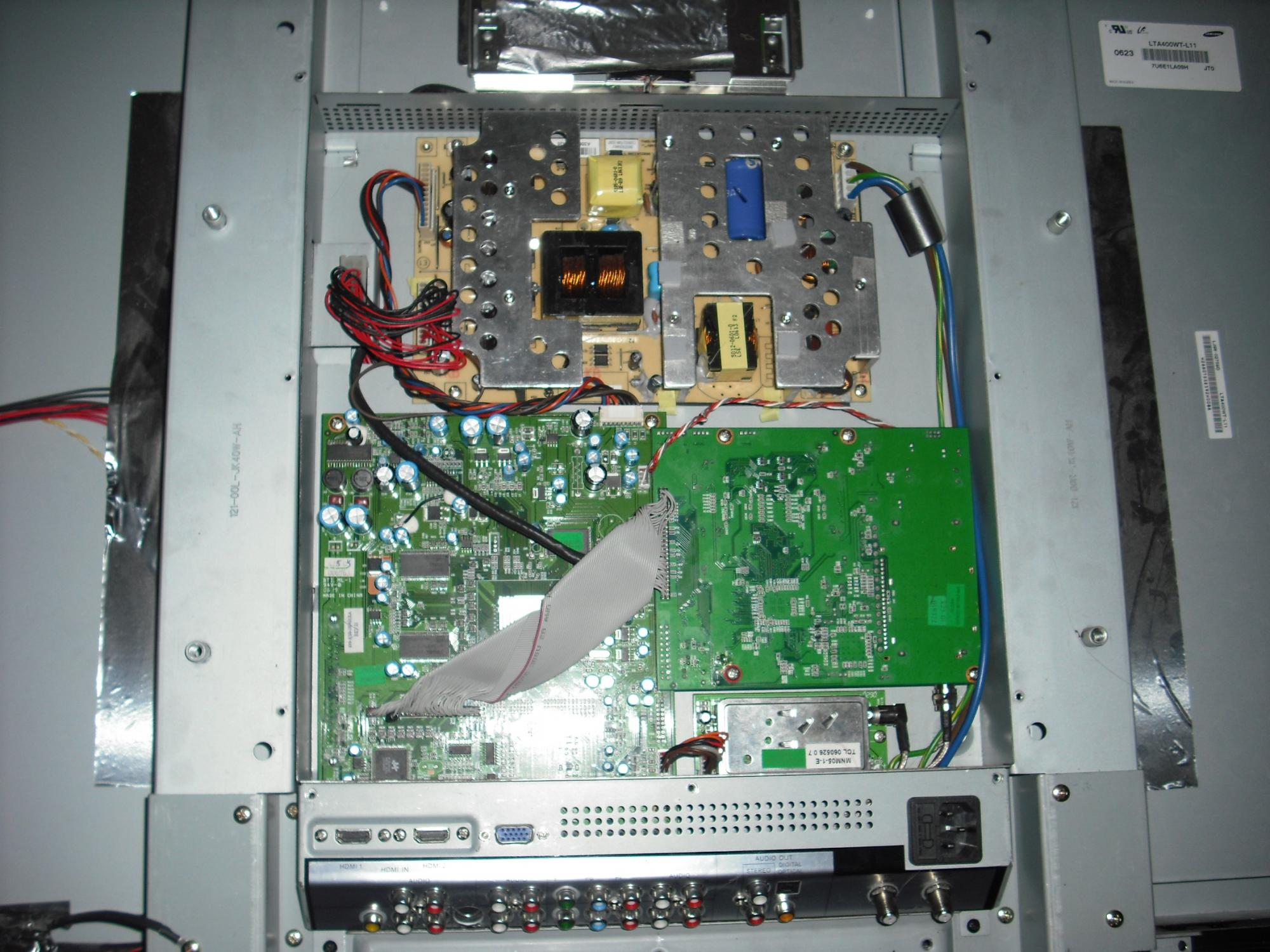

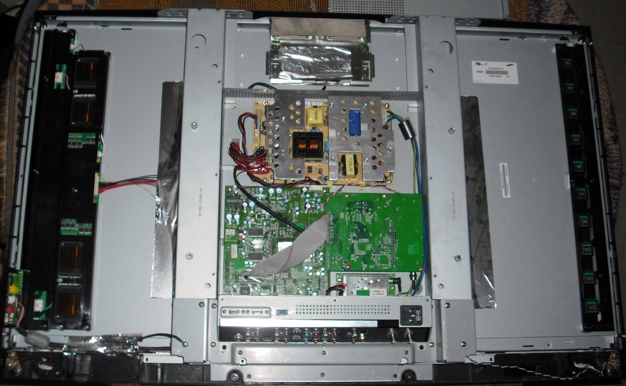

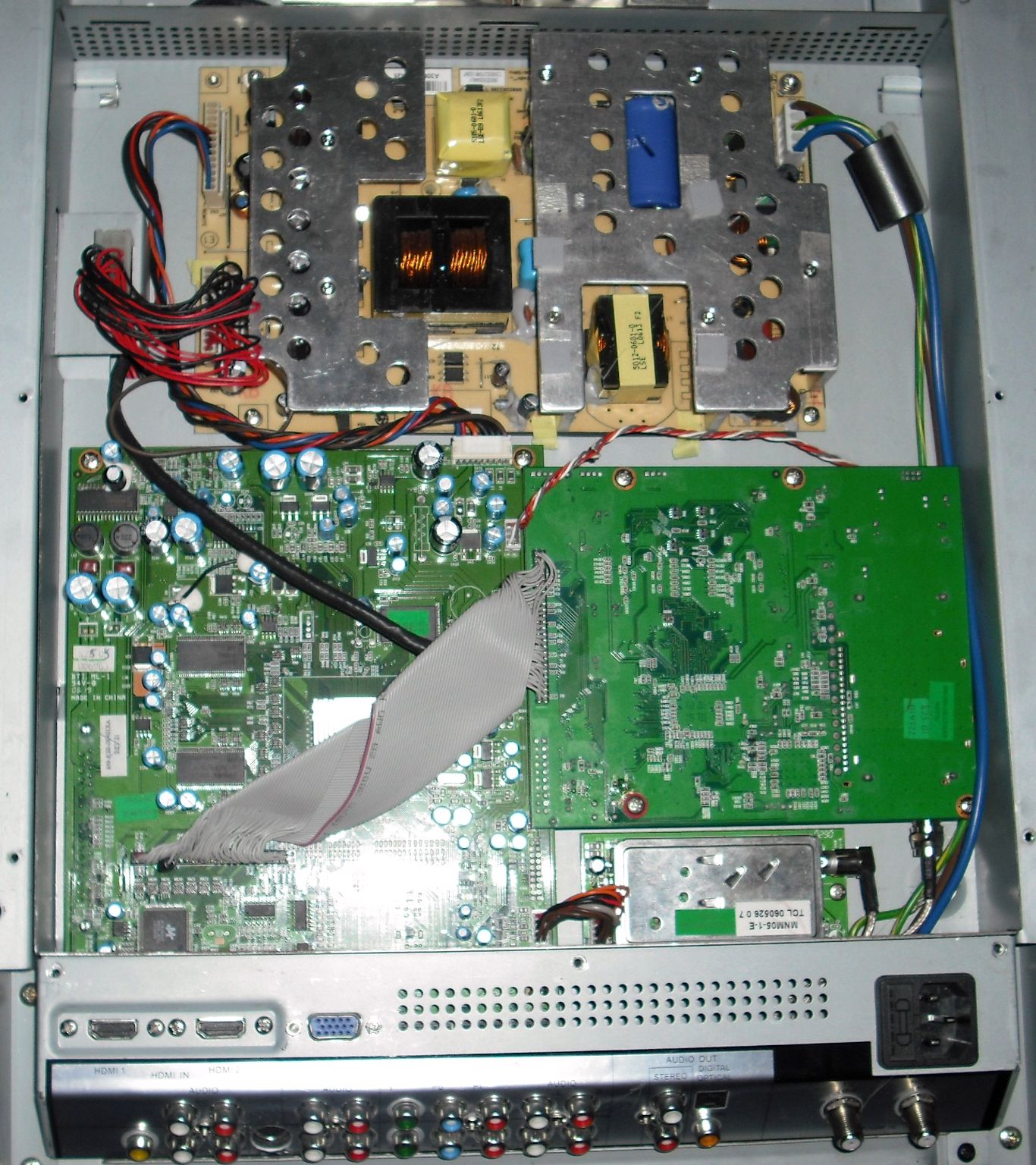

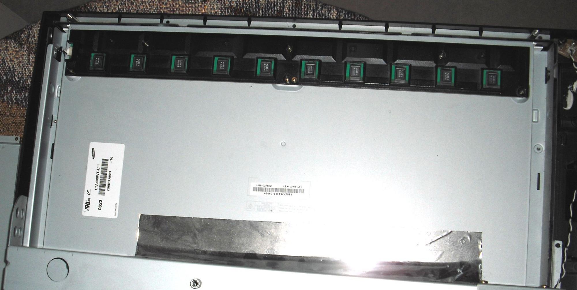

                                        I know you all like pictures so here goes.
