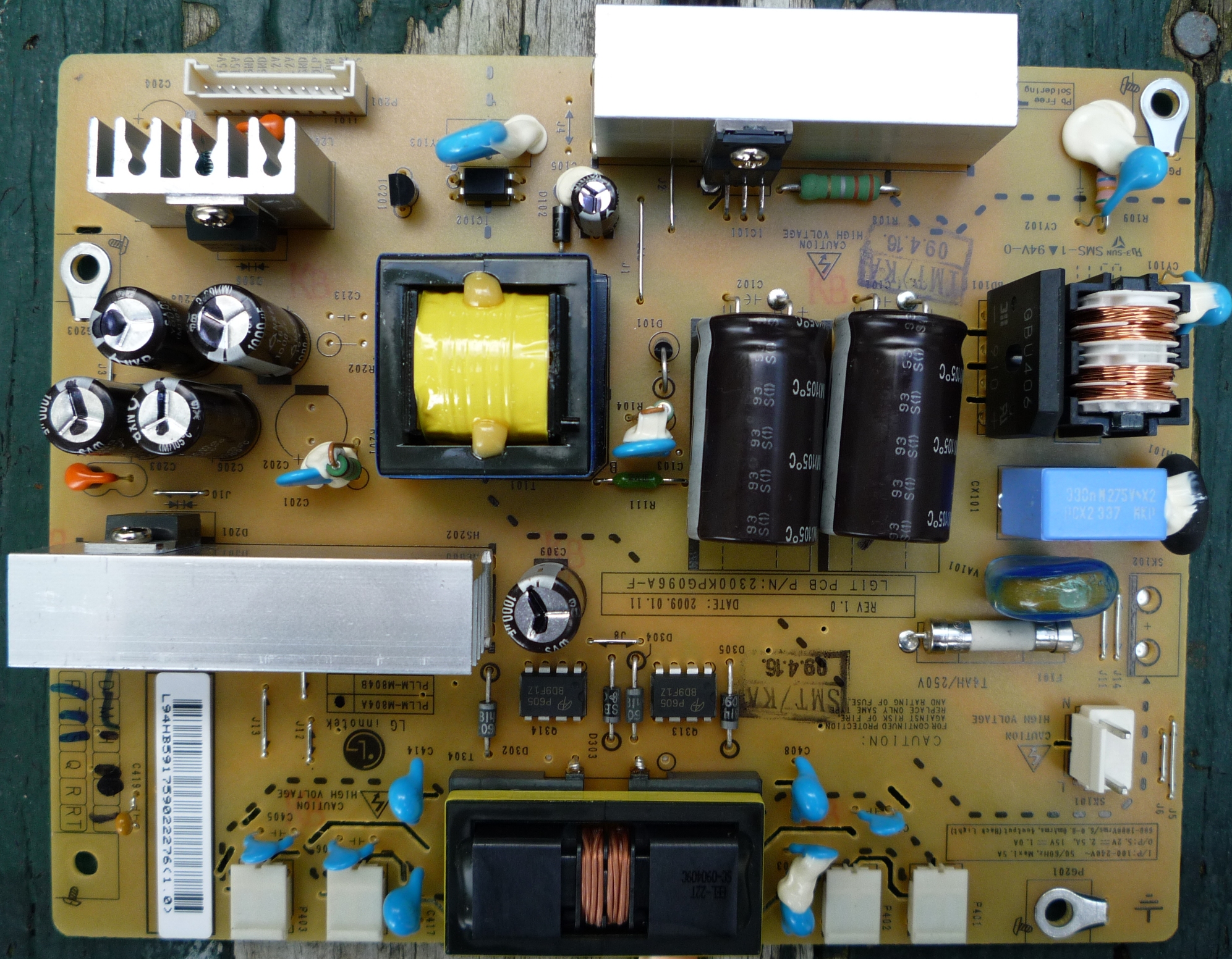

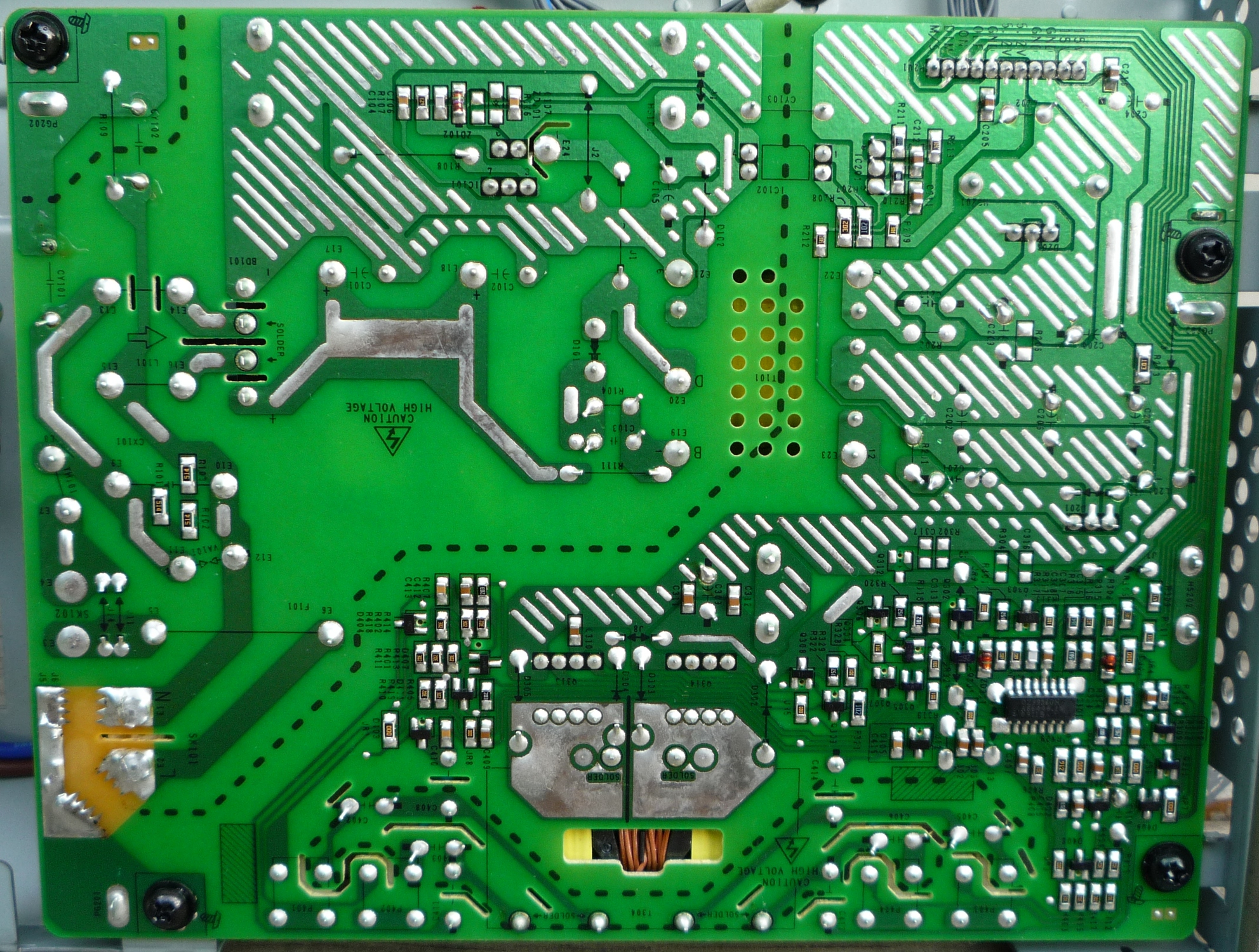

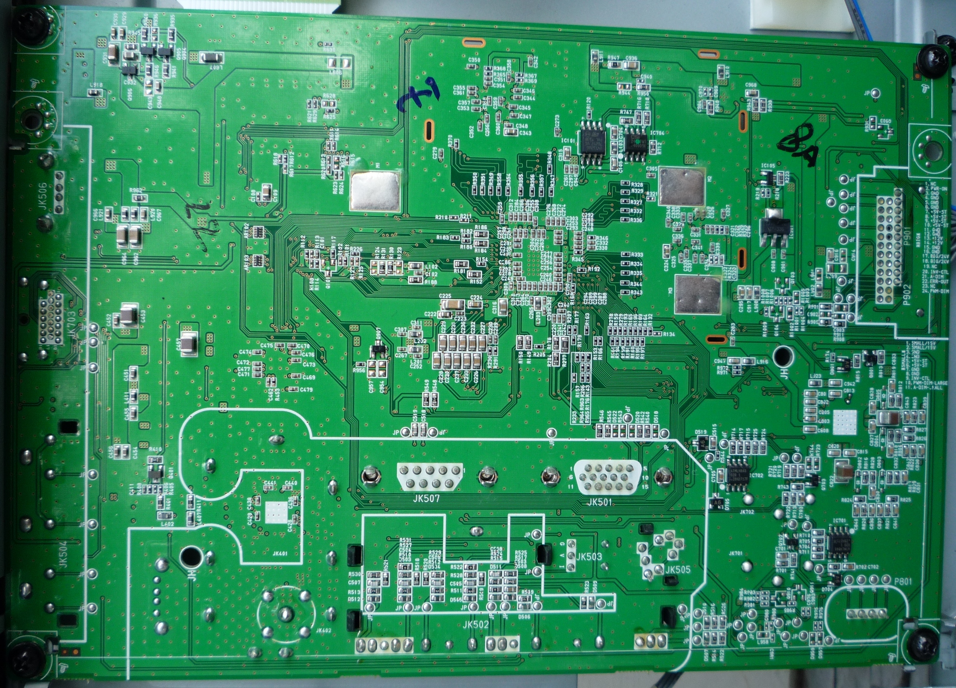

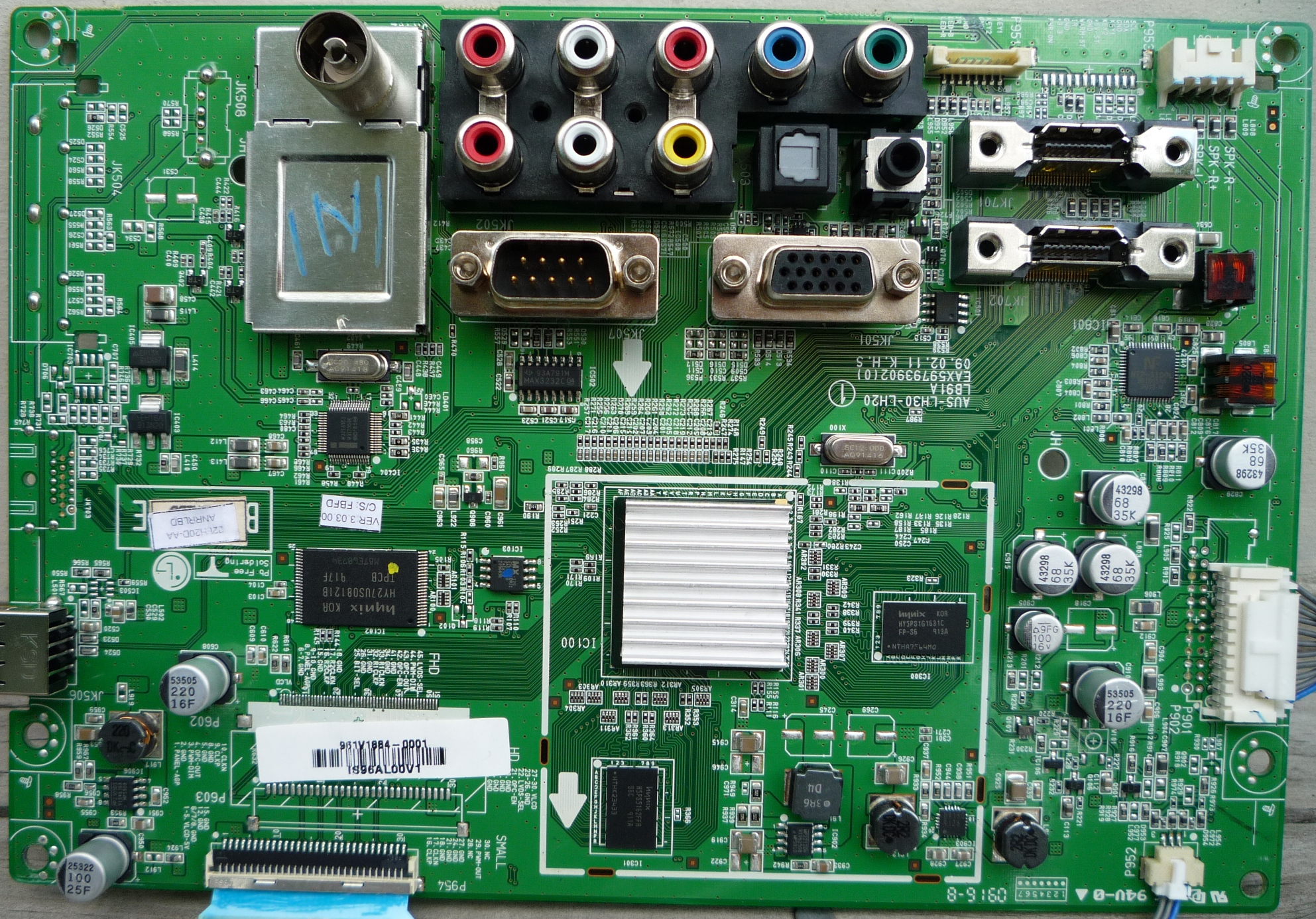

I have a LG 22LH20D LCD TV that wont power up.
I have disassembled and checked the power coming in. I get 230VAC at the power socket right through to the bridge rectifier. I have also checked the small connector that goes to the main board and have 16v at pin 1 and 2, 0v at 3 and 4, 5.2v at 5 and 6, 0v at 7 and 8, 0v at 9 and 10, 3.3v at 11.
I have also checked the power switch on top and get 3.3 v to the switch, 3.3v back untill the button is pressed the drops to 0v, so i am taking that i am getting a signal to the main board to turn on the power, but get no signal from the main board to the power board.
The blue power LED is on.
The symptoms coming up to the final fault were the TV would intermitently switch on and off, and then it switched of one last time and has never been able to switch back on since.
Please see photos for board layout.
Any help would be greatly appreciated as i have three of these TVs, 2 are starting to do the turn off intermitently. So would like to fix these before they all go. They are all out of warranty.
