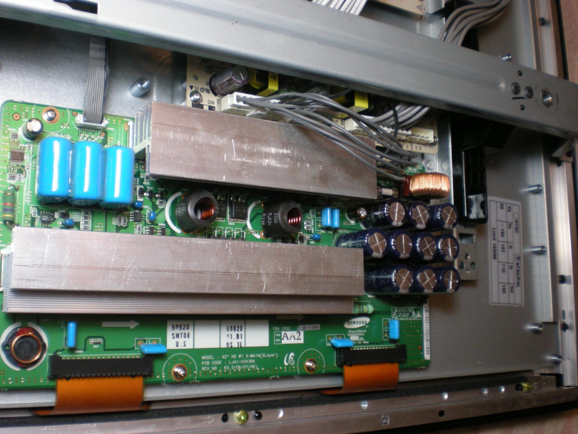

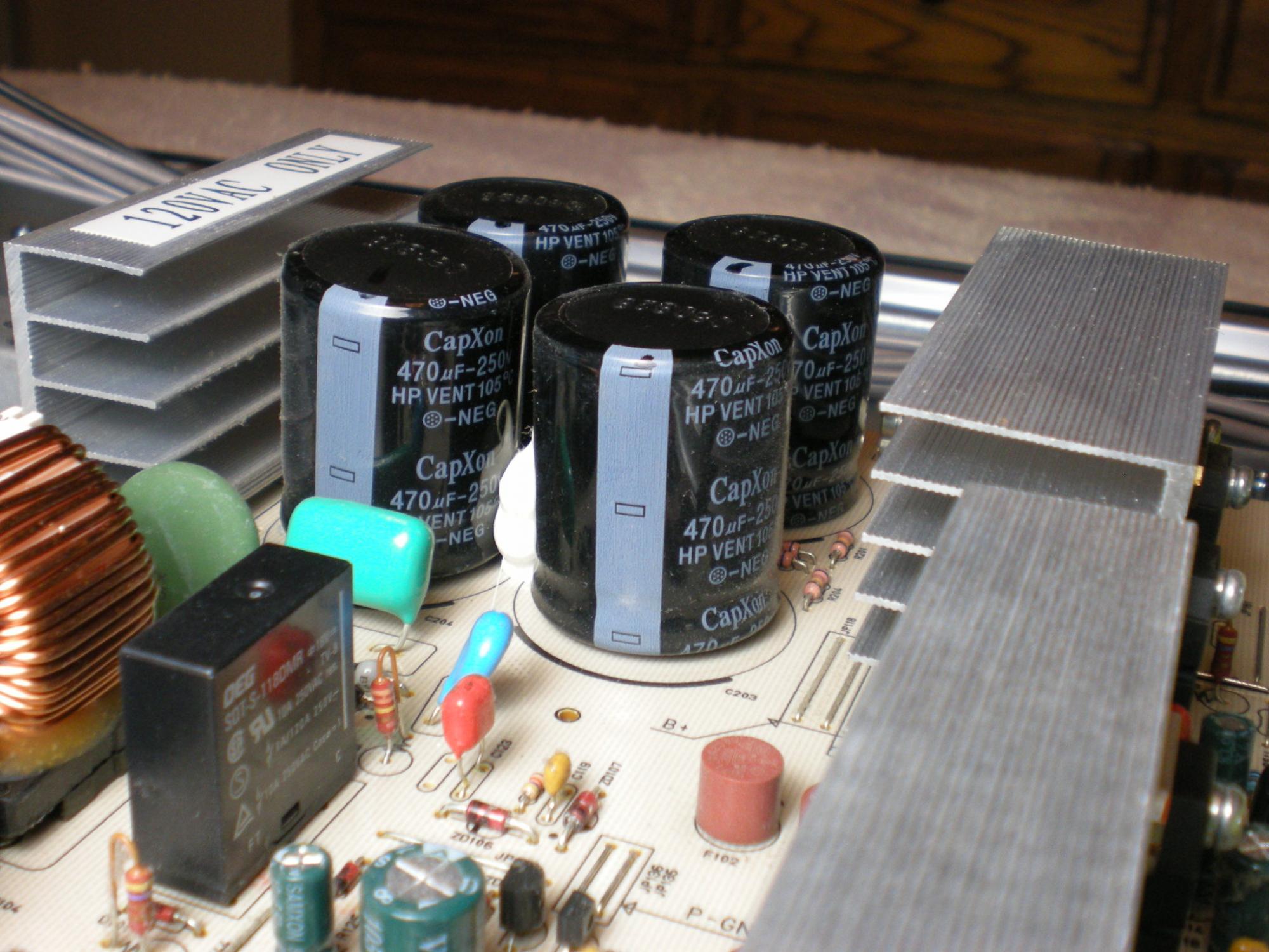

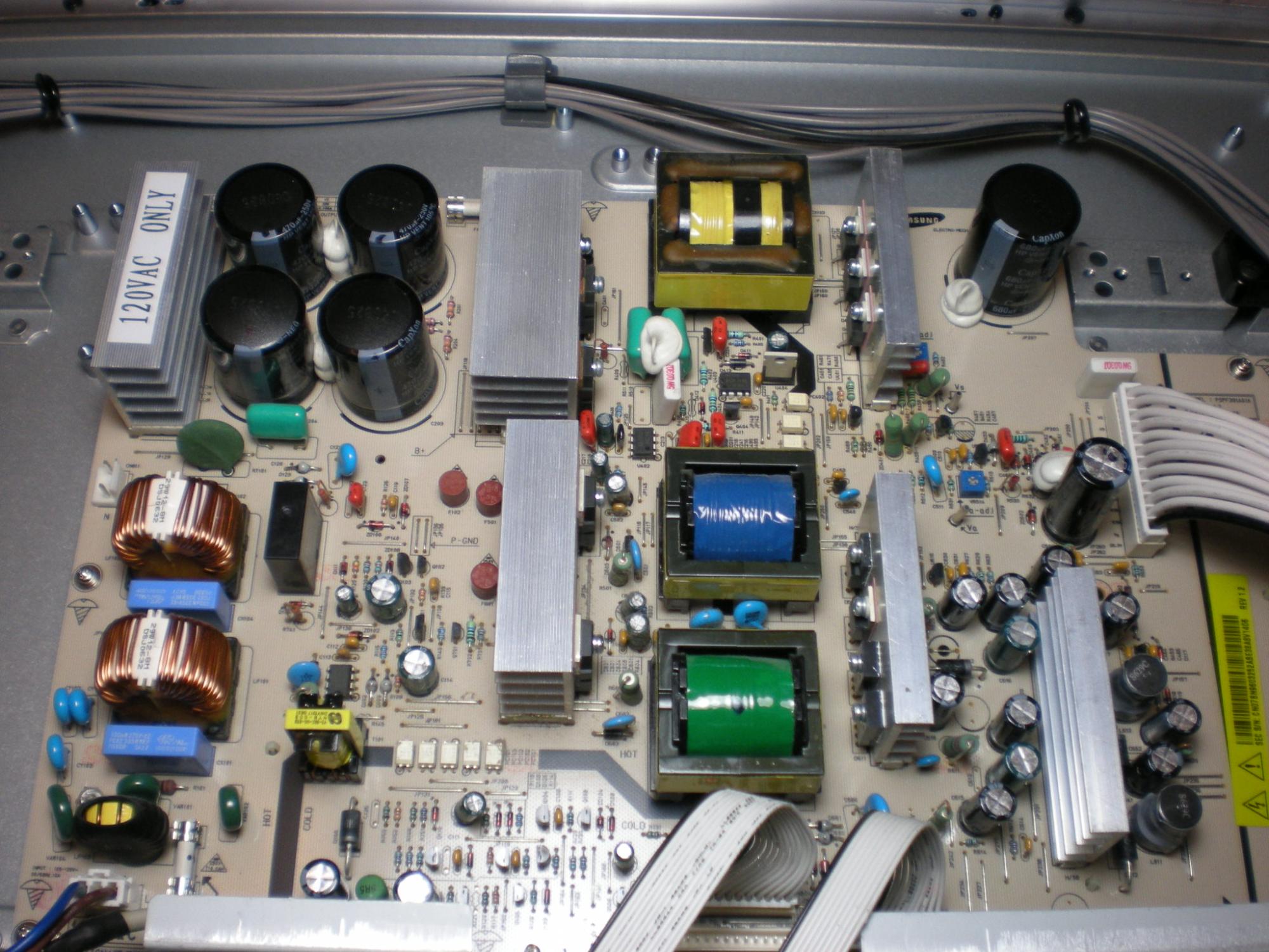

    Now that I've been successful on a few monitors, I thought I'd try to tackle something bigger. This plasma cuts to black after 2 seconds.
    The only things I see are:
    • 3 of the large black CapXon are very slightly bulged - all of the large caps are CapXon
    • The majority of the caps are SAMXON
    • Some are SAMWHA
    Should I plan on replacing all caps on the power supply or on all four boards?
    Any other suggestions before I start?

    Yeah, keep at least one hand in your pocket. These sets pack a serious punch.
    The bulges are a plastic disc on the top of the cap. Replace them only if the aluminum can beneath that disc is bulged.
    I wouldn't bother replacing ANY caps until you have a reason to suspect them.

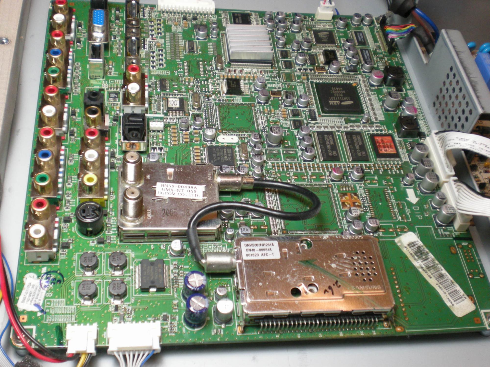

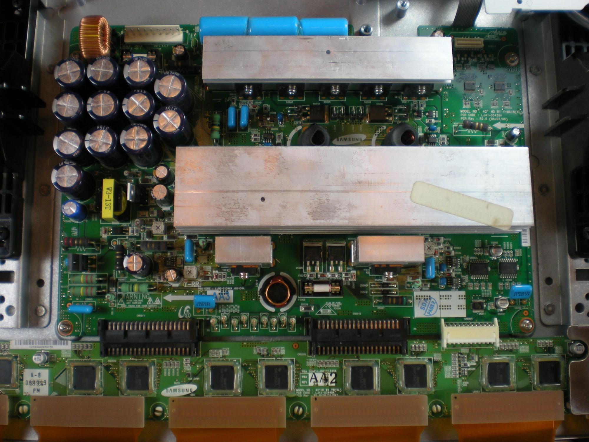

    The last picture shows the main control board. I believe two cables link it to the power supply. Usually the connectors on one or both boards are labeled with the voltages each pin carries. Check those voltages. Also, somewhere on the back of the plasma panel will be a white label indicating all of vital voltages for the panel. Verify those voltages are present.
    You didn't mention the failure details. Does the TV sound continue after the picture goes black? Is there a sound of a relay opening after the picture goes black?

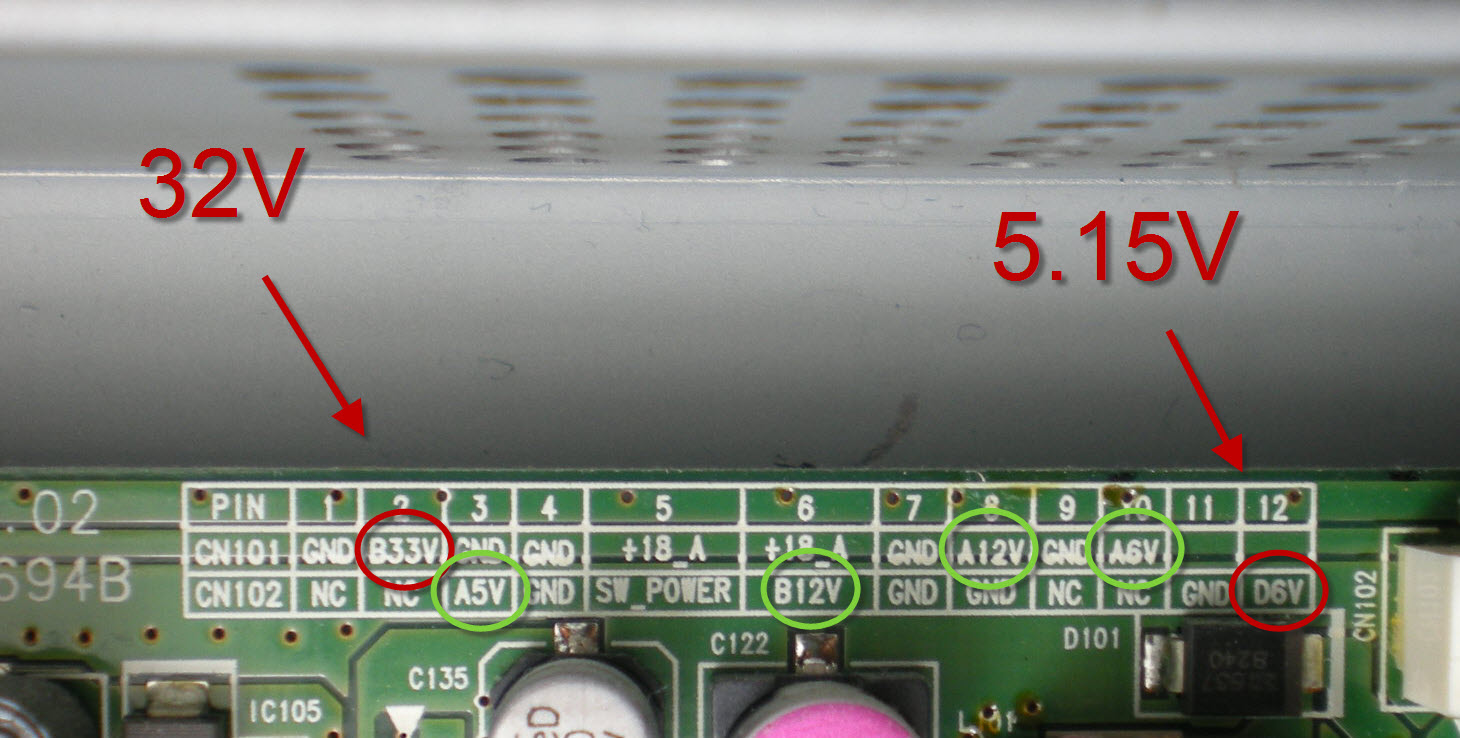

      Two of the large CapXon caps feel like there's a hard bulge under the plastic disk. Would it hurt to take the plastic disk off to see for sure?
      The two connectors test as the attached picture shows. The green circles were right at the listed values, the two red circles were slightly low, as indicated. I have a cheap multimeter (with a new battery), so they might mean nothing.

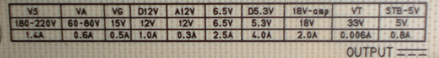

      I'm also attaching pictures of a label (I hope it's the one you meant) as well as some markings on the power supply that look to be similar info. I found test points (?) marked Va and Vs, but haven't found anything else yet that matches anything on the label. I tested those two. Va=65, Vs=2.

          All right!!! Now the question is - is the power supply bad, or is one of the sustain boards overloading the supply?
          Those voltages go to the sustain cards. The usual technique is to disconnect the power leads to one of the sustain cards (with power off!!!), then turn on the TV and check the voltages. Reconnect that card, disconnect the other, and repeat. If only one sustain card causes the problem, that card is at fault (probably the Y-Sustain). If the voltage is low with either card connected, it's the power supply.

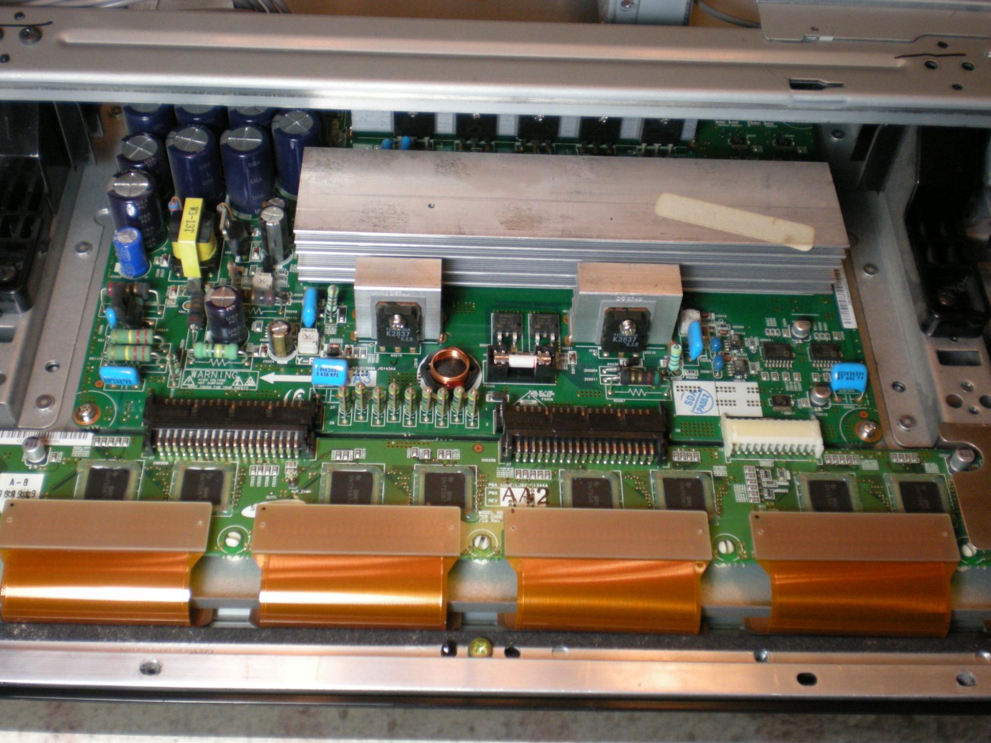

            Re: Samsung HP-S4253 - 2 Seconds to black
            Yep. The Y-Sustain board is the culprit.
            Need a better picture of it?
            • OneOfEm
              • Jan 2011
              • 31
              This is as good as it gets tonight.

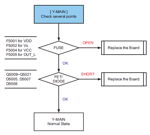

                OK... I found the attached as part of the Samsung service manual. (If it were a direct link, I'd post it, but it's on a file-sharing site.)
                I've checked the four fuses and they're all OK.
                I don't really know how to check for a short on the other parts, so I'm off to find a tutorial...

                  Q5020 and Q5021 don't exist on this board. I guess that manual covers a series of boards?

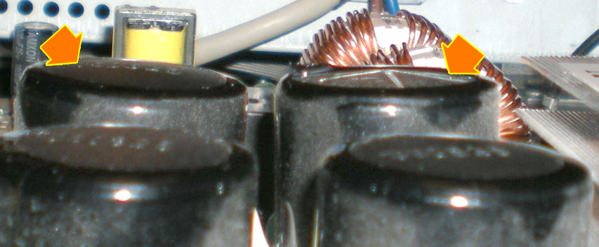

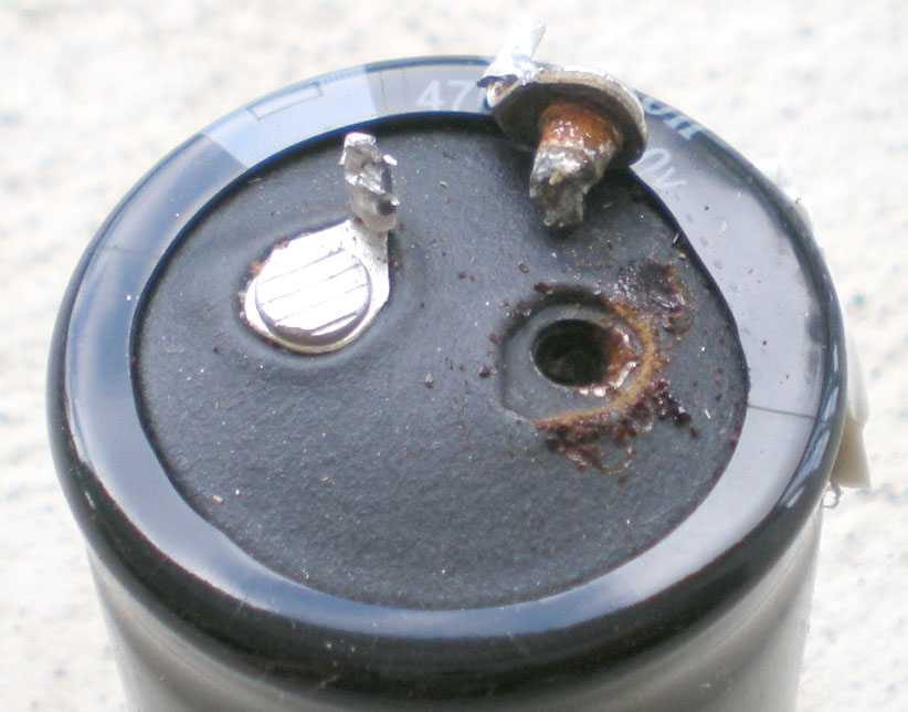

                            I should have also pried the plastic discs from the large capacitors that felt like they were bulging.
                            • OneOfEm
                              • Jan 2011
                              • 31
                              This might be part of the problem...
                              • Scenic
                                o.O
                                • Sep 2007
                                • 2642
                                there's a reason why a lot of people call them cRapxon..
                                • OneOfEm
                                  • Jan 2011
                                  • 31
                                  Replaced the two caps and it's up and running.

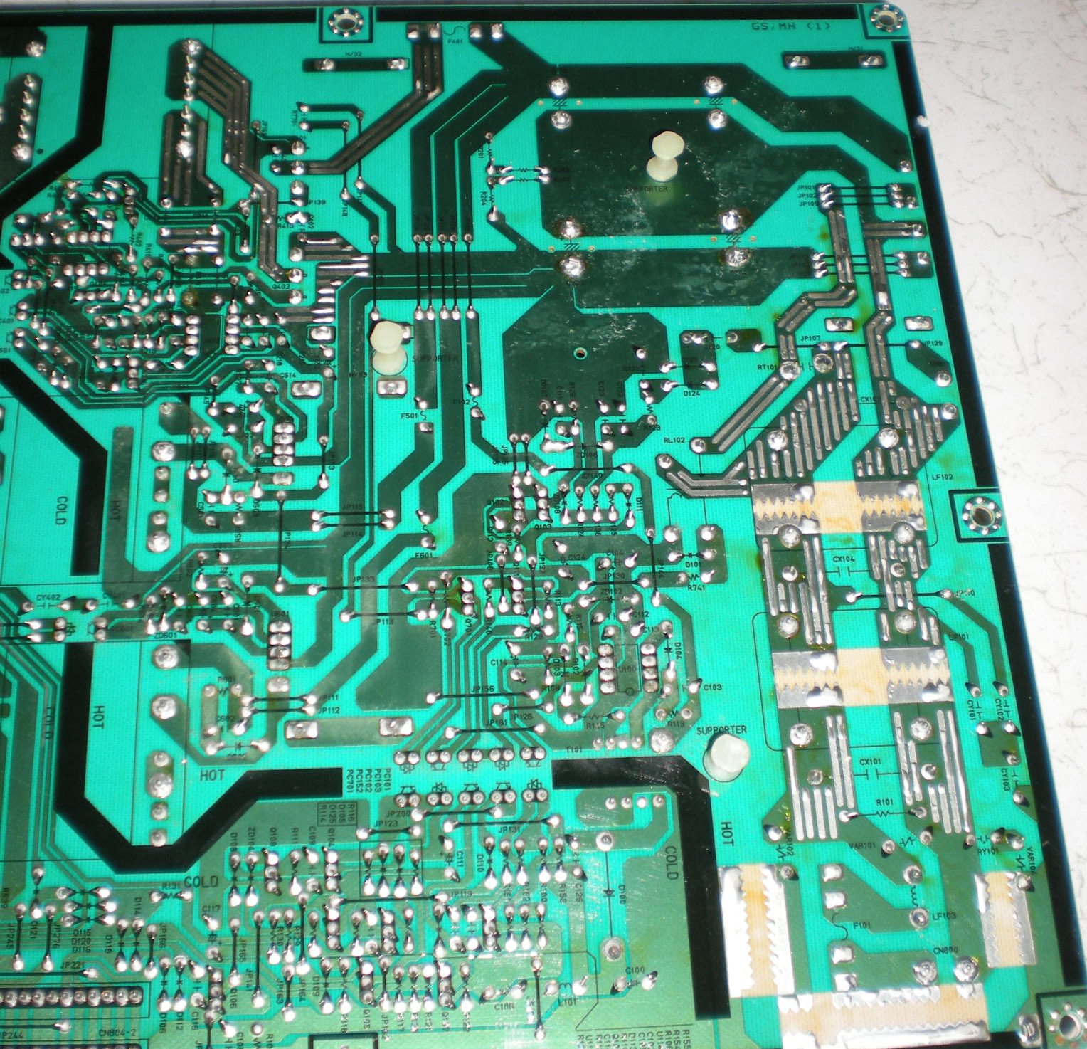

                                    I spoke too soon. I've been doing some Xbox360 stress testing and thought all was good.

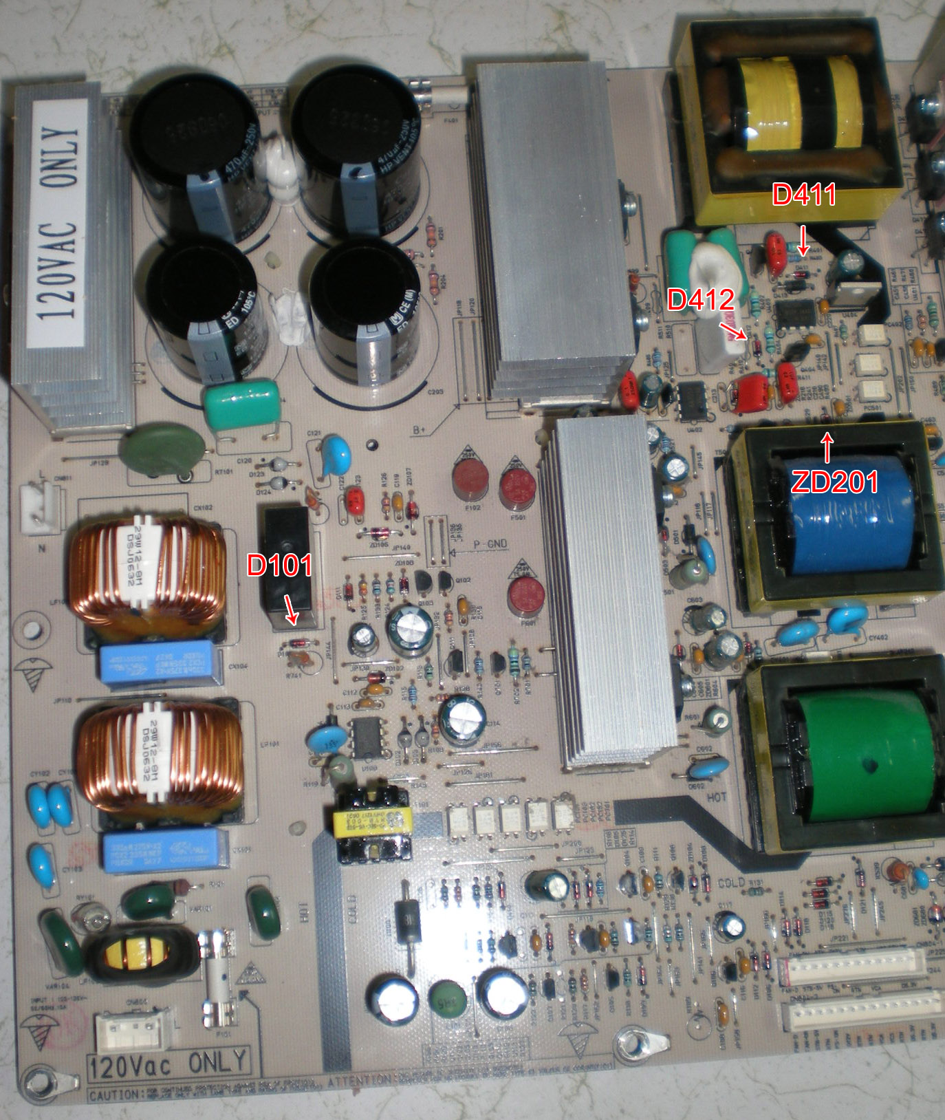

                                    Just now, it snapped like a string firecracker while it was turned off. Perhaps I should have replaced more than just the two bulging caps. Will open it up again in the morning...
                                    • OneOfEm
                                      • Jan 2011
                                      • 31
                                      I'm assuming that the problem is something on the "hot" part of the power supply (since it popped with the power off). Is that a fair guess?
                                      There's nothing visible. However, when I check voltages, this is what I get:
                                      ........On Label.........Tested
                                      Vs.........197..............442
                                      Va..........65..............145
                                      Vset......195..............415
                                      Vsc......-185.................0
                                      Ve.........110..............248
                                      Where should I look next? Need a clearer picture of that part of the board?

                                        The fuses are all OK. There are 4 diodes that show resistance both directions (see image).
                                        I could handle replacing them, but...
                                        • How do I identify what they are and what replacements I'd need?
                                        • Is it likely that these diodes are just symptoms of a larger problem?
