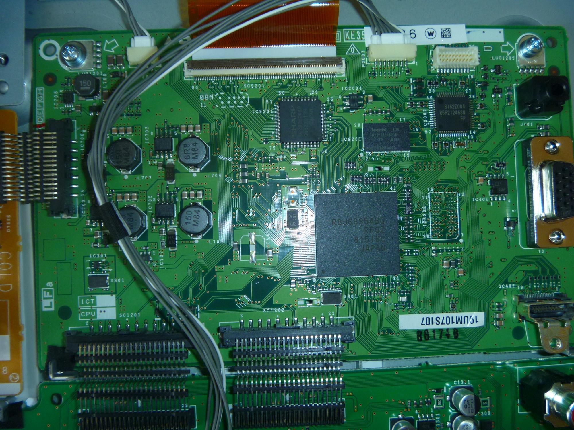

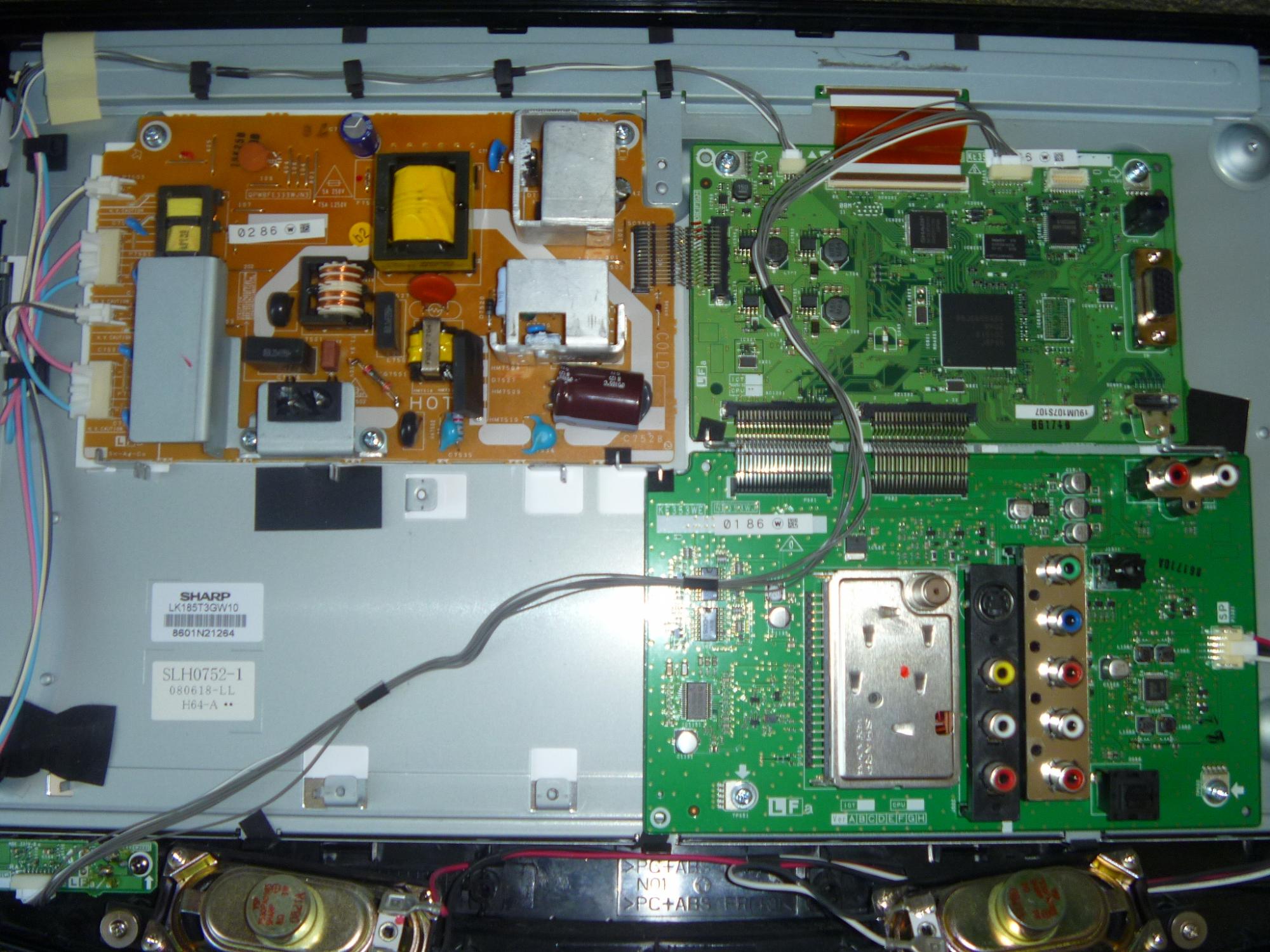

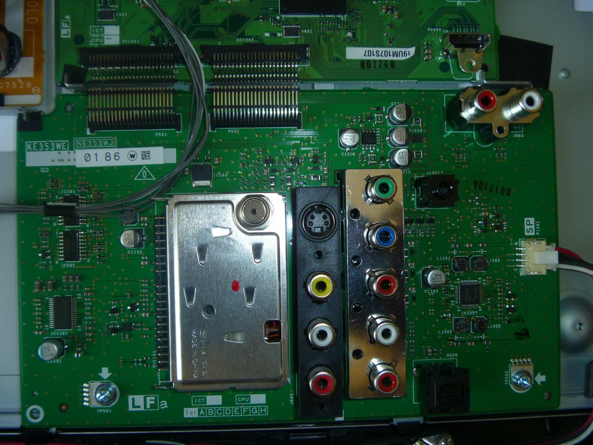

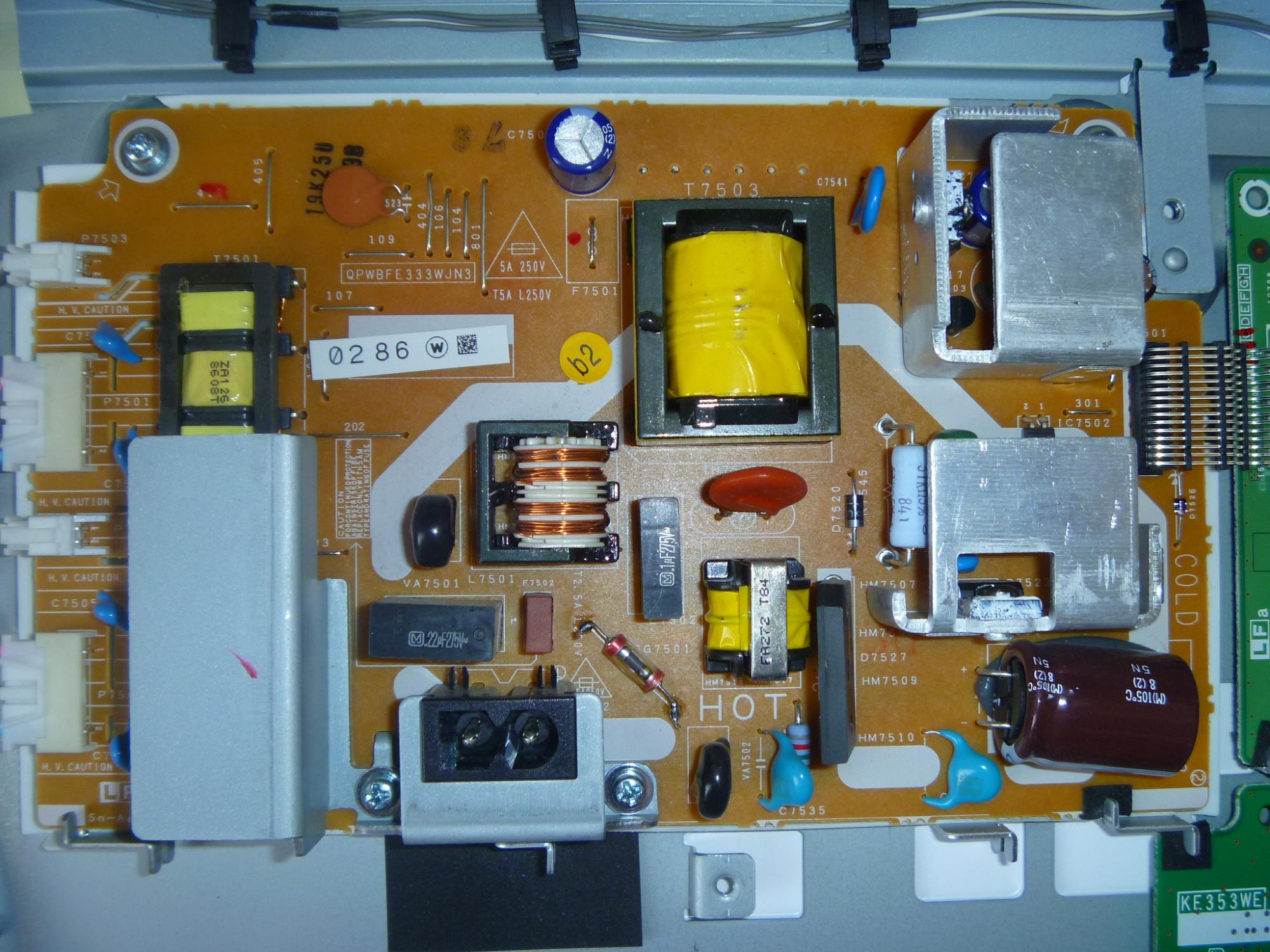

    I had Sharp LC19SB25U when plug power to TV the power red light flash, can't turn on when press power button
    open & take some picture
    check power at SC7501 (had 15 pins quick disconnect) connected from supply board to video card
    at pins 9 had 3.279VDC & pins 13+14+15 had 11.81 VDC
    Need servicer manual to find out what wrong of Sharp LC19SB25U

        I viewed your pics. I have my Sharp LC-19SB25U also opened. I am encountering the same issues. I would like to know if you have "servicer manual" to find out what's wrong with it. Also there is a fuse that one can change on it, but I can't seem to find it. Would you happen to know what I can change on it to fix it?
        Thanks in advance.

            I am new at this guys. I saw that hoadle said that he "check power at SC7501 (had 15 pins quick disconnect) connected from supply board to video card at pins 9 had 3.279VDC & pins 13+14+15 had 11.81 VDC" can you tell me exactly where are those pins that you disconnected to test them. Also where is that fuse that I read up on that one can also change on the picture. In other words if you can pin point it. Thanks.
