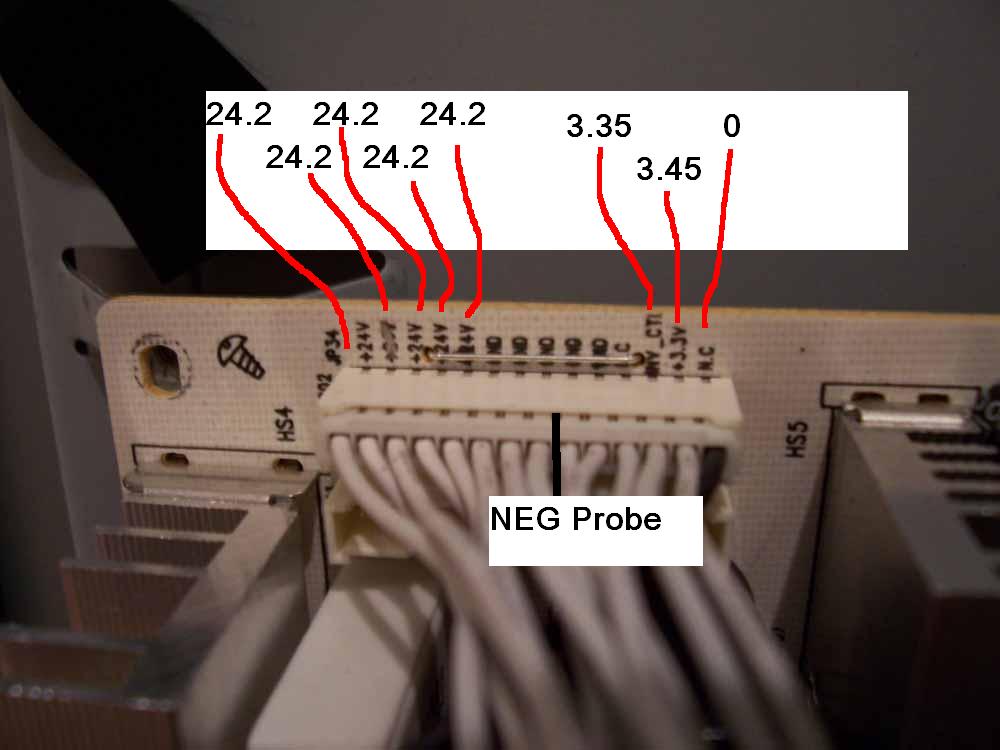

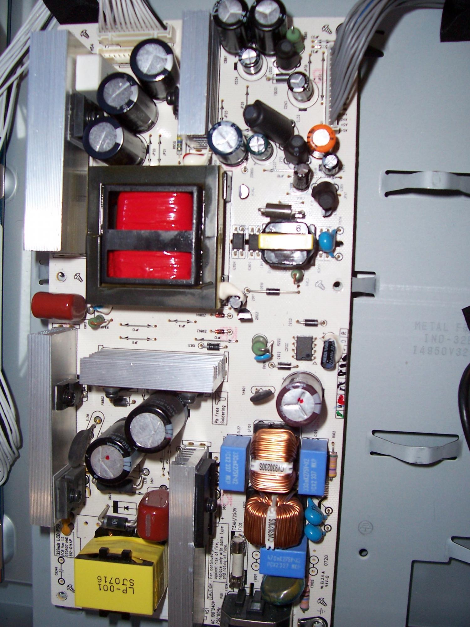

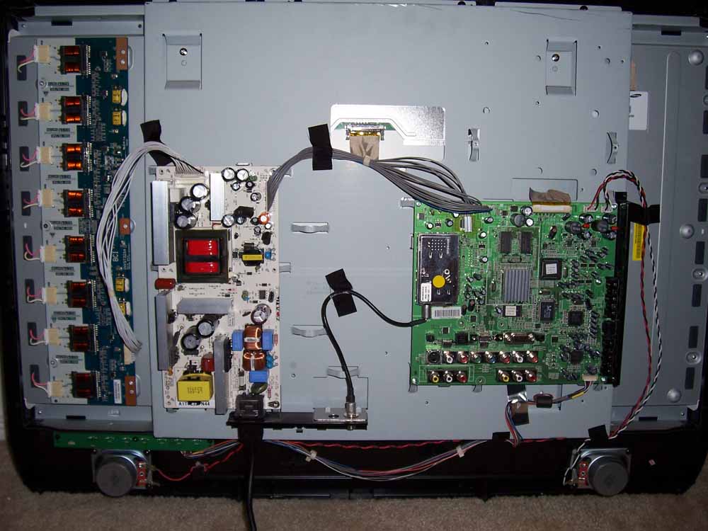

    A good description of the problem, let's see if we can troubleshoot this logically. But first, a hint.
    One thing that is missing from the pictures is an overall layout shot, and a picture of the inverter. Also, quite often clues can be found at the edges of the board, so cropping pictures too closely isn't helpful.
    NOW, working with what we do have, I see three output connectors from the power supply, two of them in use. Possibly one goes to the inverter, one goes to the main board. Or one may go to the main board, the other to an audio amp, and the inverter gets it's power from the motherboard.
    What you are looking for are the control lines to the inverter; often labeled BL_ON and BRIGHT. And what you want to do is measure the voltage on thBL_ON line as the display flashes on and off. Also check the power to the inverter, it can avoid a lot of wasted time.

      Re: daytek TV - kinda like 2 secs to black?
      ehm... 2nd pic, the 3 caps on the top left
      Panasonic HFG ? general purpose caps in a PSU? :O

        im not too sure how to check the power to the inverter board
        i did measure all the pins going to it and i think the one you mentioned, the BL and Bright are the ones on the right side of that picture. they are both rock solid at their voltages. the 24v is fluctuating in time with the on/off of the screen and they move from 24.22v to 24.18 its not much movement but i figured it was worth mentioning
        the bulbs are staying on super bright and not dimming at all
        as for my caps, i know i know but i am still very much just learning here and i cant wait for MCM mailing me 3 caps a time. i am working off of what resources i have here at home and at the local supply store. if i can manage to get this one working i will replace these caps with quality ones before doing something with it. right now i am operating on the assumption that they wont be fixed and will be thrown out.

          PlainBill has more experience in this area, but I believe the INV_CTL is the one to observe when the set/display goes off. Once the display goes off, measure that pin. If the voltage drops from 3.3V to 0V DC, it implies something on the main/logic board is turning off the backlight.
          If the backlight goes off and the INV_CTL stays at 3.3V DC, then it implies something is wrong on the inverter board.

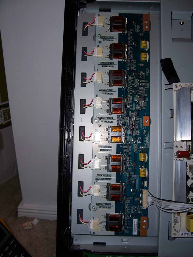

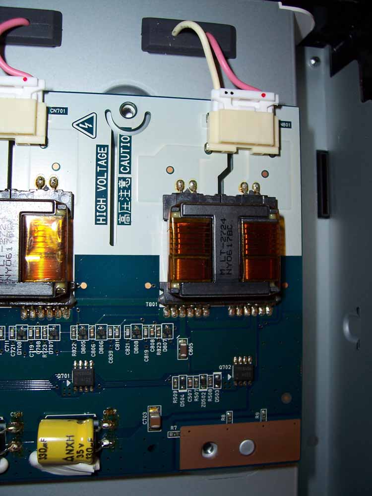

          Please post a clear focused picture of the inverter board. In addition, post another close up picture of just one inverter transformer (including the white/pink wires) so we can read/see the transformer part number.
          The closeup pic will help identify which are the secondary inverter transformer pins. Once identified, you will measure the resistance of all of them to see if one is bad. The secondaries are pins "feeding into" pink/white wires usually through some capacitor.

            i can post more pictures but while the screen is shutting off/on the INV_CTL is rock solid at ~3.25 dcv and the back lights arent shutting off or flickering
            doesnt this mean that the inverter board/bulbs are good?

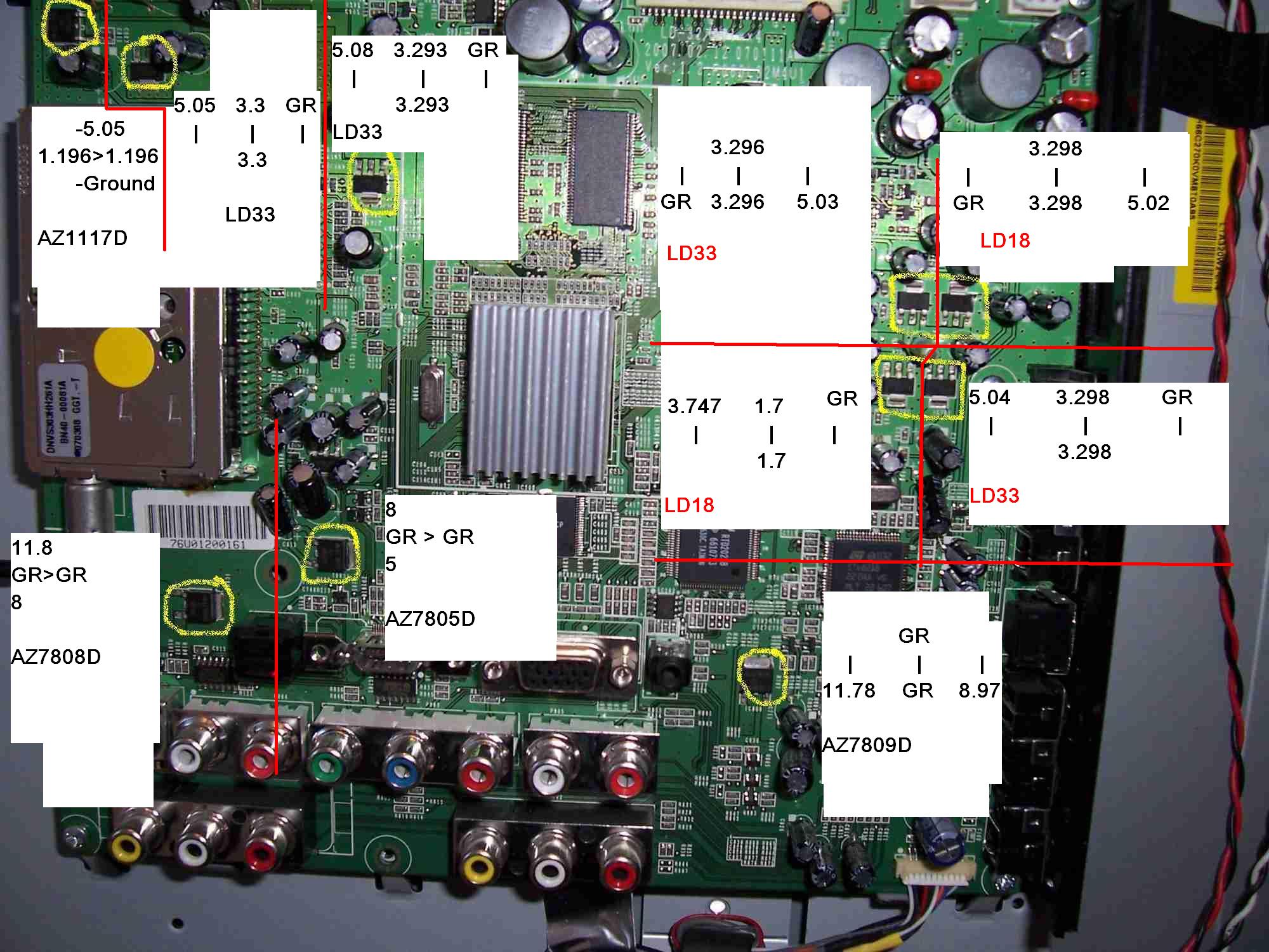

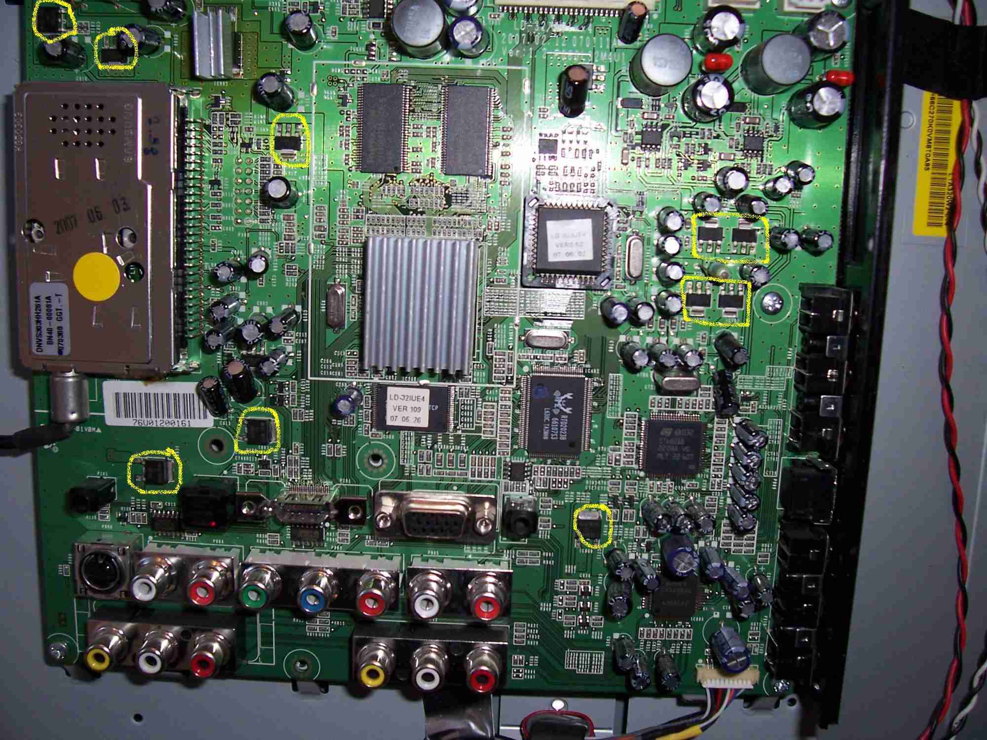

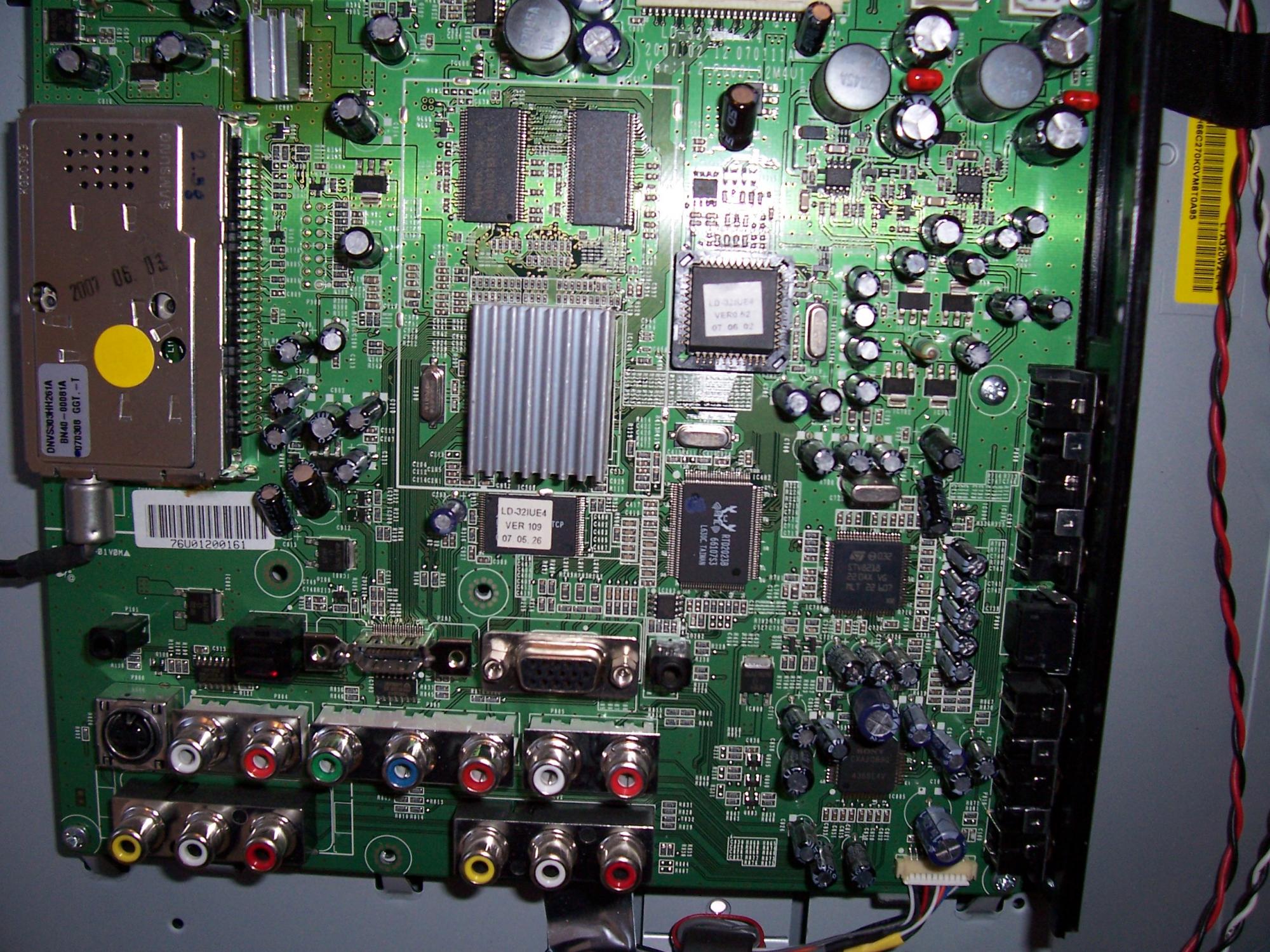

                      If your backlights are staying on throughout, then let's test the voltage regulators on the logic/main board.
                      I circled 9 voltage regulators. They should have part numbers like AL1117-33. The suffix, 33, indicates the output voltage. That is, 3.3V DC.
                      List all part numbers and the DC voltages on each pin (don't measure the tab pin). Use a ground screw on the logic/main board for your black probe.
                      Voltage regulators have a 1% tolerance.
                      --- begin sig file ---
                      --- end sig file ---
                      • scampo77
                        • Dec 2010
                        • 233
                        I'm so sorry for the lateness of this reply, this TV has been sitting here apart this entire time and I'm still interested in learning to fix these things. its just that work picked up and after working all day i didn't feel like coming home to a broken TV to fix
                        i did my best measure and post all the part numbers and measurements. i measured the tabs even tho i was instructed not to. i figured since i was in there i may as well
                        i think i noticed one that might be a problem the 2x LD18 on the cluster of 4 on the right hand side although they have the same part number they have different measurements. but they also have different tab voltages too.
                        also the regulator on the bottom right hand corner (AZ7809D) fluctuates with the flickering on and off of the TV. its not much but its still note worthy, as the rest were rock solid. it fluctuates from 11.75~11.83
                        thanks again for all the help i hope this thread is still alive and someone is willing to help out

                          hmm...
                          if LD33 = 3.3V and LD18 =1.8V, the top right LD18 is supposed to put out 1.8V, but instead it's almost 3.3V :O
                          and the bottom left LD18 is pretty low at 1.7V
                          the AZ780x seem to be all OK (the last digit is the voltage it's supposed to put out)

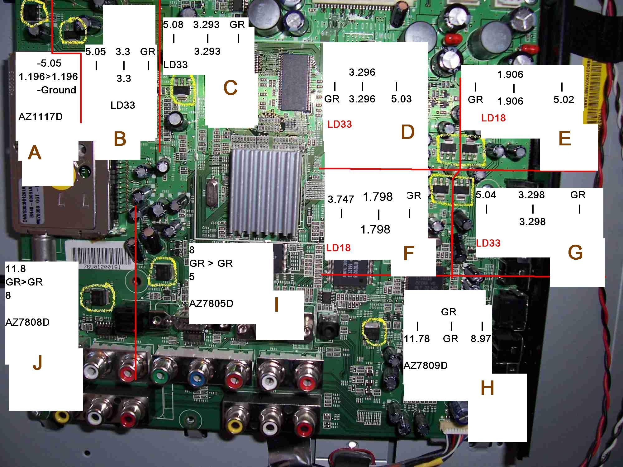

                                There are a couple of anomalies here. I'd suggest verifying the part numbers of each of the 4 regulators on the right side. I'm also mildly curious about the source of the 3.74 volts on the one with the 1.7 volts out.

                                  from my notes i took i missed 2 important values to the right of the decimal. regulator F at 1.7 is in fact 1.798. sorry about that i updated the new picture and gave them locations as well.
                                  also regulator E has changed in value it is now 1.906 it is possible i measured it wrong the first time around but it seems unlikely. all i know is now its at 1.9 now.
                                  i see what you mean about regulator F power source the rest are pretty solid at 5v does the fact that im still getting 1.8v on the other side negate the bad source voltage?
                                  i double checked D,E,F,G and all the part numbers are correct to my original post. there are additional numbers if you like but i suspect they are manufacturing codes.

                                    now "E" is too high... 1.90V instead of 1.80
                                    all the others seem to be pretty much dead on.
                                    only "A" is an exception, as it's probably an adjustable voltage regulator.. (or is there anything behind the "AZ1117D"? like AZ1117D-18 for example)
                                      E is high. It should be 1.8 +/- 1%.
                                      So 1.8 x 1.01 = 1.818.

                                        should i go ahead and order just this regulator? or is there any other contributing factors that would cause something like this to fail ie, cap or resistor close to it or in the same circuit.
                                        or should i just replace that one and see what happens?
