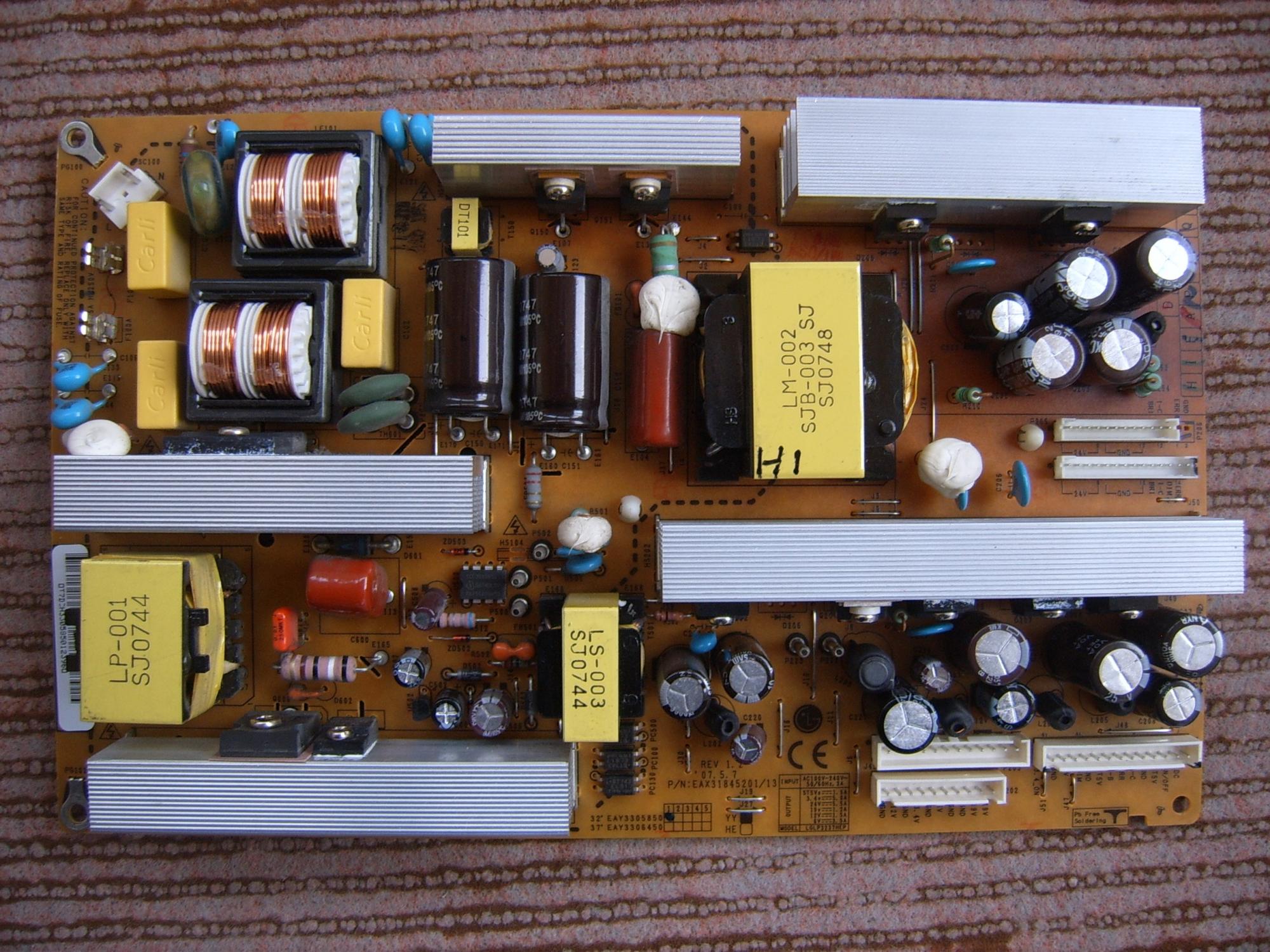

    Hi, everybody
    Two smd IC's of the power supply unit of the above model of TV are burned, I can't read their labels.
    They are U100 and U101.
    thanks in advance
    Borce.

      Post pictures of the board with the burned IC's. Someone might recognize it from this set or another set. Use "Manage Attatchments" on the posting page when posting you pictures.

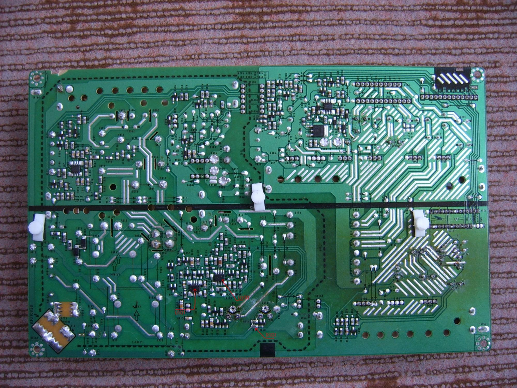

        PlainBill, there isn't supply board schematic in the service manual
        on the pictures I have attached are marked bad components wich I cannot read labels
        best regards

          Just to save you some time, there are people on ebay selling this power supply board for $50. This may be worth it if you are not used to surface mount soldering. If you buy the individual parts, wait for them to arrive, and then install them... It's up to you. Other boards cost a heck of a lot more and are worth repairing but $50 for a new board is a great deal. When searching on ebay use the board P/N EAX31845201 .

            Re: Lcd tv lg 32lc51
            i have this board, what revision is yours?
            • joste
              • Aug 2011
              • 42
              Rev 1.2, you can see it on the second photo attached above. There's a part number, too!
