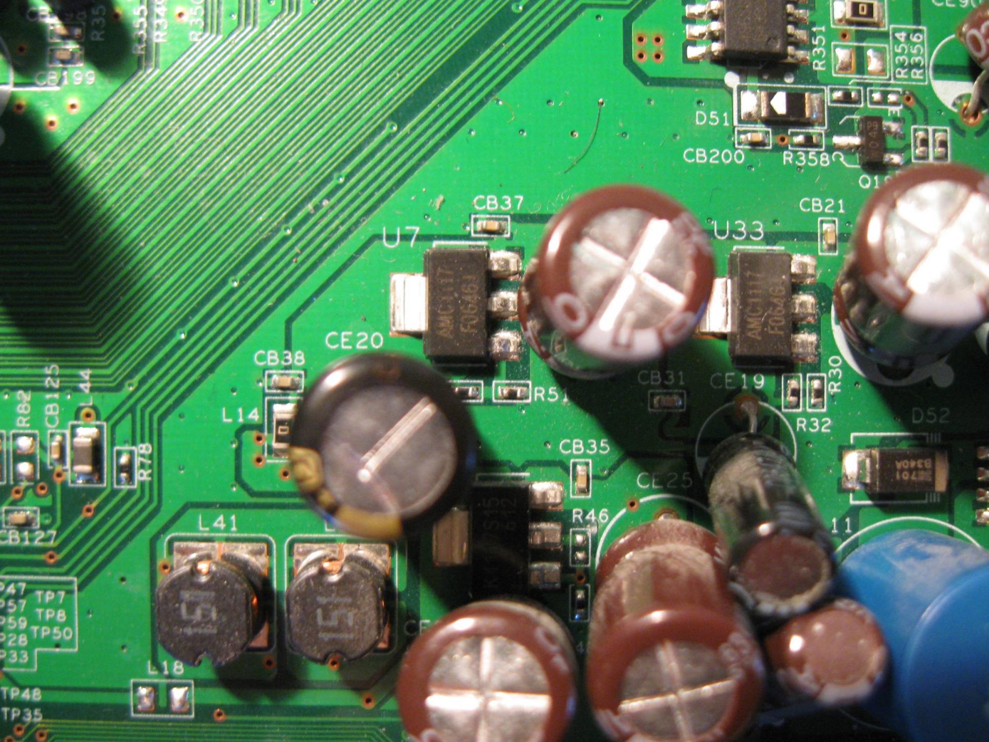

              Re: Vizio VW42LFHDTV10...Brother Mikes TV...LDO regulators
              Bill...
              Here's the sheet for my LDO regualors; Am I right that without a voltage spec on them they are the adjustable types ?:
              http://pdf1.alldatasheet.com/datashe...C/AMC1117.html
              My re-calibrated readouts:
              fet....V.in (leg 1-3)-- leg 2-3)--V.out (leg 1-2):
              U2.... 3.0 VDC-- 1.8V --- 1.2V
              U7.... 3.5 --- 2.3 --- 1.1
              U8.... 3.0 --- 1.9 --- 1.25
              U9.... 3.5 --- 1.8 --- 1.5
              U33... 3.0 --- 1.8 --- 1.25
              4 of these are AMC1117 F0646J ; U9 is a K1117S15 612
              Is leg 1-2 the output ? what is the measure across legs 2-3 called?
              What's up with my U7 and U9's ?

                I suggest measuring the voltage in a different manner. That will make it easy to determine what is going.
                Choose a suitable ground point - I tend to favor things like mounting screws, shields, or the negative lead of a capacitor. Measure the voltage from Ground to pins 1, 2, 3.
                On a fixed output regulator (U9) pin 1 is Gnd, pin 2 is Vout, pin 3 is Vin. On the variable output regulators I expect to see a consistent voltage drop between pins 1 and 2 - typically 1.2 or 1.25 volts. U7 appears to be faulty.
                  Here are the pin readings to chassis ground:
                  fet....pin 1 gnd -- pin 2 V.out --pin 3 V.in
                  U2.... 2.0 VDC -- 3.3V -- 5.1V
                  U7.... 0.0 --- 1.0 --- 3.4
                  U8.... 2.0 --- 3.3 --- 5.2
                  U9.... 0.0 --- 1.5 --- 3.4 <.....fixed LDO 1.5V
                  U33... 2.1 --- 2.8 --- 5.1
                  I doubled checked these readings, and my meter and the supply...are you sure about the 1.2-1.25 VDC outputs on the adjustables ?

                      If you check the datasheet for the AMC1117 you will see the output voltage for the adjustable regulator is Vout= 1.25 x (1+ R2 / R1). R1 is connected between the output pin (pin 2) and the Adj pin (pin 1). If you do the math, you will see there will always be 1.25V between pin 2 and pin 1 when the regulator and the load are working properly. U9 is the fixed output regulator. Look at U2 and U8 - 1.3 volts. U7 is strange. If pin 1 were grounded I would expect 1.25 volts out. Clearly something is wrong. Also U33's readings indicate a problem. If Pin 1 is at 2.1 volts, pin 2 should be at 3.3 volts.

                          When the output of a voltage regulator is wrong there are a number of questions to be answered.
                          1. Is the input voltage correct? (In this case, yes)
                          2. Is there an excessive load on the output, or did the regulator 'die'?
                          3. Was something damaged by the incorrect output? (In this case, unlikely).
                          You can get a partial answer to question 2 by rigging up a test circuit. Hook a 9V battery from Vin (+) to Gnd (-). Measure the voltage at Vout. If it is not 1.25V, the regulator is bad. It could still be bad even if the output reads 1.25V; you weren't putting any load on it.
                          The LM1117 is a positive adjustable voltage regulator.
                          PlainBill

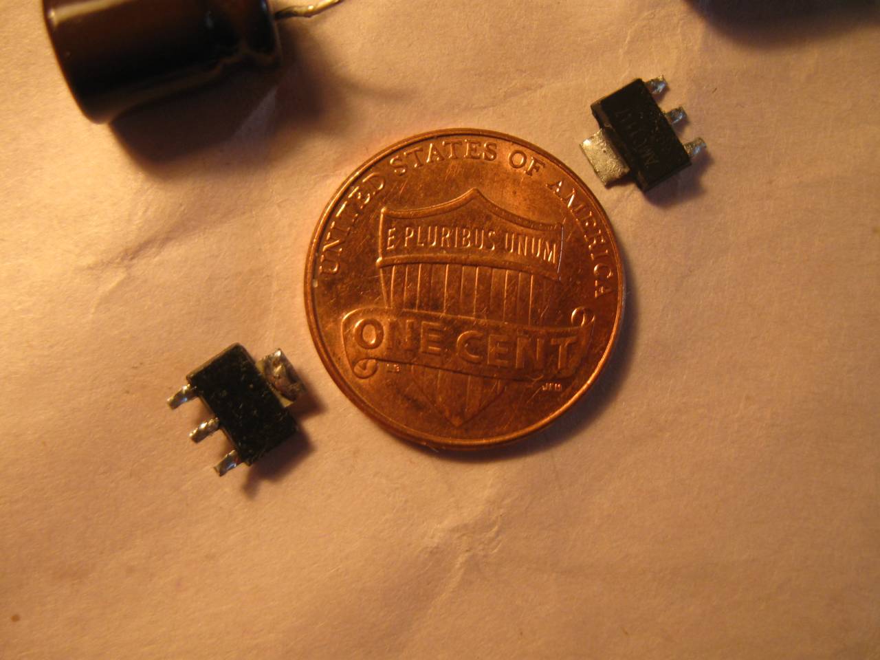

                                    First time with Chip-Quik......will recommend it to all you 'heavy metal' types !
                                    Not sure I got the right reading...here's what I did, hooked my 9v to the 1(-) and 3(+) pins, then my meter positive to the Vout pin 2, and negative to battery ground or pin 1, and read 7.5 V on both U33 and U7 chips . My battery reads 8.7V right now. Is this the right way, can't see any other way to read Vout.?
                                    BTW, had to remove the caps C18 and C27 to do the work, and they read 0.35 ESR and 215uf (25V)...too high for me...previously they had read 0.10 and 0.07 in circuit, and appear to be a close part of the regulators loop. Guess I should take out all the caps near these voltage regulators before closing the deal.
