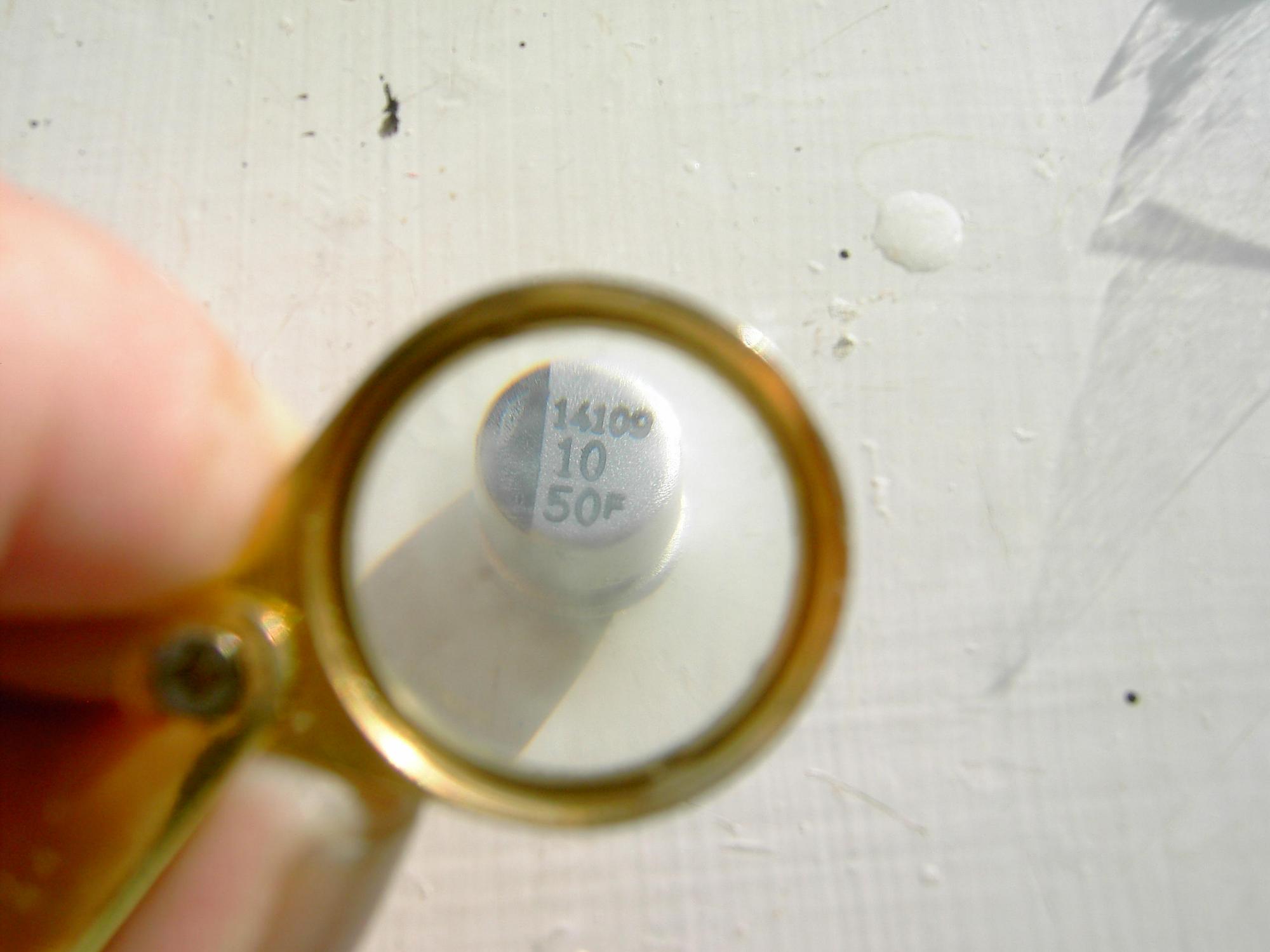

    smd device identifcation needed
    hi! does anyone know what this is and its value,number are as follows-14109-10-50F many thanks
    It's an SMD cap.
    While it doesn't cost anything to open a new thread, why didn't you simply add a post to the original thread to include the picture? Or better yet, included the picture with the original post?
    Now a little thought would lead to the conclusion that the value of the cap was 10 50. But is it 50uF, 10volts, or 10uF, 50Volts. A few minutes perusing parts listings would reveal that 10uF is a standard capacitance value while 50uF is not. So it's a 10uF, 50 volt SMD capacitor.
