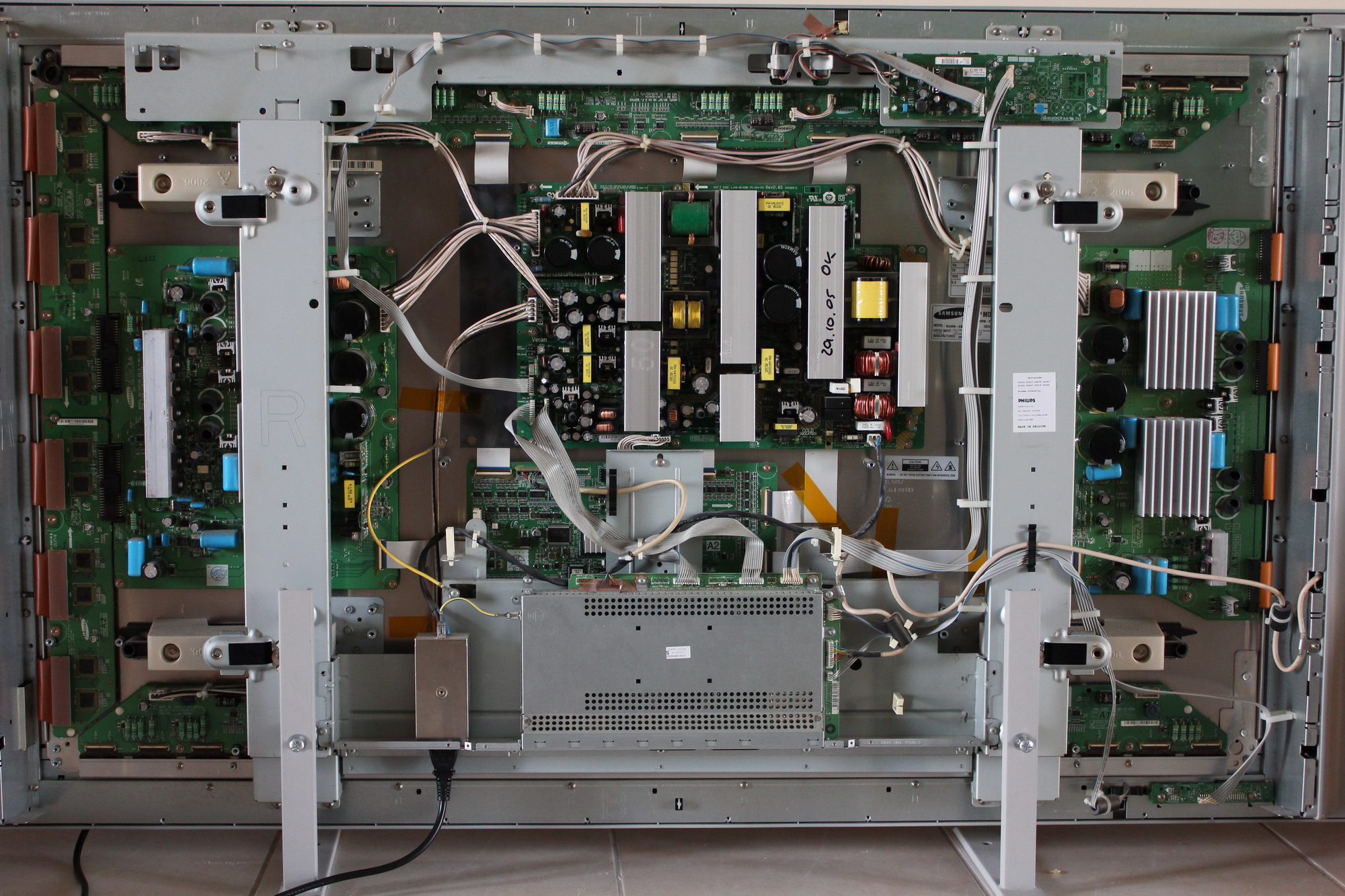

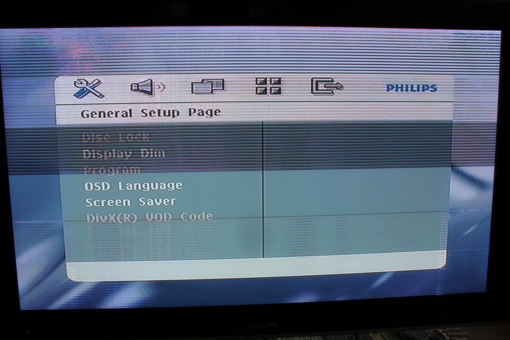

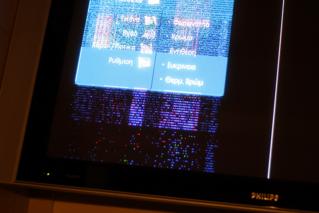

    Hello everyone :-)
    I have a Philips plasma screen, (50PF7320/10) with a display problem. (see images attached)
    Everything else seems to be working fine, audio, tv reception, menus, etc.. it's only these horizontal lines that appear messed up in the screen.
    I have read the repair manual (LC4.9E AA) and the training manual (PDP_2006)
    I have a led flashing continuesly, on the SSB, and I can not get into SDM mode, via remote control using the 062596 code. Has anyone managed that ?
    I dont see any bad caps, or other worn components. I wiggled the ribbon cables / connectors, with no effect.
    Any help is really appreciated !

    Re: Philips plasma 50PF7320/10, display problem
    additional photos for references...

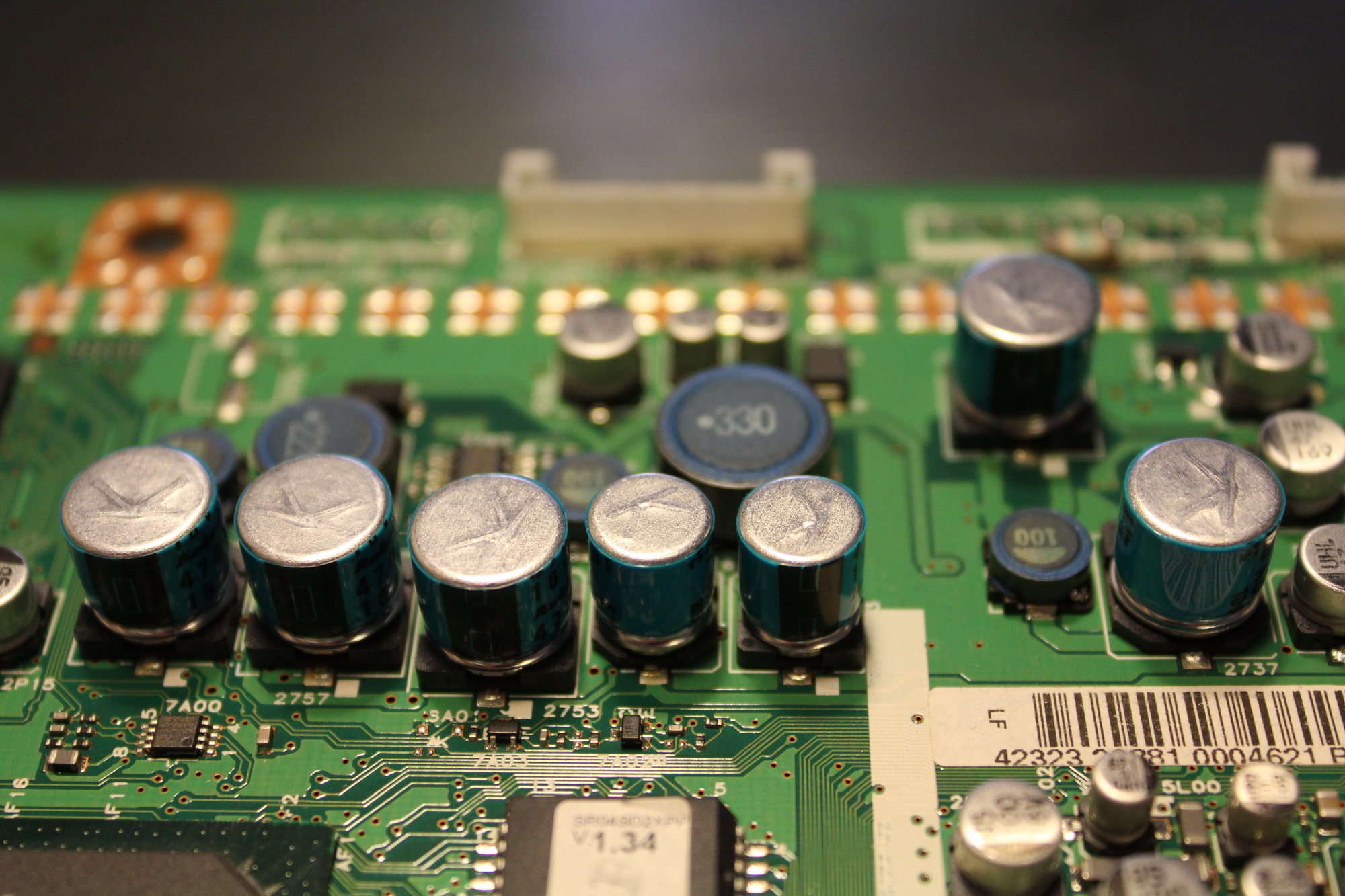

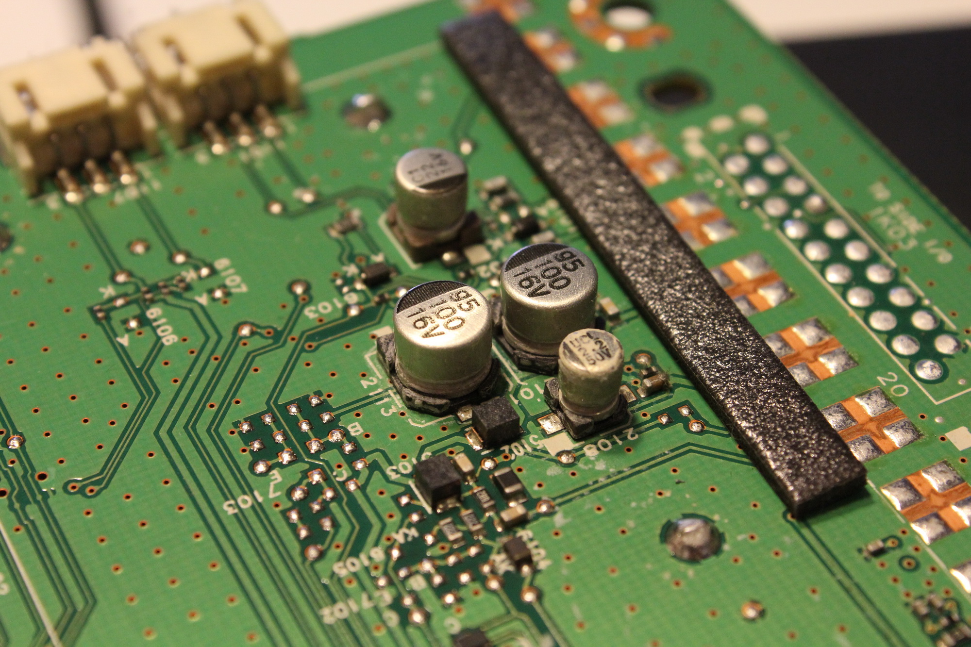

      I moved to the SSB board, and found some suspicious bad? caps
      Can someone give me his opinion ? photos attached
      On image 6764 it seems some fluid from the caps has been spilled.
      On image 6765 it seems to me that all caps have grown a bit :-) or their plastic cover seems a bit tight ?

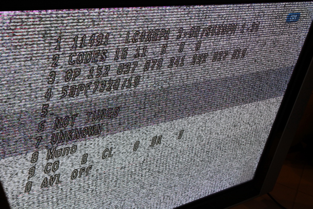

        I tried the customer services mode via the remote, and it worked. (image attached)
        So the errors are:
        (first detected error)
        8 - Scaller eeprom I2C error while communicating with the scaller
        11 - Columbus I2C error while communicating with 2d/3d combfilter columbus
        (latest error)
        16 - EPLD I2C error while communicating with EPLD

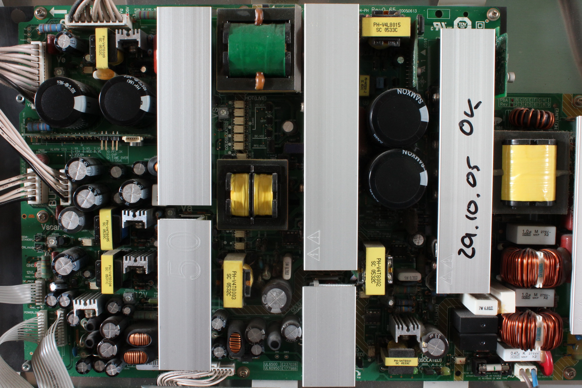

                      Ok.... after playing around with the TV I have "created" new symptoms, more clear this time! So I will try to summarize them:
                      1) Attempt to use TV as normal, all boards connected => Front Green LED blinking, no picture, ( I am in SDM mode hence there errors are 16, 11, 8 as seen on screen when it was working)
                      2) Attempt to start PSU with NOTHING ON => Alert LED on PSU blinking 13 times (12V problem)
                      3) Attempt to start TV with only picture boards (no audio, no signal board) => Alert LED on PSU blinking 4 times (3V3 problem)
                      4) Attempt to start TV with only picture boards (no audio, no signal board) and "white-picture" jumper shorted on main board => PSU alert LED blinks 13 times
                      (And this is the most interesting one)
                      5) Attempt to start TV with all picture boards, no audio, however with signal board connected only to PSU and not to main board - and main board white jumper shorted.
                      I have a white picture !!!
                      This white picture has the black horizontal lines ( initial symptom of tv)
                      I noticed now that the bottom lines are purple instead of black
                      While is not consistent, bottom corner is pink-ish
                      Also, D3V3 line on PSU goes from 3.2volt to 3.4v .. not stable!
                      and 12v line is 11.9 and using the "12v trimmer" on the PSU I can not get it to go any higher. If I turn the trimmer to the right, psu turns of with LED blinking 13 times, before actually increasing the 11.9v
                      Conclusion?
                      I definitely have "some" problems with the PSU .. I was thinking to replaces ALL CAPS larger then 100mf
                      Does that make sense ?
                      Should I replaces specific voltage regulators as well ?
                      Regarding the screen. When I do manage to get the white screen, can the black lines be justified due to faulty PSU ? or is this a different problem ? hence once I sort the PSU, I will have to replace main board or Y-circuit ?
                      Video with white screen: http://www.youtube.com/watch?v=iRfd033WtnU
                      • cadiman
                        • Mar 2010
                        • 397
                        You have a y drive buffer out. for starters. If I remember that is a two part buffer (upper and lower) I have unplugged the bad buffer board and then the y drive would stay up and running and the power supply would stay on

                          • mbates14
                            • May 2005
                            • 169
                            bad Y buffers. if they intermittently short, they will shutdown the power supply or blow the sustain board.

                              • PlainBill
                                • Feb 2009
                                • 7034
                                Originally posted by nikil511
                                ok, so can the Y buffers be repaired ? are there any common-failing components that I should check ?
                                Yeah. The ICs on the buffers are known to fail. This blog discusses the problems with the buffer ICs used in the 42" version of this TV. As far as I know, the same ICs are used on the 50" set you have.
