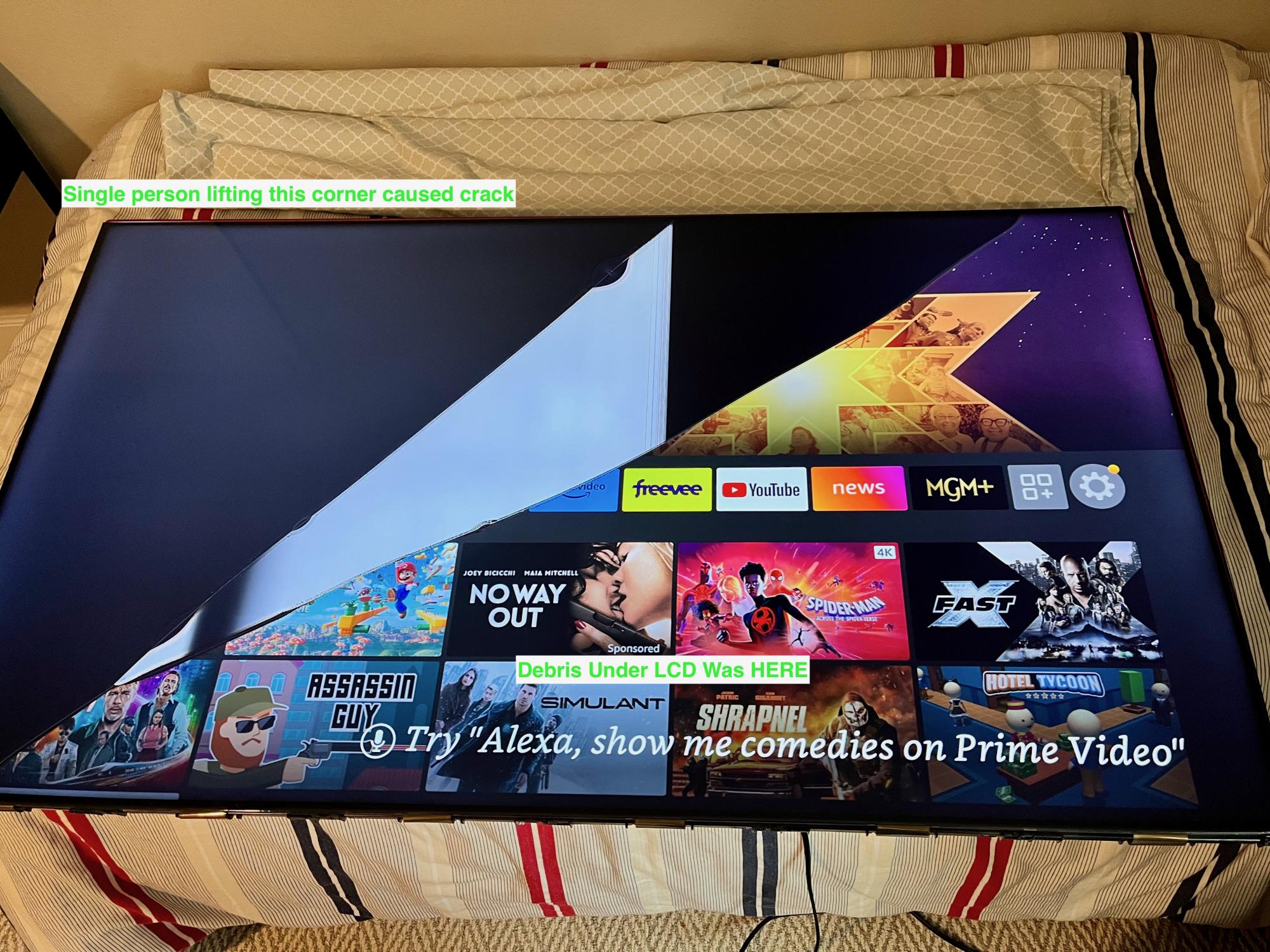

            Almost successful in repair. Unfortunately cracked the LCD nearly the last step trying to remove debris from underside of the LCD.

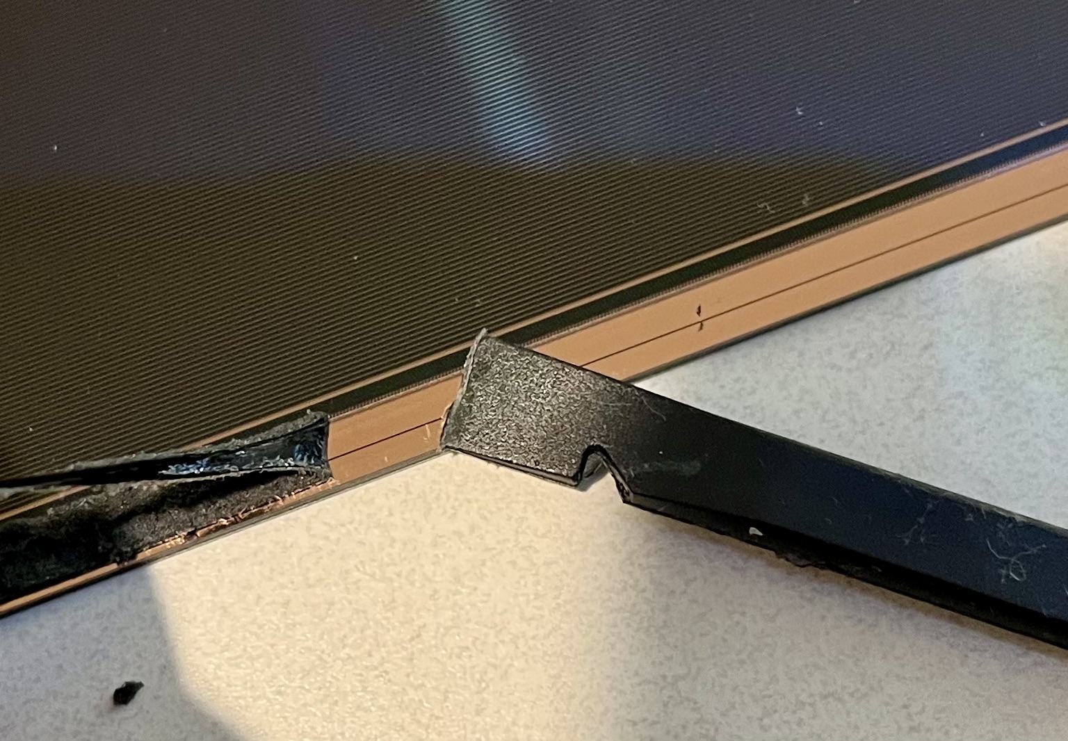

            Debris on underside of LCD Glass
            To remove the double sided tape from the underside of LCD require exposing the underside to open air for extended period of time. Only way to see and clean all dust/debris particles is with LCD installed (but not double sided sticked down) and backlight on. The natural instinct is to tilt up the LCD while installed and use masking tape to remove the debris. Got every debris except the last one towards the center lower of the screen which unfortunately require higher tilt and stress on the LCD glass lifting it from one corner (one person). Thus cracked. If doing this again, definitely need 2 people so one can tilt the screen supporting from both top corners while the other person remove debris with masking tape. Alternatively go slower, mark the debris location, remove the LCD, remove debris, install, repeat.

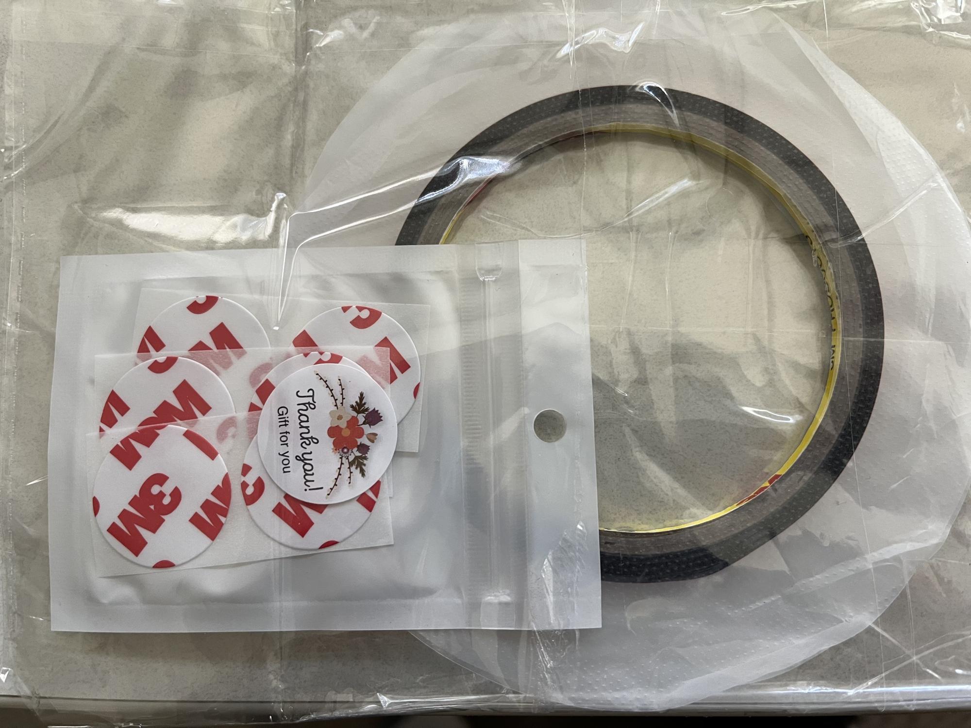

            4mm VHB 5952 Tape from AliExpress Works
            Mounted the LCD onto double sided tape despite cracking LCD to test out the tape. Definitely sticks well. Likely genuine VHB tape custom cut to 4mm as noted by the seller. $7 for 3 meters.

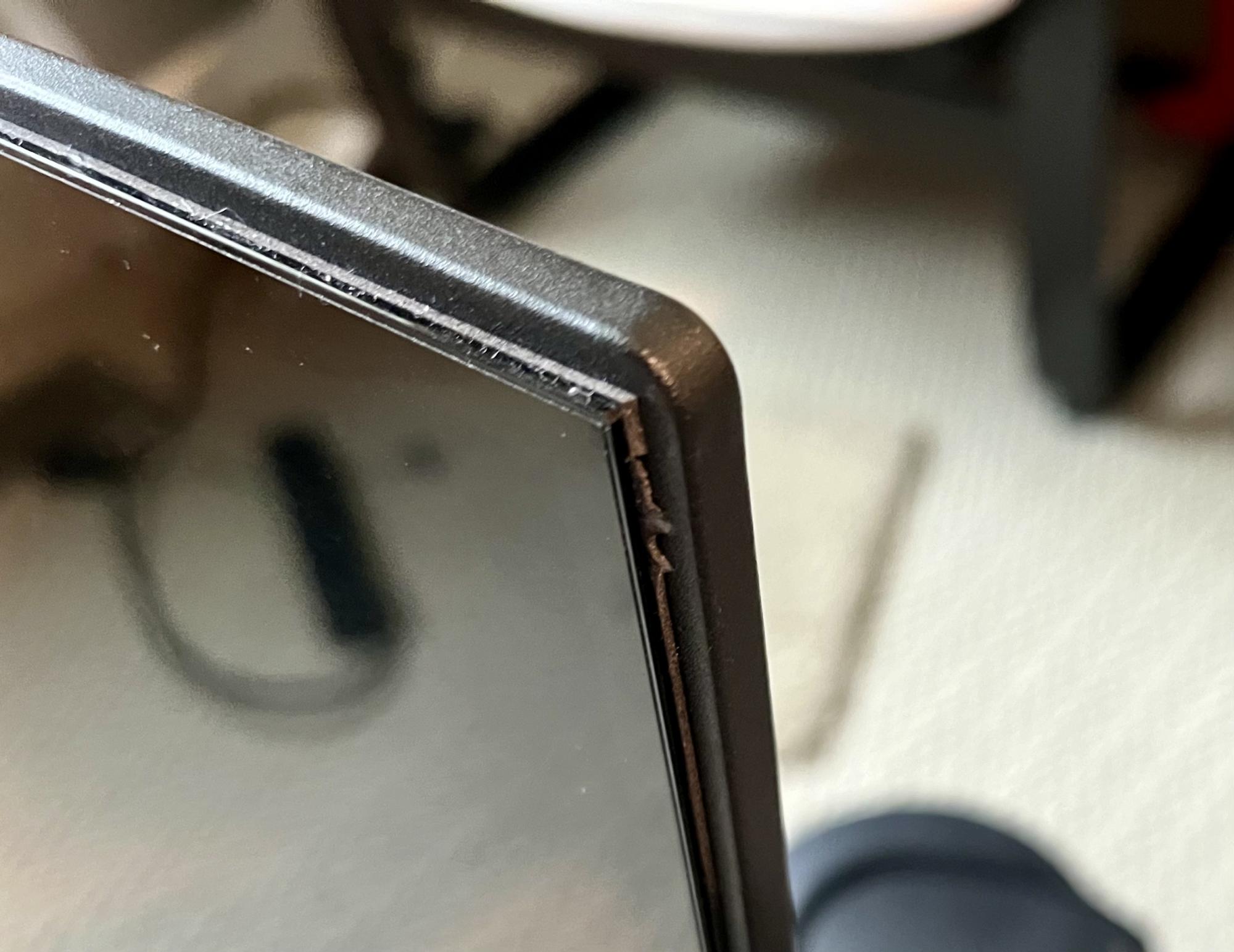

            Cutting Old LCD Tape
            Didn't have rotating cutting wheel which would have worked better. Blade will leave black foam debris on top of backlight diffuser AND underside of LCD and require more cleaning effort.

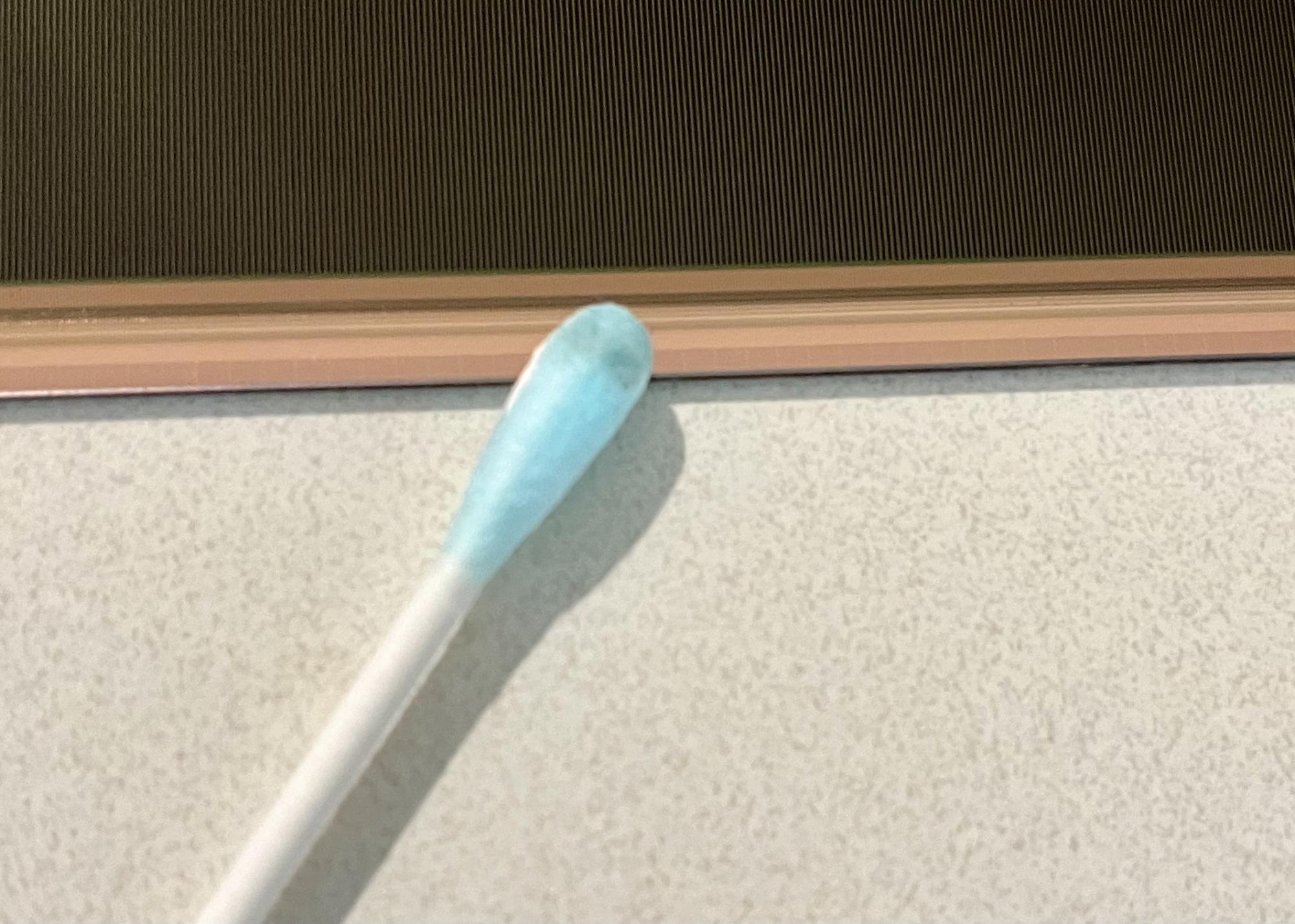

            Cleaning old tape from LCD
            Takes quite a bit of time so go slow. Place LCD glass on flat table with hard flat surface so plastic scraper have a firm surface to scrap off the tape. Removing the tape with the shiny sticky surface facing the glass intact is desirable to avoid leaving too much sticky residue on the glass requiring further cleaning.
            Clean up remaining residue with little bit of ISO on a small firm q-tip
            Tape will cover 2 layer? levels of glass. The ~2mm thick layer faces outwards on the TV and a much thinner layer where LCD circuits are probably lithographed on. It is likely this ultra thin layer that cracked when I lifted one corner up too high trying to get last remaining debris.

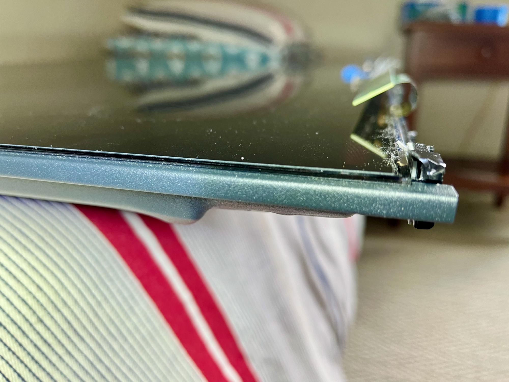

            Cleaning old tape from metal chassis
            The chassis tape surface is textured. Old tape will just peel off. Go slow as some areas will leave residue (near corners) Just have plastic scraper near to aid glue removal in these regions.

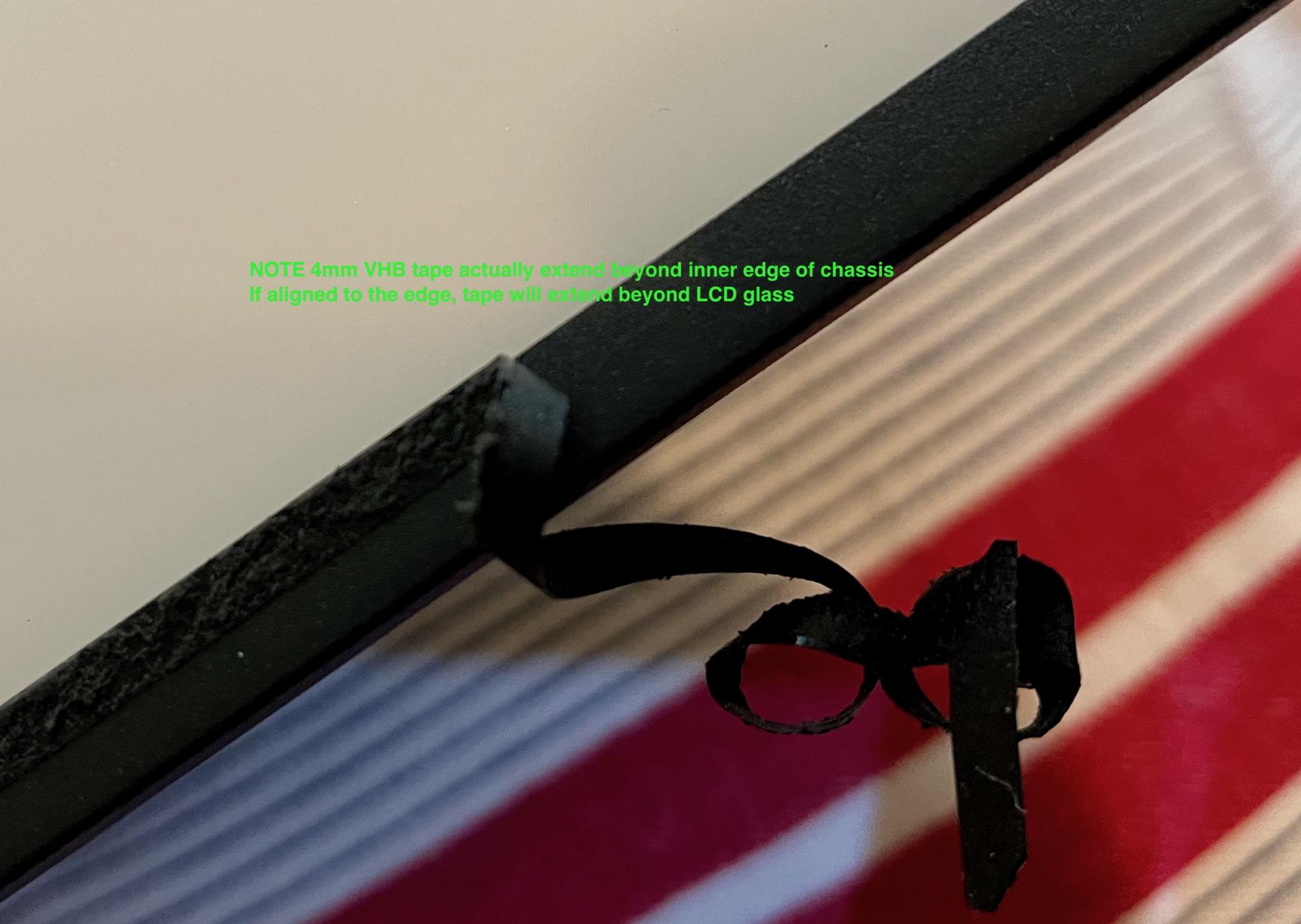

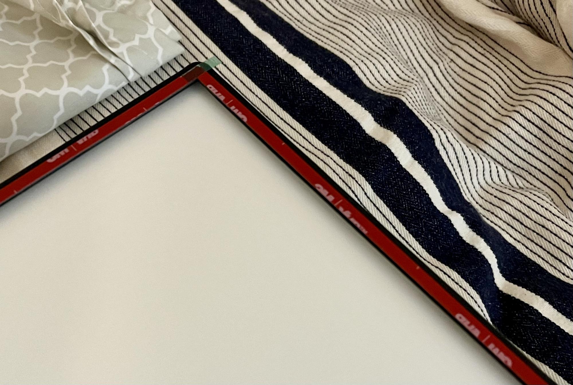

            Installing VHB Tape
            I chose to install it on the metal chassis first. In hindsight, it might have been better to install on the LCD first. 4mm tape evenly aligned with inner edge of the chassis will have 1mm+ of sticky surface outside of the LCD glass after install. So its better to install on glass first for perfect alignment.
            Removing under LCD debris
            As noted above. 2 people is ideal to tilt up both top corners. To get to debris lower on the screen require tiling the LCD higher which is more stress on the glass. Going slower by marking debris and repeatedly removing LCD and remove debris sticky masking tape probably best.
