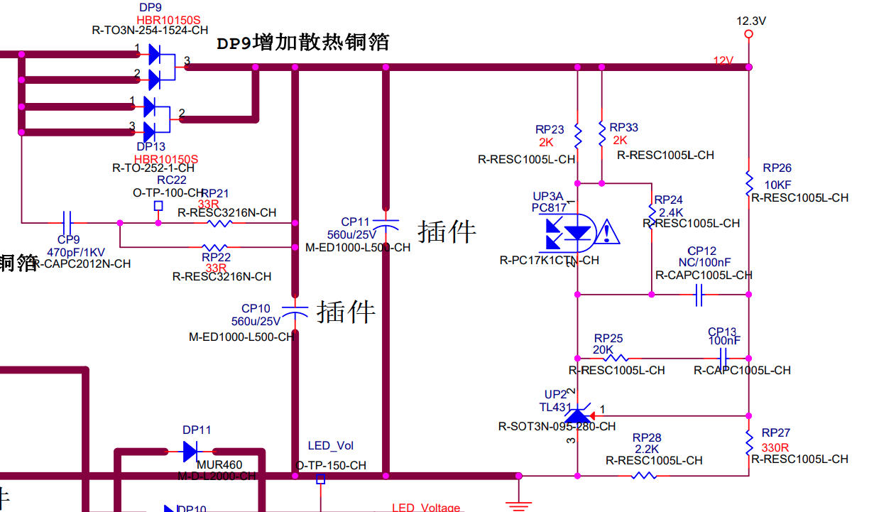

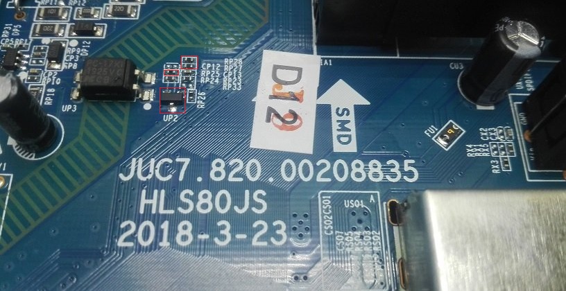

    Any kind sould with a JUC7.820.00208835 TV board on hand that could help me
    identify the values of some components, these are in the feedback section near the optocoupler, i need to know the value of:
    Resistors: RP28, RP27, RP25
    IC: UP2
    I attached a picture for easier finding of the components in question.
    Thx in advance.

    Re: Help with Parts Identification TV Board: JUC7.820.00208835
    Juc7.820.0020883
      Thx a lot for the help.
