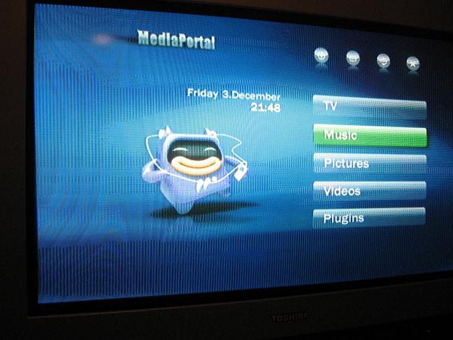

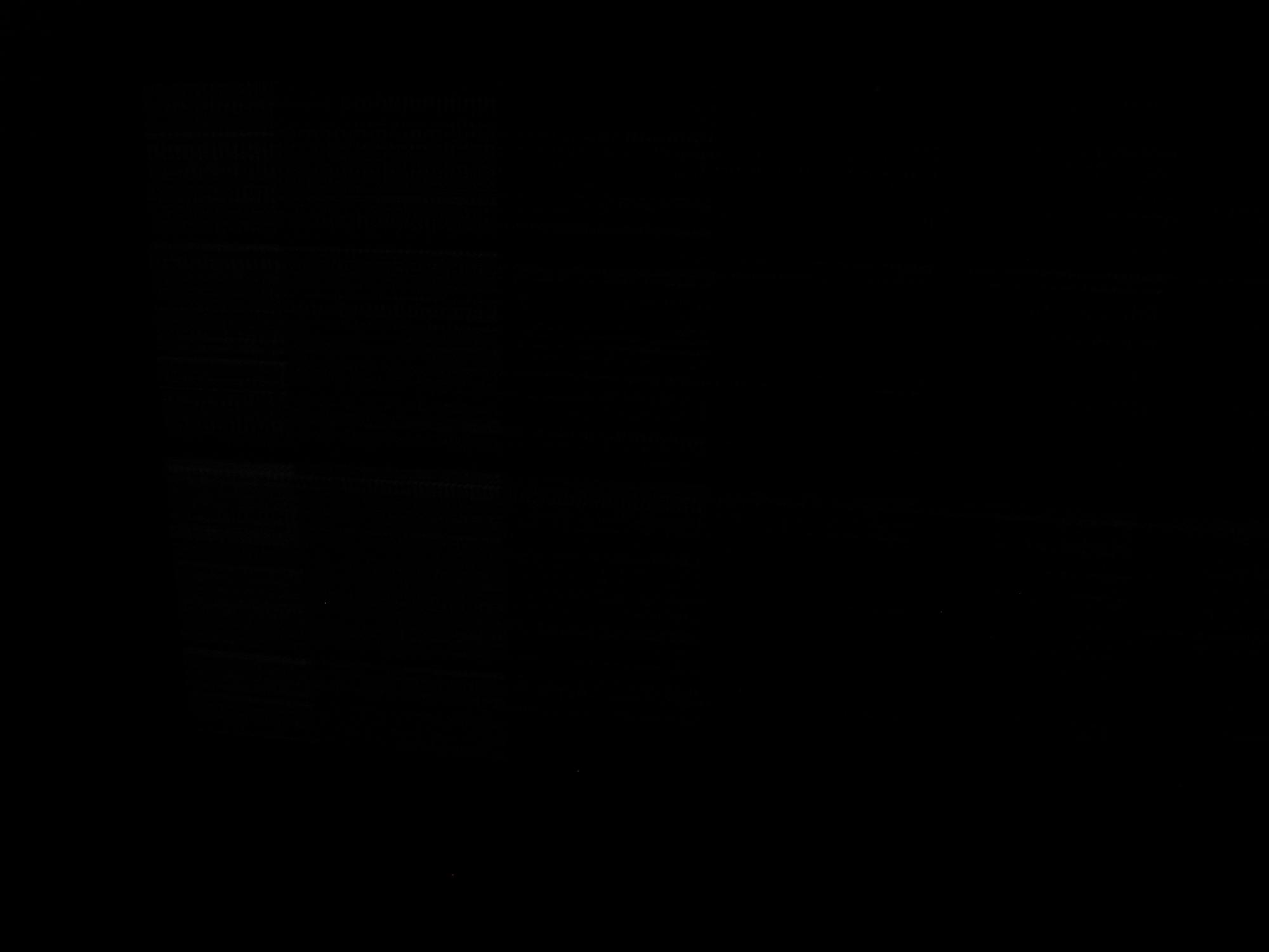

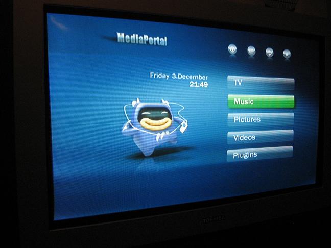

    Having a problem with the picture on this TV recently. Initially, after switch on, the TV would have the issue for a while, maybe 10 minutes, then suddenly would snap back to a perfect picture, but now, as soon as the TV is switched on, the picture has the issue.
    Hard to describe. Like a severely grainy picture, or if you had scanlines, in a vertical orientation mainly, but also some horizontal exhibition too, but not fixed, the grainy lines move about randomly. The picture is split into about 6 "bands" it seems, you may be able to make them out in the first picture, the dark one (IMG_0338.JPG) - you may be able to see the leftmost 3 "bands". I've included another photo to show the issue.
    The menu overlays, when invoked, don't suffer the same issue as the picture, they're clean and solid.
    Tried all scarts, and the issue is the same on them all. Source is fine too, tested on another TV.
    Any ideas where I should begin looking?

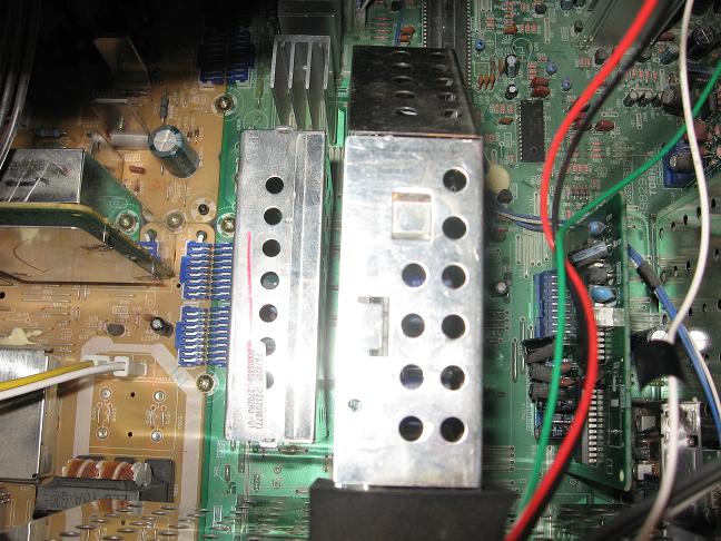

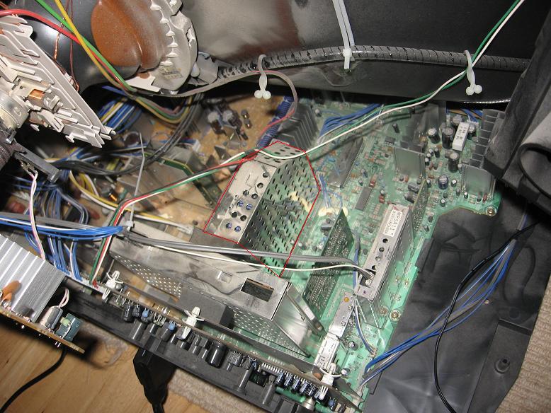

                    I've only had a chance to look at the TV today, and it seems like it's a bad connection. I've attached a photo, and the biggest riser card inside the metal shielding right in the centre of the photo is the one that was causing the issue (highlighted in a thin red line). From the few markings I could see inside the shielding and from looking through the schematics, I believe it's the DFS board (I could see QX01 and QX11 markings inside).
                    I poked a few areas inside with a wooden spoon, and when I moved this one slightly, the issue would come and go. I pulled it out a bit, and pushed it down, and it seems harder to cause the issue when I move the card slightly from side to side.
                    Looking underneath the card, it seems like it's attached to the mainboard with blue plastic connectors, but the shielding looks like it might be going through the mainboard, and maybe bent over or soldered to hold it down. I didn't try to lift it out fully.
                    I think if it happens again, I'll need to pull out the boards, and try to fix the problem more permanently. A quick google sees the issue coming up a few times with DFS boards, also with older Toshiba CRTs. Some of the fixes look like removing the DFS board, and resoldering some connections. We'll see how I get on.

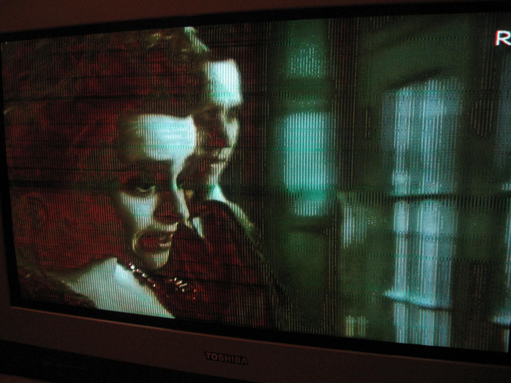

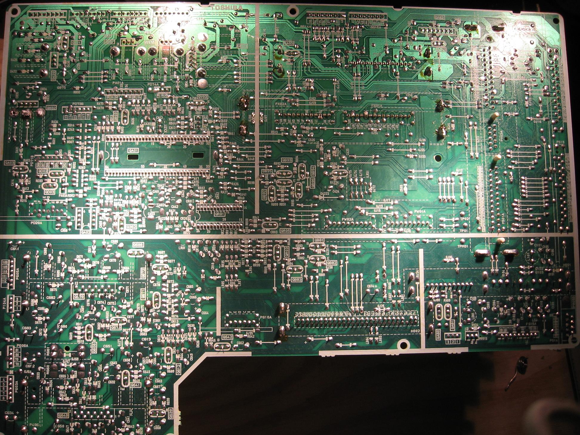

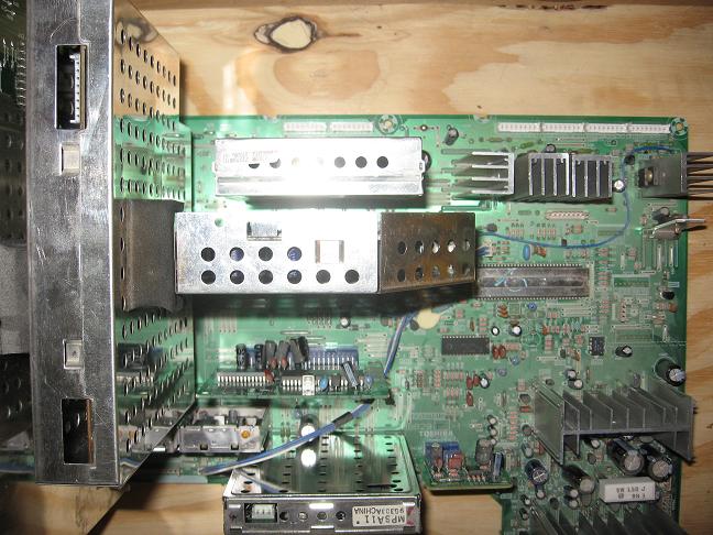

                      Ok, the TV didn't last very long before exhibiting the issue again. I've attached a few pictures.
                      The first 2 (Picture_G and Picture_B) show when the picture is good and bad. The problem is with the vertical graininess (there are some curved lines on both photos, but that's due to the camera).

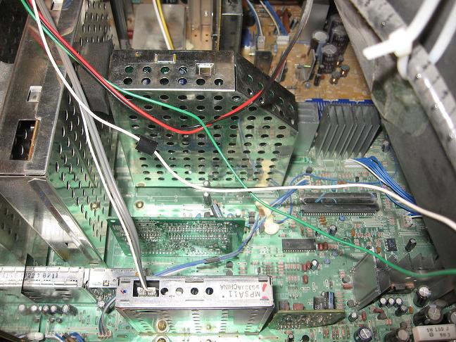

                      I've also included a few pictures of the top-side of the boards, with the board that causes the problems usually towards the centre - it's the large square shaped one, with the top-forward (towards the tube) corner cut off it.
                      When I move the board either towards the power side of the TV, or even in the other direction, the issue comes and goes.

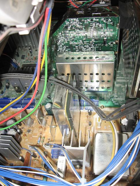

                      I've also included a picture of the underside of the board.
                      There are blue interconnection connectors between the power side of the chassis and the side where this problem board is, but they seem to be sound. Any flexing that results from moving the problem board shouldn't cause a problem on the power side with these connections. Also, if I move any of the other vertical boards, the same degree of flexing occurs, but the picture doesn't change from good to bad.
                      I also had the problem board off the mainboard. Four solder points removed it where the cage goes through the mainboard. It's connected to the mainboard through a connection not unlike an IDE connection. On the underside of the mainboard, I reflowed the solder that attaches the connector to the mainboard. I also tested the problem board for continuity between it's connector pins and the solder points on it's board - no problems detected.
                      I didn't take the problem board out of it's cage. There are a few heavy-duty solder points holding the board to the cage, and they all look sound. It's unlikely that moving the problem board causes movement inside here that would be causing the issue to come and go, is it?
                      Anything else I can try or test, or something I may have overlooked, or need to go back and check?
