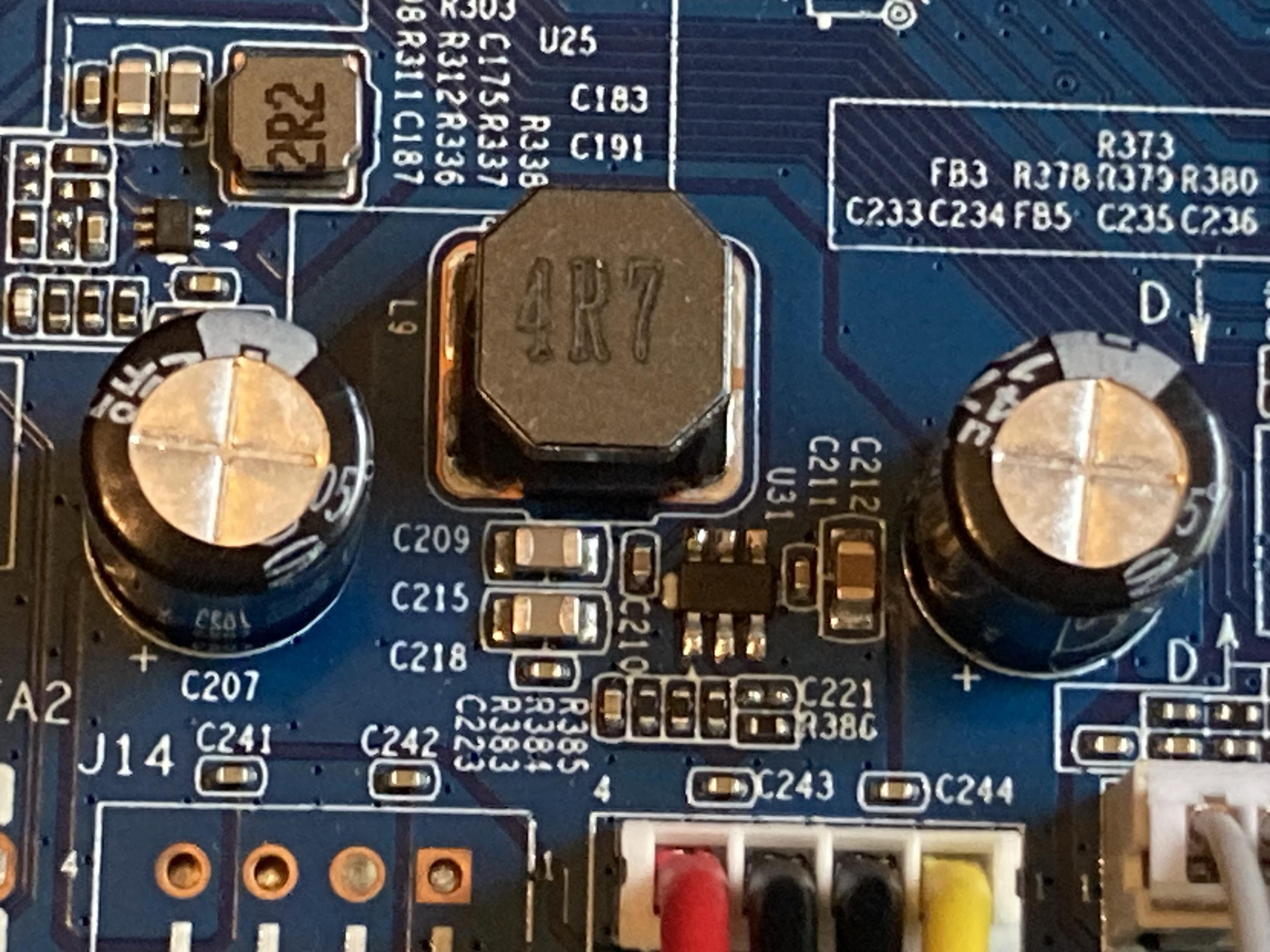

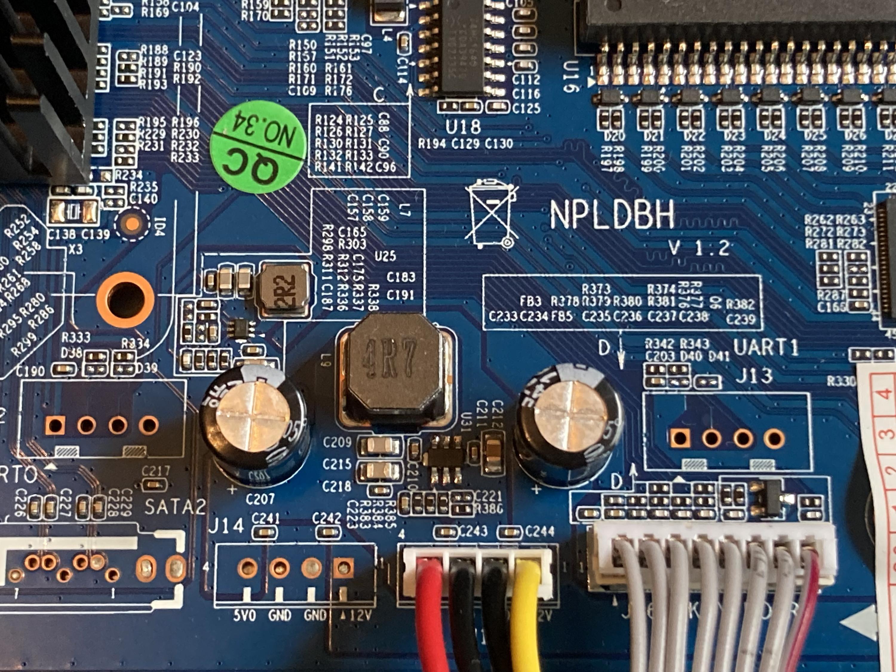

    Trying to identify this IC near the 12 and 5 volt connector. It is marked MDME and looks to be some kind of voltage regulator for the 12 and 5 volt rail. This is located in an Invid Nvr #PN1B-8X8NH. As you an see from the picture it is a 6 pin small ic. Any help is appreciated.

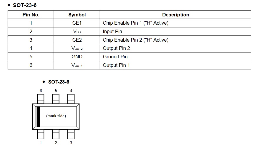

    Looks like a Ricoh RP154N028B Small dual ldo regulator outputs of 2.8v(pin1) and 1.0v(pin4) input (pin2)
    The picture is too out of focus to be of much use.

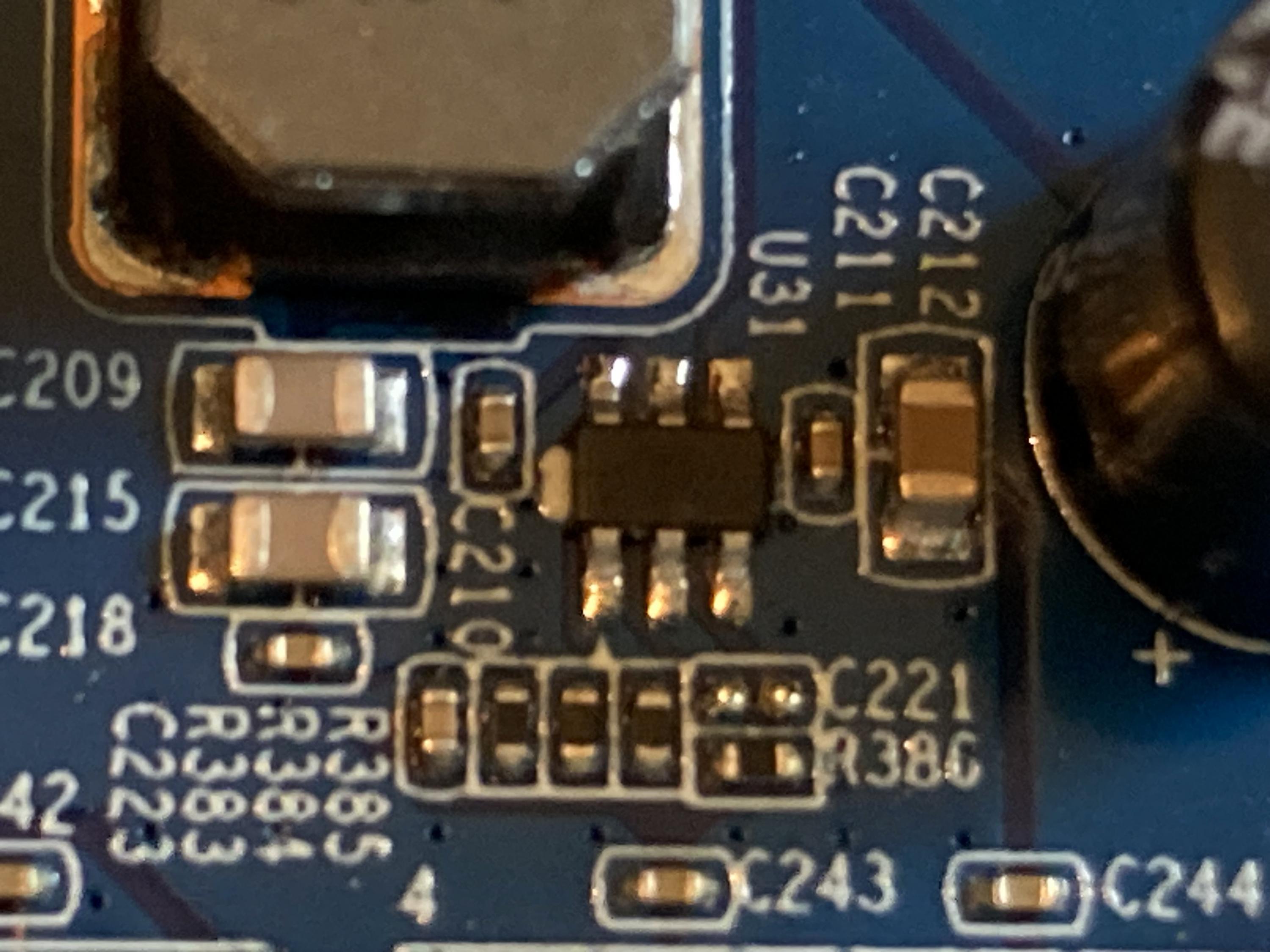

      Thanks Rj. Will check the output pins but pins 4 and 5 have 12v and 5 volts if not mistaken. Will get a better picture up. Thanks.

        Here is a pinout and voltage reading for this ic acquired from another nvr.
        Pin 1 - 0.600vdc
        Pin 2 -11.96vdc
        Pin 3 -0.00
        Pin 4 -12.09vdc
        Pin 5 -5.0vdc
        Pin 6 -8.20vdc
          Re: Invid PN1B-8X8NH Nvr Unknown IC
          I guess that is not the ic, it might be a custom marking? does the other nvr have the same ic top markings?
          What are the ic voltages on the non working nvr?
          Pin 3 seems to be ground, are 2 & 4 connected together? pin 1 looks like a control line?

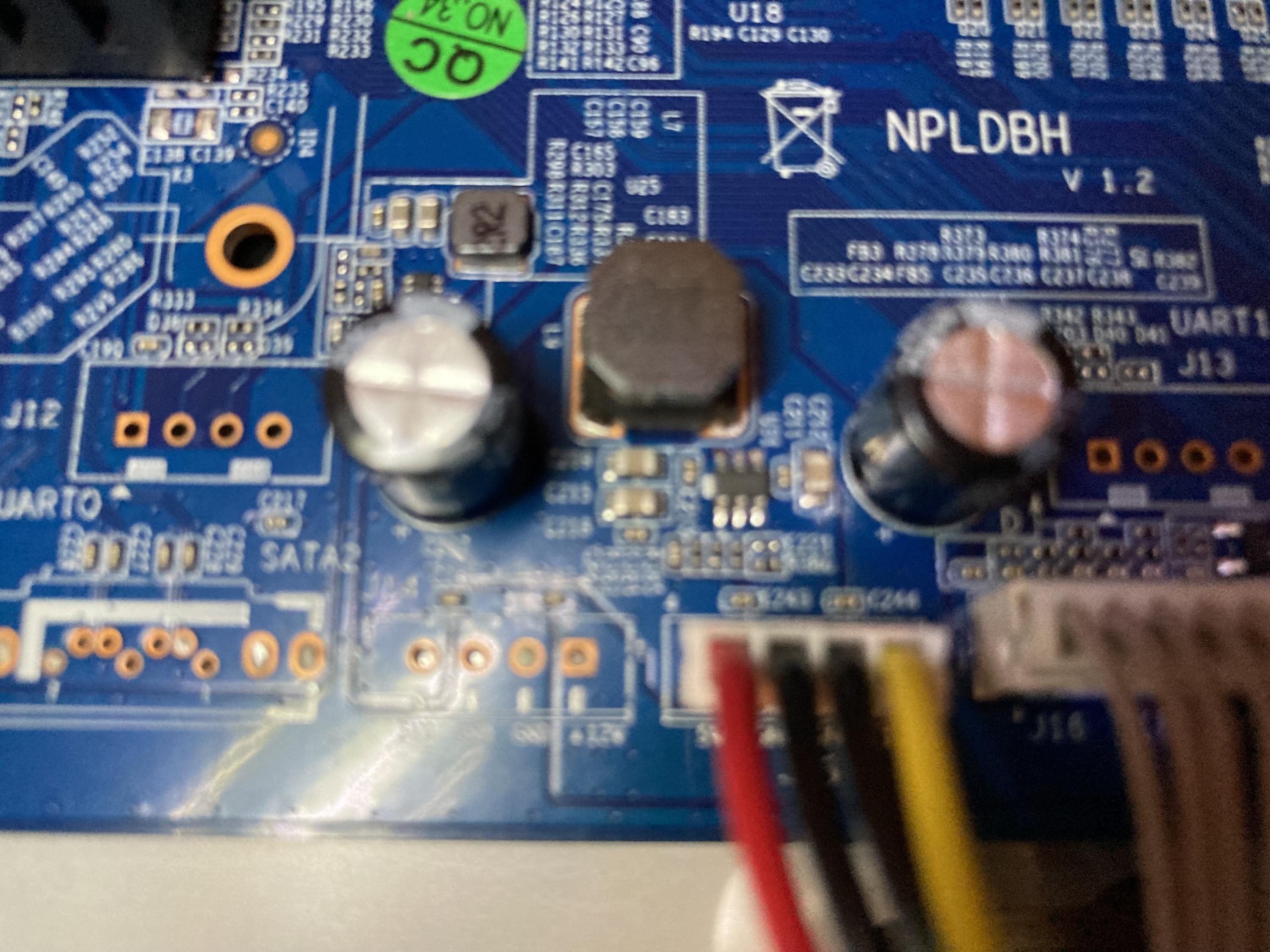

            Actually not Rj. Looks like the other nvr has the marking beginning with NY. It is burned so i cant read the full marking. Same circuit though. This is a pain finding these tiny components while the schematic diagrams are somewhere locked away. Thanks for trying to help.

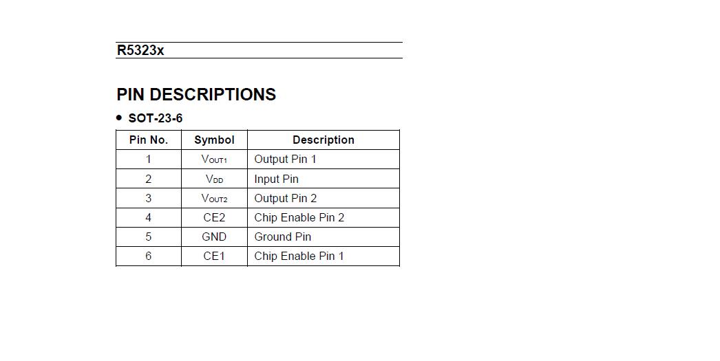

                NY seems to be a Ricoh R5323N030A which has a different pinout

                  Pin out is the same on both boards even though I can't determine voltages on the non working board. Same inductor and capacitors on both boards. Looks like a lot of these markings are cryptic as none of the databases show them. Hard to fix something when components can't be identified.

                    Try and draw out the circuit if you can, then it might make more sense. I can't see where the pins go or what components are connected to it based on that picture.
                      Here are some more pics. Thanks for your assistance.
