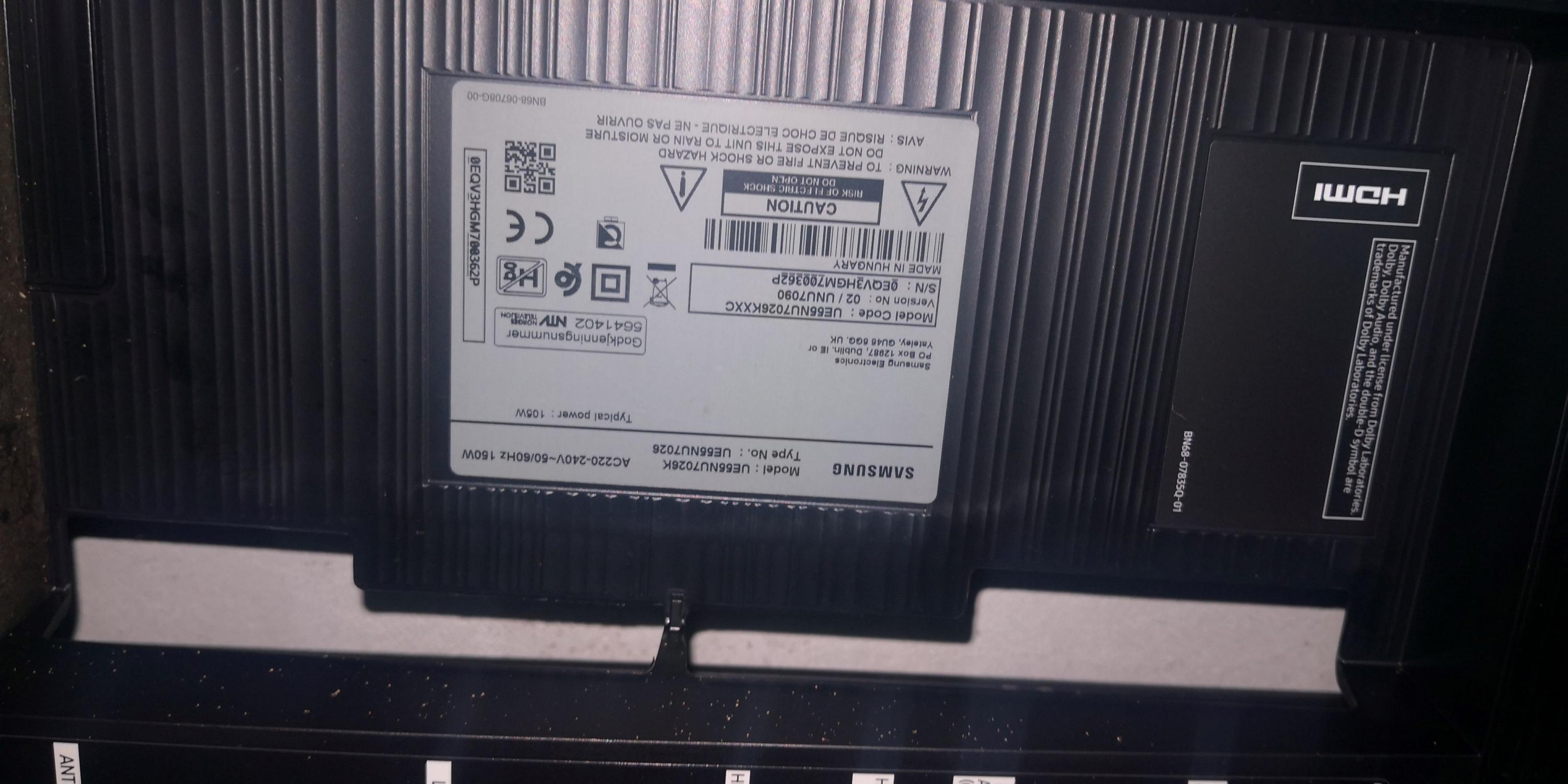

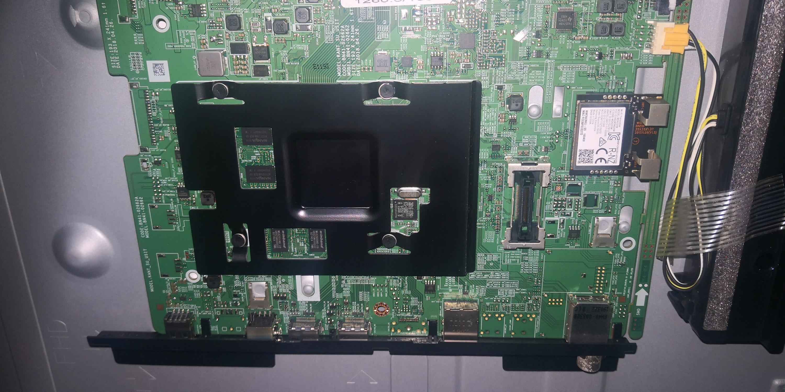

    Hello
    I have one LCD TV SAMSUNG UE55NU7026K and it starts, blink 2 times led, backlight on then about 4 seconds, restart again, but no logo appears on the screen. I disconect the power supply cable to the Mainboard and power is ok and backlight also ok.
    With the mainboard BN94-12869G connect, the voltages are ok, 13 Volts and 3,3 Volts also.
    I know that the problem is mainboard, but could be the software?
    I try to find firmware for this mainboard but can´t find
    Can any one give me some help?
    Thank you

        You need pictures for us. The whole back as a whole and each individual board

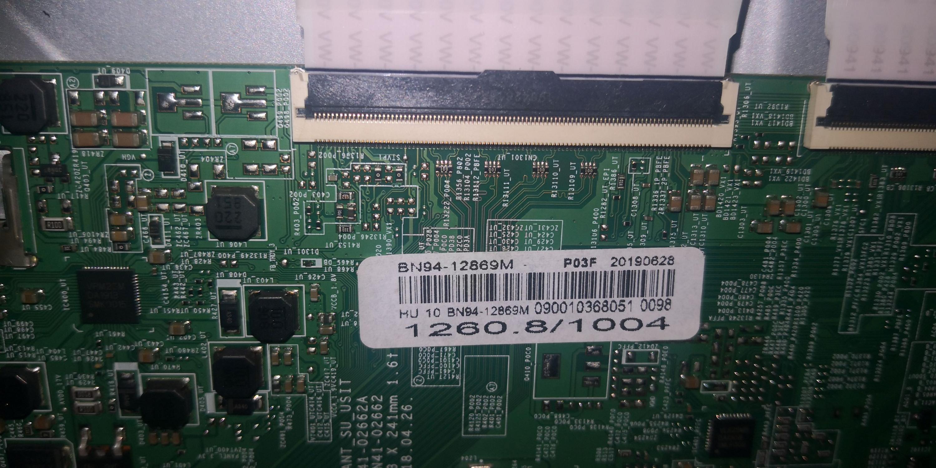

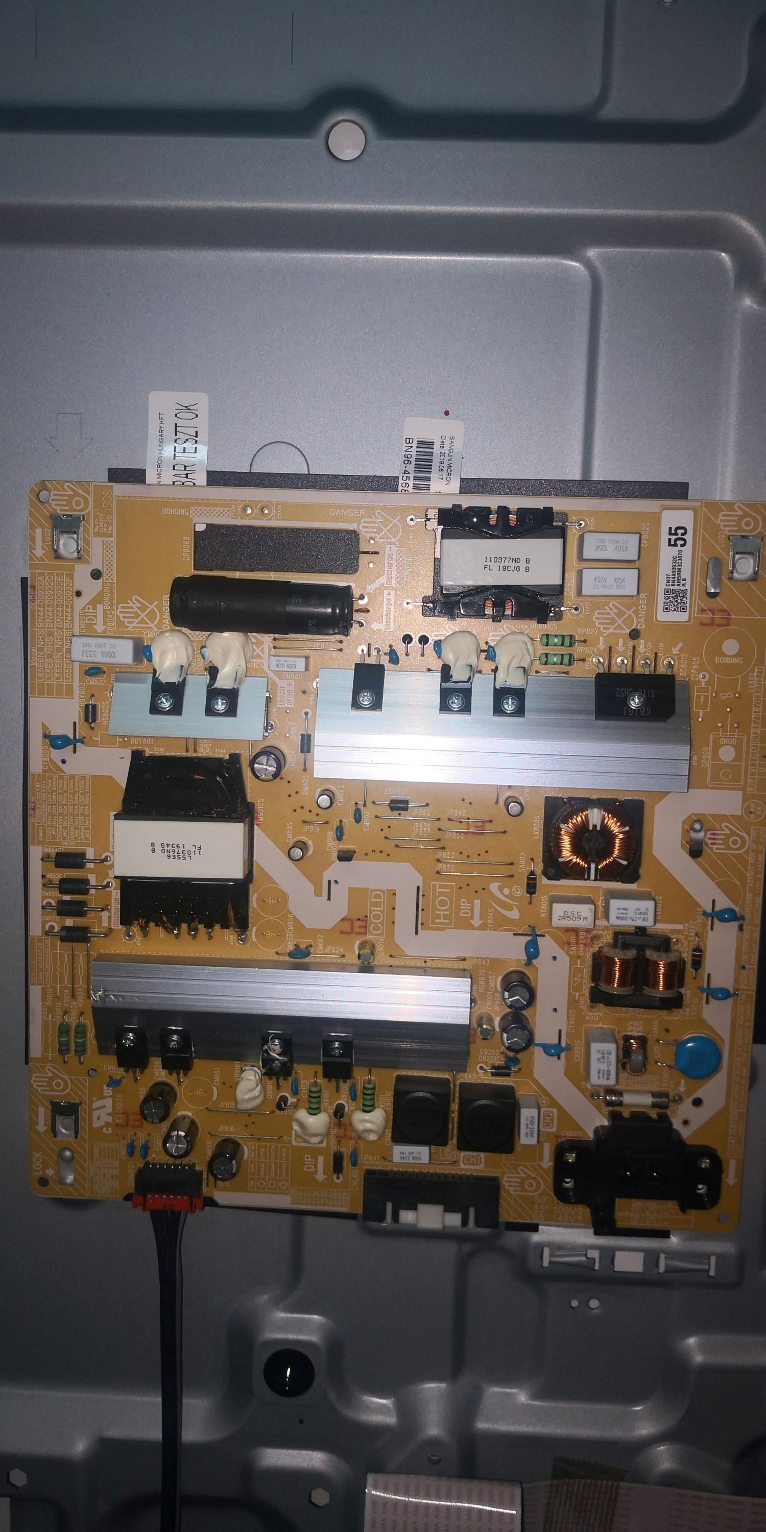

            Re: Samsung UE55NU7026K always restart
            Here the photos from TV
            • lotas
              • Jan 2016
              • 4969
              • Russia
              You have two loops, so that the TV would turn on without these loops disconnected from the panel, you need to put a jumper on the motherboard between the points FB_TRDY_1 and FB_TRDY_3.
              • avalente123
                Avalente
                • Dec 2017
                • 9
                • Portugal
                i made jumper between the FB_TRDY_1 and FB_TRDY_3 but same problem. I will buy a used mainboard for test. Then i wiil write results. i am afraid that panel have something wrong, but need to find
