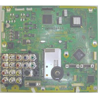

    My folks have a 46" Panasonic Viera Plasma TV. It is slightly more than 18 months old. They have only expanded basic analog cable + clear QAM channels playing through the internal tuner. The problem is that recently about half a dozen channels (no particular order here) have decided to not play any sound. It is always the same channels and yes I did check the other TVs in the house and the problem is not with the cable feed. I was told that once the turner also 'went crazy' and was continually scanning through all the channels without stopping. Apparently a power cycle cleared that up and I have not been able to get it to repeat that.
    I haven't taken apart yet. I am hoping that it is some bad caps
    Has anyone ever heard of this? I did some googling and found some references to tuner problems on panasonic plasmas, but nothing for this model. There was a post over at AVS that talked about upgrading firmwares, gave a link to a site, but that site is now password protected.

    I found the part number of the main board to which the tuner is attached (TNPH0721ASS). Looks like an expensive part. The tuner module (ENGE6608KF) is available separately for ~$50. Would replacing the tuner module on the main board solve the problem with the set? Any tips?

              I came up with the picture from a site selling the main board. Found that based on the model number. At some point I am going to open this thing up to see what is going on. But being a Panasonic, one could assume that it should have Panasonic caps in it. I guess there is only one way to find out for sure.

                Well I finally decided to tackle this one. I got a replacement tuner module for around $50. To make a long story short, I soldered it in there and the problem with some channels not having sound remained.
                So in the normal course of fiddling around, I came across the 'reset' menu. Had to give it a password (don't remember setting one), so I tried 1234 and amazingly that worked. After completing the reset and re-scanning channels, I was amazed to find that the previously soundless channels now had sound. So I solved the problem, but wasted $50 on an unnecessary tuner replacement. If anyone needs an ENGE6608KF tuner module, PM me and I will sell it cheap.
