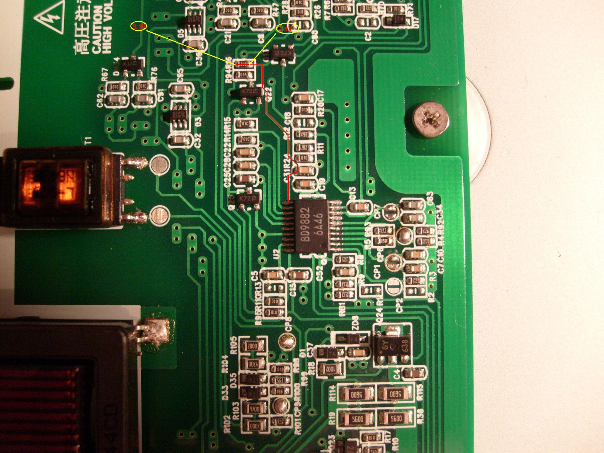

    Okay.... this is what I have found concerning voltages with respect to the BD9882 chip.
    Pin 20 (Vcc) = 9.1V acceptable per spec
    Pin 12 (Comp) = 3.1V unacceptable max is 2.8V
    Pin 11 (STB) = 4.4V unacceptable should be Vcc?
    Pin 13 (Reg) = 3.1V acceptable per spec
    So the question I have ....... is the chip shutting down the CCFL's due to over-voltage detect and why is Pin 11 voltage more or less half of what it should be?
    I don't know if I am on the right track or somewhere out in left field.

      Many inverter controllers are turned on / off by turning the power to them on and off. The sample schematic does that. This chip also has an on / off input -STB. The datasheet says that if STB is below .8 volts the controller shuts down the outputs, and turns them on when the STB input goes over 1.8 volts. The maximum allowable voltage on STB is Vcc. So that voltage is not a problem.
      You are correct, Comp is too high; that's what's shutting the inverter down. I've spent the last 15 minutes staring at schematics and datasheets. IF the sample application note is correct, that would appear to be triggered by the output voltage being too high, but more studying is required.

        One more point. Earlier I had you take pictures of the components between the transformers. I notice one picture shows DN2 and DN3; I suspect there are also DN1 and DN4 - DN8. What are the making codes on those diode nets?
        PlainBill

          KJJ T9 is the marking code on all of the "DN" diode sets on this board.

            OK!!! That's the BAV70 configuration. The first test is easy. I usually think of these diode packs as oriented with the two pins on the 'bottom' and the single pin at the 'top'. (Sort of like one of the objects from Space Invaders'). Are the 'top' pins on the DN1-DN8 diode nets all connected together? If they are not, stop here.
            The next step might be a little more complicated. Can you trace pin 11 from the inverter controller to the source holding it at 4.4 volts? This is probably a pair of resistors. Is anything else tide to the junction of these resistors? IF this seems to be an isolated point, you should be able to cycle the inverter by momentarily grounding pin 11 of the controller. (It will be easier if you momentarily ground the junction of the resistors). If you can't be sure, stop here.
            Is the top of the inverter exposed when it is installed in the TV? If so, the next test should be relatively simple. Rig two short (12" max) wires with probes at one end. Either leave the other end bare of attach a mini-gator clip. Ground the bare ends of both wires to one of the mounting screws for the inverter. With the TV on, use one probe to ground one of the 'bottom' pins of DN1. Now use the other probe to momentarily ground pin 11 of the controller. Do the CCFLs stay on? If not, move the first probe to the second pin of DN1. Repeat cycling the inverter by momentarily grounding pin 11. If the CCFLs still won't stay on, repeat with DN2, DN3, etc.
            PlainBill

              Per the attached pic, backtracking the trace at Pin 11 leads me to a resistor that is holding the voltage at 4.4V.
              Does this mean that this resistor is the culprit or
              Additionally, grounding either bottom pin of any DN component as well as momentarily grounding Pin 11 results in the CCFL's coming on for about three seconds then promptly shutting down.

                  Re: Samsung LN-S3251D Black Screen
                  No, I don't think the resistor is the problem. I think they used a voltage divider for multiple pirposes - note that there is another trace running from the 4.4 volt end of the resistor. Odds are that runs to another resistor, the other end of which is tied to ground. And the odds are at least one other point is tied to it.

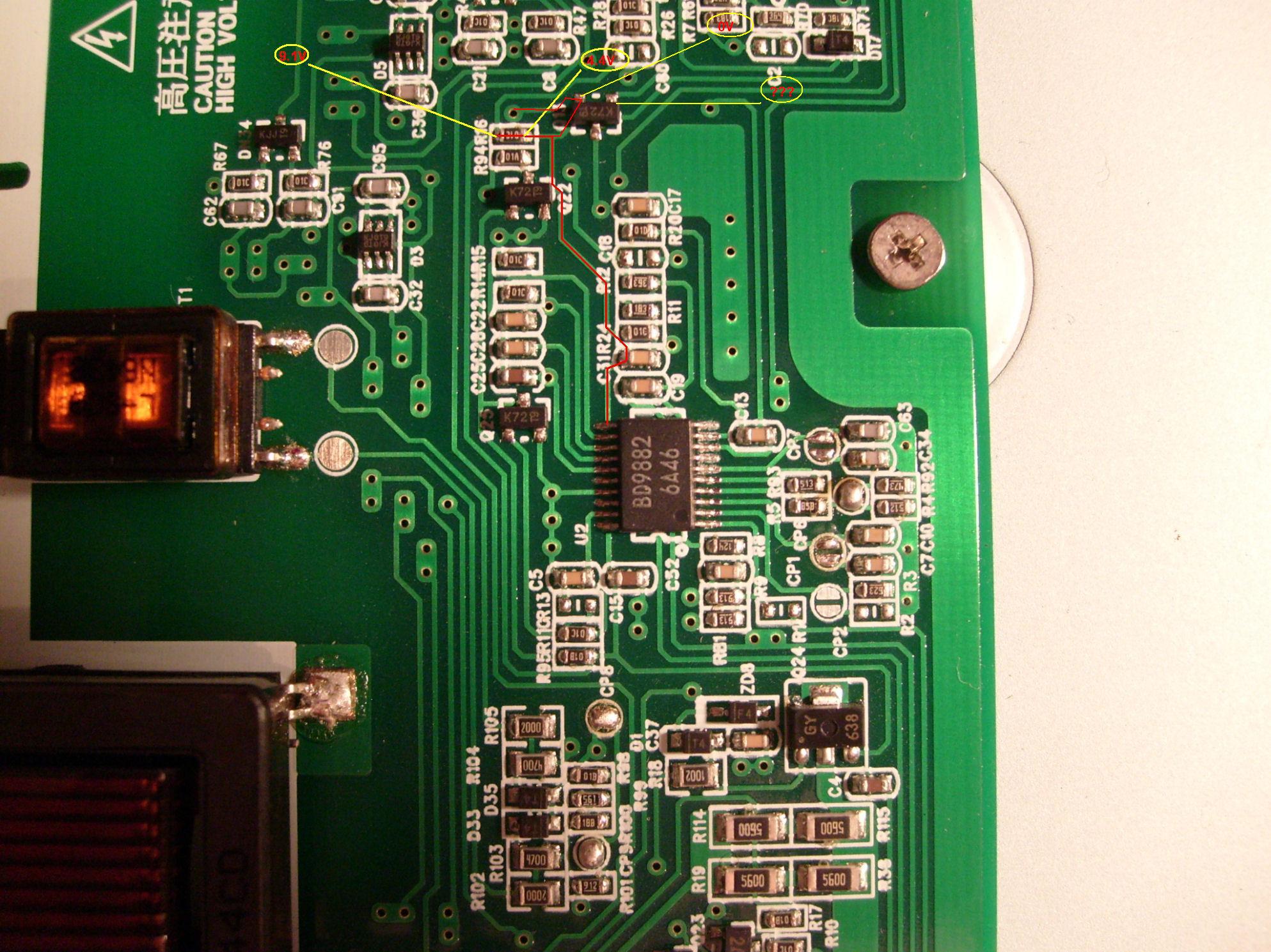

                    #29
                    I've modded the last pic to reflect the latest measurements, etc.
                    I have no idea what type of component is K72 T9 so I don't know what to make of the voltage reading.
                    And where did the 4.7V go?

                      #30
                      A more clarified pic.
                      Still as to the disappearance of almost 5V.
