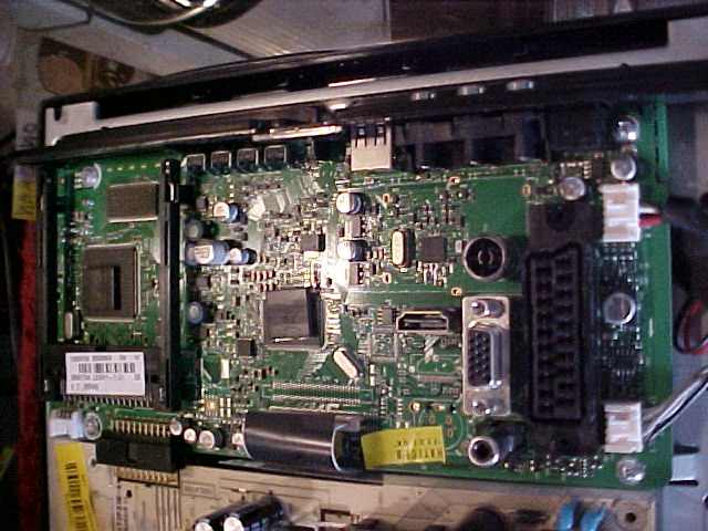

    I use this as a 19 inch CCTV monitor,via the SCART socket.
    Last night after power up, worked for a few seconds,then shut down.
    Standby light flashing orange and a chirp from the power supply transformer.
    Normal standby is blue,power on is orange.

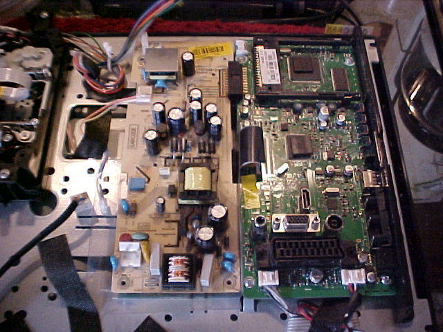

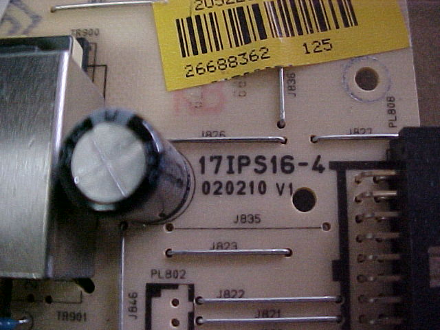

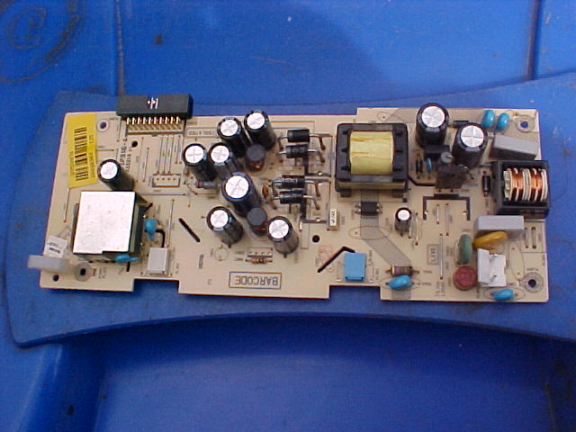

    Power Board is Vestel 17ips16-4 version 20522876.

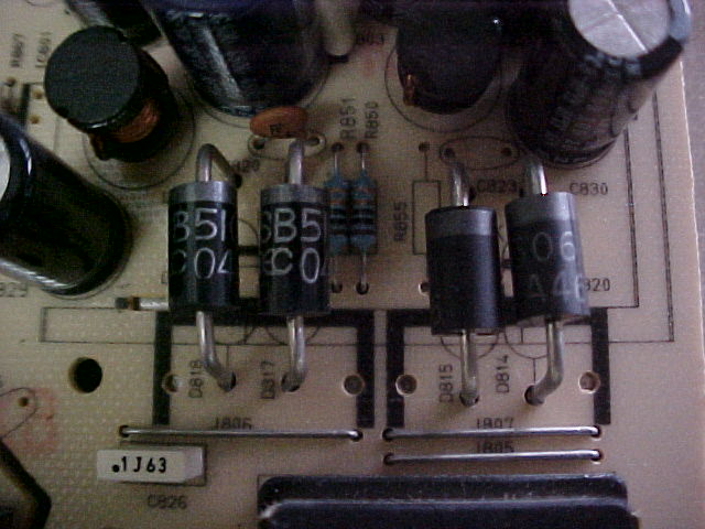

    Checked diodes D814,D815,D817,D818 and startup cap C807 33UF/50V all OK.

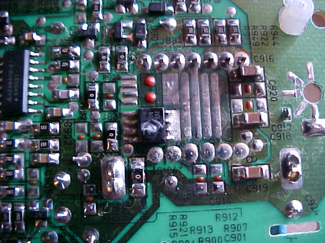

    Wisp of smoke from 8 pin smd chip near CCFL back-light driver transformer.
    On power down and power up, TV will go to standby and power up with no back-light.
    Evidence of Menu on screen seen albeit lit by a torch.
    Question.
    Could the CCFL arrays be faulty?, if so is there a way to test them with a power supply and if so what voltage?
    I test LED backlights via a 30 volt DC power supply,so straight forward.
    Obviously the power board is visually faulty,are these still available?
    Don't have access to rework SMD devices.
    Cheers
    Steve

    Re: Agora AGR-19-822-COB, Backlight Fault
    IC102 (FSD8962C)

      Managed to download schematic for power board.
      IC102 listed as FDS8962C
      Can you confirm type number?

        Have ordered some FDS8962C chips which are complimentary pair mosfet packages.
