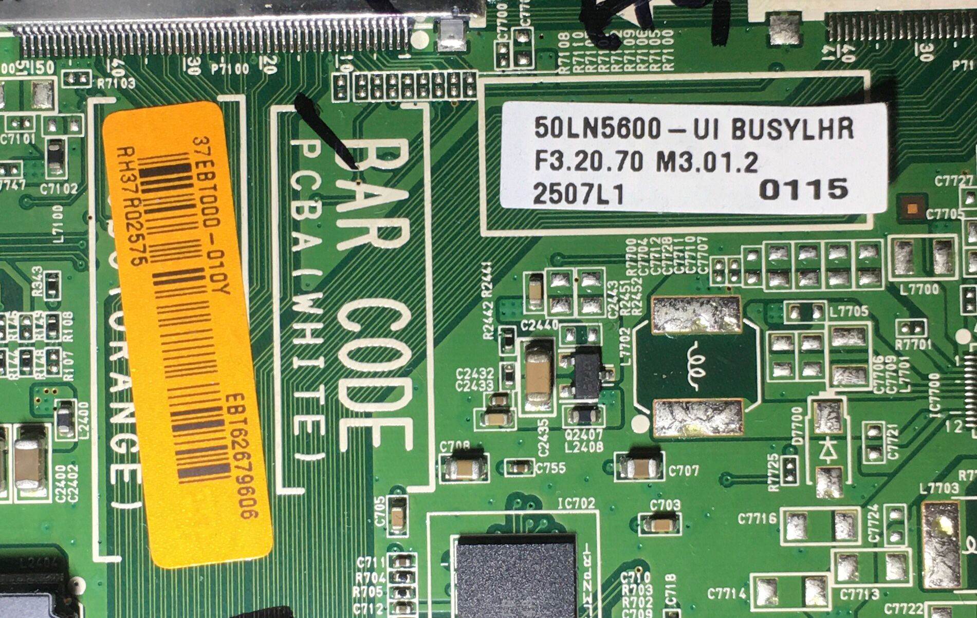

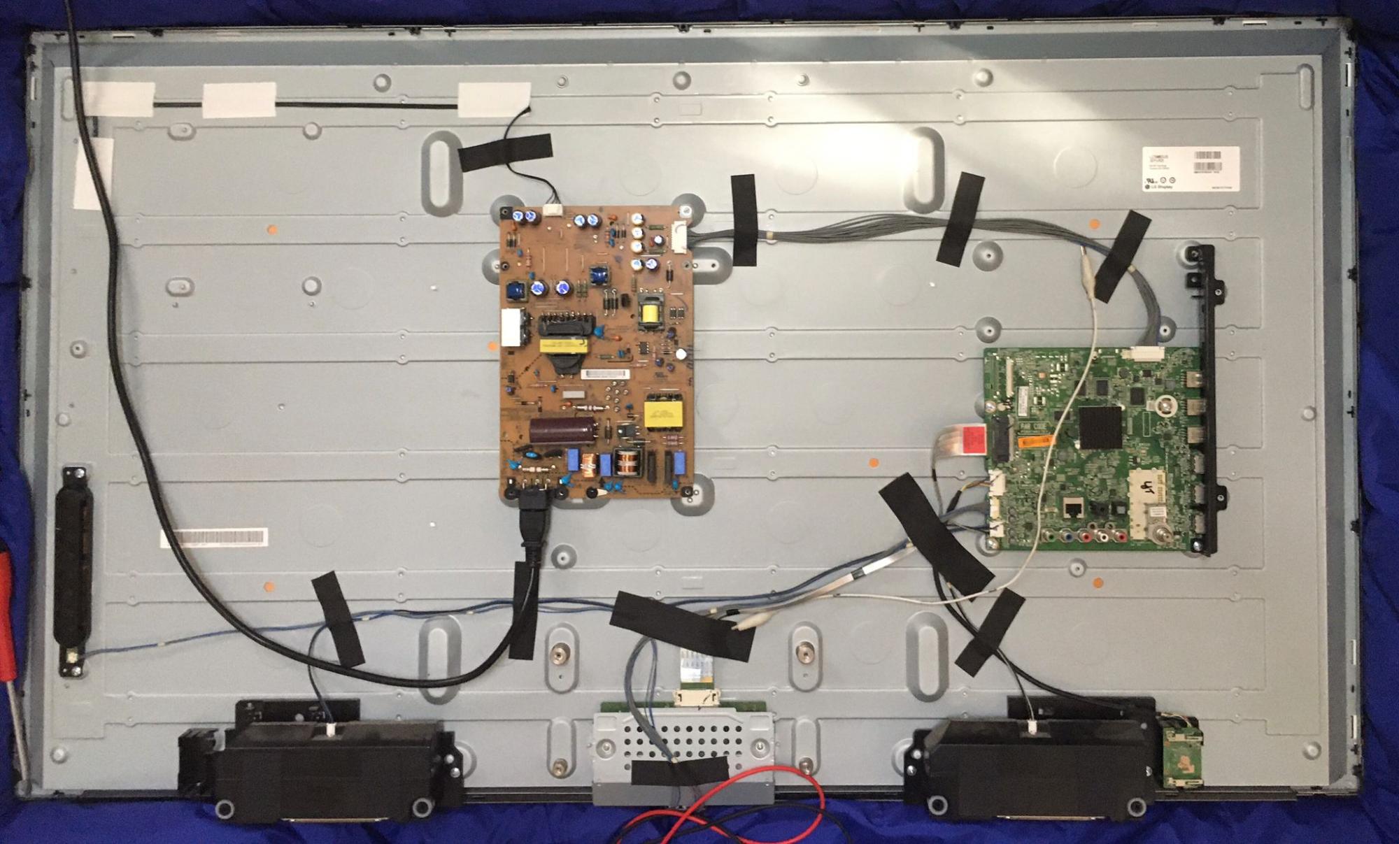

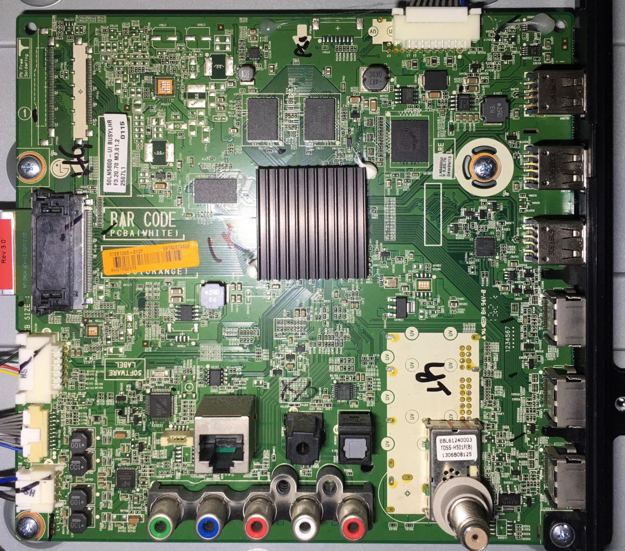

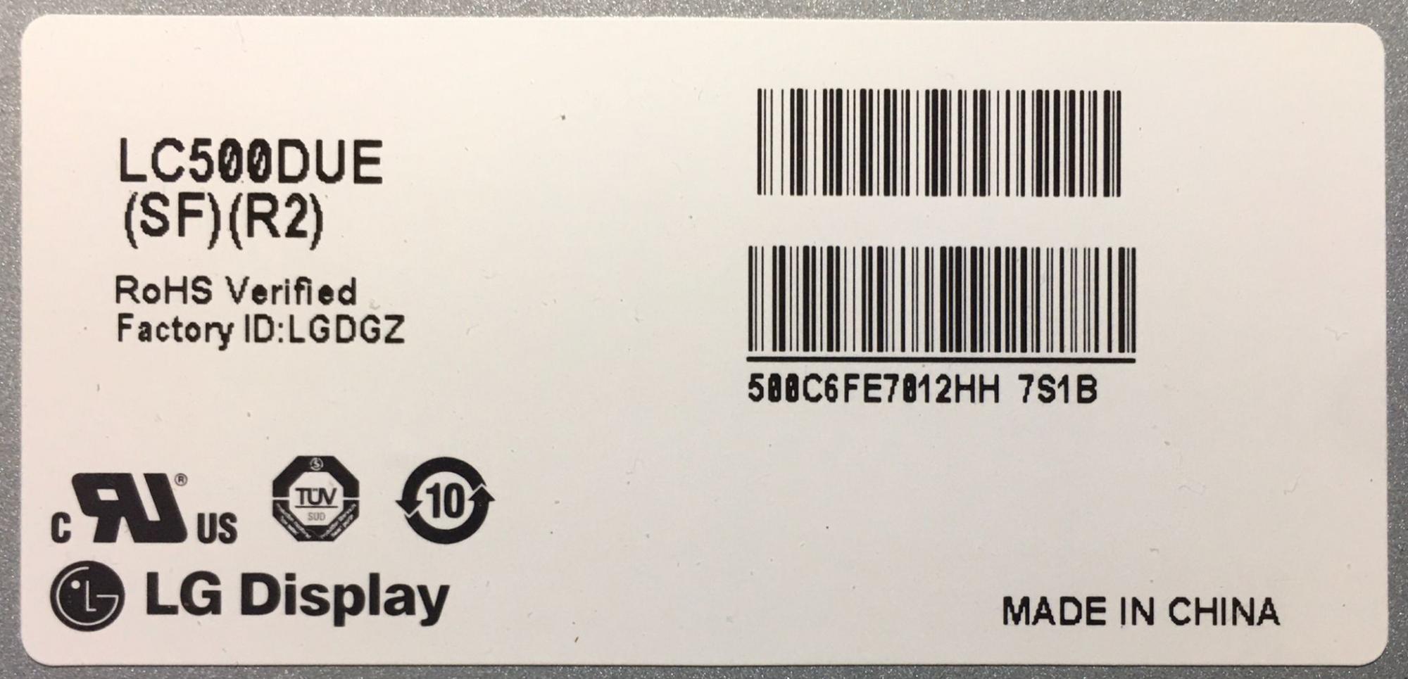

    This 50 inch LG LED (LCD) TV was given to me not working. Powering it on, the logo flashes once for 1/4 second then black. Front panel red LED blinks 3x (I think... see below) then the LED turns off. TV stays on until I press the Power button again. There is an image on the LCD panel--I press the "Settings" button on the TV and this brings up menus I can see with a flashlight / torch.
    (The front panel red error code LED blink sequence is a bit confusing to me. The LED is on when the TV is off. I press the Power button and the LED *very briefly* goes off--maybe 1/10 second--then goes on-off-on-off-on-off and stays off as long as the TV is powered on. I guess this is 3 blinks?)

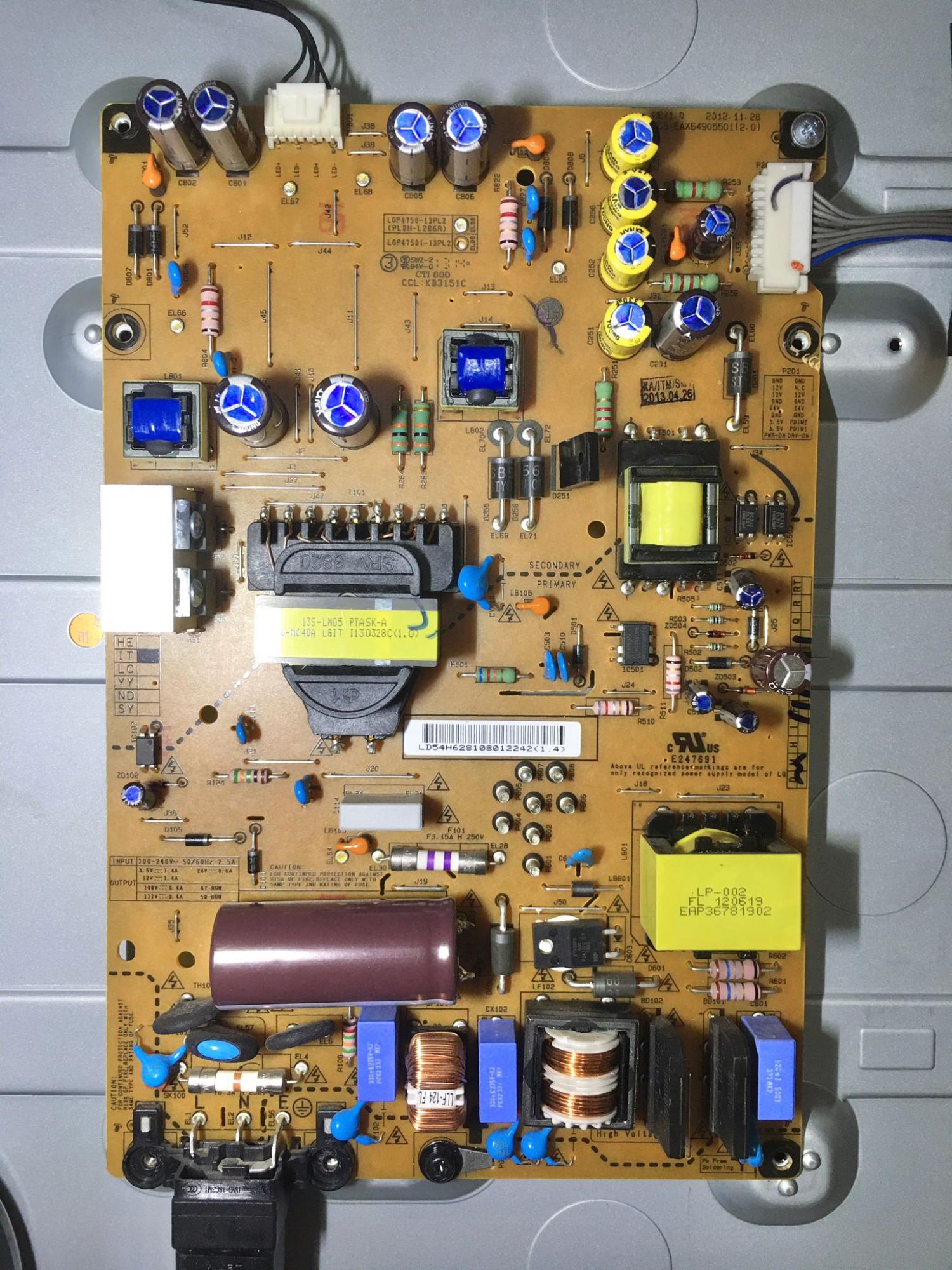

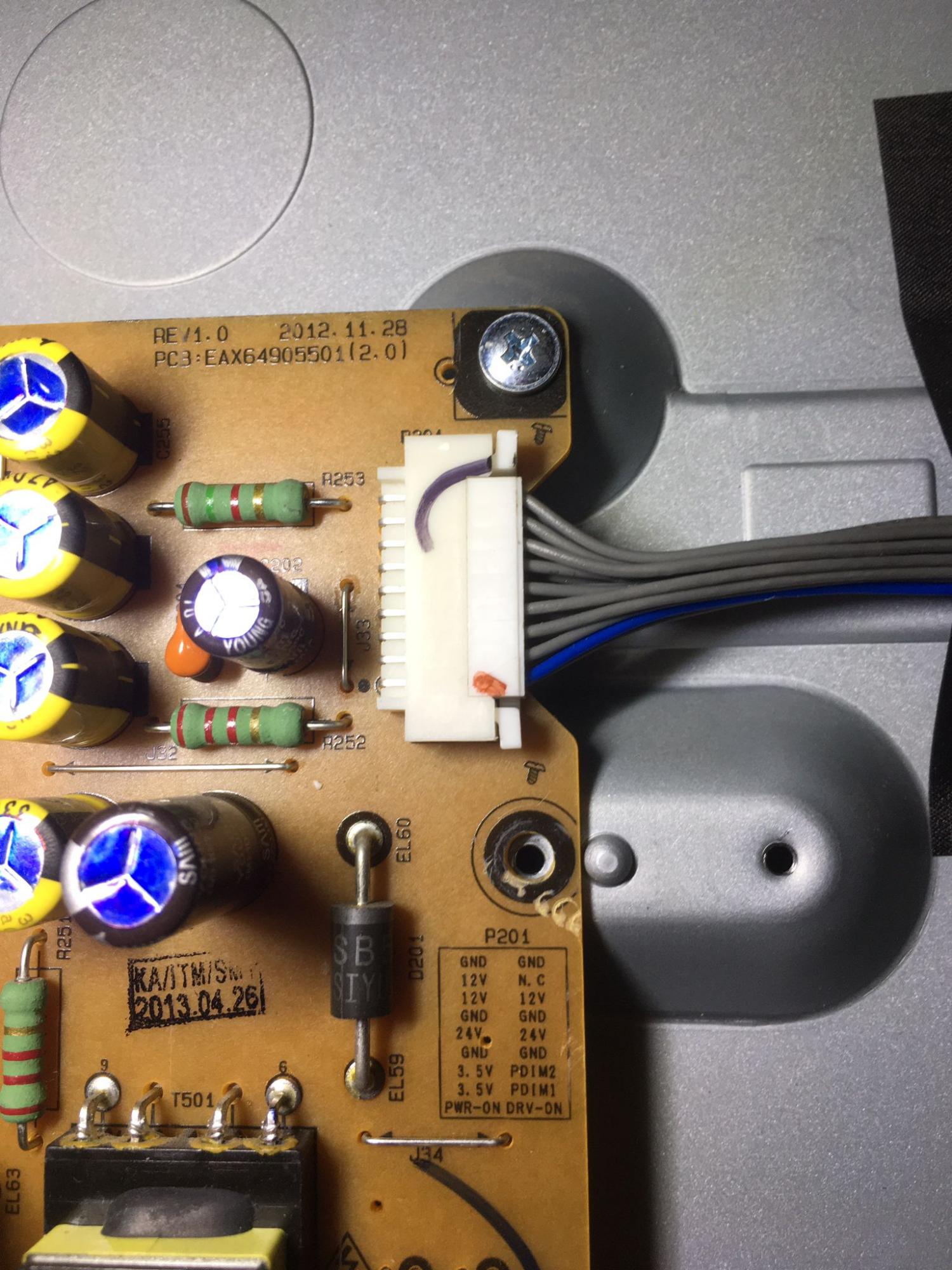

    Voltages at the PS board output connector are all present and correct.
    Measuring the backlight output connector on the PS board (with cable to the backlight connected), I back-probe the cable connector, choose MAX setting on the meter, and press the TV Power button. I get a maximum reading as the backlight LEDs flash, then a minimum reading after they turn off:
    pins 1-2: 74v max, dropping down to 4v.
    pins 3-4: 114v max, dropping down to 4v.
    I found 2 electrolytic caps on the PS board that measured ESR out of spec: a small 47uF/100v; and the HV 100uF/450v (which I replaced with a 270uF/450v that I had on hand). Is that 270uF OK in place of the 100uF? Or is it important that I find a direct replacement? The 270uF is a Cornell-Dubilier. The voltage measured across the cap is 395vdc.
    So that's the history. Do these symptoms point to simply bad backlight LED strips?
    Also, where to get a service manual for this?
    Thanks for reading.

    Re: LG LED (LCD) TV 50LN5600-UI flashes logo, red LED 3x blink
    LED BL issue
    • jojo88
      • Jan 2013
      • 11
      Originally posted by Diah
      LED BL issue
      Yes, but is it a fault in the BL protection circuit (for example) or bad LED strips?
      • Diah
        • Feb 2013
        • 6532
        to clear yours questions ... you need take the screen a part.
