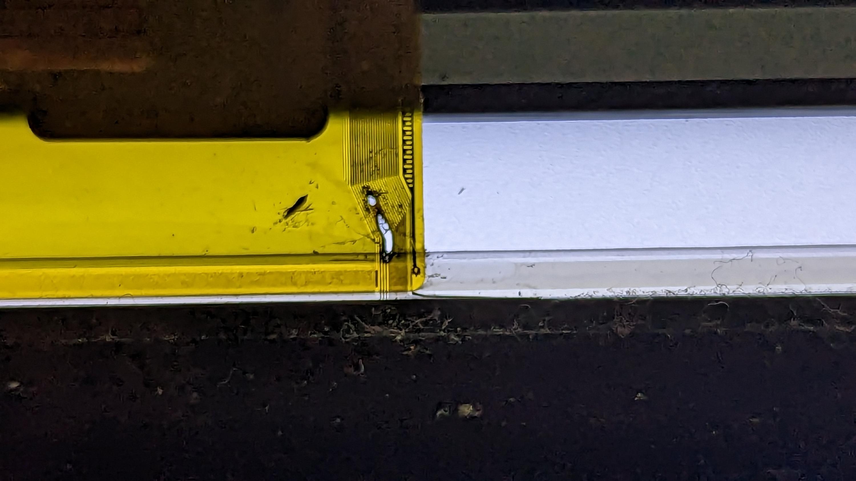

    i just spent quite a few hours trying almost everything i could find out to check why this panel wasnt working.
    MB was detecting a fault and going into fault mode.
    i could se the AVDD go high for a second then drop to off.
    check all CAPs and diodes on bottom buffer boards.
    in the end i gave up and removed the panel, only to find burnt tracks on the cof tab..
    i learnt a lot in the process, but wont go doing all those checks first next time.
    so word of advice... if your panel is suspect, save youself a few hours and check the tabs first.!
