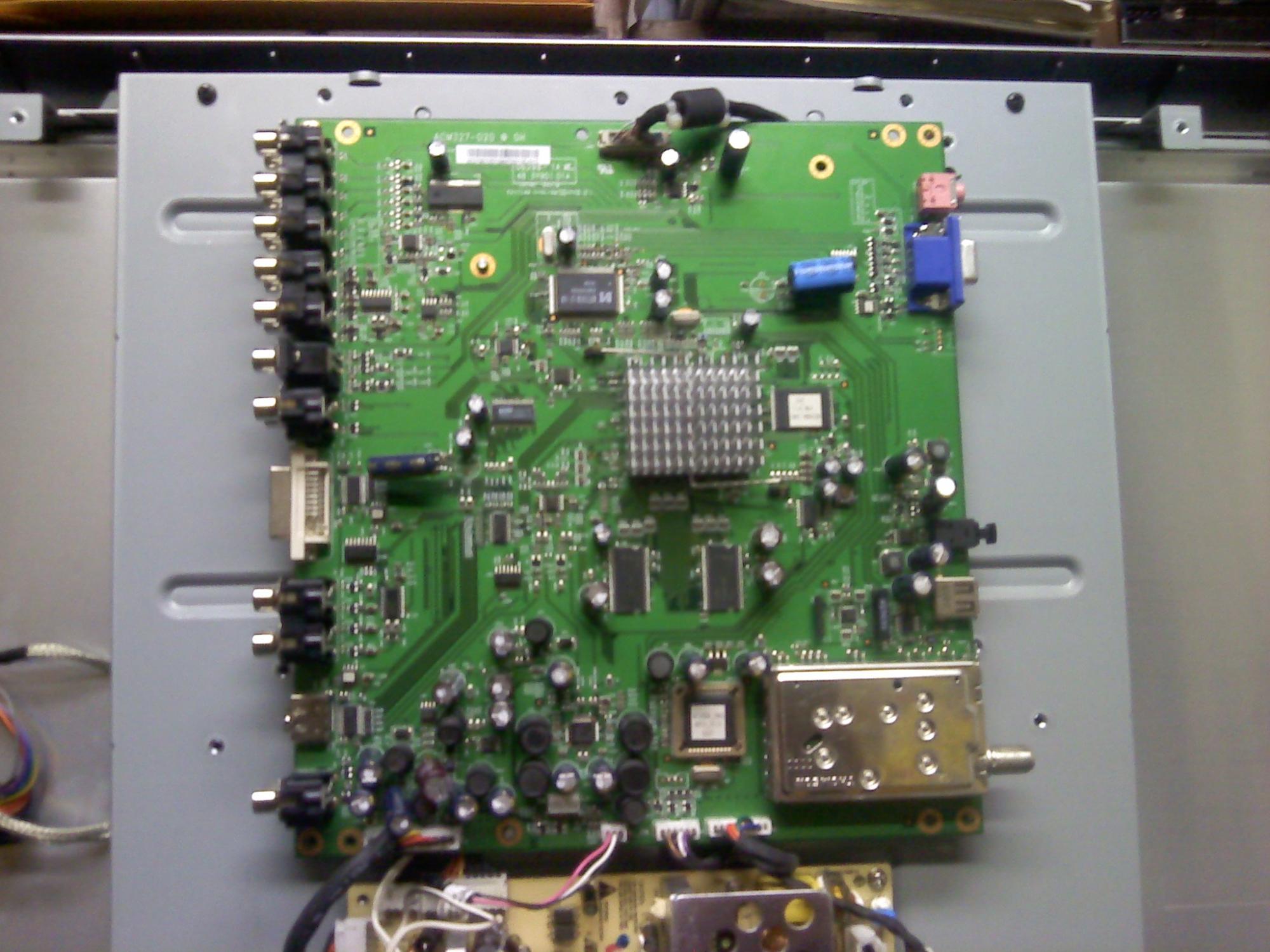

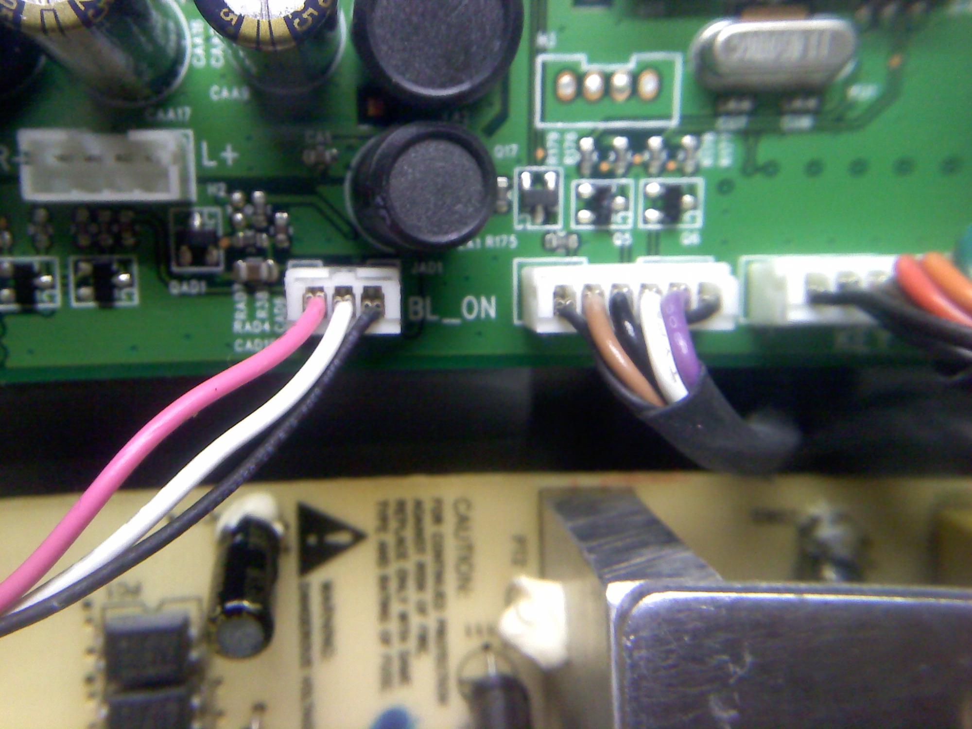

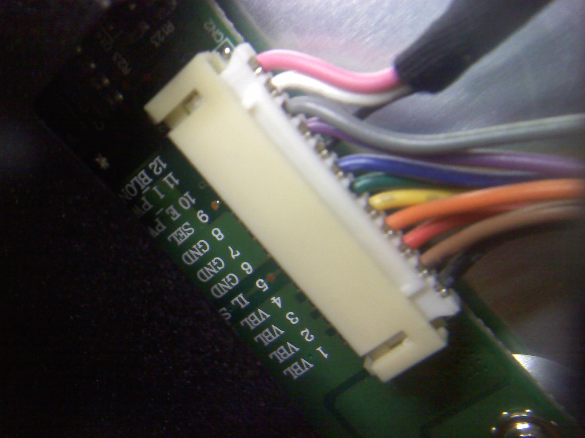

    Hey fella,s Can any one tell me how to force on the back light inverters on this main module.The power supply is up and running

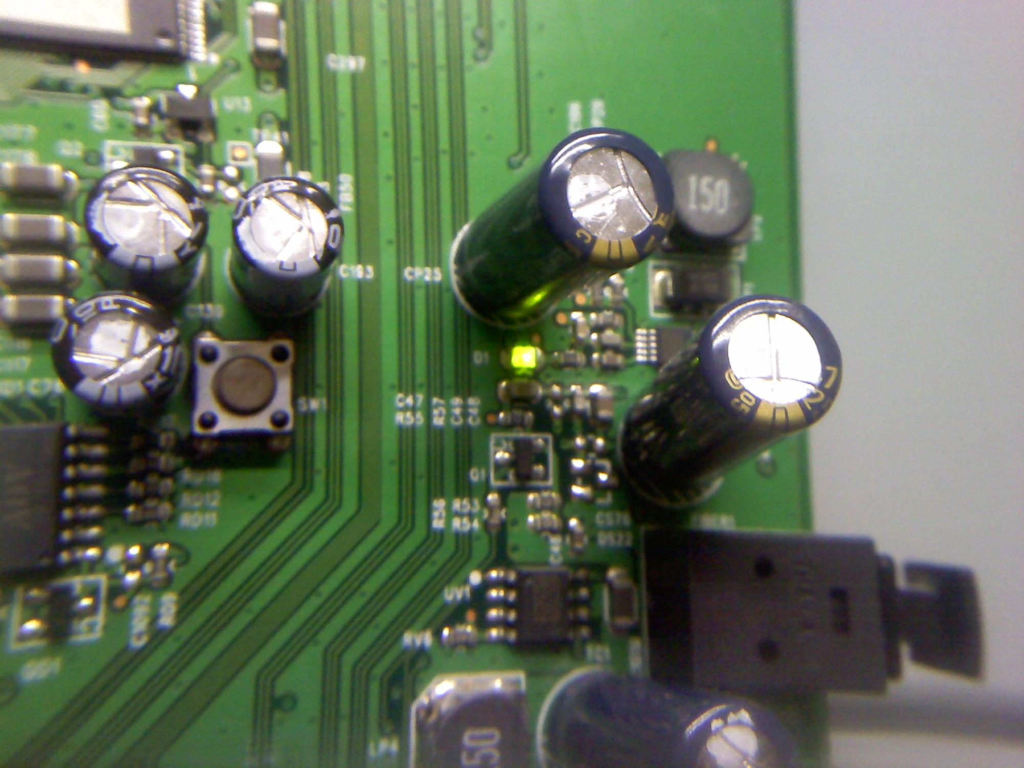

    I have no pix, no menu, no sound. The off/ on function does change states. But with a 20 second delay (the power LED on keyboard and LED on the chassis go off and on) I have physically removed and checked all electrolytics (all good)
    I did find one open surface mount fuse on the 5volt sw line. There is a tac sw on the main module and what appearers to be a plug in bois chip
    Shop jimmy has the main module for $139.90 thanks

    Update my westing house lcd tv is working!!!
    It took 3 replacement main modules from shop jixxy to get it going all the modules turned on and off.The ic's got warm but no, back light,pix,sound.
    I guess the reset button in the previous post is to reset the bois/ firmware.
    I do have 1 question, when the tv is on the blue tight is on. when the tv turns off the blue led turns yellow for 1 hour then go out.Iis this normal? the tv takes a couple of seconds longer to turn on when the light goes out.

      It sounds like it has two modes - standby, and sleep. There may be a significant difference in power used between the two 'off' modes. And there might be a menu setting to cover this.
