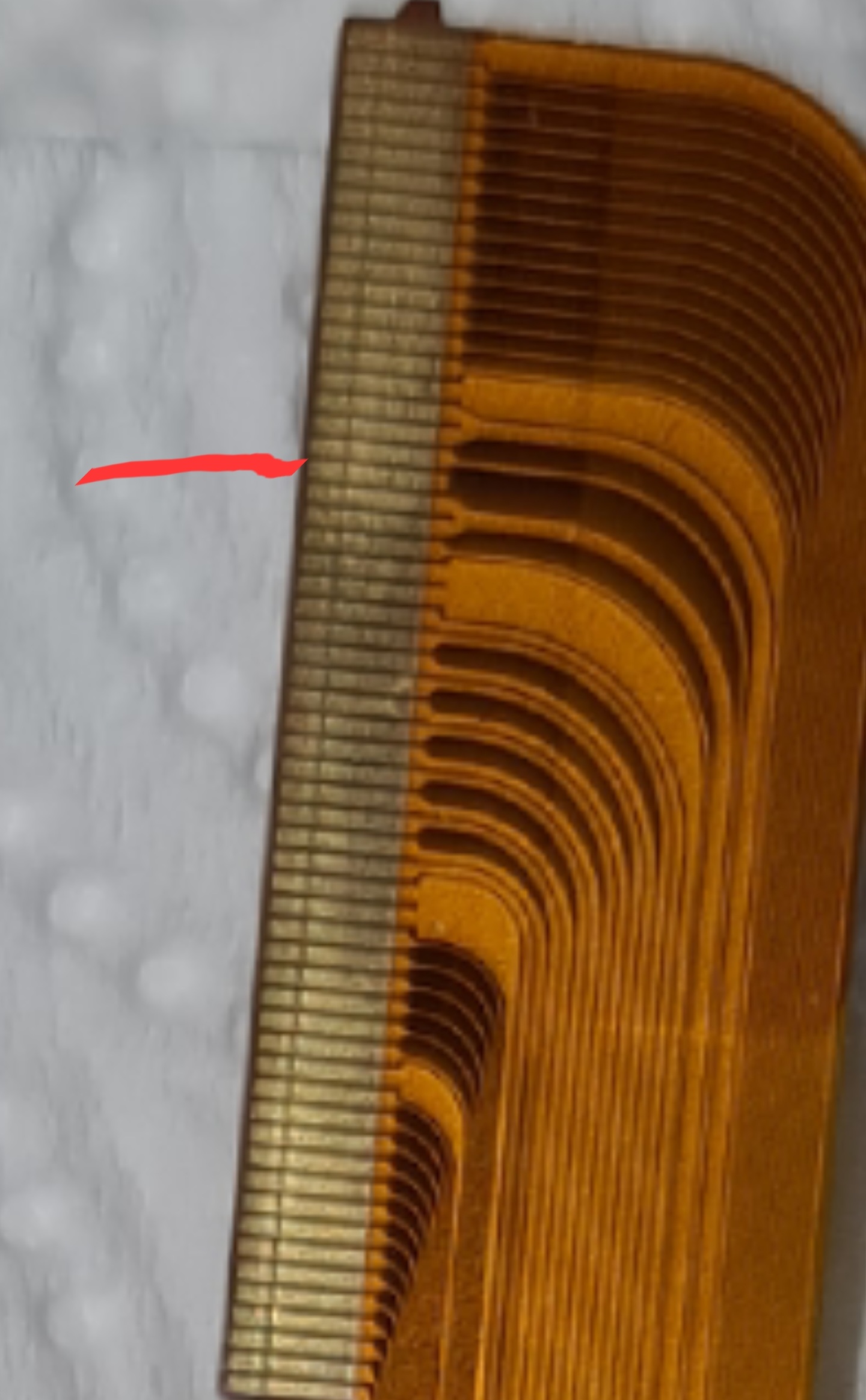

Samsung 65" UE65TU7000KXXU VER:02/UTU7000 TV Blue screen
  • gbbradshaw
    replied
    Re: Samsung 65" UE65TU7000KXXU VER:02/UTU7000 TV Blue screen
    Originally posted by lotas
    This photo also shows that this pin is a dummy, there is no conductor. (copper conductor inside yellow)
    I thunk you are right. Since none of the cables (lvds, u ribbon) seems to be damaged, I have taken the risk and bought the pcb board off ebay. I will update this post as soon as I get it changed and hopefully fixed. Thanks to all for involving and helping.
    Leave a comment:
  • lotas
    replied
    Re: Samsung 65" UE65TU7000KXXU VER:02/UTU7000 TV Blue screen
    Originally posted by gbbradshaw
    Is it really? I am no professional so I might be wrong. Can you confirm looking at this picture please? Thanks
    This photo also shows that this pin is a dummy, there is no conductor. (copper conductor inside yellow)
    Leave a comment:
  • gbbradshaw
    replied
    Re: Samsung 65" UE65TU7000KXXU VER:02/UTU7000 TV Blue screen
    Originally posted by Diah
    this is wrong theory... never being 2 U ribbon defect at same area.... your eyes are tired.. i wrote don't trust your glasses.. only magnifier or telescope can see if there are wrong with pins.
    or you bought this TV as it is now !!!..
    from the photos you posted before we can see the U ribbon cable both side look like larger than original they didn't sitting normally flat.. but there curve and this should never happened with U ribbon. .. they should Flat connected between the tow parts if panel side buffer boards.
    I have no idea how these ribbon cable should be inside the tv, you definitely have more experience than I do. If I bought the tv as it is, that's for sure, I haven't touched it before developing this issue. Then I believe it might have been fixed before as when I bought it , it wasn't brand new. I will look for a magnifier and go over them again.
    Leave a comment:
  • gbbradshaw
    replied
    Re: Samsung 65" UE65TU7000KXXU VER:02/UTU7000 TV Blue screen
    Originally posted by lotas
    But the photo shows that this pin is a dummy, there is no conductor.
    Is it really? I am no professional so I might be wrong. Can you confirm looking at this picture please? Thanks
    Leave a comment:
  • Diah
    replied
    Re: Samsung 65" UE65TU7000KXXU VER:02/UTU7000 TV Blue screen
    Originally posted by gbbradshaw
    It should, but at least one of the u ribbon should be good, while both of mine have that highlighted pin not connected to each other. We can see from the picture that the highlighted area shows a thicker connection between the pins, which I think it's meant to lead power between them. What i think is that The lvds delivers the power to the lower board and from there, the u ribbons are supposed to take it to the display. Does that make any sense? I can't find a better explanation.
    this is wrong theory... never being 2 U ribbon defect at same area.... your eyes are tired.. i wrote don't trust your glasses.. only magnifier or telescope can see if there are wrong with pins.
    or you bought this TV as it is now !!!..
    from the photos you posted before we can see the U ribbon cable both side look like larger than original they didn't sitting normally flat.. but there curve and this should never happened with U ribbon. .. they should Flat connected between the tow parts if panel side buffer boards.
    Leave a comment:
  • lotas
    replied
    Re: Samsung 65" UE65TU7000KXXU VER:02/UTU7000 TV Blue screen
    Originally posted by gbbradshaw
    Update: The lvds is perfectly fine, I have tested it with the beep test (continuity) every pin.
    What I have found out is that on both of the ribbon stripes CSF01, the pin highlighted in the picture did not pass the beep test, on both of them there is no continuity. Could this be it? Please see the photo.
    But the photo shows that this pin is a dummy, there is no conductor.
    Leave a comment:
  • gbbradshaw
    replied
    Re: Samsung 65" UE65TU7000KXXU VER:02/UTU7000 TV Blue screen
    Originally posted by gbbradshaw
    Is this the right way to do it? Please check the picture
    I know that if the caps beeps when I use the multimeter, in most occasions its a bad capacitor.
    I also know that if I set the multimeter to 20k to check the ohms and the value is not going from 0 to higher, that's also a bad cap.
    Correct / guide me if I am wrong please. Thanks
    Originally posted by Diah
    i wrote on my first post #26
    but if you remove the U ribbon... the tv should wrok normal only 3/4 Screnn
    It should, but at least one of the u ribbon should be good, while both of mine have that highlighted pin not connected to each other. We can see from the picture that the highlighted area shows a thicker connection between the pins, which I think it's meant to lead power between them. What i think is that The lvds delivers the power to the lower board and from there, the u ribbons are supposed to take it to the display. Does that make any sense? I can't find a better explanation.
    Last edited by gbbradshaw; 02-22-2023, 04:43 PM.
    Leave a comment:
  • Diah
    replied
    Re: Samsung 65" UE65TU7000KXXU VER:02/UTU7000 TV Blue screen
    i wrote on my first post #26
    but if you remove the U ribbon... the tv should wrok normal only 3/4 Screnn
    Leave a comment:
  • gbbradshaw
    replied
    Re: Samsung 65" UE65TU7000KXXU VER:02/UTU7000 TV Blue screen
    Update: The lvds is perfectly fine, I have tested it with the beep test (continuity) every pin.
    What I have found out is that on both of the ribbon stripes CSF01, the pin highlighted in the picture did not pass the beep test, on both of them there is no continuity. Could this be it? Please see the photo.
    Leave a comment:
  • gbbradshaw
    replied
    Re: Samsung 65" UE65TU7000KXXU VER:02/UTU7000 TV Blue screen
    Originally posted by Diah
    in case the LVDS all PIns are fine same long.. no one short than others.... then put it back carfully..... put the TV in stand by by remote.... after TV in standby mode push with remot this pne afte other
    INFO --- MENU-- MUTE--- POWER ( this is service menu = in case it show to you service menu.... dont do any things just plug it out from wall socket... same case if the screen show blue..... just plug it out from walll and try again..
    its possible because the first time you put U ribbon not correct.... the MB change mode... hope this will help.
    Thanks dude ! I will definitely try this now. By the way , if I cast YouTube from phone to tv, the music starts so I think this source should have worked , right?
    Leave a comment:
  • Diah
    replied
    Re: Samsung 65" UE65TU7000KXXU VER:02/UTU7000 TV Blue screen
    my last post because football champion league.... you must feed the TV with signal and you can hear sound.... some TV if no signal will turn blue screen. LOL
    Leave a comment:
  • Diah
    replied
    Re: Samsung 65" UE65TU7000KXXU VER:02/UTU7000 TV Blue screen
    in case the LVDS all PIns are fine same long.. no one short than others.... then put it back carfully..... put the TV in stand by by remote.... after TV in standby mode push with remot this pne afte other
    INFO --- MENU-- MUTE--- POWER ( this is service menu = in case it show to you service menu.... dont do any things just plug it out from wall socket... same case if the screen show blue..... just plug it out from walll and try again..
    its possible because the first time you put U ribbon not correct.... the MB change mode... hope this will help.
    Leave a comment:
  • Diah
    replied
    Re: Samsung 65" UE65TU7000KXXU VER:02/UTU7000 TV Blue screen
    yes the white one are LVDS take it out from both side and inspect all pins carfully
    Leave a comment:
  • gbbradshaw
    replied
    Re: Samsung 65" UE65TU7000KXXU VER:02/UTU7000 TV Blue screen
    Originally posted by Diah
    in this case... take out the LVDS and with yours mobile camera or magnifier inspect all pins.. you have one or more from one side or both cut out short ..
    LVDS, the white long cable coming from the PCB to the CSF01 ribbon cable, yes? Where should I look? Along the length of it?
    Leave a comment:
  • Diah
    replied
    Re: Samsung 65" UE65TU7000KXXU VER:02/UTU7000 TV Blue screen
    in this case... take out the LVDS and with yours mobile camera or magnifier inspect all pins.. you have one or more from one side or both cut out short ..
    Leave a comment:
  • gbbradshaw
    replied
    Re: Samsung 65" UE65TU7000KXXU VER:02/UTU7000 TV Blue screen
    Originally posted by Diah
    dont play with lvds..... just remove one u ribbon from each side complete and turn on see u will have picture 3/4 screen or blue 3/4 screen
    Originally posted by Diah
    what do you mean no result ????? tv didnt boot or you have 3/4 screen blue or all black explain No result
    Sorry, blue screen 4/4 . If I press the channel button on the remote I can see the blue screen going darker and light again, as if changing the channels normally, if that makes any sense
    Last edited by gbbradshaw; 02-22-2023, 01:25 PM.
    Leave a comment:
  • Diah
    replied
    Re: Samsung 65" UE65TU7000KXXU VER:02/UTU7000 TV Blue screen
    Originally posted by gbbradshaw
    Turned off the tv. Lvds plugged in. Removed the left U ribbon cable, nothing changed, turned the tv on, no change.
    I did the same with the right side of the first U ribbon cable, same result.
    Again, I did the same with the right side U ribbon cabble, following the same steps, no results.
    what do you mean no result ????? tv didnt boot or you have 3/4 screen blue or all black explain No result
    Leave a comment:
  • gbbradshaw
    replied
    Re: Samsung 65" UE65TU7000KXXU VER:02/UTU7000 TV Blue screen
    Originally posted by Diah
    dont play with lvds..... just remove one u ribbon from each side complete and turn on see u will have picture 3/4 screen or blue 3/4 screen
    Turned off the tv. Lvds plugged in. Removed the left U ribbon cable, nothing changed, turned the tv on, no change.
    I did the same with the right side of the first U ribbon cable, same result.
    Again, I did the same with the right side U ribbon cabble, following the same steps, no results.
    Leave a comment:
  • Diah
    replied
    Re: Samsung 65" UE65TU7000KXXU VER:02/UTU7000 TV Blue screen
    dont play with lvds..... just remove one u ribbon from each side complete and turn on see u will have picture 3/4 screen or blue 3/4 screen
    Leave a comment:
  • gbbradshaw
    replied
    Re: Samsung 65" UE65TU7000KXXU VER:02/UTU7000 TV Blue screen
    Originally posted by Storyteller12
    You can try taping pins on lvds cable going to panel to see if you get any sort of picture.
    It's a trial and error kinda of thing. So might have to try several times covering different pins
    Hi pal. Thanks for replying.
    I have tried that using a cotton bud and gently going over every bit of lvds/ribbon cable existed, going from left to right and so on.
    Leave a comment:
  • mar1in
    Samsung TU8000, backlight and sound on, stuck in blue screen
    by mar1in
    Hi everyone,
    I've got this Samsung here that would be stuck in a boot loop.
    After opening up and doing the tape block method, I was able to get it to turn on and play sound from the HDMI input, but with a blue screen.
    Does that mean there is another combination of pins that I need to block in order to get a picture, or is there something more serious, faulty mainboard or faulty panel?
    Thanks in advance
    11-08-2023, 05:43 PM
  • Mgiffune
    by Mgiffune
    06-09-2024, 10:28 AM
  • Chrissygizmo
    by Chrissygizmo
    02-10-2025, 12:33 AM
  • Chrissygizmo
    samsung galaxy ao2s very temperamental after screen replaced
    by Chrissygizmo
    Hi , I've recently replaced the screen in my Samsung galaxy ao2s, at first it wouldn't even turn on, it had the charging symbol on the screen when plugged in but the green circle wasn't going around to show it charging....
    Ive eventually managed to get it on and working but it's very temperamental...
    The battery icon always reads as 50% , when the phone goes into lock screen mode i sometimes can't get the screen back on unless I plug the charger in to get it to light up, also it keeps putting the camera app on.. u think it could be something to do with the side buttons. ...
    05-26-2024, 12:05 AM
  • bohaboha
    Samsung UE70TU6905 BACKLIGHTS AND SOUND ON NO PICTURES BUT SCREEN NOT DARK
    by bohaboha
    Hi it looks like everything works don't know where to test except the 390v in the 2 capacitor in the hot side of the power supply and the weird 180v in the diodes in the cold side that should be discharged it is writin on the circuit no more you can read what is written on the circuit quite srrange color mixiing yellow and white
    anyhow i couldn't t read anything else
    the backlight is on strong and the screen does not get dark or very dark but no pictures
    the mainborad feels a bit hott on the black part i test it to 52 degree's against 34 to 40 on the rest of it
    01-02-2025, 08:04 PM
