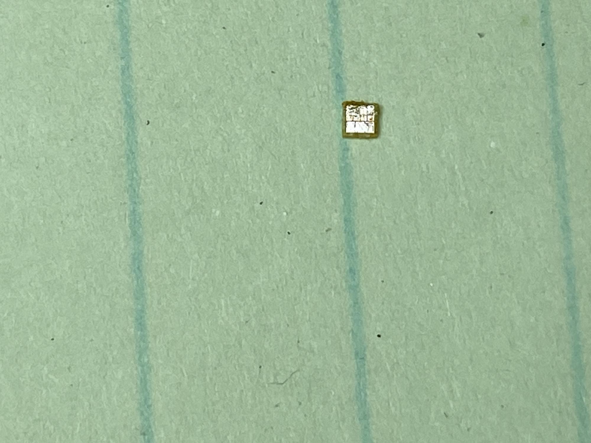

    Ill have to measure with dmm later as I'm not at the office now but I don't think it measure open as the led lights up but only show 9v on tester
    also dont forget to messure the size of it with mm.

      i think they are just normal LED from innotek 6.4V
      You may be right. I have 6v led to put in and test but why would these measure 9v even when off the strip if there 6.4v?
      I can remove a good led to test but I'm almost positive it will show 20v

        i know same system with hisense nano.. i do believe 99.9% normal innotek led 6,4v almost size 3040
        by the way.. the one you took it out just take look on the back side.. you will see only 2 pool

          dear friend... believe me and dont bleieve your tester.. LED tester good only^with normal LEDs with out ziner diode build in.

              Here ziner diodes are installed separately on the bar for each channel (4 leds).

                lotas innotek build the ziner inside the led unit.

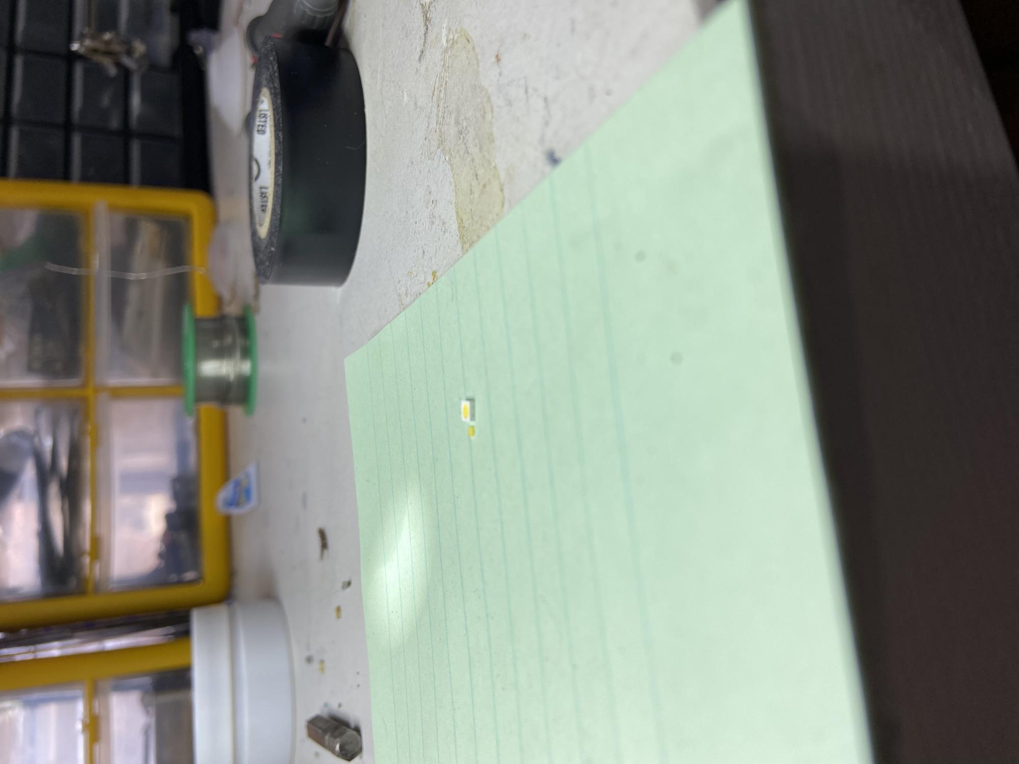

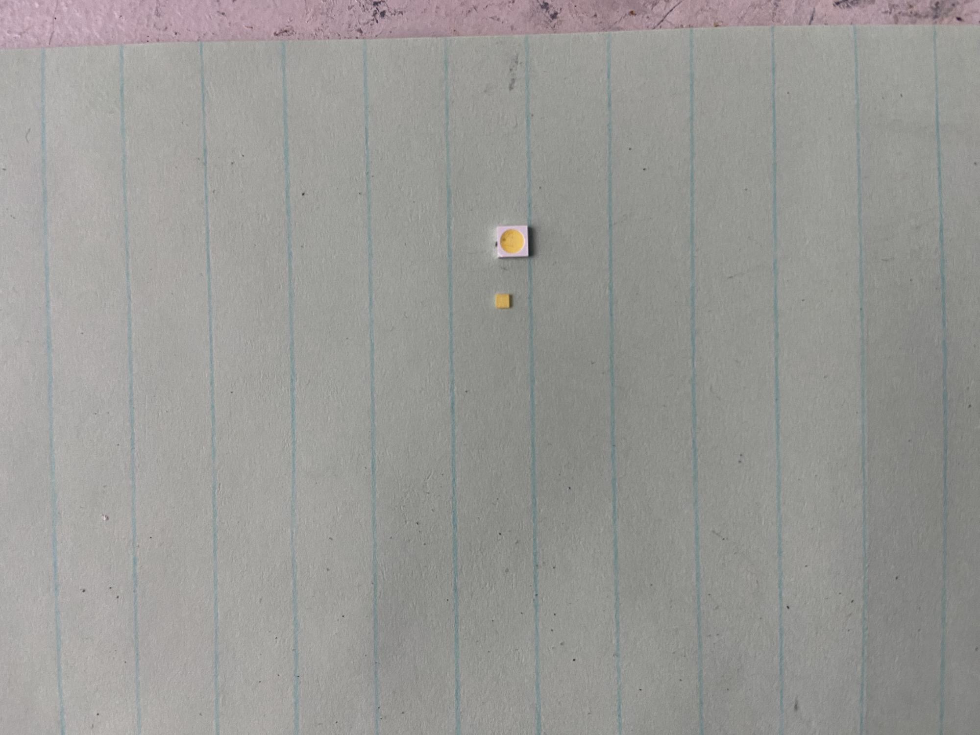

                • Storyteller12
                  • Jun 2020
                  • 625
                  Re: LG Nano91 TV Backlights
                  Diah,

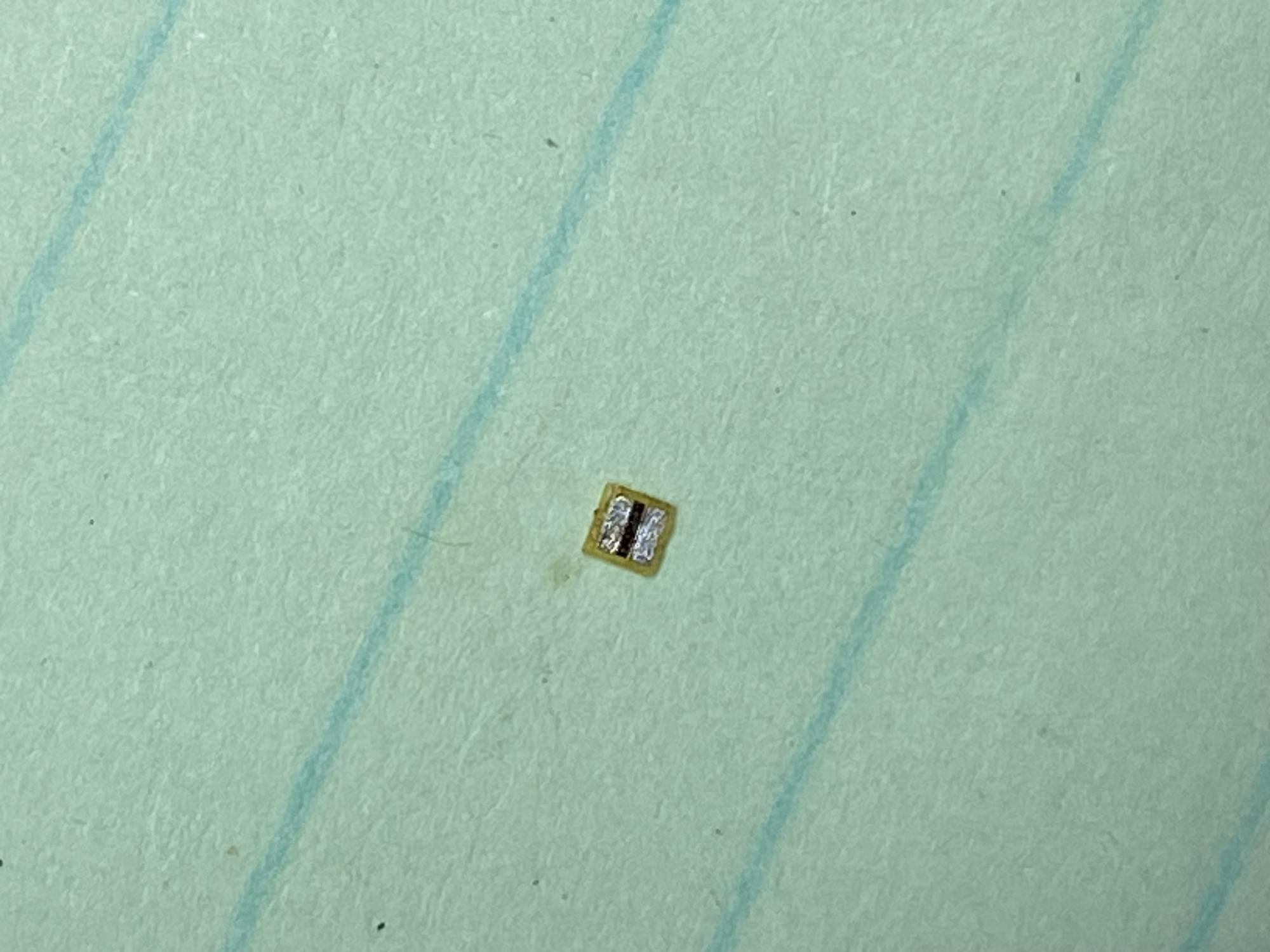

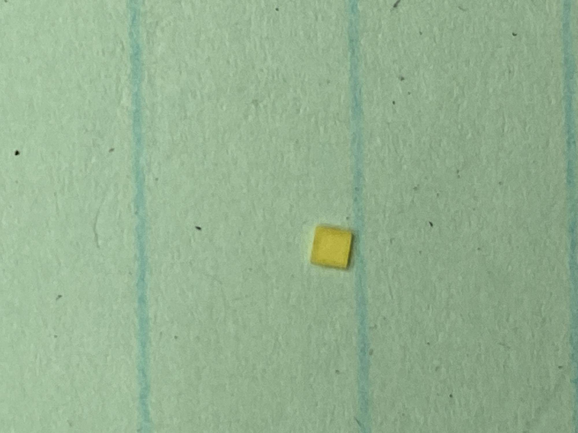

                  Measured the led in beep mode and diode mode and got OL on both. No shorts but no reading either. As for size I cannot measure but I took a pic of it next to a 3030 led for comparison.

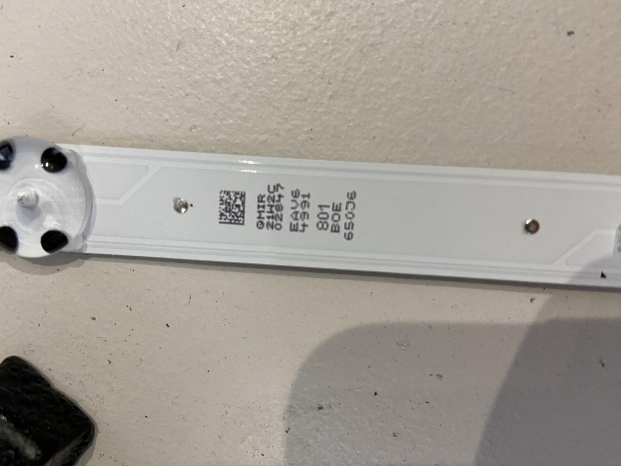

                  • Diah
                    • Feb 2013
                    • 6437
                    #29
                    Originally posted by Storyteller12
                    Diah,
                    what about the back side of it can we see it .. ?
                    can you zoom on the front surface to see how many small dark dots it had..

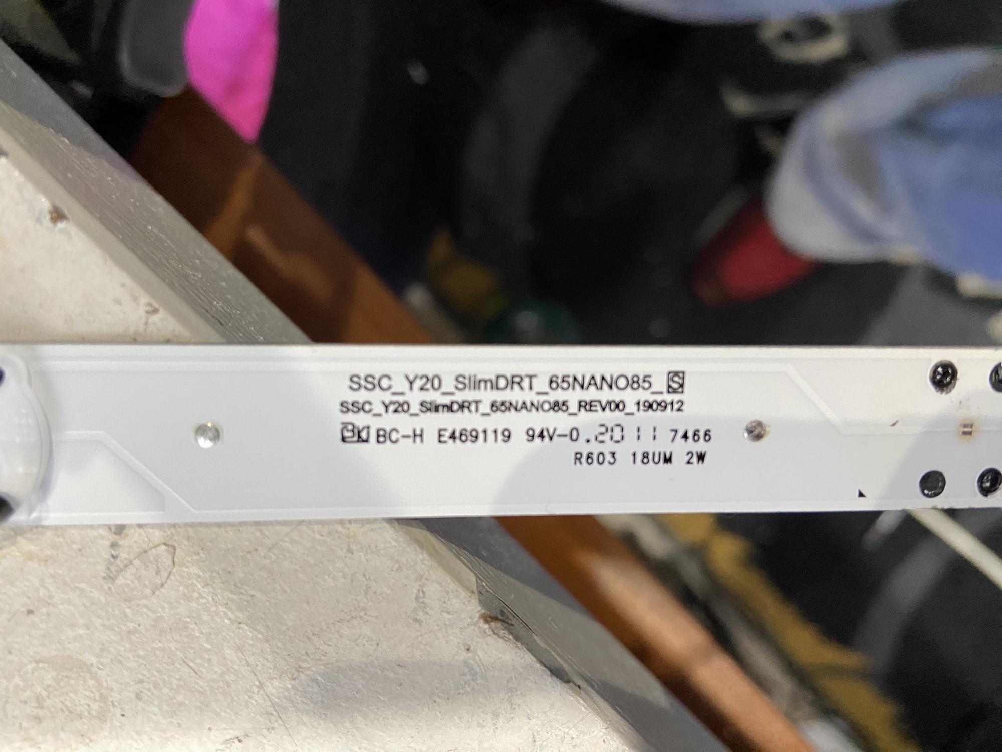

                    by the way... the type info of the LED should be print at the strips lable

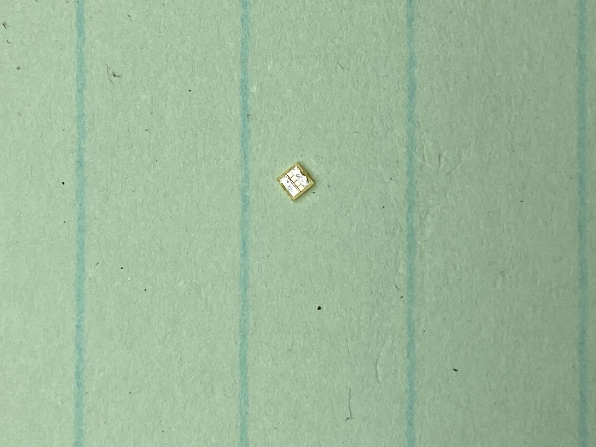

                    • Storyteller12
                      • Jun 2020
                      • 625
                      #30

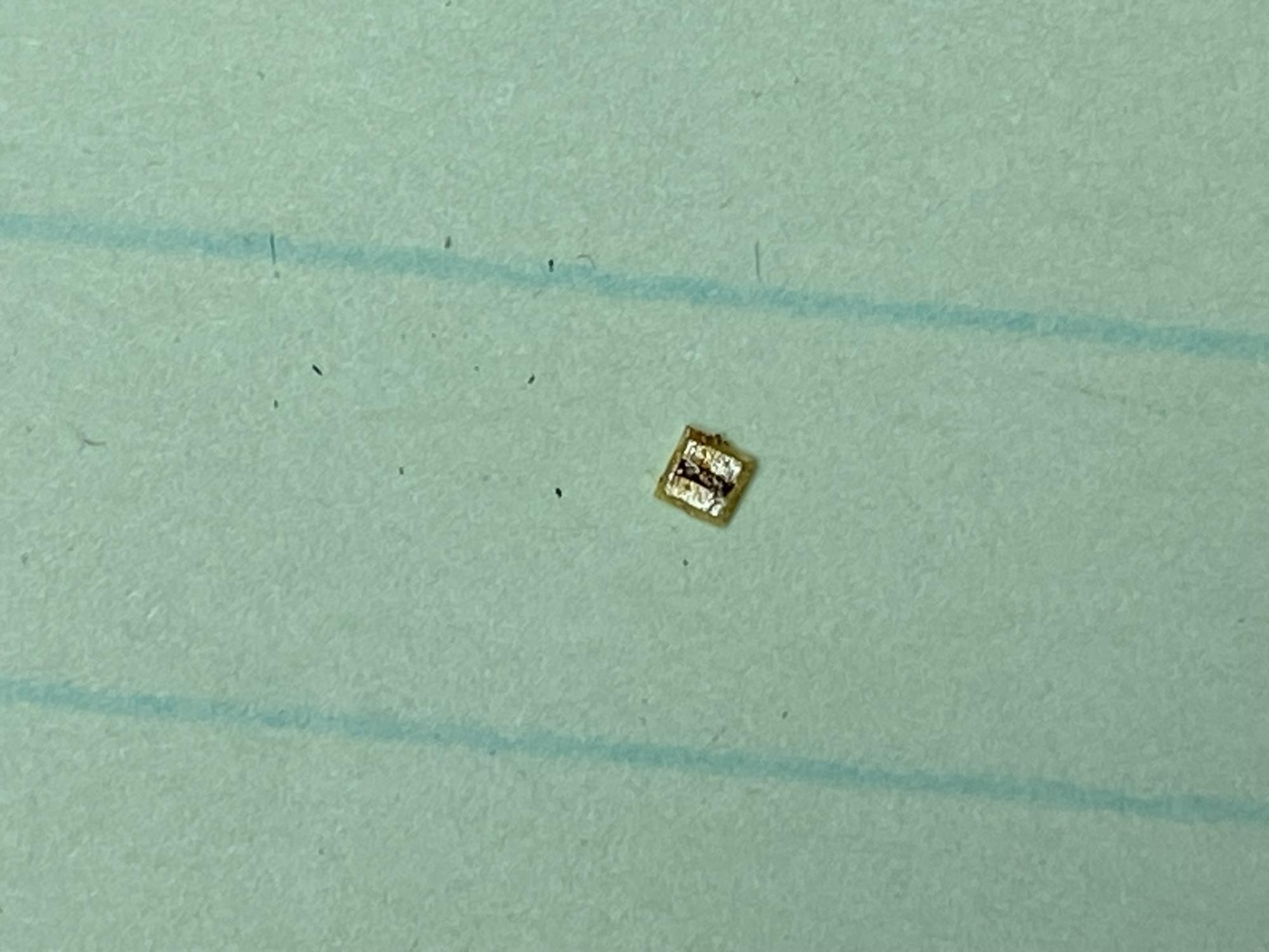

                      Here you go
                      • Diah
                        • Feb 2013
                        • 6437
                        #31
                        from the photo i can see there are 4 LEDs section. 4x6 =24V or coulf be they are just 3 x6= 18V. on the label there are 18UM 2W
                        you need to see the back side exactly if they are separated ( no conection at bed )to know how many they are, same as Lotas said early they are group of many LEDs

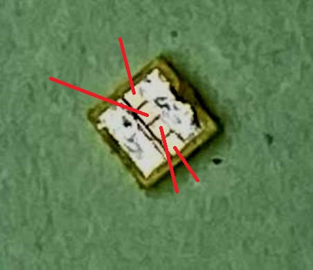

                        • Storyteller12
                          • Jun 2020
                          • 625
                          #32

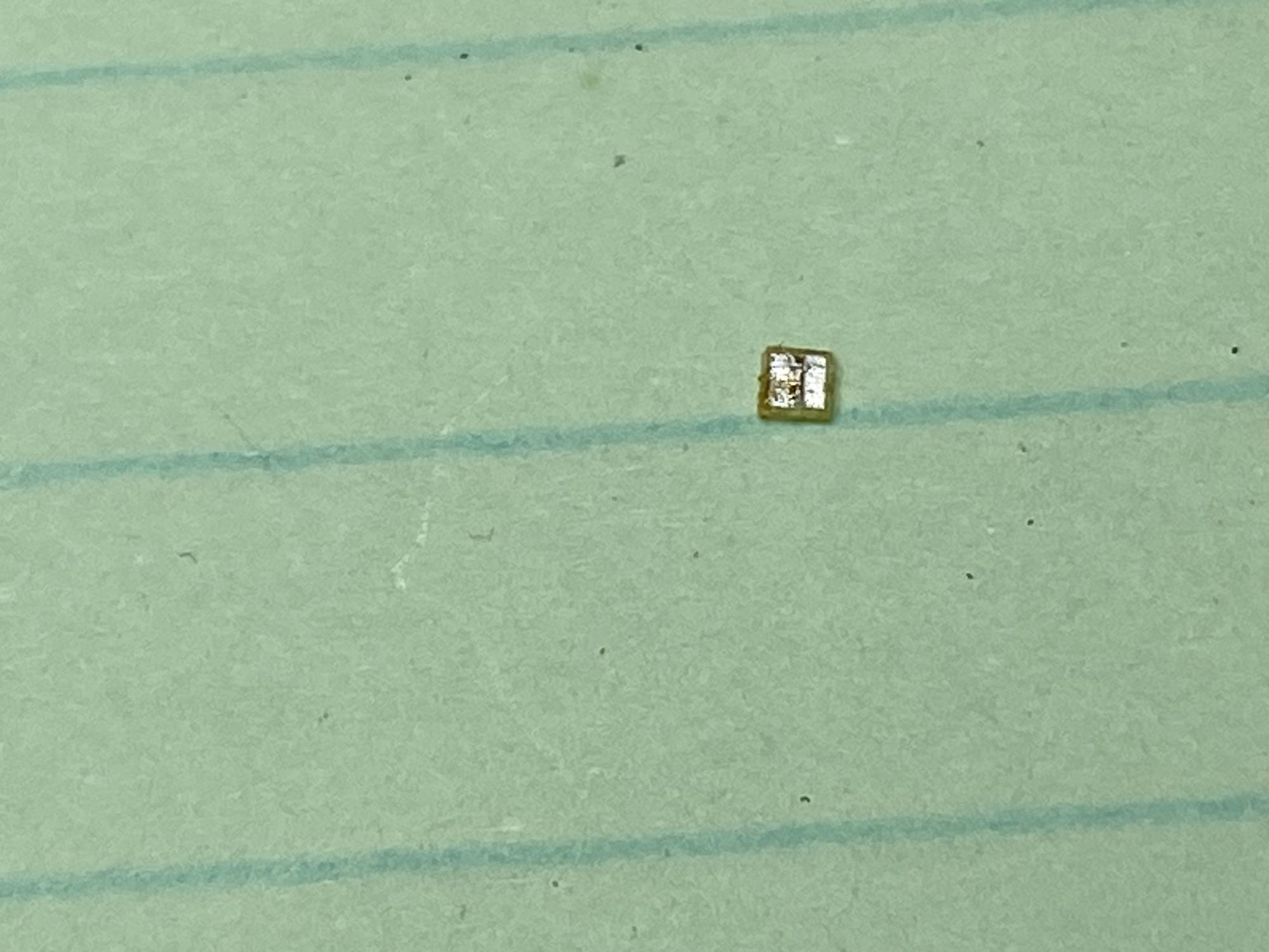

                          I tried my best to desolder and take a pic of it. It's so small and I don't have a scope so it's hard to work on.
                          The last pic I believe is the best and I think your right about 4leds.
                          Now we have some better info on them. Trying to source them is another thing
                          • Diah
                            • Feb 2013
                            • 6437
                            #33

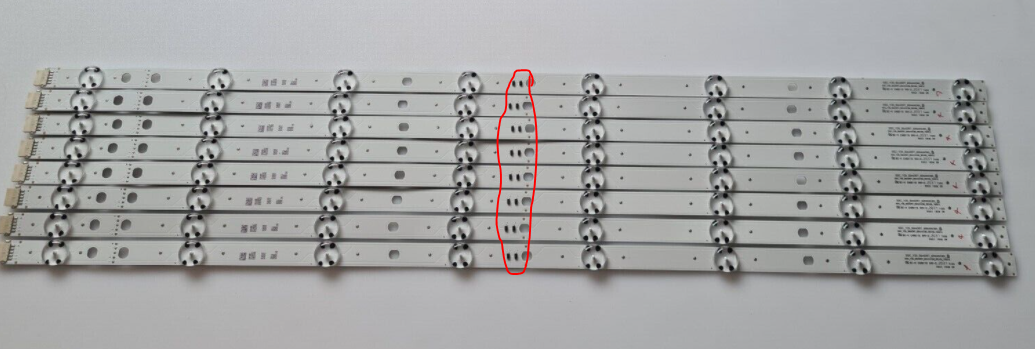

                            yours last photo they look 8 leds... and you do have 8 channel.. lol
                            the best way look on the strips where you removed the led..

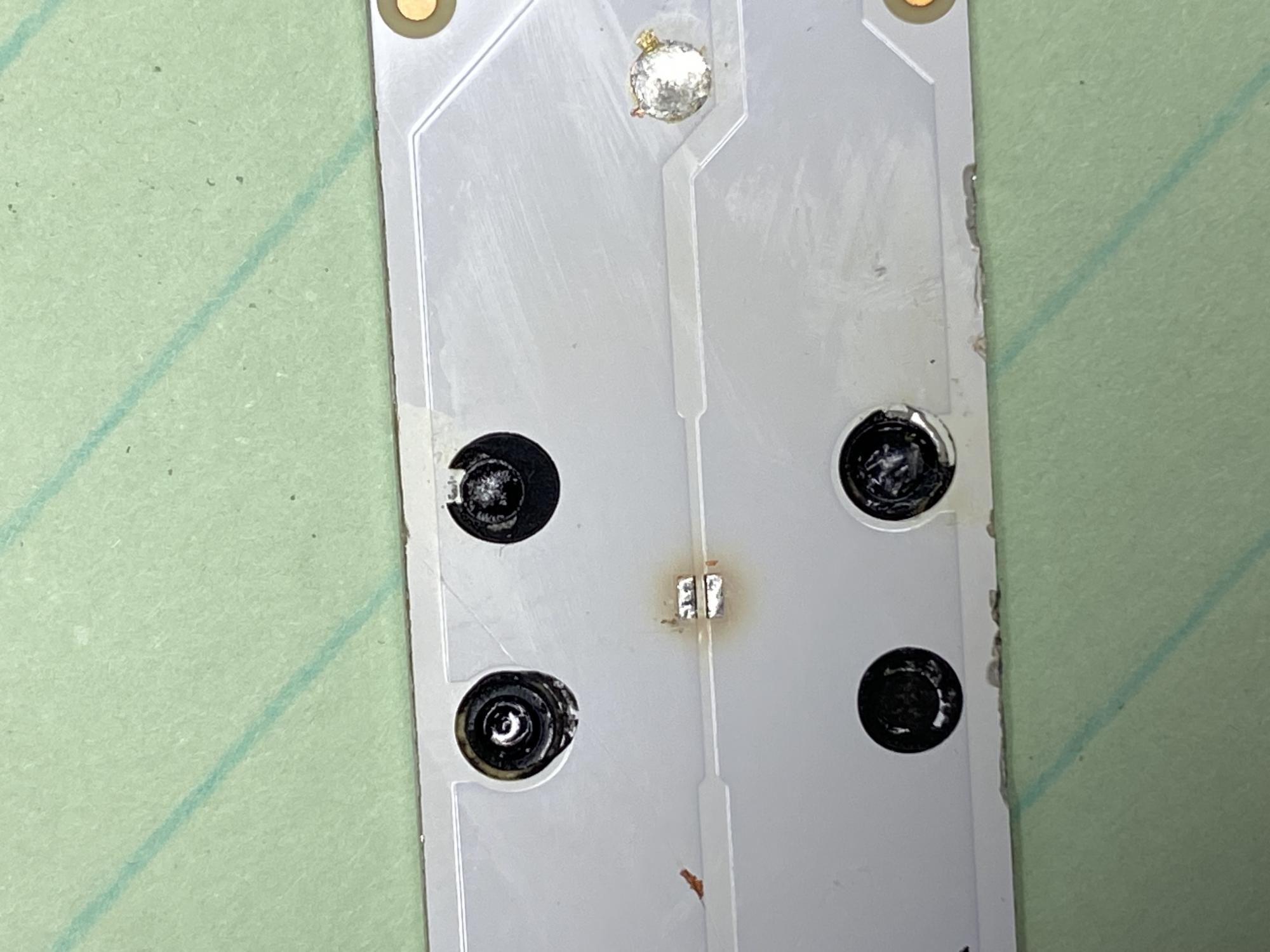

                            • Storyteller12
                              • Jun 2020
                              • 625
                              #34
                              It's still hard to tell. But here is the strip where it was removed from
                              • Diah
                                • Feb 2013
                                • 6437
                                #35
                                need to remove / clean the old solder to see howmany beds.. now they look shorted together
