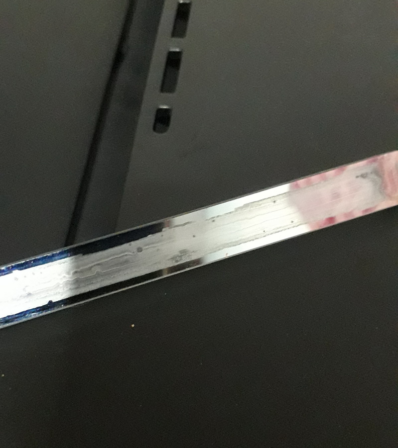

    HP CP1025 faded mirror
    This is what happened to 45 degree angled mirror of laser assembly. mirror surface coating is almost completely etched away.
    what can be the possible solution for this?
    Printer - HP colour laserjet CP1025
    Symptoms - faded printouts
    • 31201
    Re: HP CP1025 faded mirror
    is the mirror flat?
    if it is - go talk to a glass shop - they can cut mirrors to size and probably have offcuts
    • pavithra_uk
      • Nov 2010
      • 44
      Originally posted by stj
      is the mirror flat?
      yes. flat mirror
      it placed 45^ angled in the laser assembly. after acrylic lens
