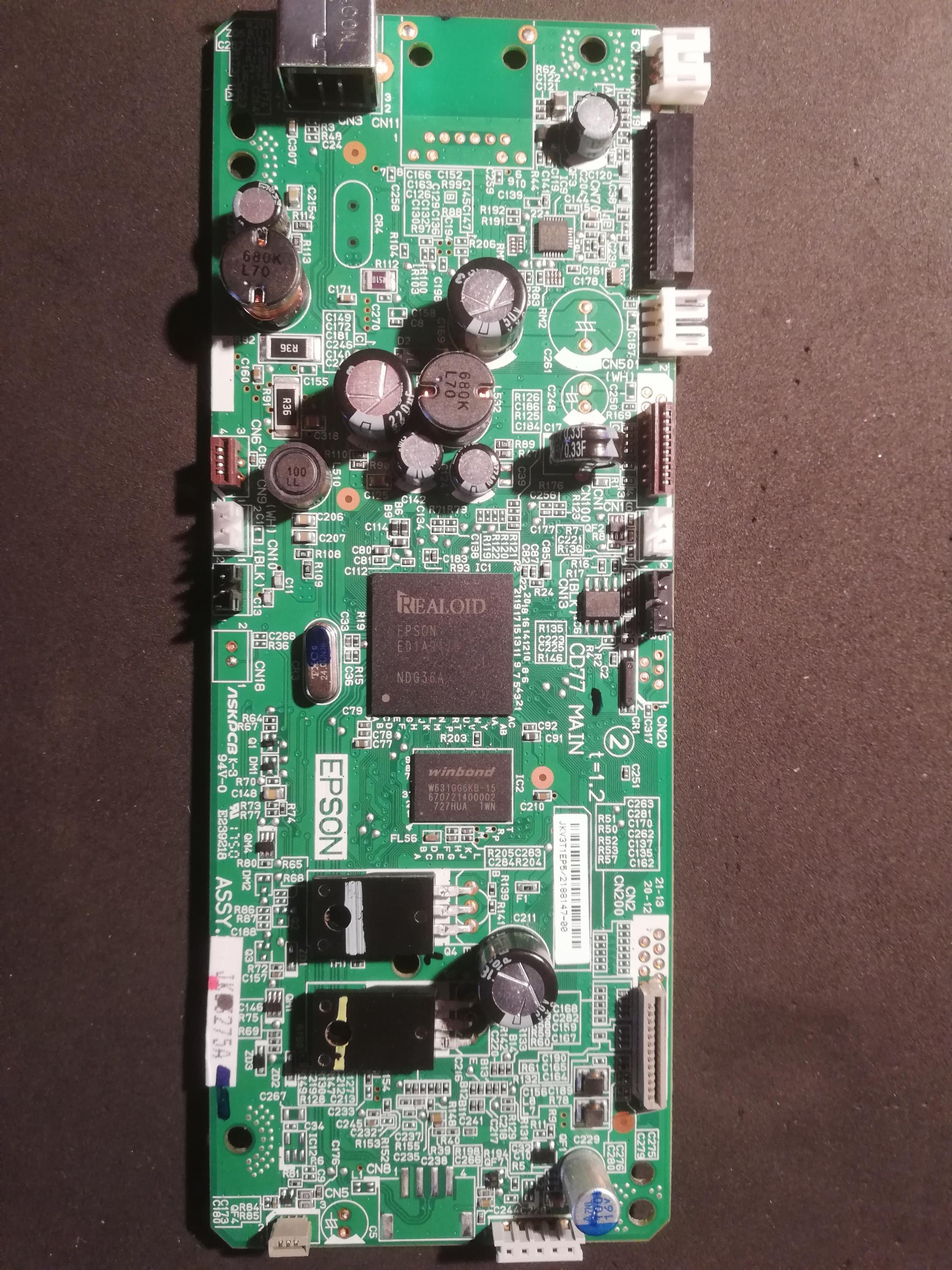

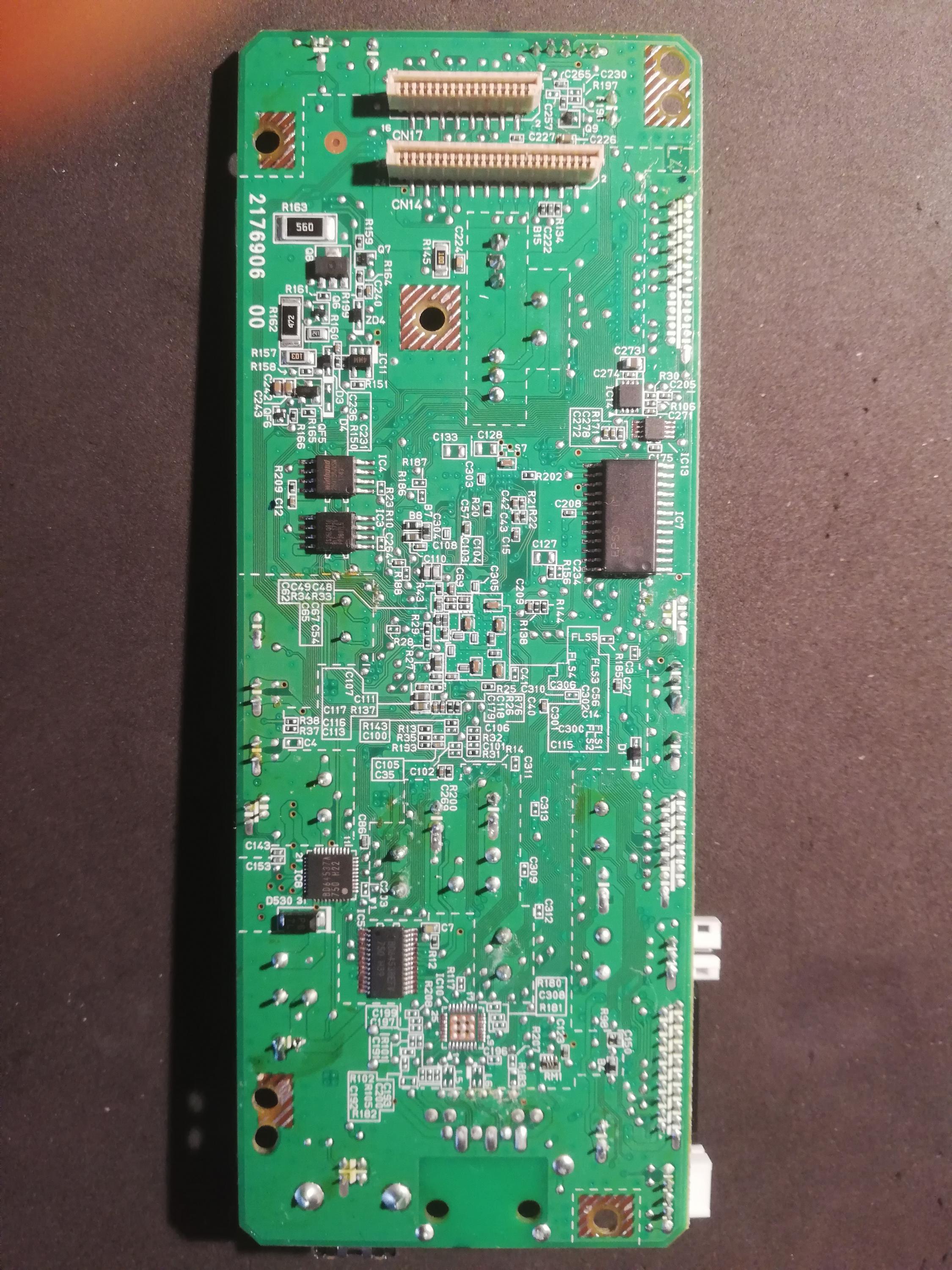

    Greetings to all. I have a problem with an EPSON WF 2750 printer that does not turn on. The power supply is ok. The two transistors Q4 and Q5 c6082 and a2222 are ok. The fuse near q4 is ok. Do you think it is necessary to replace the ic 7 E09A7418A?
    Or a firmware problem?
    Thanks for the reply

    I would like to try to reprogram the eprom. Do you know where to find the firmware?
    CD77 main, flash memory: 25Q128JVSM

      Re: printer Epson WF2750
      Epson wf2750 dump
        Thank you very much
          I flashed this firmware and the printer has restarted
          Thanks Lotas
