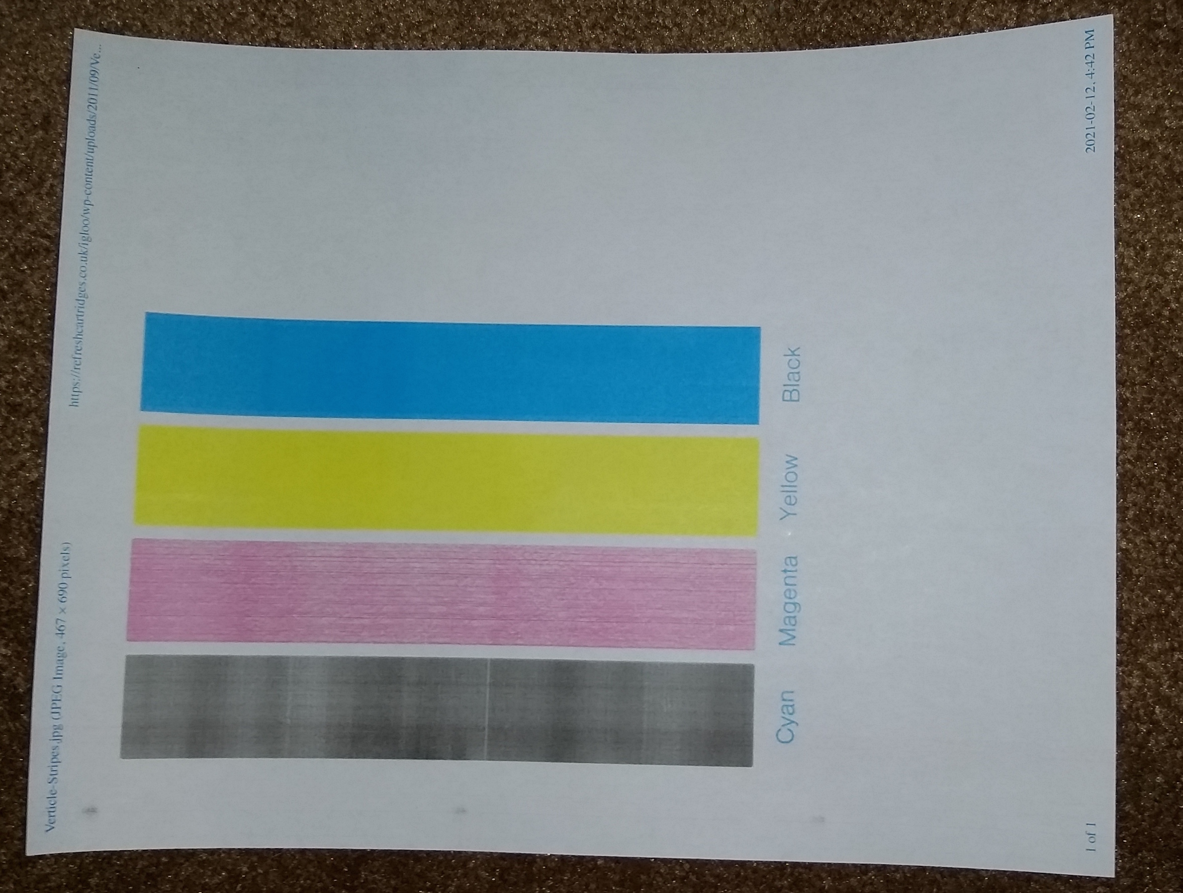

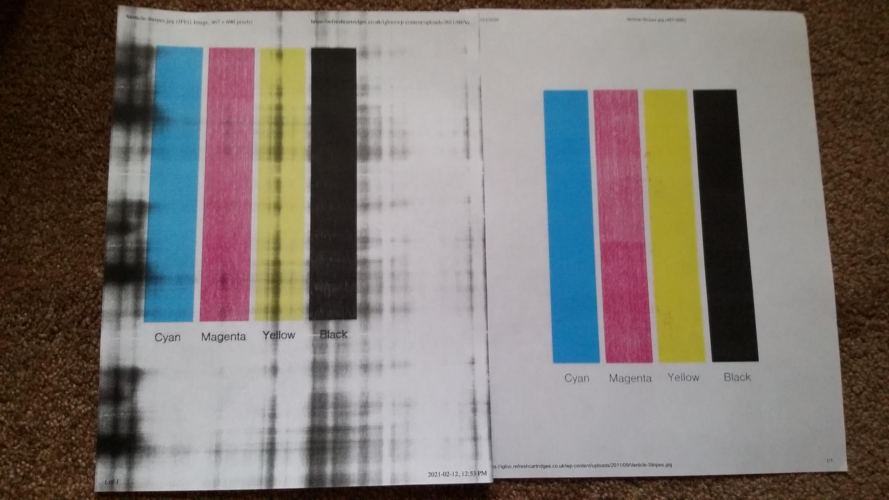

    This printer started to usually print the first sheet output of the day with back streaks / blotches. After the first sheet, the print would then be relatively clean. I did the corona wire cleaning but it didn't really help as the next day, the same result. Now after some cleaning of the black drum (with some alcohol and cotton), it has gotten worse to the point now it prints "ugly" all the time. :-(
    Is the toner just done or have I ruined the drum during my effort? System indicates the drum has about 60% life, toner 40%.
    The attached picture shows the poor print on the left while the right print was a good one from an earlier period when a first bad sheet had already been printed.
    I cleaned up / vacuumed / wiped interior areas of any loose toner. Didn't help.
    Any guidance or help would be appreciated before I totally break the thing (if I haven't already). Thanks.

    looking at the colours, i think you need to start with a full cleanup.
    i suspect there is dust on the mirrors that reflect the laser from left to right.

        I swapped the cyan and black positions in the unit (same drum / cartridge left together). The pattern cleared up in terms of the black with just a little "contamination" along the left side in a few place. Both black and magenta appear to be on their last toner legs... but it would appear that the drum / cartridge pair is somewhat ok. Although at this point, it might be that the black "pair" has been used enough during my tests to finally get to an almost "normal state" again. I guess I will leave them in place and let things cool down a bit to see what happens.

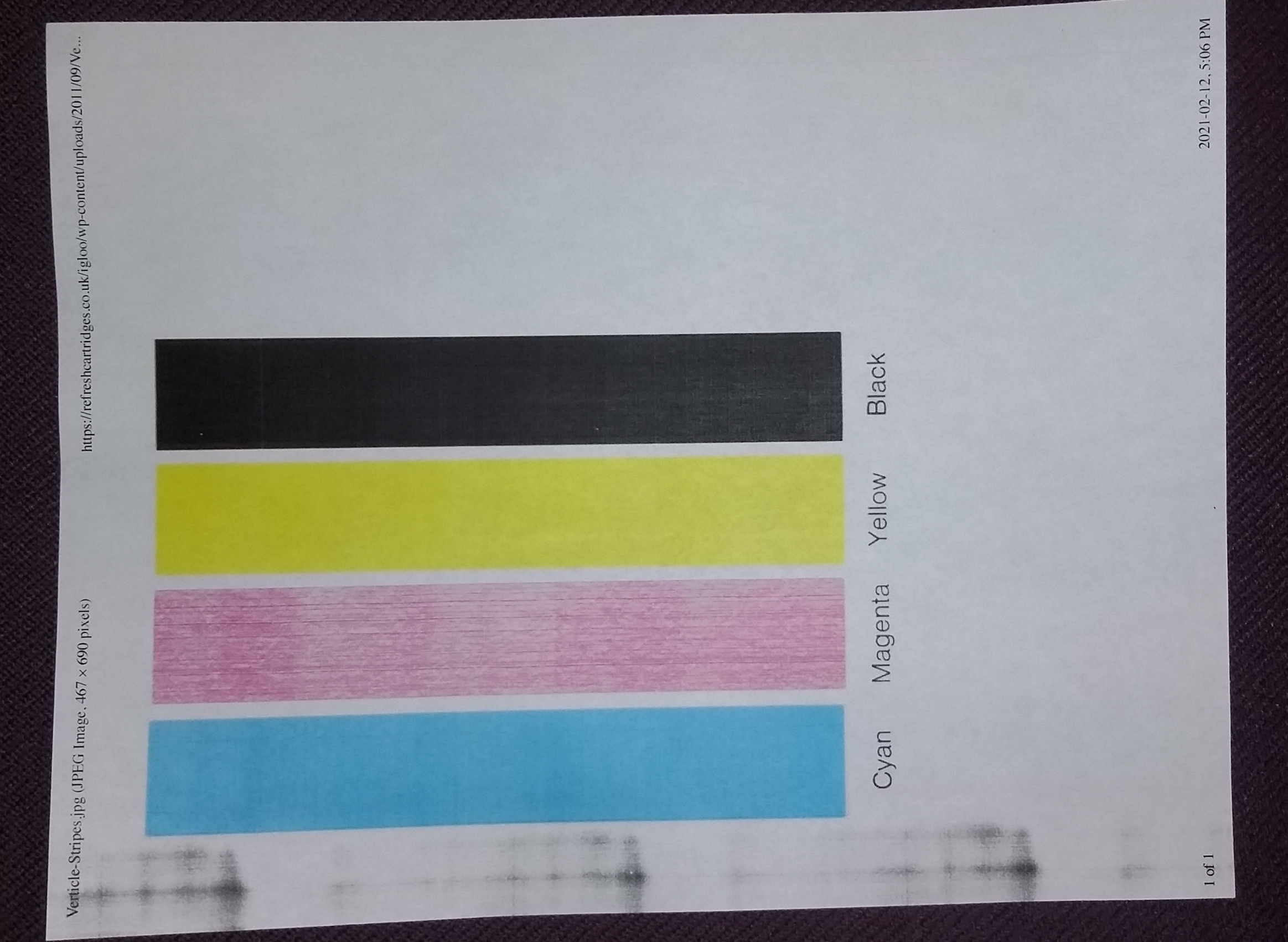

          swapped the units back to "normal"... the contamination on the left is a bit more but like the original problem. The black appear "fuller" in its original place holder. Perhaps this is an electrical issue? I am somewhat at a loss.

              thanks for the further info. It helps me along. Further tests with swapping the cartridge pairs back seem to indicate the problem is with the density (how bright a color is or how black is black... I think). Not sure how it is handled but the regular position of the black seems to have high density such that it brings out the black toner. When the black toner is in the cyan position, its density is lower and thus there is little to no black toner spread "spuriously" around the page. How is the density "read"?... is it possibly that particular "sensor" is having a problem determining the actual density of the output?

                  OK... but when the cyan toner / drum is in the black position, the cyan resulting color (for the black text) is a nice "cyan printed text" page off of the same leds that would have generated the regular black positioned cartridge / drum (the equivalent test with "blue text" and black toner / drum in cyan position also gives an relatively nice black text output with no "over streaks"... less density overall).
                  Basically, only the black toner in its normal position is a problem with density. Its almost like there might be some sort of voltage / contact problem with how that drum is charged at that position. IF I understand things, in general, the difference in charge (thru the optical drum) is what causes the deposit. Normally, no printing, charge is at the same level (drum and wire?). Increased "potential difference" attracts more toner resulting in print / darker accordingly. I am probably "out in space" on this. :-) Maybe I have to look closer at the contacts of the drum unit with the body of the printer to see if there is some form of corrosion or otherwise cause a voltage drop going into the drum at that position that is slightly different for the other drum.... maybe.

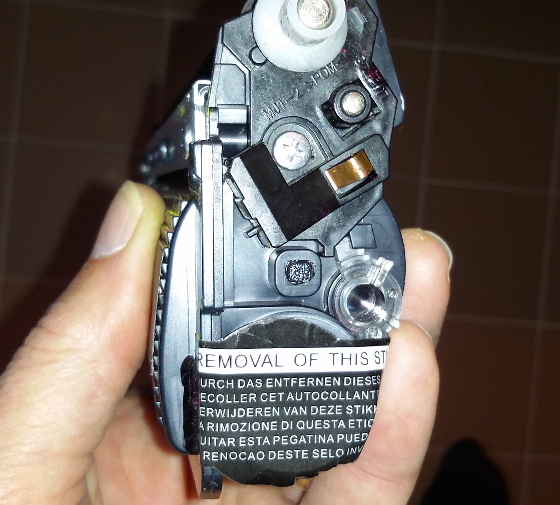

                      I was comparing a couple of the cartridges.... i have an old yellow one that was recently replaced. On the side of all the cartridges, there is a small circular window (on the same side as the electrically contacts). It appears to align with some form of sensor on the side body of the printer. Each slot has one. Anyway, the window for the black cartridge appears to be somewhat frosted over while the others seem to be clear, meaning you can reading see thru them into that area of the cartridge. Not exactly sure of what the sensor is reading but maybe some form of "density" moves by the window's interior to be "read" by the sensor... maybe?
                      On the black unit, it appears that perhaps some form of contact cleaner was used on it which "frosted" the window's plastic... maybe. Just a guess though, I am a recent second owner. :-( I tried cleaning it with alcohol but not much luck. It is still quite "surface fogged". I am thinking that I might try removing the one from the old yellow unit and installing it on the black to see if that changes anything... maybe. Although, I think it might take a bit of disassembly to get at that "window lens" and haven't yet looked at how a toner cartridge comes apart without a hammer :-)
                      Looking closer at the mark, it looks like someone might have taken a black felt pen and provided some "darkness" to the window.... hmmm. I think its permanent marker so I don't think there isn't any way to clean / clear it. :-(
                      Can someone tell me what that window is used for? The picture doesn't really show it well but you can kind of see the "cast" to the side of the window... it covers about 70-80 percent of the view.

                        it may be for seeing if it's empty - an led to light it and a sensor to detect the light reflecting/being blocked.
                        i'v not seen anything like it on HP stuff i'm used to.
                        interestingly, my brother inkjet uses an optical beam to detect low ink!

                          You are probably right.... and I wasn't very observant as there is a similar window on the opposite side of the cartridge. So there are two "windows" on each cartridge along with sensors and / or sources, one on each side of the printer chamber for each slot. The printer sensors appear to be be clean. Its the cartridge window on one side of the black that seems to have some sort of "contamination" on part of it. Like I posted, it seems like some sort of permanent marker or equivalent that has "frosted" the plastic so that it is no longer clear... almost opaque. Not sure what it is used for... probably some form of "fill detector" maybe. I wonder though if there are different detectors at each slot in terms of "light response" / colors such that they see (thru) certain colors better than others to get a better idea of how much toner is actually there????
                          The "mystery" of a laser printer is certainly great for me. :-)
                          edit add... it appears from some brother help page that the "beam / sensor" combo is used to determine that a cartridge is empty. Of course, the "explanation" does not shed any "light" on if the system uses the detection in any form to help with density decisions.
