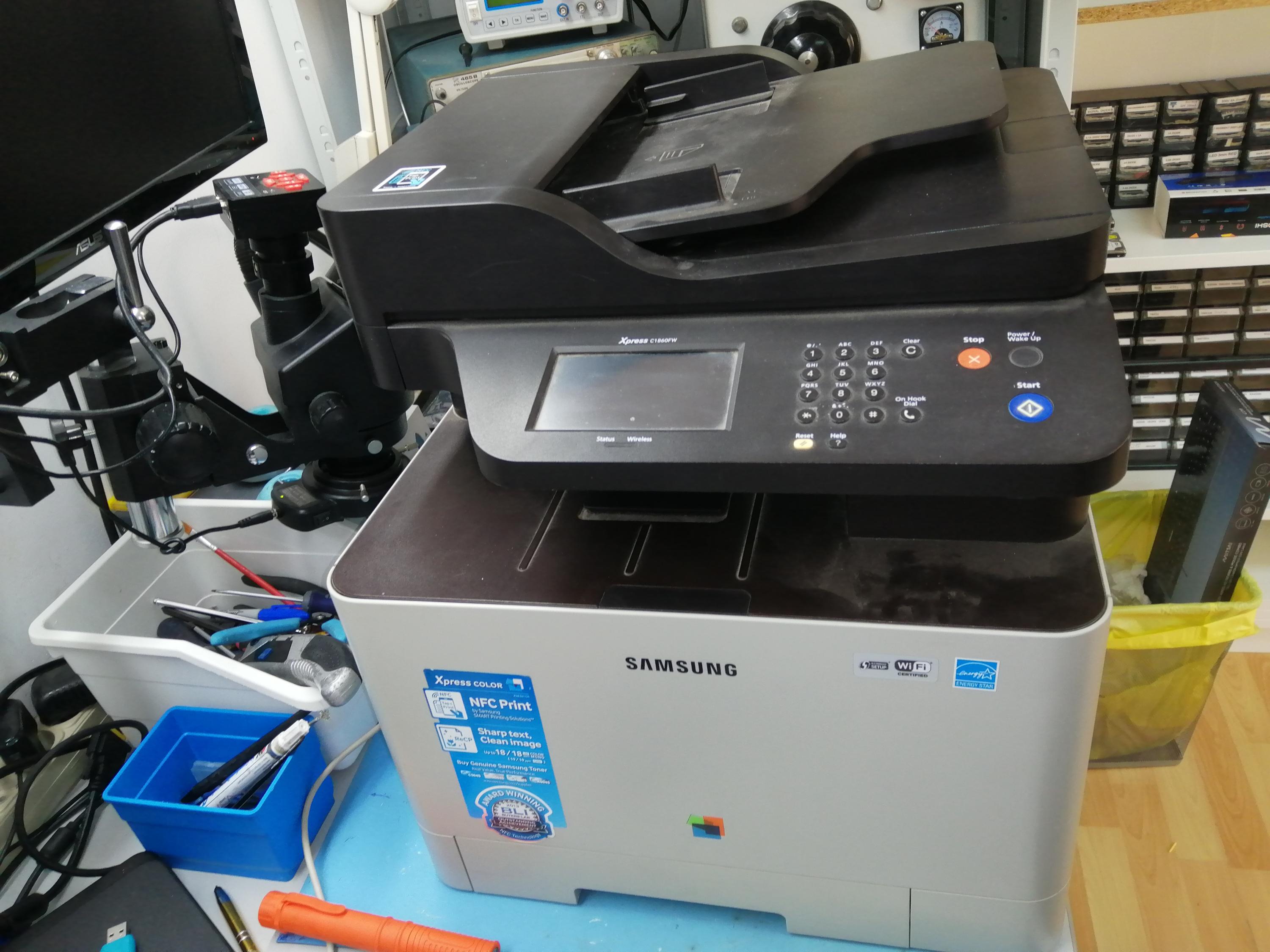

    I'm no expert on printers. I have this colour laser here, it has new toner cartridges fitted - Samsung Xpress C1860FW
    It power on but after a minute it starts to smell bad like something is getting very hot (but not smoke). It's not so much a burning smell it's more acrid like burnt TCP or something similar

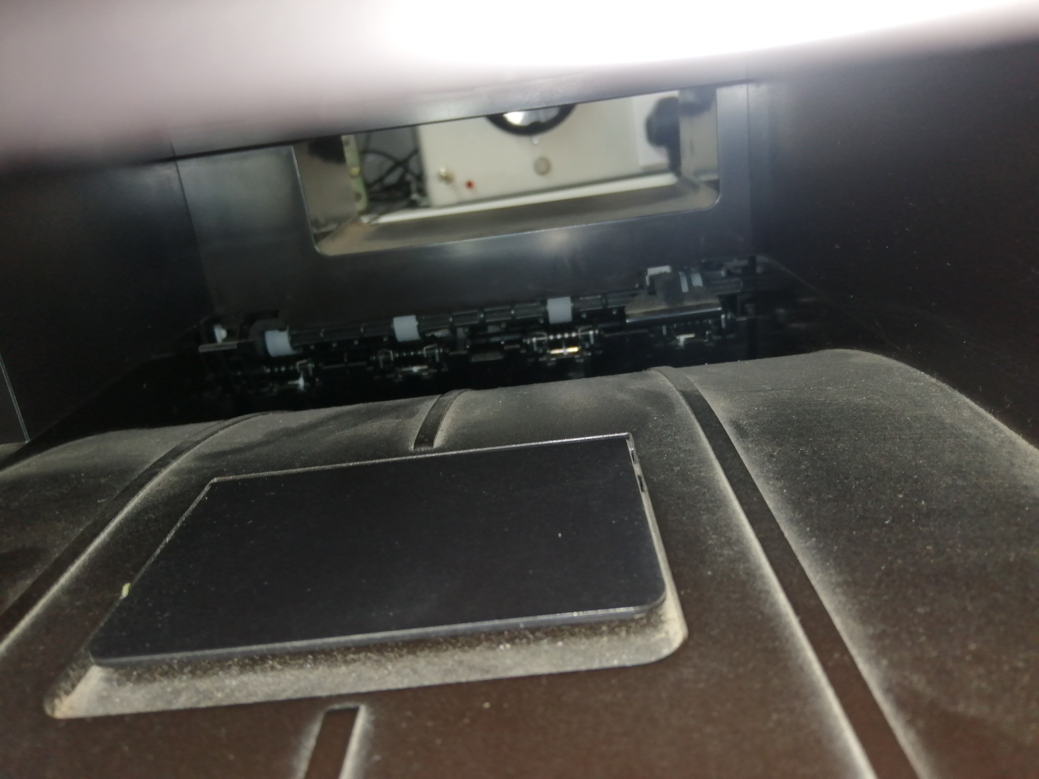

    It's hard to pin down exactly where the smell is coming from but there is a gap under the scanner and in the back are some rollers - if I put my hand down there it feels warm. This is where I tried to take a photo (see attached)
    The client says it does try to print but the paper jams in the back

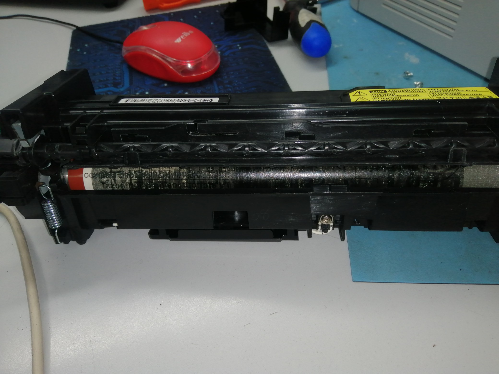

          I decided to ignore the smell and install the drivers (USB). When I turned on the printer the status LED went read and gave an error #U1-2320 - which means Fuser Unit failed (apparently)
          I googled that and it said turn off and on again. I did that and this time I got no error - Status LED Green
          I installed the drivers, then decided to try the copy function on the printer
          The first page (excel spreadsheet) copied but the quality is shite

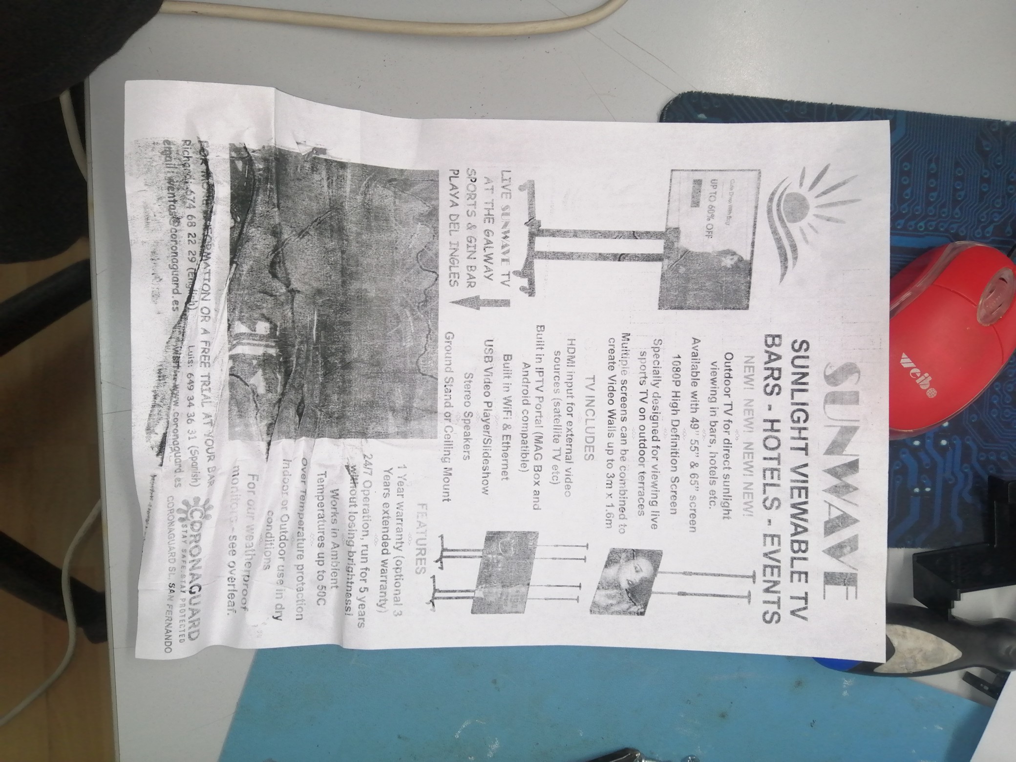

          The next page I tried is a colour document, it scanned and copied in monochrome (could just be some setting) and again the quality was rubbish, then the page jammed and the printer said 'Output paper jam'. It jammed coming out of the fuser unit. I managed to pull it put gently.

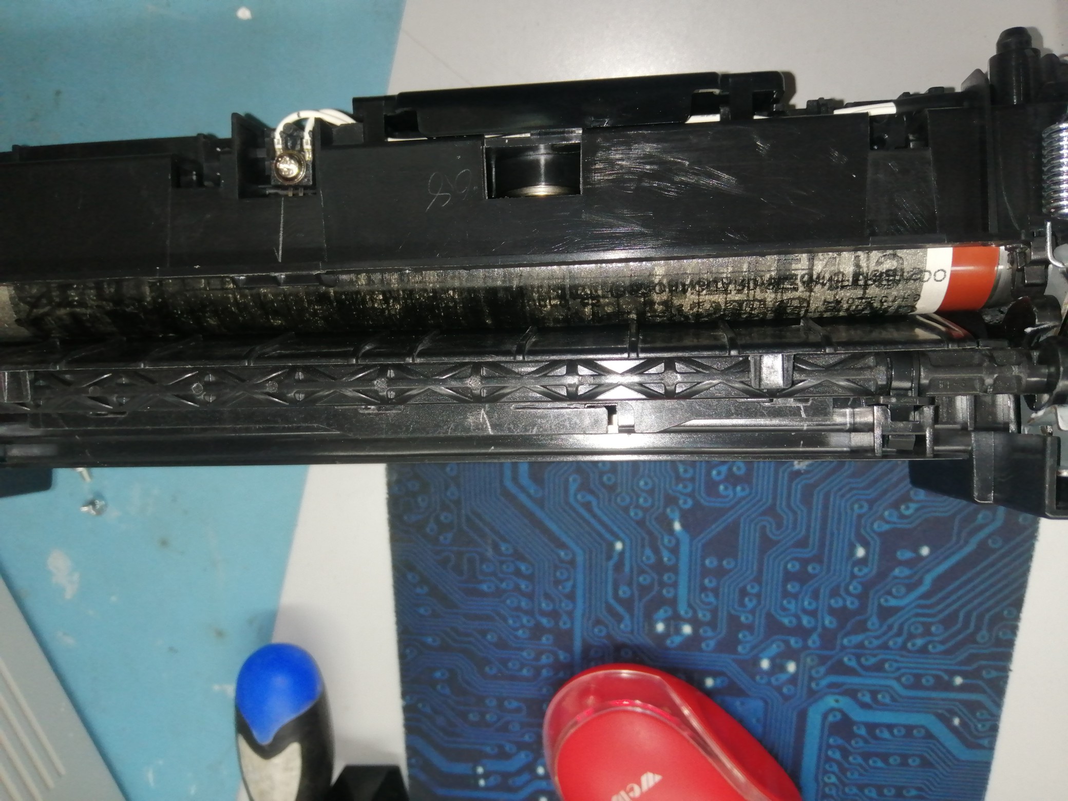

          I then removed the fuser unit, this is definitely where the strong smell is coming from. It looks all grubby on the roller.
          So between the error code, your advice and the paper jamming coming out of the fuser, everything seems to be pointing to this being the faulty item.
          Should I clean/service it or replace it?
          Ahh NO. It's got paper all wrapped around it!

            OK I removed all the brittle paper from the roller and it's working good now
