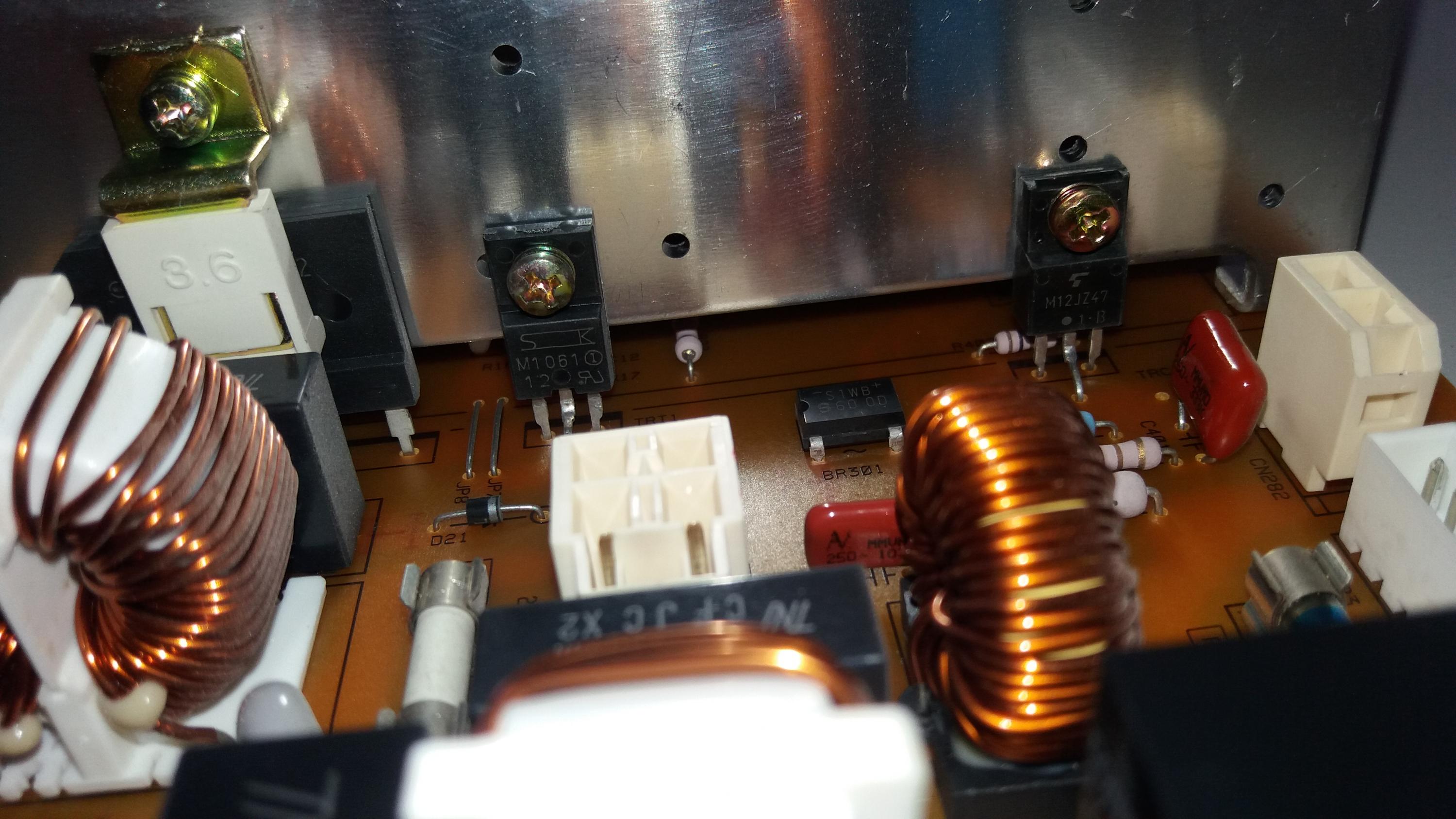

    sc 541 rex rotary nrg 1802 copier
    after cleaning fuser
    copier indicate error sc541
    fuser lamp seems ok
    but no voltage from psu to fuser in heater
    connector
    i suspect the component sk 1061m is faulty
    but no datasheet in google
    pls help identify or any idea
    • 31294
    Re: sc 541 rex rotary nrg 1802 copier
    "SK" is the maker - Sanken
    so it's a Sanken TM1061
    a 10A triac

        May be the TRIAC is not being driven.
