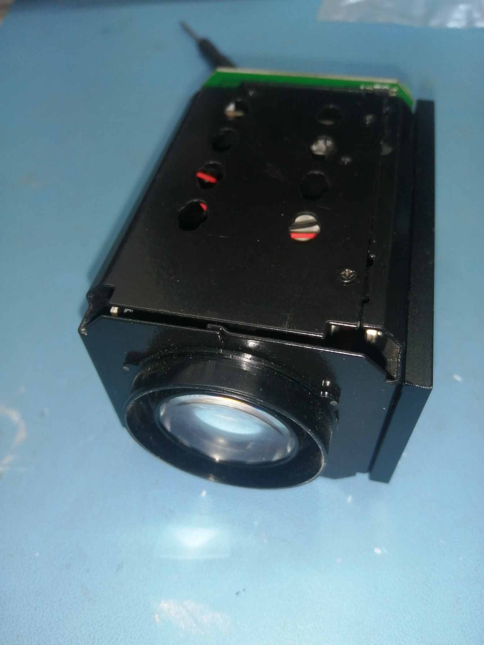

    Hi guys
    I know nothing about fixing cameras
    This is from my BGA rework Machine, it is part of the optical alignment system for placing BGA in the correct position on the PCB
    It's only a few months old, it was working but became more and more intermittent and now it does not work - the monitor says No Signal.
    I tested the monitor with another video source and tried another HDMI cable. The monitor works fine

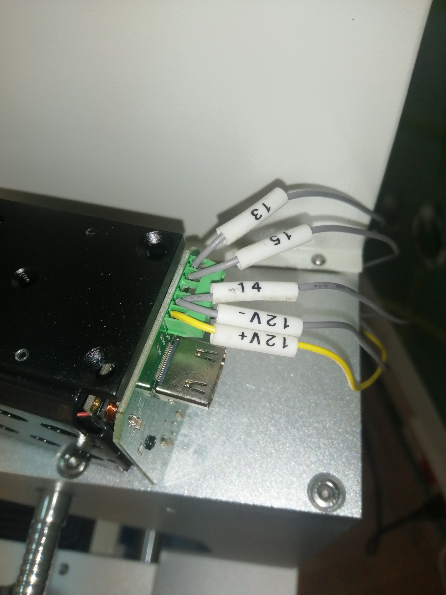

    I checked it had 12V present while it was still attached to the machine

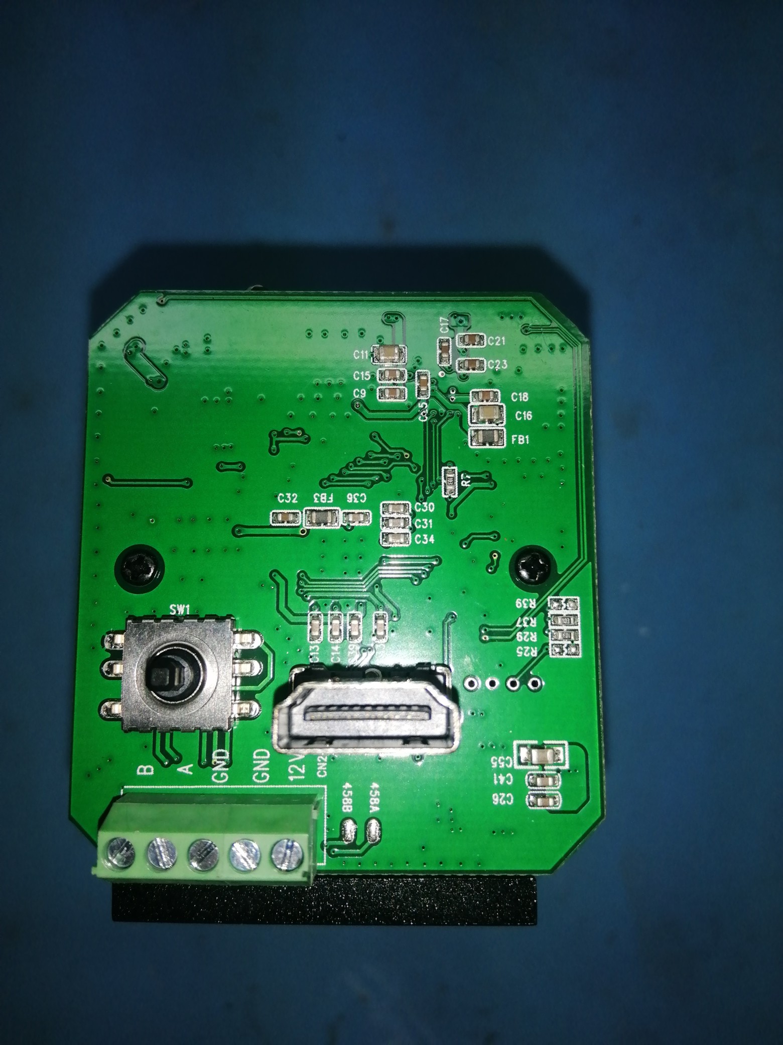

    The connections are marked
    12V
    GND
    GND
    A
    B
    There is no brand name on the camera as far as I can see
    What should I check, and what is supposed to be on the connections A and B?

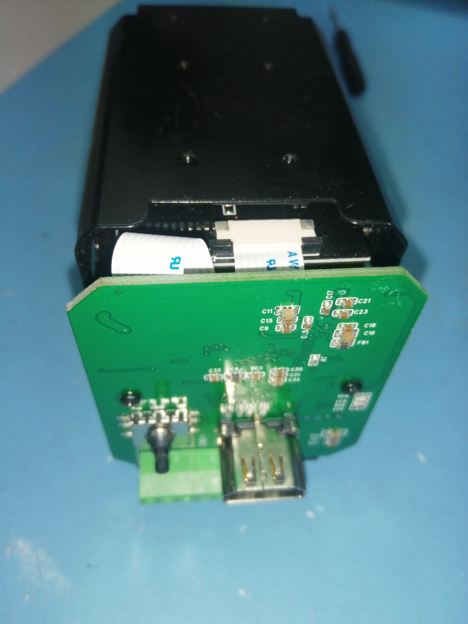

      Maybe remove the PCB and check the flex cables are attached properly.

        The 458A and 458B could be a typo error on the silkscreen. Looks more like the RS485 communication protocol. Try scoping those line. But first test and see if voltage is making it to other part of the board, sometimes it could be a cracked solder joint or cracked via, especially with those screw terminals.

          I would inspect the pins on the hdmi plug, use a needle to see if any of the pins have loose solder connections to the board. even one or two loose pins will result in no signal.

              You should have image via HDMI directly. If A and B are indeed RS485 communication lines, they would be to control zoom, focus, etc.
              Assuming it is just a bad HDMI port/solder issue resulting in no image, you should still be able to manually control the lens mechanism and see the lens move as well as hear/feel the motor vibrations.

                It's working
                The flexy ribbon cable from the camera to the rear PCB did not look like it was properly inserted on the PCB end. In fact it seemed like here was something stopping it going into the socket as far as it should.
                I eventually got it to fit after reversing the cable, though it still didn't want to go all the way in after i had done that. For some reason it eventually did.
                On the bench it still would not give any HDMI output but I decided to reconnect it to the machine with those A and B cables fitted and then it worked.
                I inserted it back into the alignment unit, tested again and it is now working more reliably than it ever did
