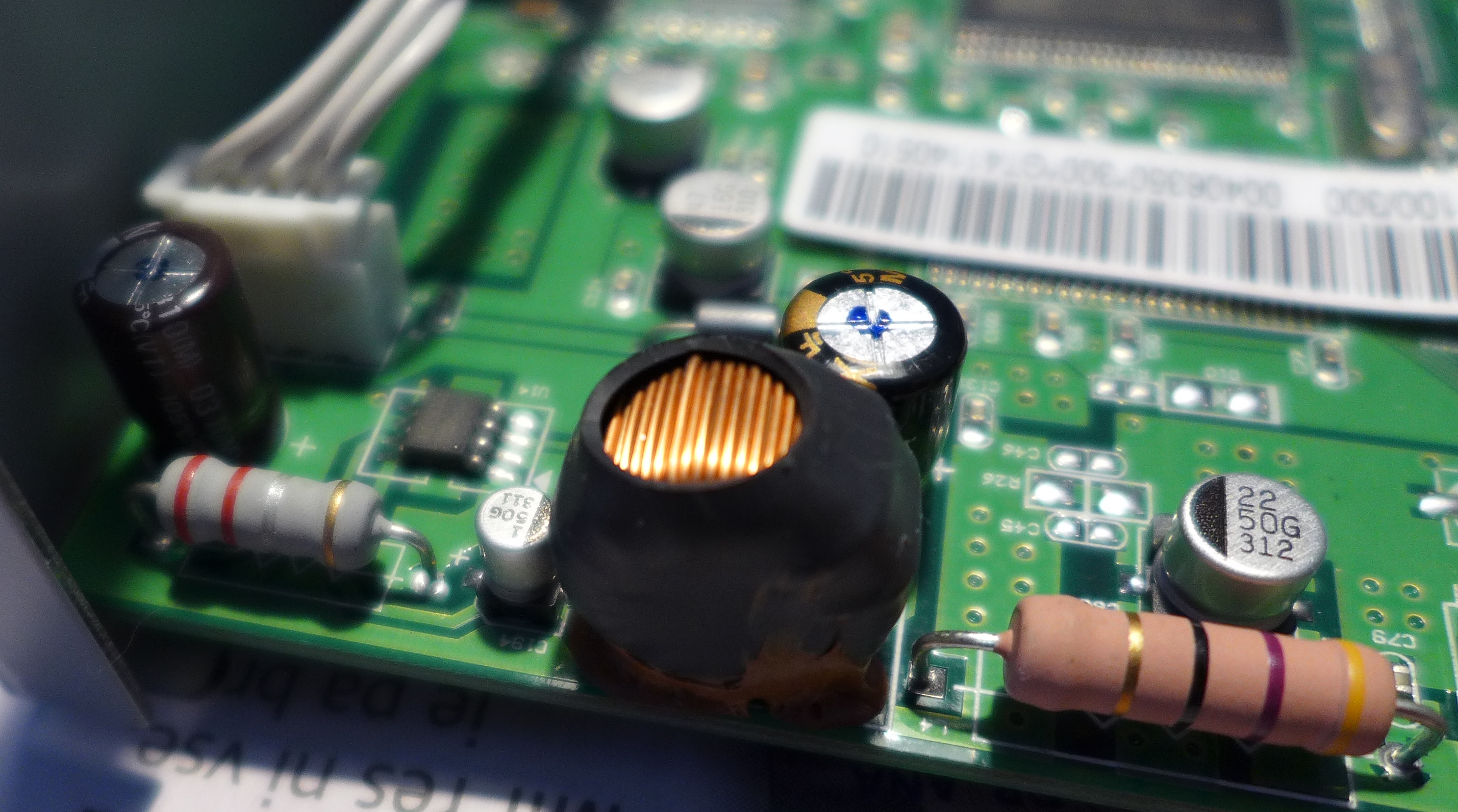

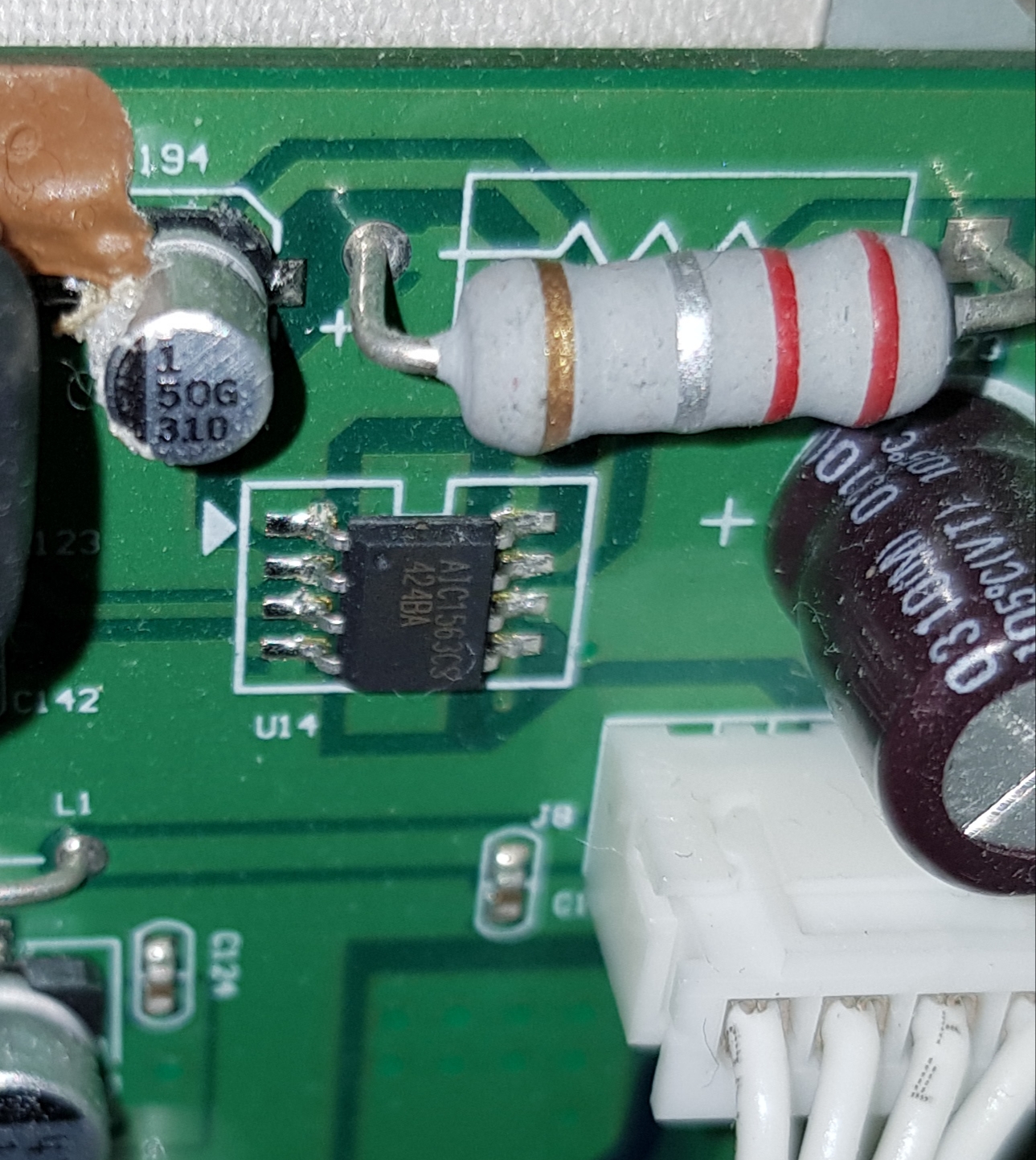

              Did you find the cause of the breakdown ?
              I had a similar failure and I found an inflated capacitor near the CI 8 legs (AIC1563CS regulator which is also very hot, probably because of the capacitor that has sunk) at the top of the card ... But I do not do not know how to interpret the value of the capacitor ... It is 4mm in diameter and 7mm high ...
              It is written:
              1
              50G
              310
              It is not branded
              Do you know what is its value in μF nF pF?
              thank you for your reply
              Bertrand

                      My computer is under win7 64 with XP mode for the scanner and was running the original Minolta application.
                      The scanner worked very well before the failure, both USB and FireWire ... Of course, I tested on another machine directly windows XP ... Without success ...
                      Anyway, there is a faulty component to replace, so this is the first thing to do before making new investigations, no?
                      I am just looking for confirmation of the value of the capacitor described above ...

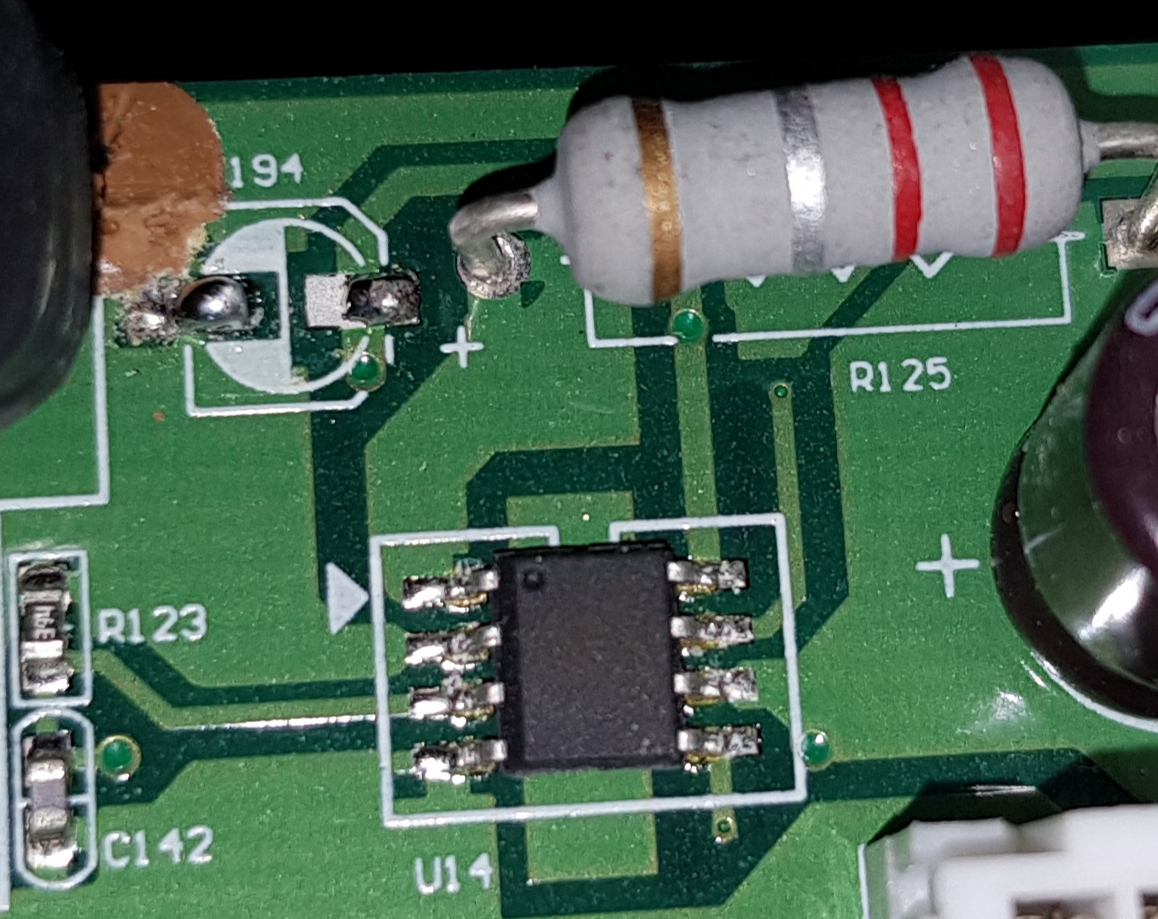

                        aic1563 is a dc-dc converter chip, see https://cdn.badcaps-static.com/pdfs/...e3e0e01d7a.pdf
                        check example circuits in datasheet and compare your parts with circuit.i have hunch it may be input capacitor for the chip... if so this cap must meet some minimum specs like max esr, ripple etc and a 100uf polymer or tantalum is probably meeting those but an 100uf electrolytic capacitor would not, so i guess they probably went with whatever capacitance and voltage rating combo they could fit and meet the requirements.
                        my guess is 50v rated, 330uf or something like that... though kinda small for such big values. 0G is also code for 4v voltage rating on small caps but usually theres at least a space before or code is by itself on a line... it would be easier to just desolder and measure.
                        remove that brown "glue" wherever you see it, it's not supposed to be brown. that material had bad chemical formula, as it ages it goes bad and becomes conductive and can short traces and contacts under itself

                          This Capacitor is 1µ 50v, G series,
                          311= 2003, november
                          • R_J
                            • Jun 2012
                            • 9555
                            Re: Cap. plague in Minolta DiMAGE Scan Elite 5400?
                            If you look at the pdf of the ic, this cap. is most likely C3

                                A big thank you to you ... Indeed, the device dates from 2004 and capacitors have on the last line from 308 to 311 which corresponds to a date of manufacture in 2003. The diagram of the integrated circuit also confirms the value . I am going to mount a chemical capacitor of 1uf 50v and I come back to you to tell you if everything is back in order ... Good Sunday ... God bless you and America... Bertrand

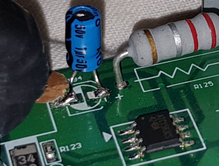

                                  The brown run is neoprene glue that is next to the winding of a self ... But anyway, the capacitor is dead ... Thank you for your comments ... Bertrand

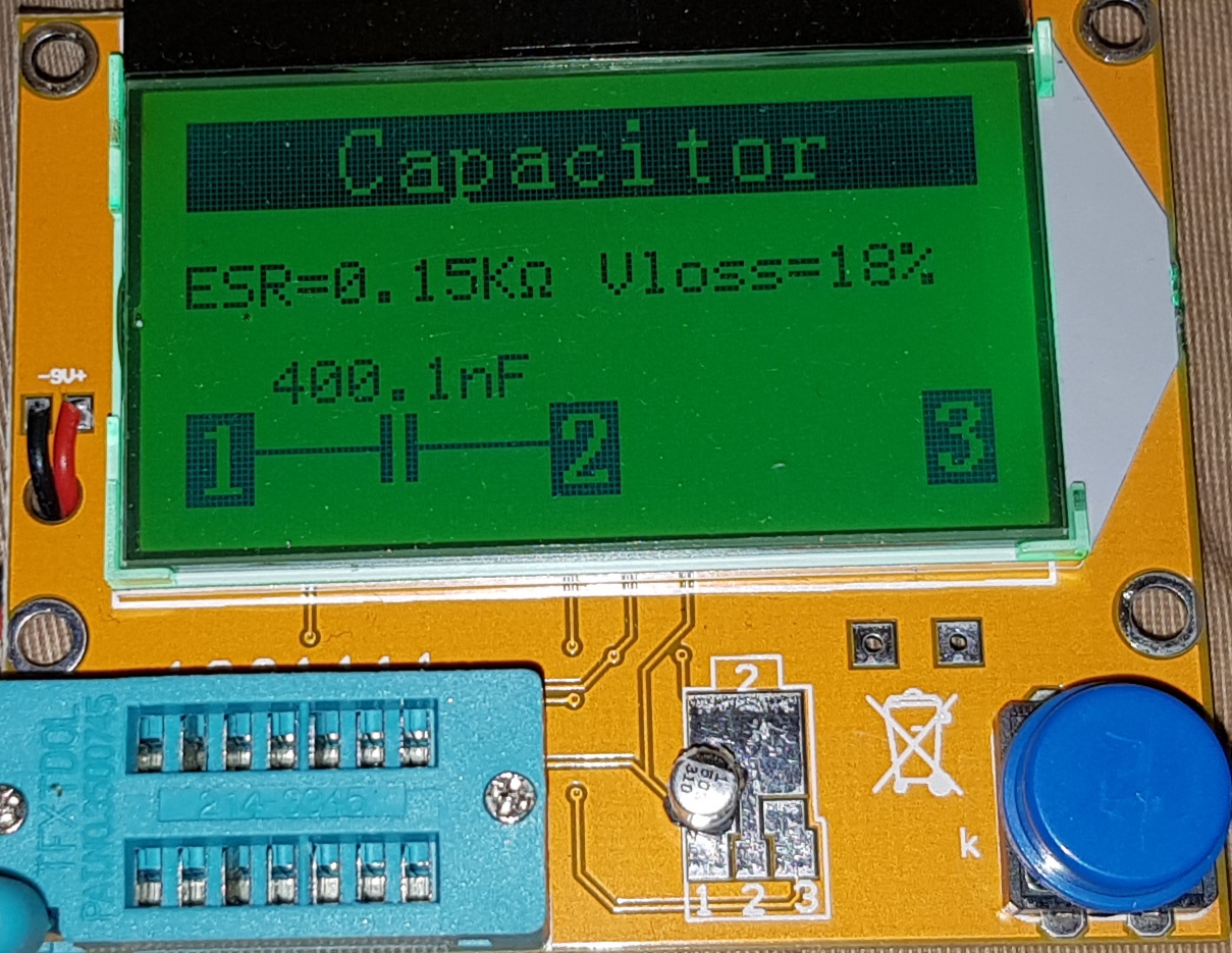

                                    After replacing the capacitor with a conventional chemical, the scanner works perfectly again. Thank you very much for your help, especially for reading and interpreting the characteristics of the faulty capacitor...
                                    The defect one have less than half its original value...
