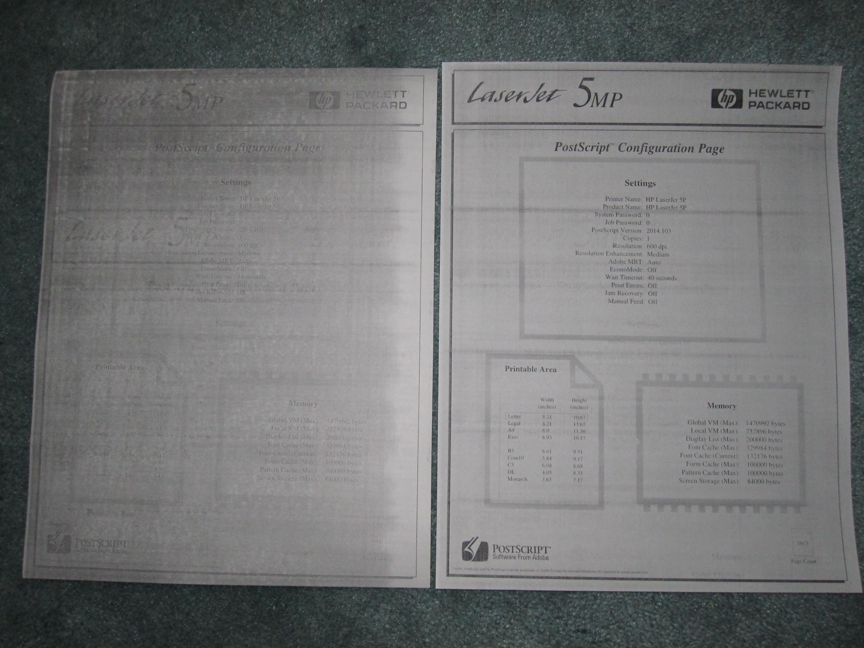

                                I have three toner cartridges for the 5P and the 5MP, and all three of them streak darkness on both printers. The two "original" cartridges do this, and the new old stock cartridge also started doing this. Hard to tell the cartridges apart other than "darkness" of the actual print as I'm sure one of the cartridges is pretty much empty, yet it still seems to gray out the pages.
                                I was thinking the wiper blade in the toner cartridge too, but not sure if that can be replaced.
                                I was able to pull the transfer roller. I suspect I should either use compressed air (hmm. Maybe I should get an inline oil remover for my automotive air compressor) or vacuum it to see if I can get rid of the toner collected on it.
                                Attached is from the 5MP from two different cartridges. The one on the right is from the "newer" cartridge. The third cartridge is somewhat like the one on the right, the one on the left is the faintest of all the three but darkest background... The third cartridge has printing defects that I'm sure is caused by a scratched photodrum but also has the dark background.
                                The 5MP has it's darkness setting at "2". Both the 5P and the 5MP print very similarly depending on which cartridge is inserted but always has that gray background hue...
                                (and woah, this 5MP is just a baby. Not even 4 reams of paper has gone through it.)

                                  I think I sort of figured out why cleaning the roller helped, it was a false flag of sorts. I'm pretty sure it's one of the scrapers in the toner cartridge indeed. Cleaning off that roller worked because that roller was cleaning all the excess toner off that one of the scrapers in the cartridge wasn't doing, and was doing its job until it got full of toner, and then it would just splash toner everywhere.
                                  I guess now it all makes sense.
                                  I wish I could replace the scraper in the cartridge, or somehow fix it temporarily...
                                  I just don't get why the scraper failed well before it ran out of toner... even for new old stock cartridges. I suspect for refills it would make sense.
                                  Then the other question is how to prolong the life of these scrapers - cool? humidity? what else could make it last longer?
