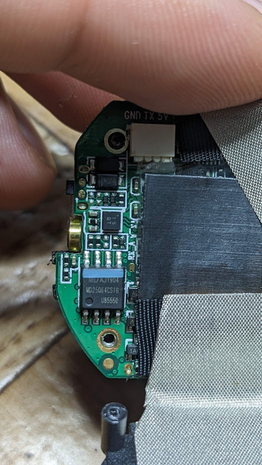

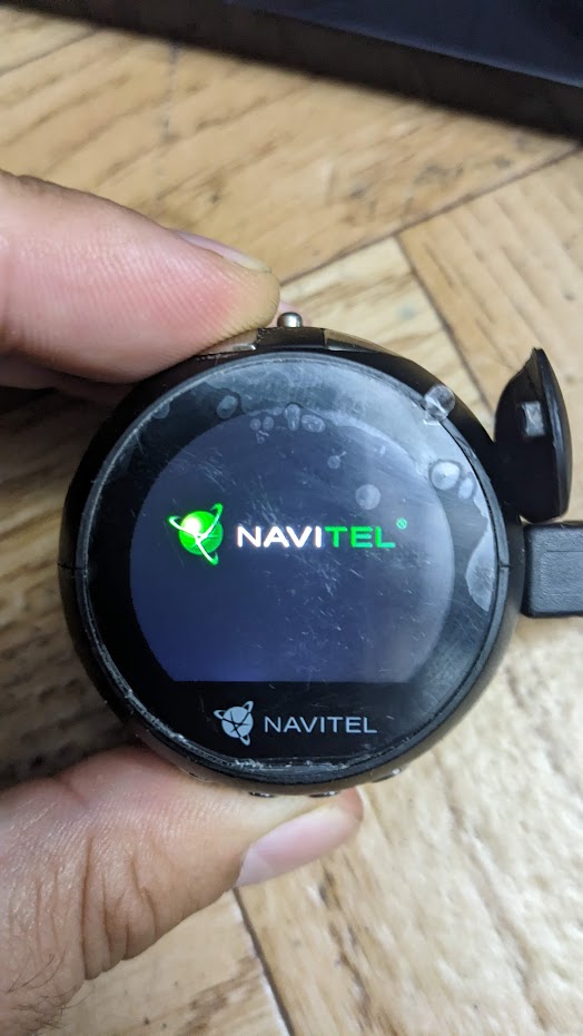

    This camera was flashed by the owner and after update it starts displaying NAVITEL and that is all.
    I have contacted Navitel help , they sent me one file called SdFwCode.bin and the firmware SD_CarDV.bin which i have uploaded here in a zip file together with a backup of the actual dump thats on the camera.
    These two bin files they say that i have to copy into an microsd card formated fat32 not bigger then 32Gb and to install the card into the camera.
    So first i had to press the M button on the camera , while keep pressing it i have to plug power cable into camera then press power button while keep holding the M button and the camera was suposed to update the firmware but it my case it does nothing. I have tryed with several micro sd cards, i have also programmed the flash memory with my programmer using the SD_CarDV.bin which is the update file from their website but i get no image on the display.
    If someone can help me compare the bin that i made a backup of with the one from their website and maybe we can make one good bin from the two files.

      Hi Thesame.
      Your files are fine, the SD_CarDV.bin file is the same as the 20230823_105532_SVOD3.bin file
      METHOD:
      01. FAT32 card format in PC
      02. upload files SD_CarDV.bin + SdFwCode.bin
      03. insert the SD card into the switched off camera
      04. hold the M button
      05. connect the power cable directly to the camera
      06. STILL hold the M button + hold the ON button until the RECOVERY message appears on the camera display.
      07. release the buttons and wait until the Navitel logo appears on the display and the camera turns off.
      08. turn on the camera with the ON button and make new settings - everything is in factory settings.
      Good luck.
      Peter
      PS: I'm using an automatic translator, so I apologize for any mistakes.

        I have tryed it several times, i have to check the M button to see if it actually works like STJ replyed, it does nothing when trying the recovery procedure, display is black, i was holding both M and Power with the power connected for 30 seconds and the display does not turn on, only when releasing M and pressing power button it does start displaying the logo.
        Then if the both files are the same why when i flash SD_CarDV.bin with the programmer i get no image?

                      I have formated the microsd with the tool copyed files but with the same problem, i think the microsd are ok , the problem is in the camera itself.
