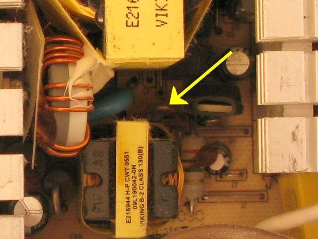

Re: Antec TruePower 2.0 TPII-550
It is a critical cap, if it fails 5VSB will go high and kill your mainboard
Increasing it's voltage rating is a small safeguard that will make the capacitor withstand voltage spikes etc better (If memory serves, which it well might not, I think Wizard did a test where it was found that there could be quite high voltage spikes on this capacitor...)
