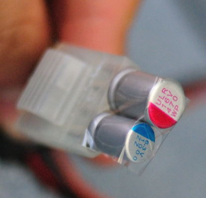

    is this a good way to use polymer caps?
    I have some unused polymer caps lying around, decided to try them on 4 pin outputs on a PS, parellel to my DVD rom. nothing bad seemed to happen. maybe or not, my digital multmeter shows a kinda more stable voltage.
    I am not good at physics. Is this a good idea at the first place? Can anybody comment on this?
    If I am interested in giving better power to my DVD rom, should connect the caps parellel or in series to the device?

    If that's the connector that's supposed to plug into the dvd-rom, that's not really gonna work
    If that's on a flying lead, that eventually ends up at your dvd-rom, all that length of cable will render the possible advantages, useless.
    They would be most effective if soldered on the input connector on the dvd-rom's pcb, but i doubt there's a lot of room left in there. If your drive hasn't been giving you trouble, what are / were you trying to achieve, if i may ask?
    And power supply caps go in parallel with the load.

      thank you for your input.
      I use the device for retrieving WAV from CDs, where accuracy is important. Fluctuations in voltage will degrade the signals quite badly, and I see this happen in my work. I already recapped my PSU, but with all with same capacitance as it was. so just wondering if there is any better way in getting more stable voltage from a PS.?

        if you are using same PSU for system and DVD-rom device, noise always happend from the system due to power consume dynamically by CPU,RAM,HDD,etc.
        you may use another PSU for DVD-rom separately to reduce that noise.

            normally, CD/DVD-rom device are using +12V and +5V from PSU by a MOLEX connctor, the computer's PSU have no output greater than 12V to be used to enter voltage regulator circuit for 12V and 5V output.
            another way, use any PSU for the CD-ROM which has play/stop button (without computer), you may be get clear sound.

              Retrieving WAVs? As in "ripping"? I highly doubt you'll improve sound quality with caps and such, since it's all DIGITAL... (That's one of the differences between vinyl and CD's ) Now, if you were ripping vinyls, a re-capping might've helped the turntable and/or the audio interface.
              But feel free to correct me if i'm wrong
              And it's quite likely the controller inside the dvd-rom might have some regulator of its own, so... Unless you're ready for some "on-board surgery"...

                                Hi all, i didn't have time for a bit to bit comparison from different drives. But while playing with the caps and drives I got a pretty nice bonus.
                                I remember I mentioned the 'crap' Benq drive. It always failed to eject discs while upright. then I found
                                FSP 350w power with or without extra polymer caps.. still fail
                                Delta 350w power... fail
                                same Delta unit with extra polymer caps, it works!
                                I will disassemble the benq drive and recap it as well. Will post updates.
