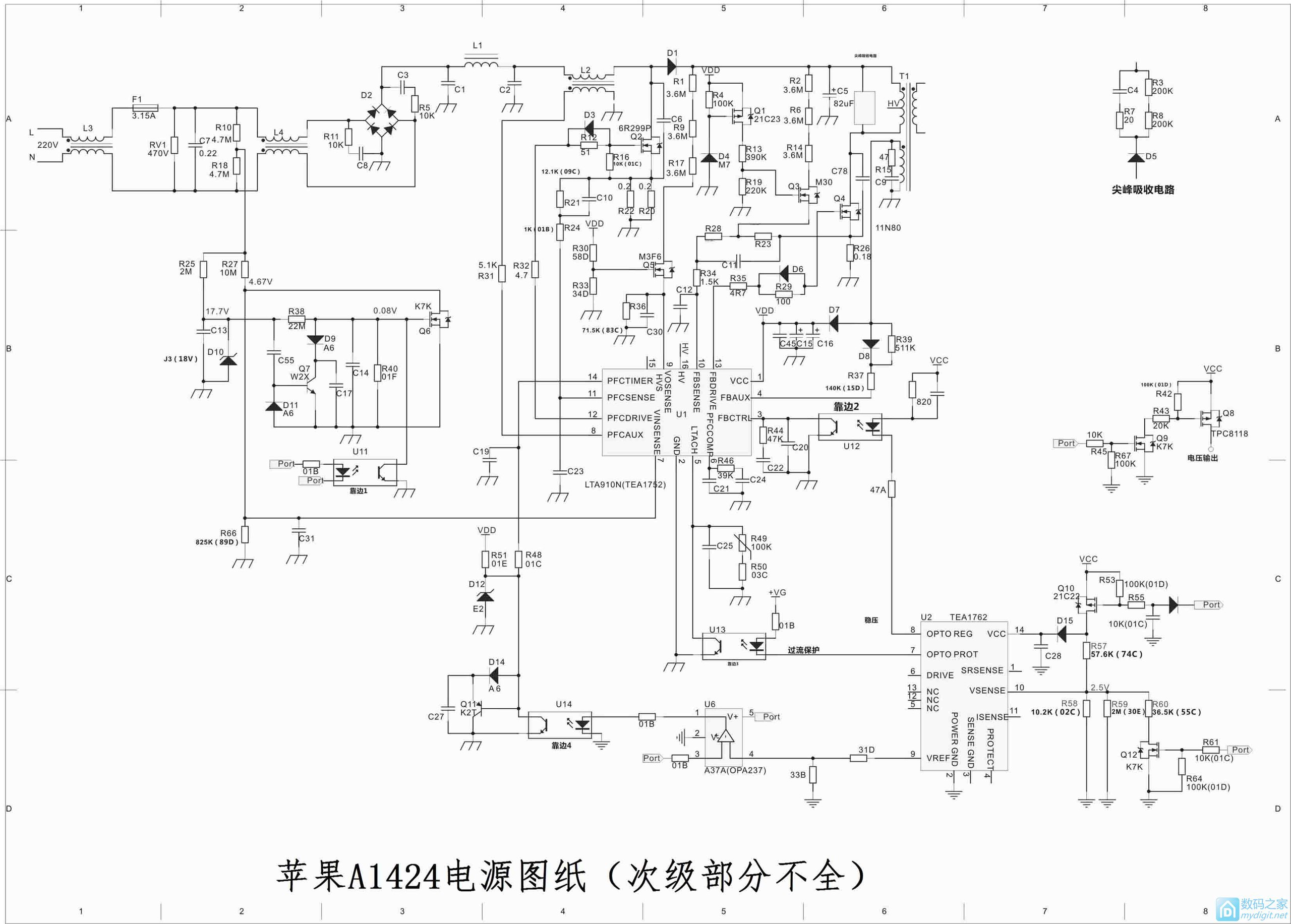

    Re: Apple 85W MagSafe Power Adapter - blown - help with component identification
    Here I found a diagram on the A1424, maybe it will help in something.
    • duwane
      • Mar 2022
      • 57
      • New Zealand
      Awesome thanks. I will check through this and see how much of it is accurate for the A1343.

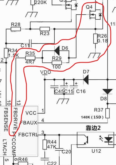

        Just did a brief check through it, and found the following section (see image) which pretty closely matches the section of the circuit that I am trying to find the value for the burned resistor.
        I think a value of 0.18ohm for R051 in my case (R26 for the A1424) is what I am going to go with, as my gut feel was 0.17ohm based on what I could still idntify from the resistors burned marking. Thanks again foir posting this!
