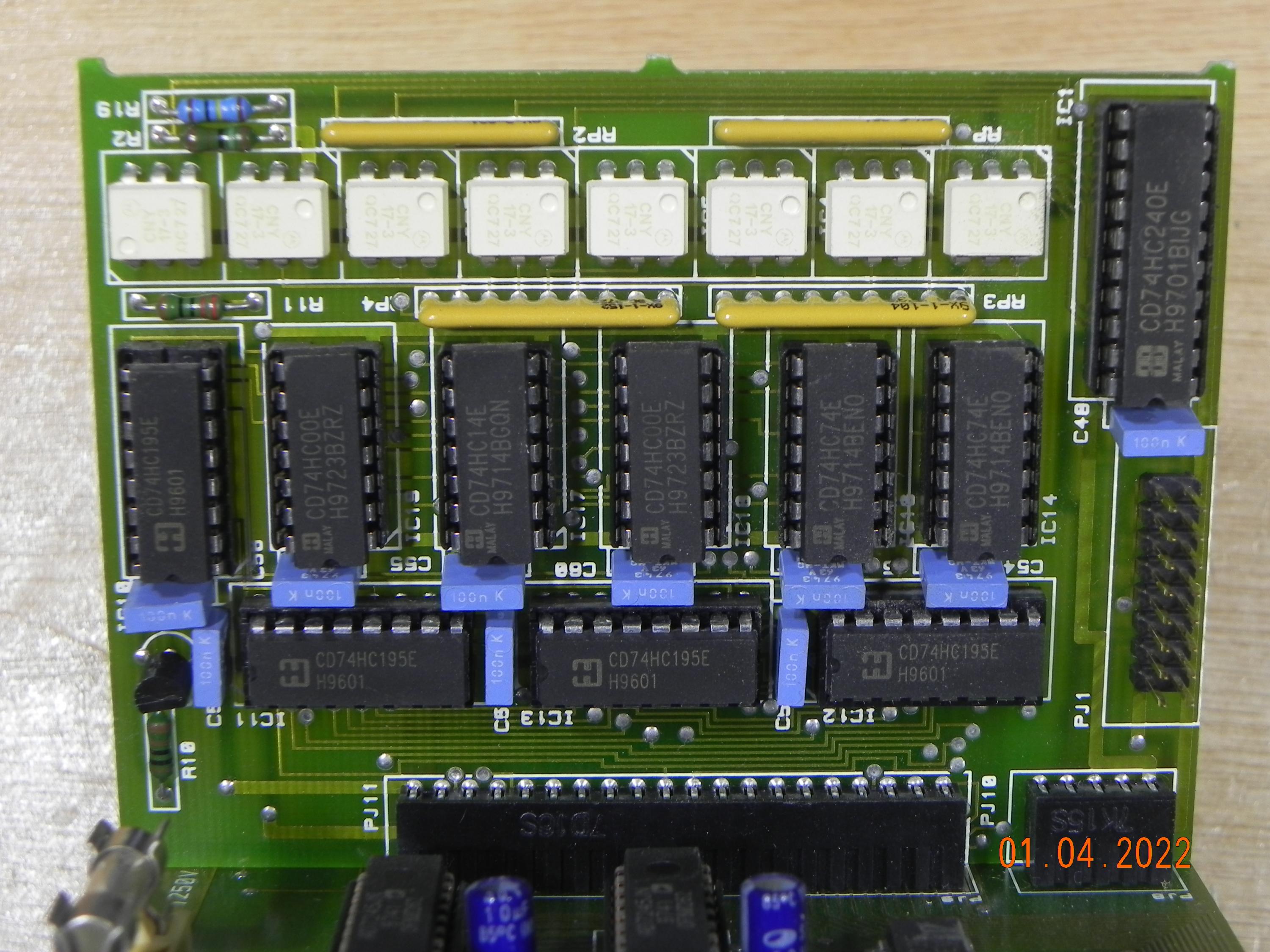

    Hello First i apologise if this in the wrong place or format ect.
    Please let me know. i have 2 thurlby thander TSP3222 lab/bench psu's
    1 of showing fault codes 061 and 022 the other no display but a few leds lit on
    the front panel.
    Has anyone got a service manual/schematic all i have found online is a 2 page intro with spec. i have emailed tti a week ago but no luck so far
    Thanks in advance and hello to all
    • Jul 2011
    • 6037
    Re: REQUEST for help and info TTI TSP3222
    Post some pictures of the boards that are in this device and might be able to help you with it

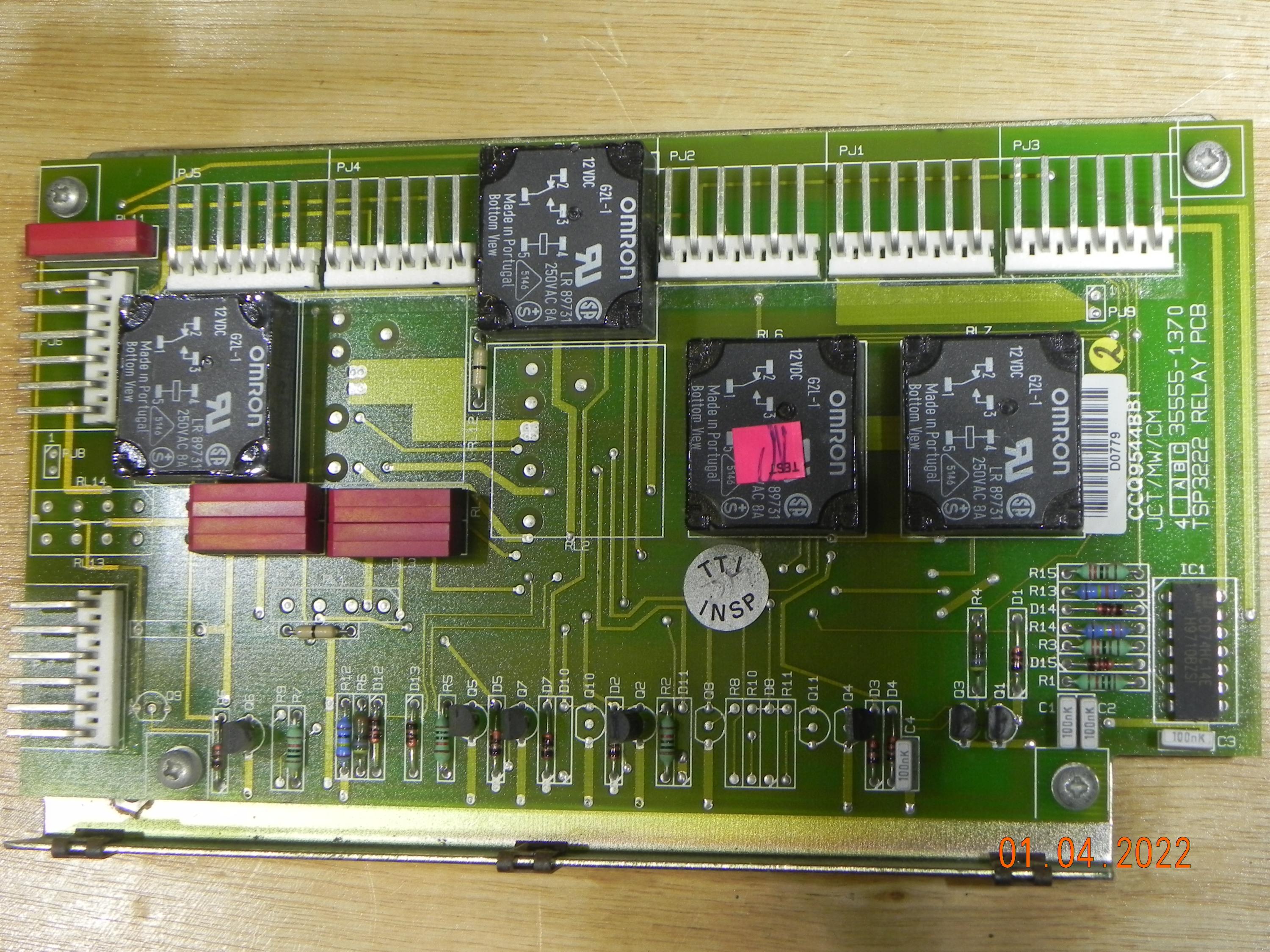

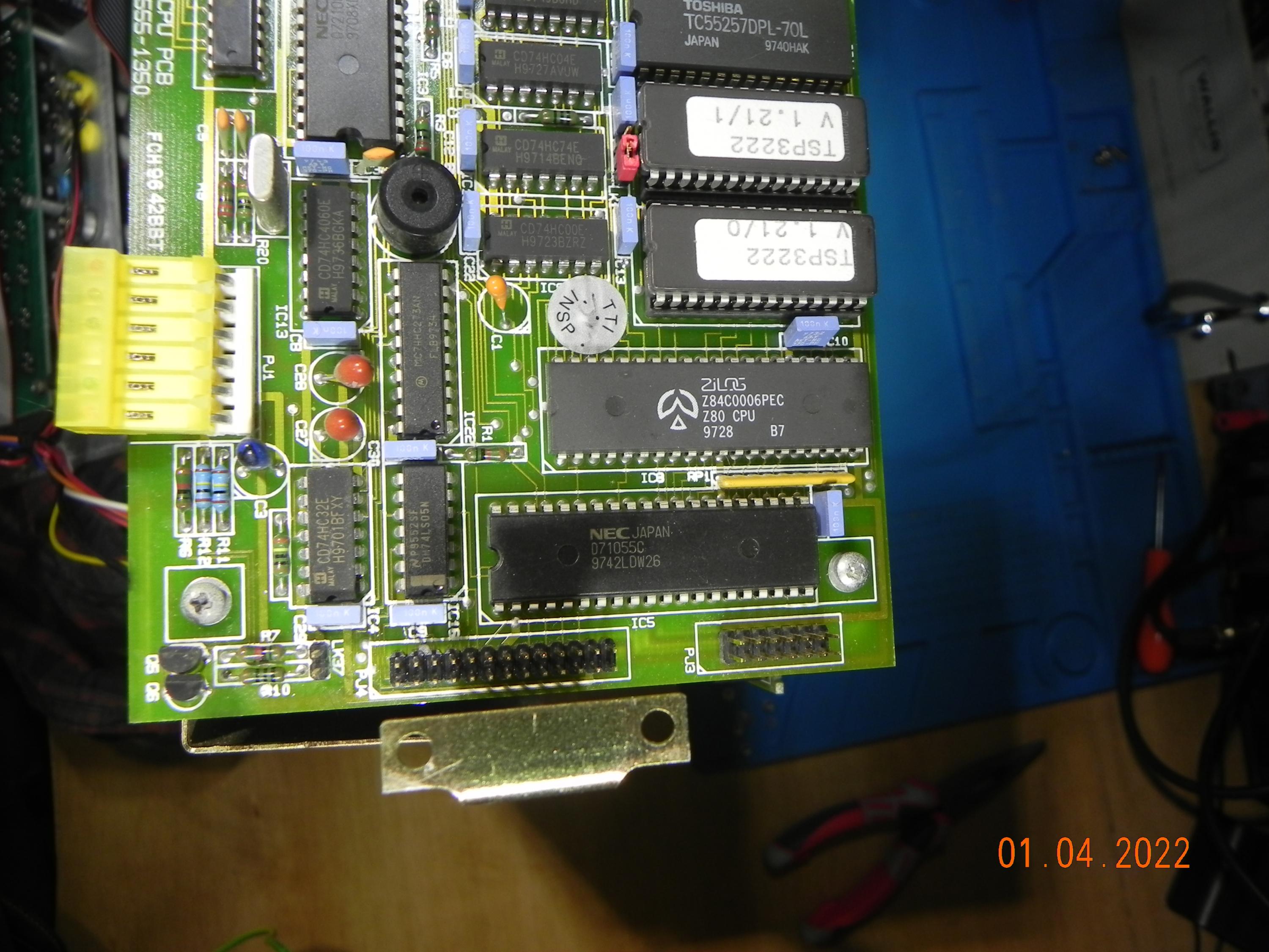

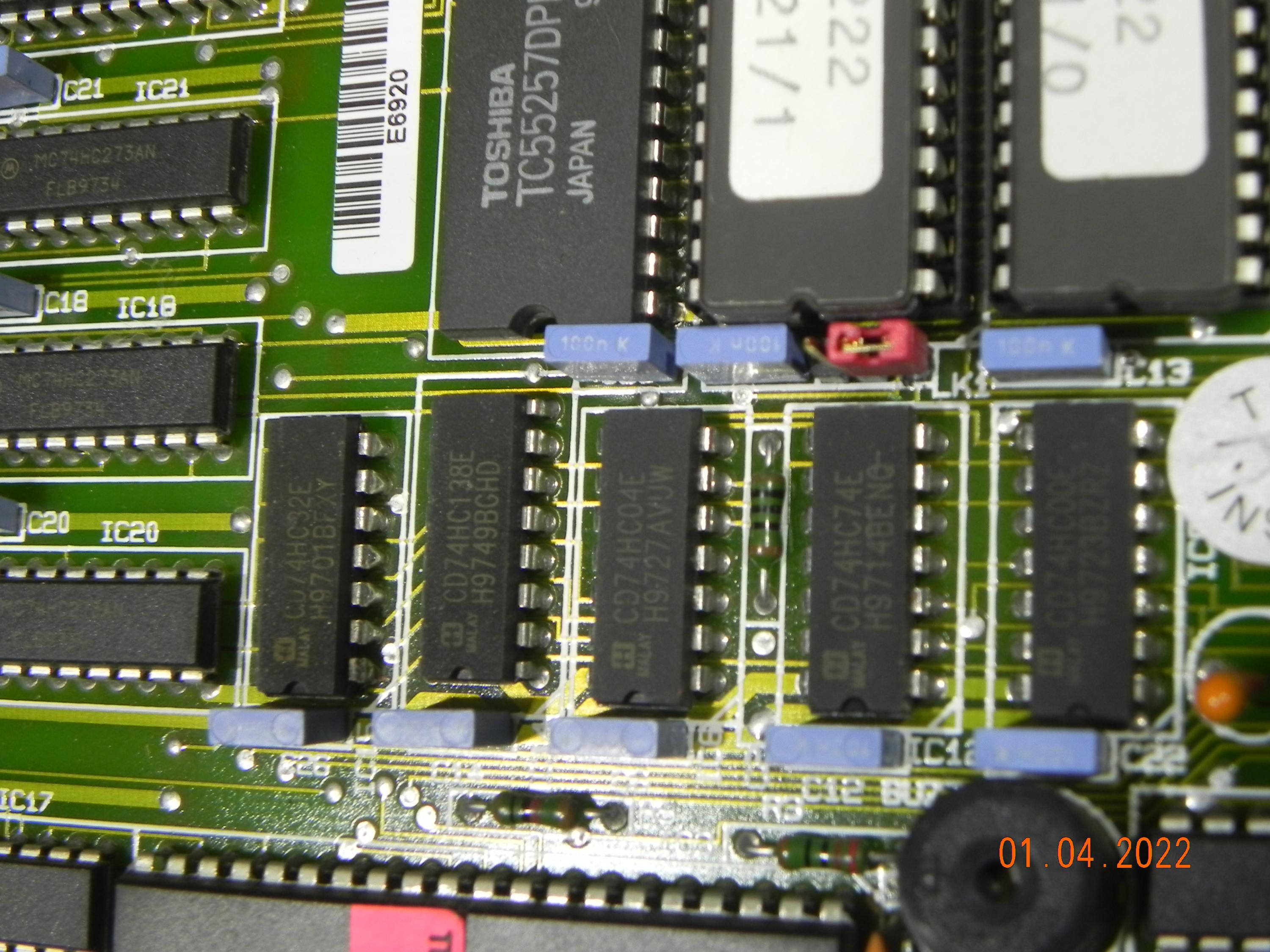

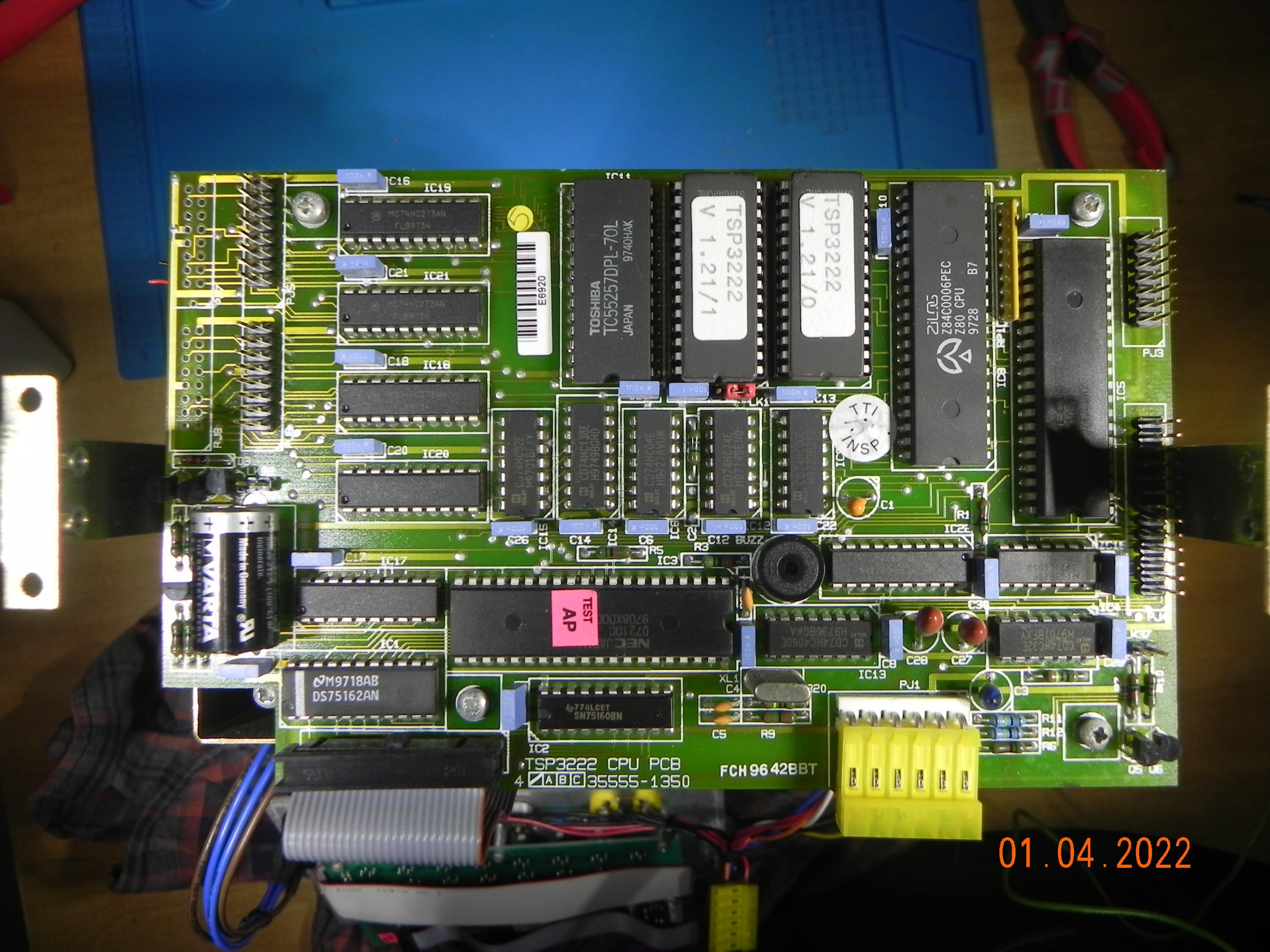

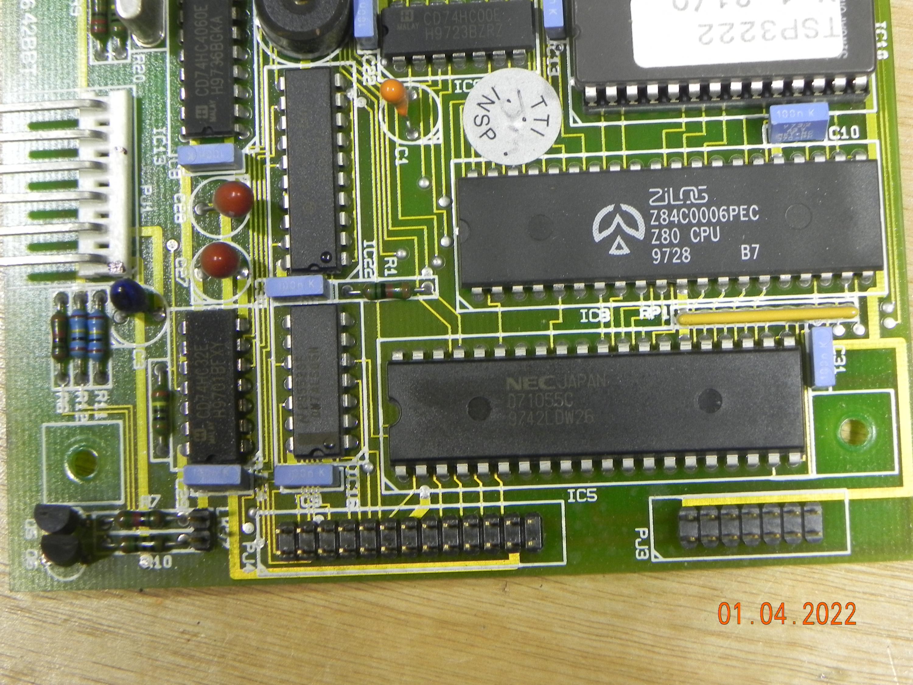

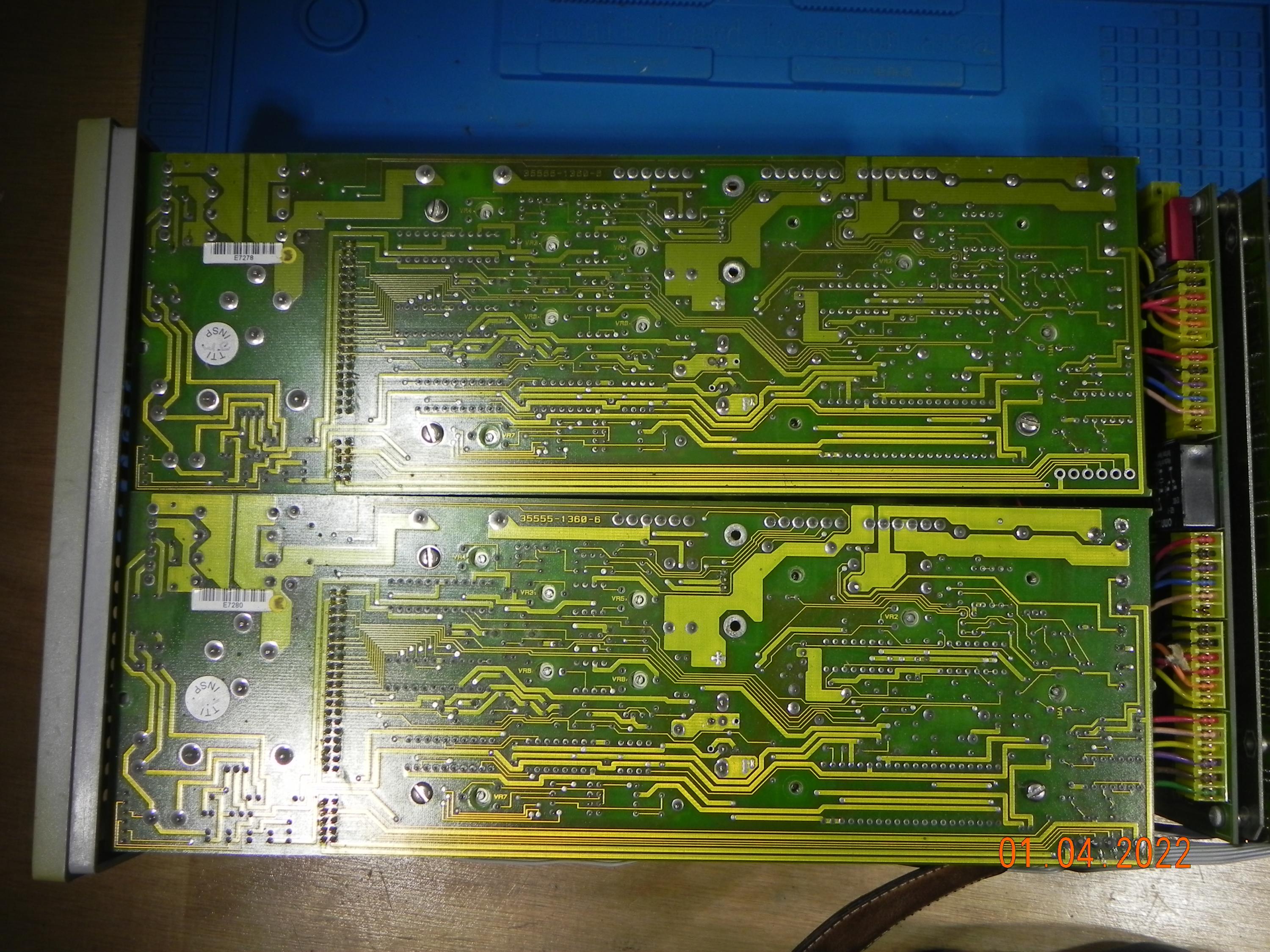

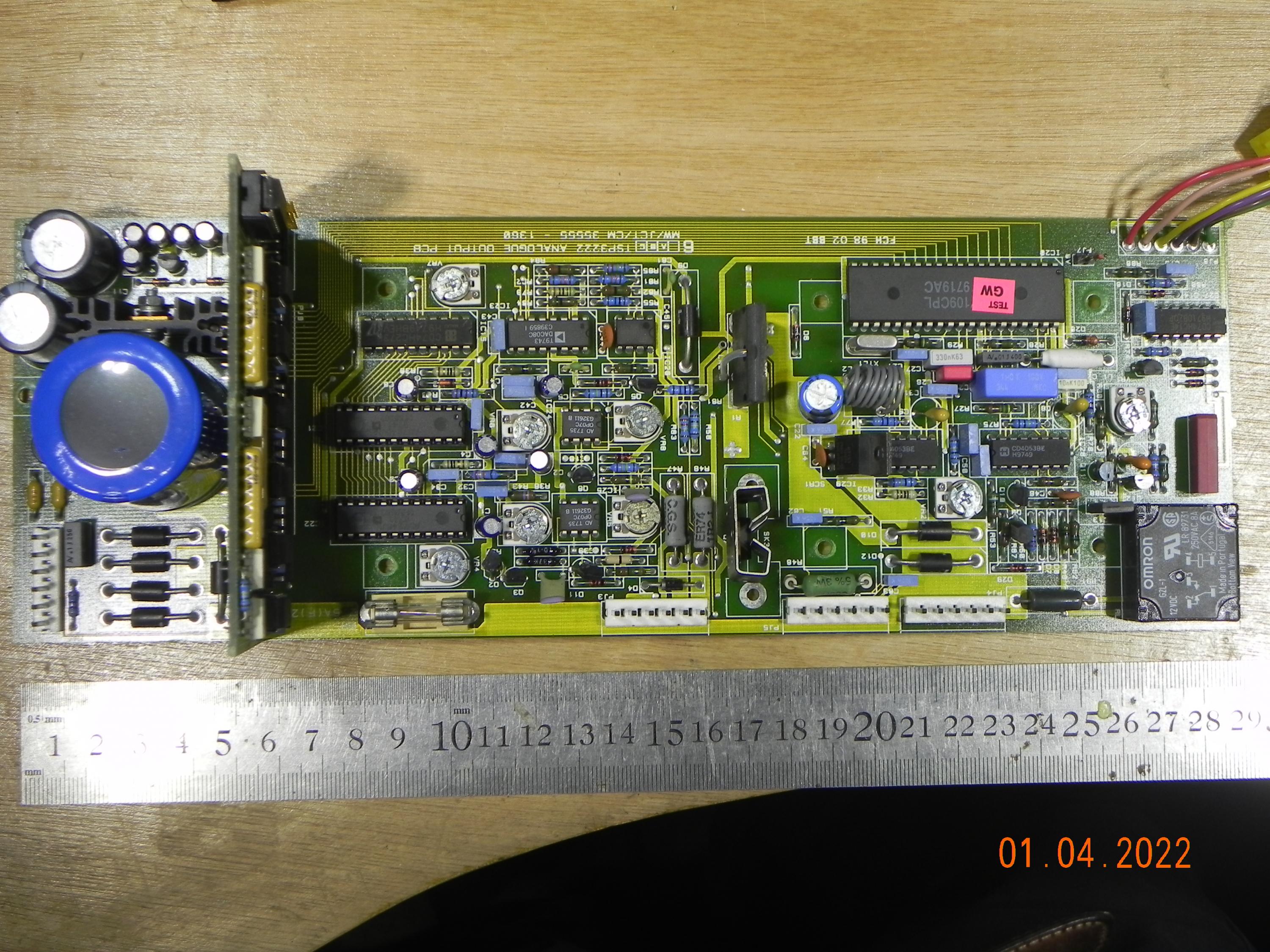

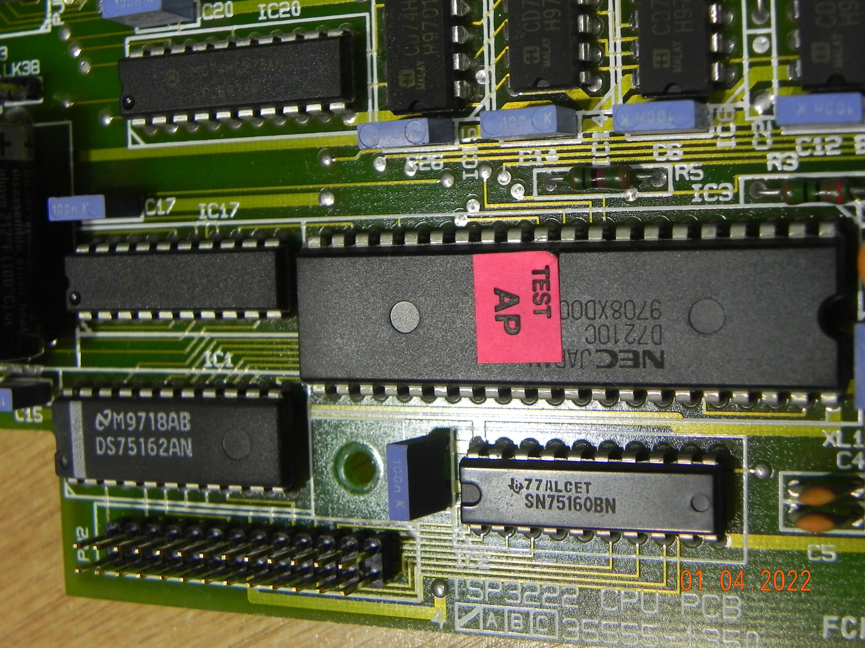

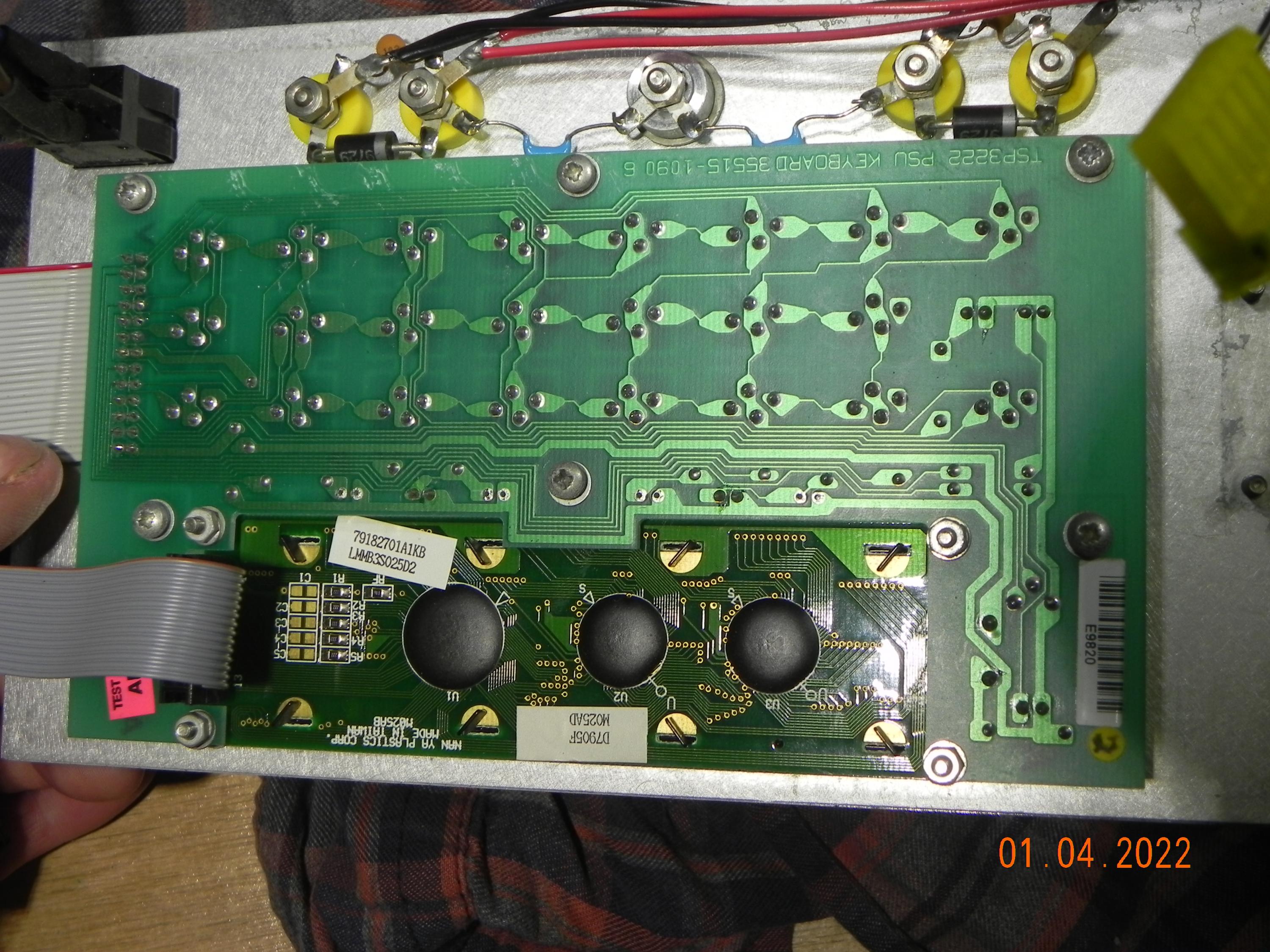

        ok so ive done the PCB photoshoot.
        not really tested anything but the bat on the cpu brd which shows 3.1v .
        im planning to carefully remove the big stickers from ic7 and ic10.
        but im wary as im out of my depth with cpu/memory stuff in particular ....
          I would leave the stickers on the eeprom ic's, they are not likely your problem. Do you have the operators manual?
          Try emailing them again, other people on other sites seem to have good luck getting information from them.
