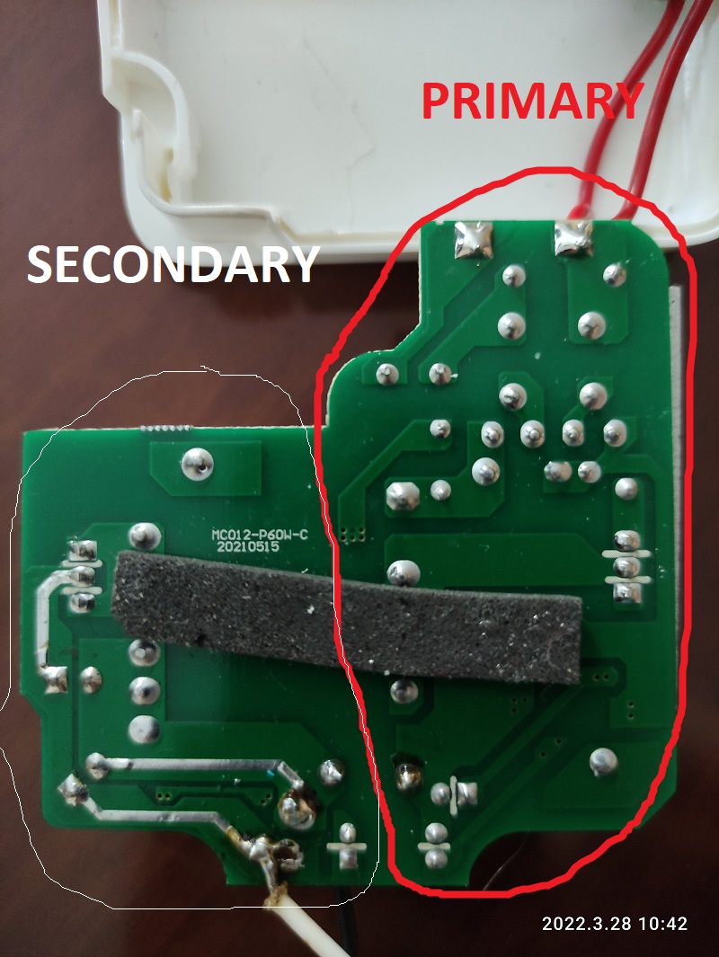

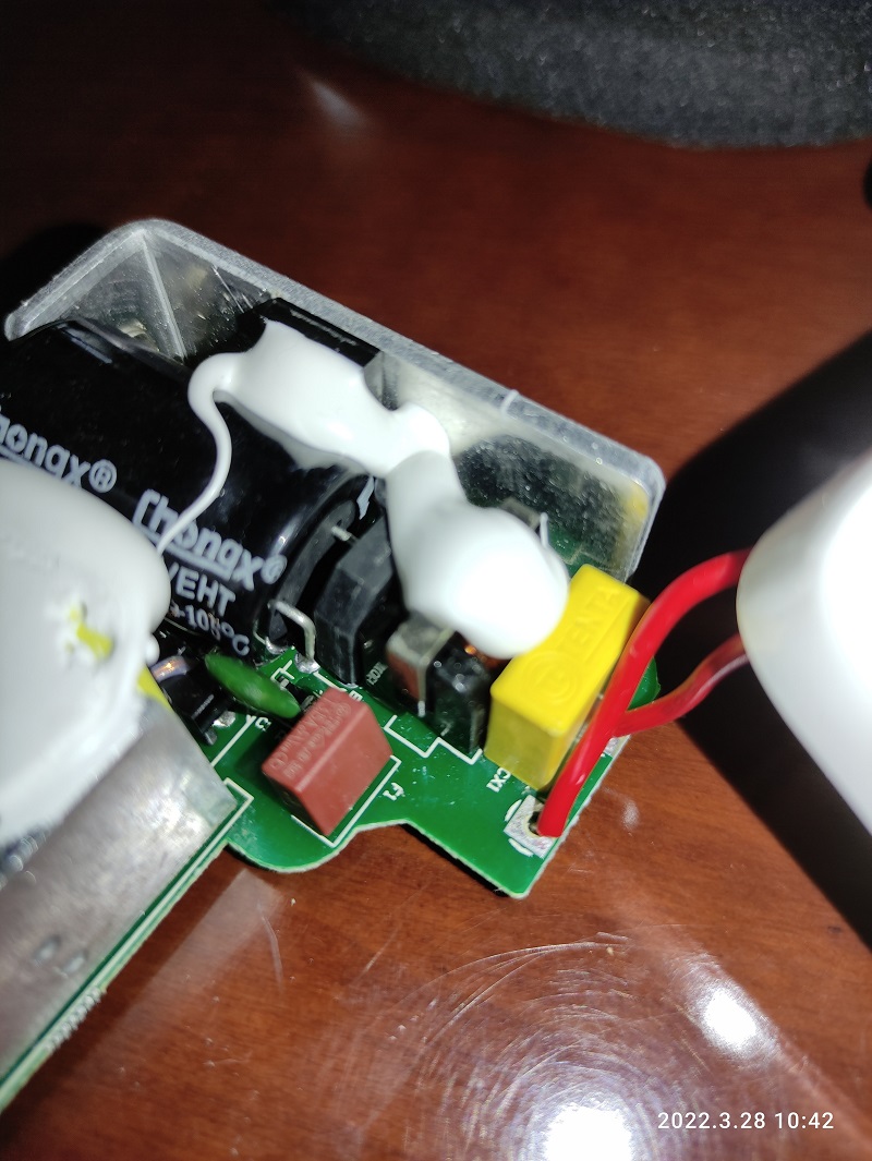

              Originally posted by cruiser_
              [...] there are proper gaps between the sides. [...]

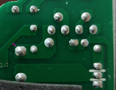

              I can see one spacings violation (pic related), your usual chinese screwup that would fail any safety certification.
              I would say you need better common-mode filtering which can be done at the input or output or both.
              Usually the primary CM choke is small inductance value for low cost, if you have another you can temporarily add it to the mains input of the adapter, like adding a second stage. Although it is a dangerous experiment. Just to narrow down if the noise can be lessened there. Or go to town with the ferrite clamp choke # turns to achieve the same result.
              On the output side, adding a CM choke you get losses, a voltage drop so it is not the ideal place.

                Re: Generic Magsafe charger ghost touches
                The two pins are both on the primary side, I thought the worst were small gaps between primary and secondary?
                On the input, this adapter has X rated 0.1uF capacitor, double coil (each has 1400uH) and 4.7nF with 10k resistor. My other coils are in the 0.x uH to hundreds uH range so I guess no point in adding them here? Pretty similar to the filtering section in
                I used HT2629H ferrite clamp on either input or the output, no joy.
                I even put the adapter in a metal bowl and covered it with a metal cover
                I do not have the original charger for comparison unfortunately... but I hooked up some old Delta 19V adapter (II class too) and the touches were gone so it must be doable!

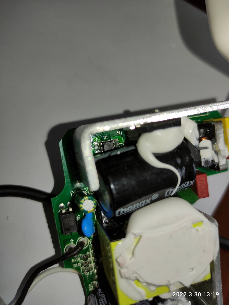

                  How much space is there on the secondary side between the output filter caps? Could we see more picture of the whole adapter from different sides?
                  If there is a little bit of space on the output side, perhaps you can try adding a "PI" coil (rod core with wire wound around it) between or after the two output caps (if after, add another small electrolytic cap before the output wires, and possibly a ceramic too.) This may or may not reduce the noise enough. I know you mentioned you already tried an "RC" filter with coils and caps... but if you do it on the PCB very close to where the noise is being generated, that could help.
                  If there is more space, you could also add a small CM choke, as already suggest (only needs a few turns, so you don't get too much voltage drop.)
                  Finally, I don't see an RC snubber circuit before the secondary-side rectifier - that could be another source of HF noise. On the above Delta schematic, you can see this with R21 and C21 right next to the output rectifier.

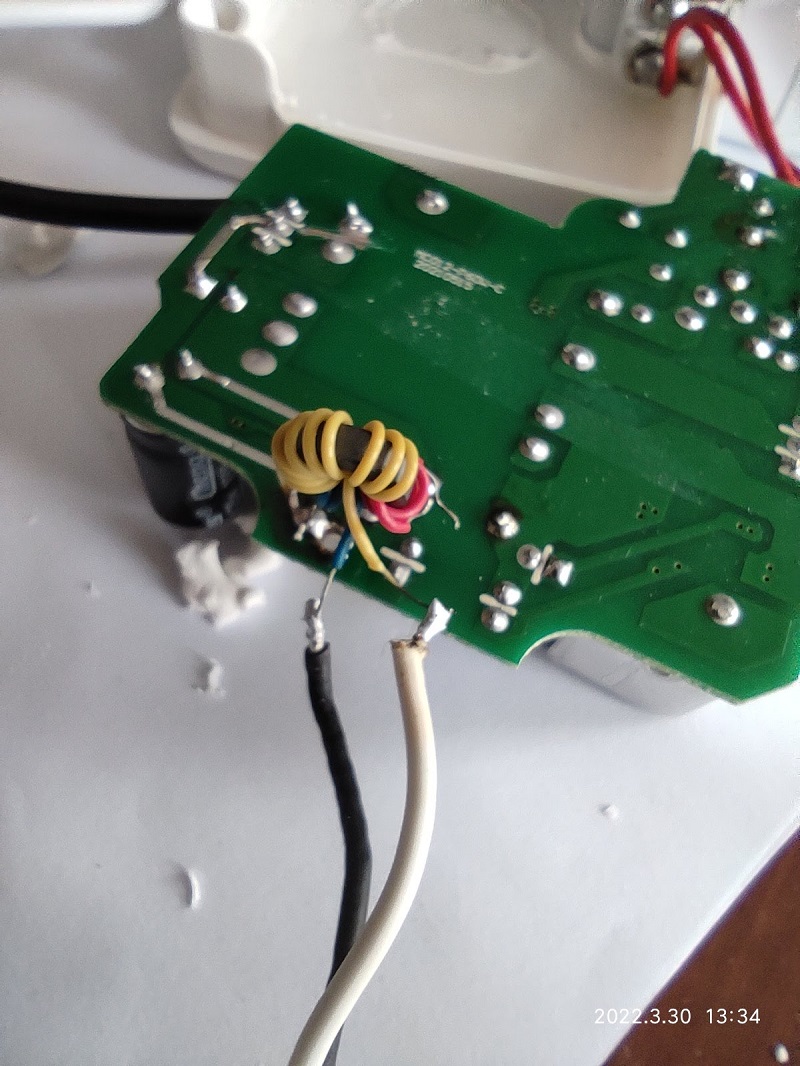

                    hi momaka,

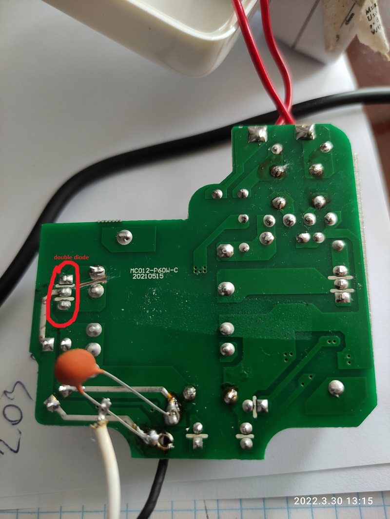

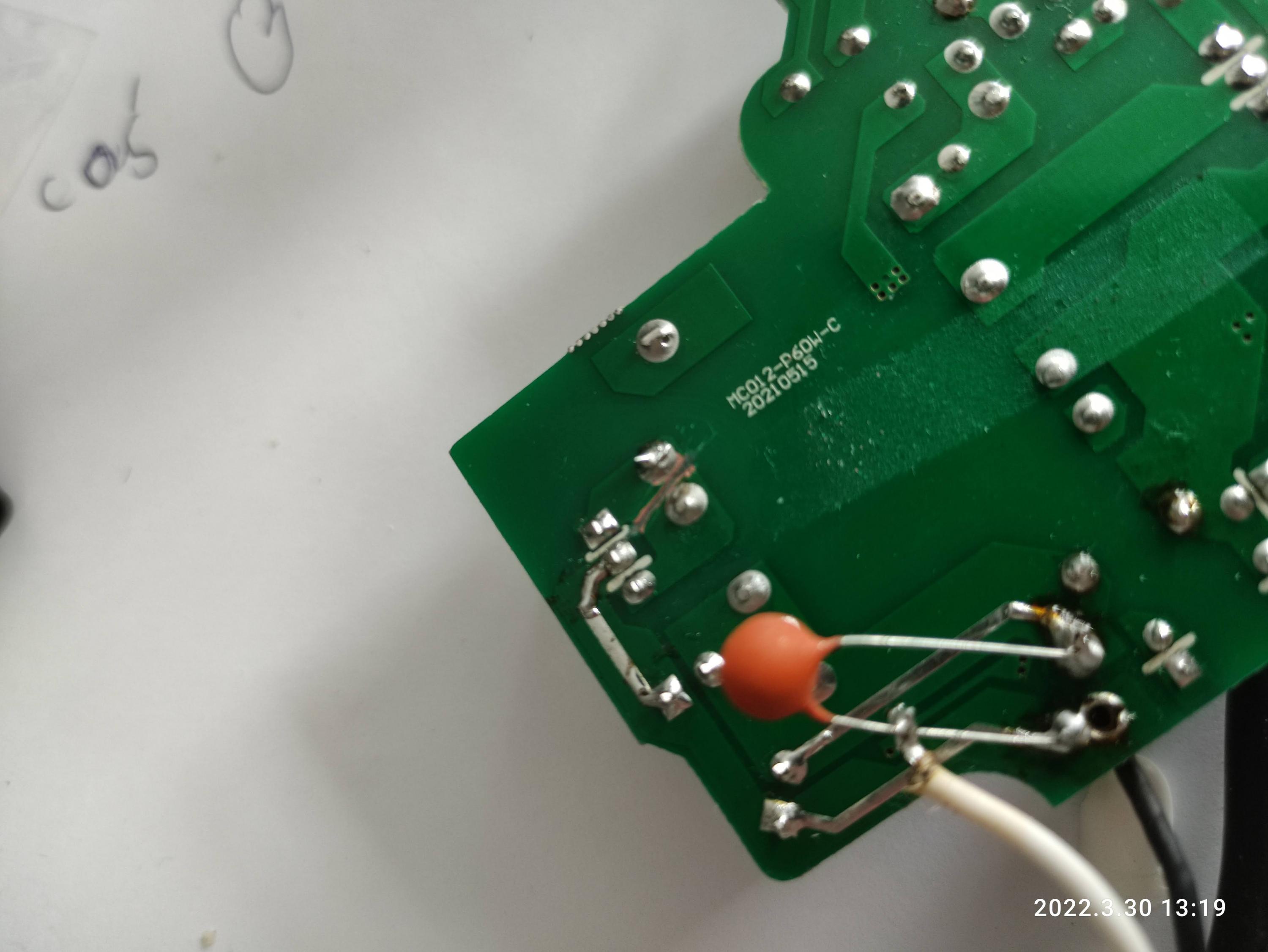

                    attaching some more pictures.

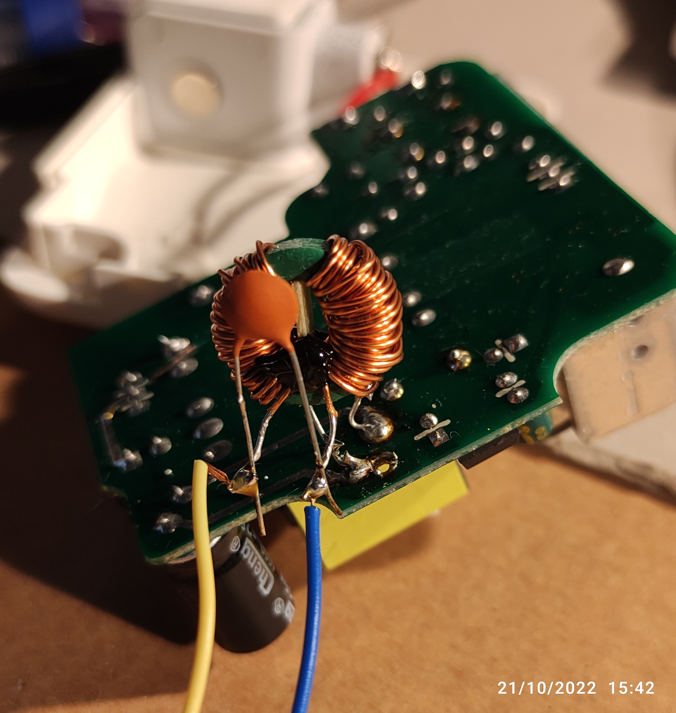

                    Small correction on the lowpass RC filter - I meant LC filter (2nd order) - a coil with a capacitor. With 34uH coil and 2200uF cap it's supposed to filter anything above 580 Hz.
                    There seems to be a snubber on the double diode - I also temporarily added additional - used 2.2nF & 1k resistor (which got pretty hot..?)
                    Also, cut off the trace between two 'legs' of the diodes' input (found some reference to EMI reduction there).
                    My last attempt was to add small coil with double-winded cable, with it the small power board PCB in a laptop went with a puff of smoke
                    Is it possible that some high voltage was induced by this? No-load measurement showed 16.5V there. Or was it just a pure coincidence...

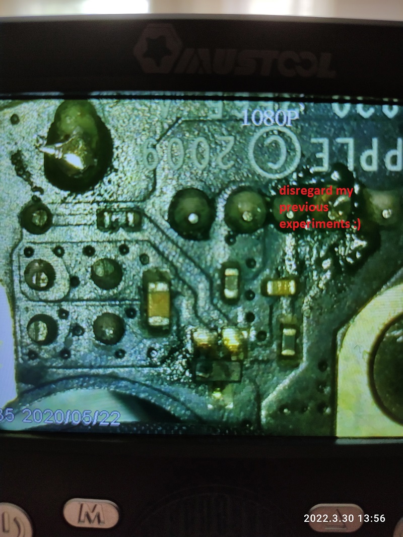

                      ... and above all, just going through the diagram of macbook's board (820-2530, with power board 820-2565-A) I noticed that DCIN is supposed to be at 18.5V, while all the 60W chargers are only providing 16.5V.
                      Anyhow, anyone with a power board schematic? Bear in mind there's a full laptop board under the same number (820-2565-A)...

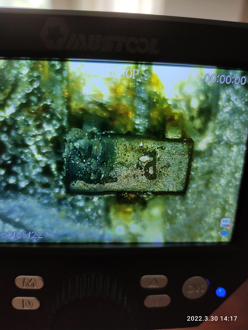

                        board fixed, must have been an accident - TVS diode RClamp2402B blew up.

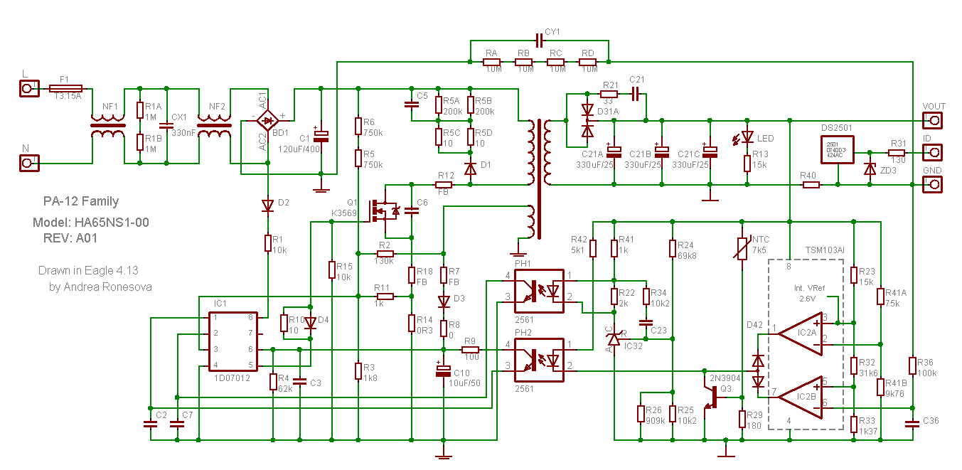

                                The only thing I can think of is one side of the rectifier is leaking ac voltage because in the circuit diagram it shows that there is a capacitor but it also shows four 10 megohm resistors on the negative side of the rectifier and on the secondary side of the power supply it shows that it goes to the ground terminal
                                If this circuit diagram is correct for the switching power supply in question then this might explain why you are having this issue
                                I could be wrong but this is the only place that I could possibly see you getting this voltage from

                                  Hi samsamsam
                                  The diagram is for another, well-behaving adapter which I am trying to mimic in my 'chinesium' one.
                                  I have added common choke to the output, also capacitors before it and after it. Sadly, no difference in ghost touches.
                                  Thought the choke would get rid of common and differential noise. Perhaps this isn't the reason of this phenomenon?
