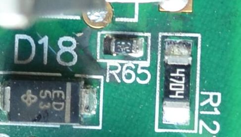

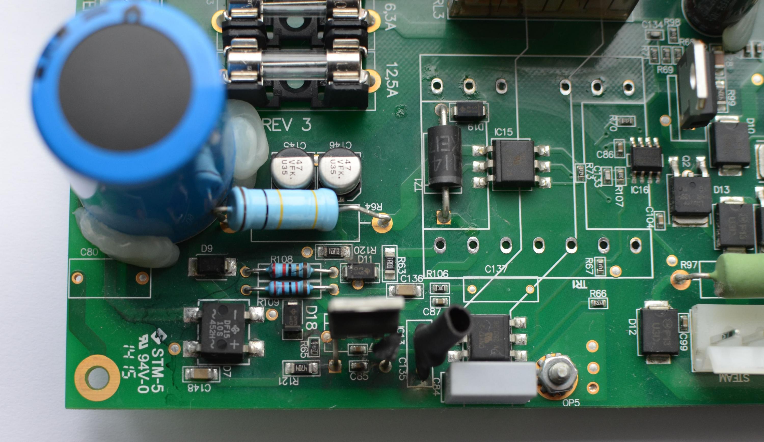

    The mosfet VIPer100A has blown up and damaged also other small components.
    Can you please identify these components?
    C85
    C147
    C136
    D18
    D11
    R65

    The Diodes D11,D18 marked ED are Vishay ES1D
    R120 looks like 10R3 = 10.3 Ω
    R65 connects from pin1 of the ic to where? (see if you can read any of the numbers)
    Capacitors are likely ok if not shorted and are just black from the ic explotion

      R65 connects to the diode D11.
      Numbers on R65 could be: 672 as I can see an underscore under the middle number or 572.
