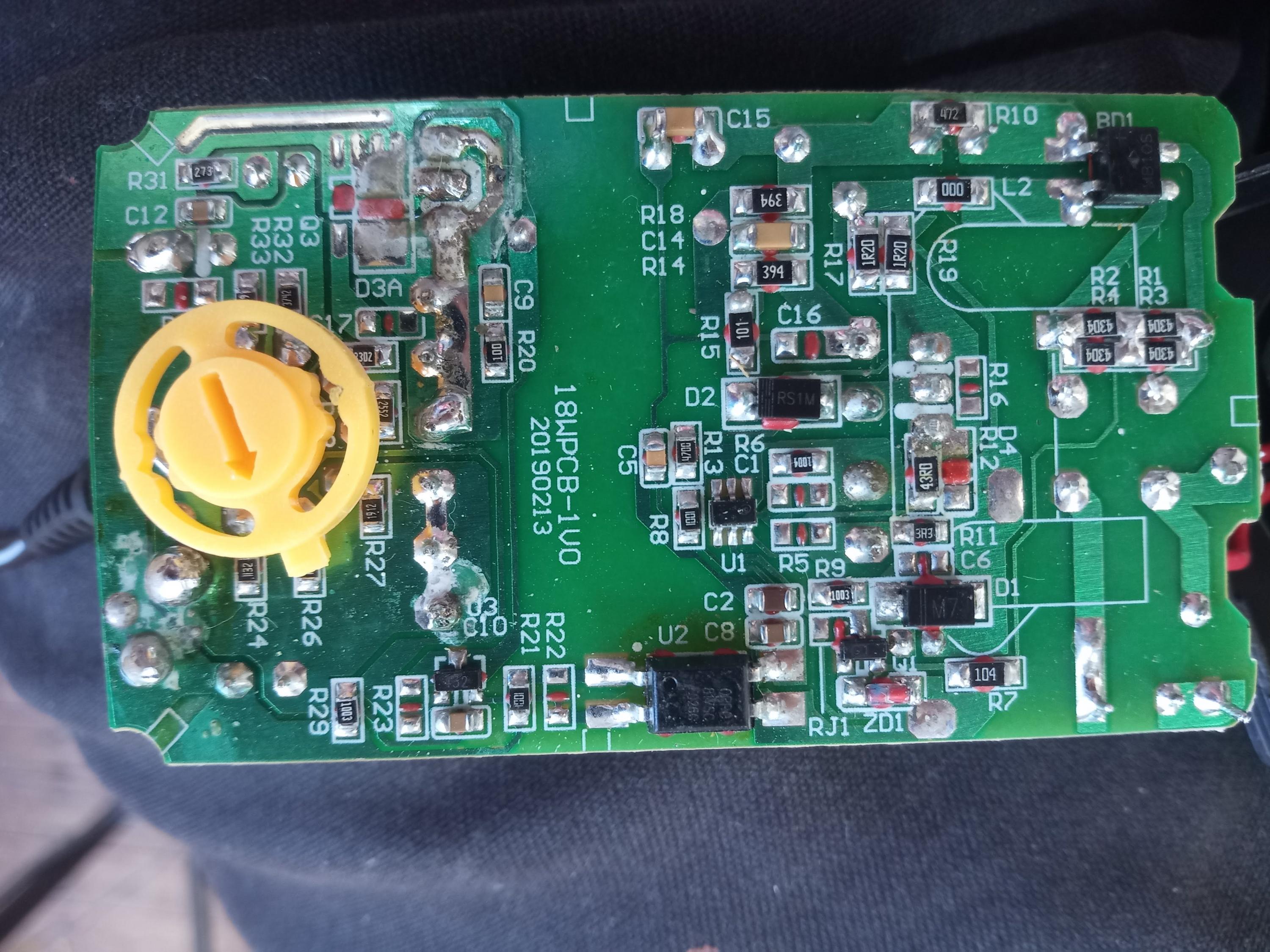

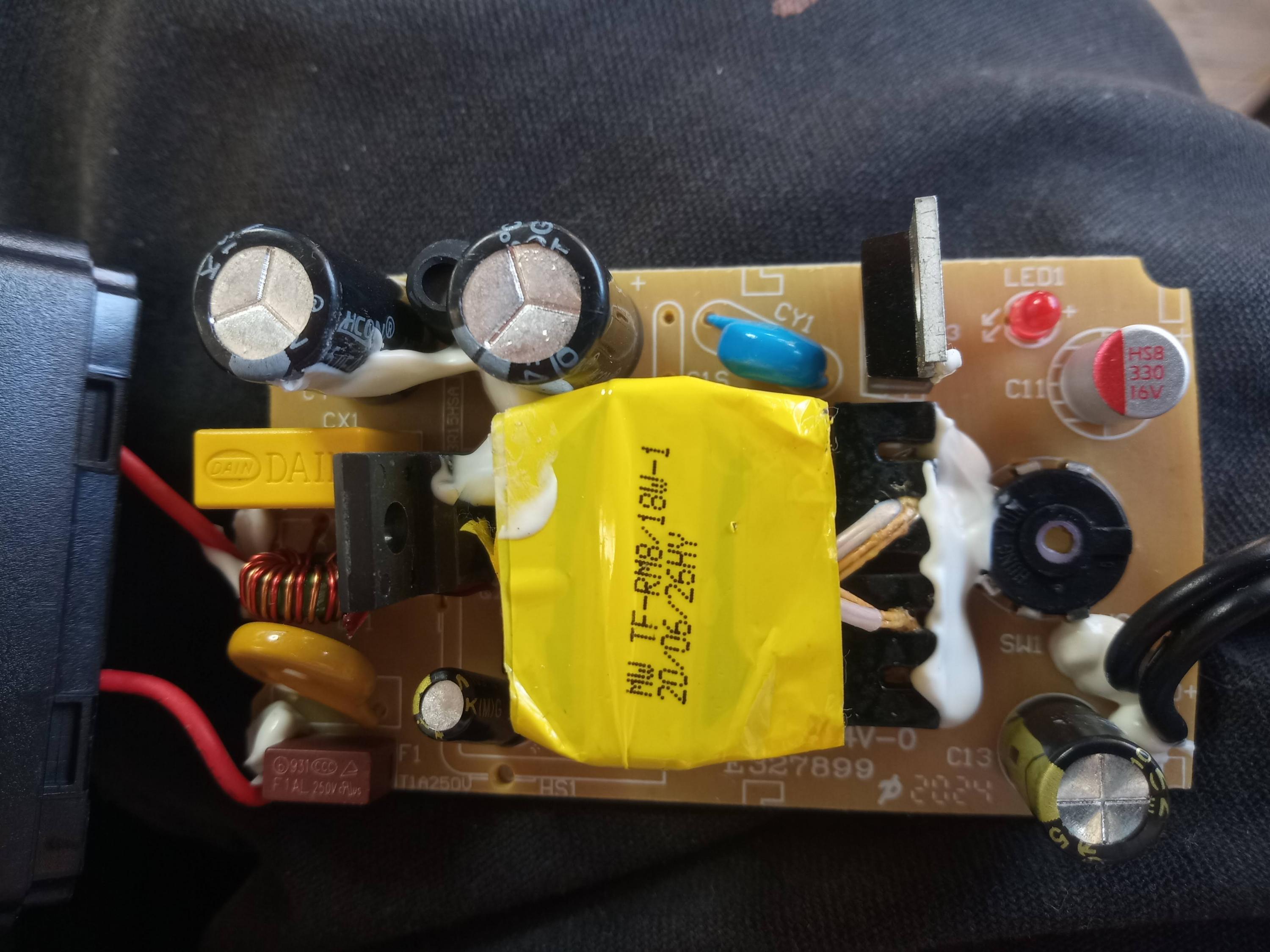

    I know these things are only worth a few dollars, so this is perhaps more an intellectual exercise in understanding what is (not) going on here.
    The model is marked as MP-3314, sold in our consumer electronics stores, and is variable between 3V and 12V at 1.5A.
    Under no load it shows as the appropriate voltage - set currently at 9V. But under load it fails, the LED flashes/blinks as it tries to restart. Meter shows volts come up but fall back with a fraction of a second, repeated continuously.
    What would be a typical component that would fail, producing this effect?
    Images attached of both sides of board.
    By the way, have confirmed the device it is driving is OK. I have wired in my bench variable supply and all works 100%

    3v @ 1.5A
    probably means 6v @ 750mA and 12v @ 375mA
    whats your load and where is the primary's heatsink?

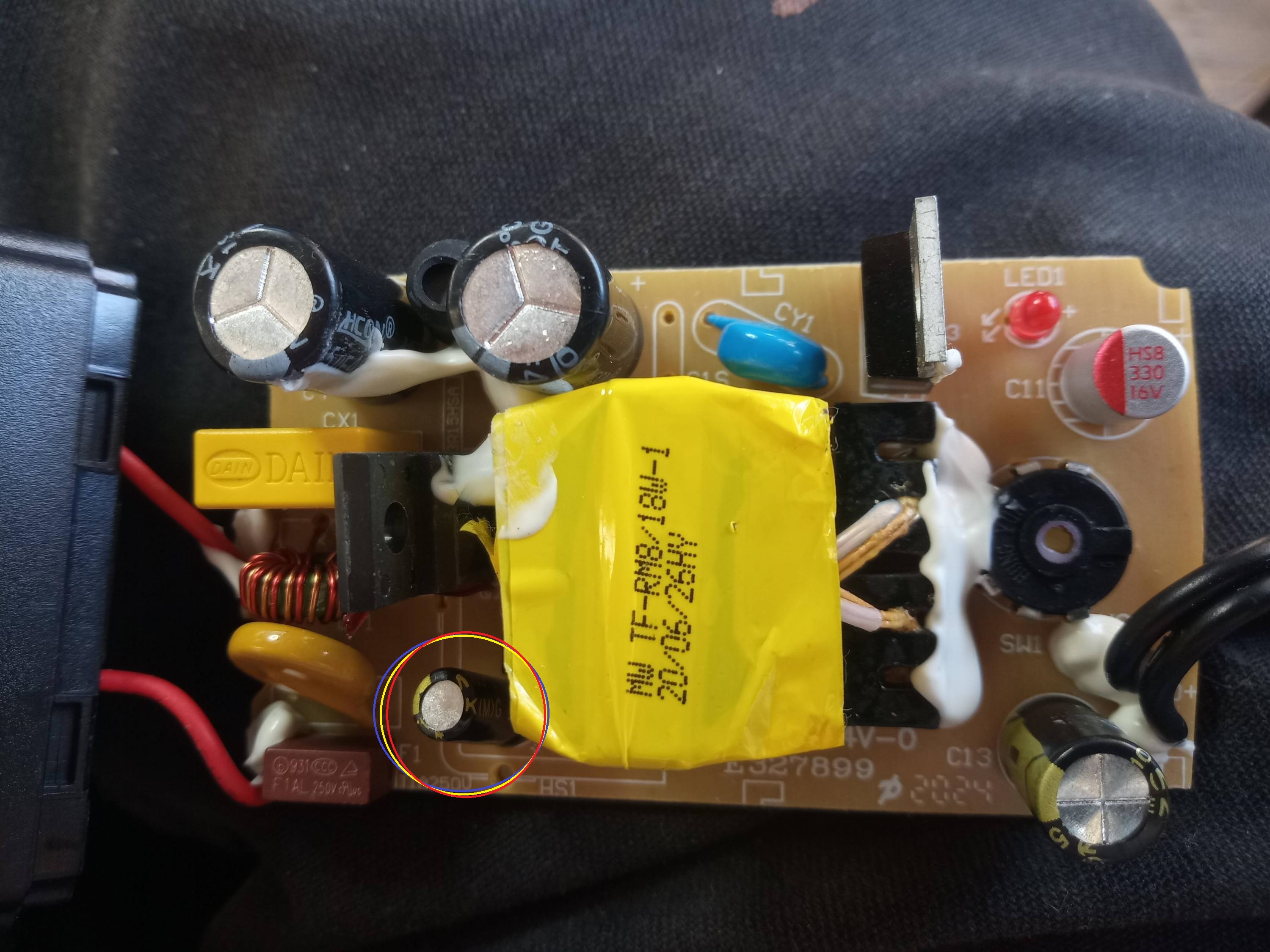

      There is a small value electrolytic in the primary I would replace first, In your picture it is the one located next to the transformer below the mosfet.

        clean the solder side of the board and resolder the bad joints

          It's driving one of these cheap and nasty Chinese all-in-one Hi-Fi (actually Lo-Fi) units with a turntable, CD player, radio. The specs on the unit say 9V @1500mA.
          And what you see in the images is what you get. No heatsink to speak of.
          I think you are probably correct. Simply can't supply the required load.
          I found a 12V 2A plugpack in my junkbox and gave that a go. It powers up and runs. But there is a oscillation tone coming from the speakers that is reasonably prominent. Hard to image that 3 volts would make much difference? But I certainly didn't hear any of that when I was running it off 9V from my bench supply. Just cheap and nasty electronics all around I suspect.
