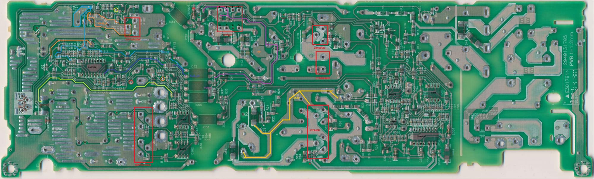

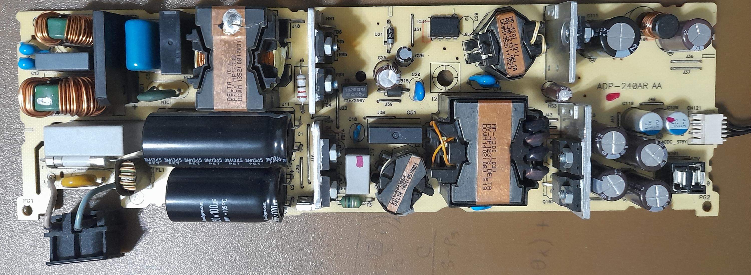

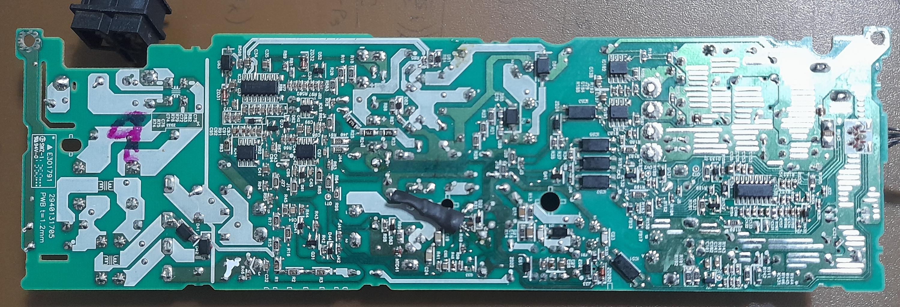

    Hi guys im new in this forum. I'm having trouble repairing a PS4 fat ADP 240AR power supply.
    Checking I found several problems (the components that I changed I put it with red color) in the 5v sector and a burn power resistor which did not allow the activation of the 12v relay.
    Once fixed, the power supply extends the 5v and 12 (when bridging standby and 5v) but when testing it on the console it turns on with blue light and then turns off (if I try to turn it on again the console does not turn on until I leave it disconnected for a while) I think they call these symptoms BLOOD. I used a 600w atx source and tested the ps4, it works fine, apparently the problem is in the original power source
    I checked and I think the problem lies with some smd component. What would be the next step to follow?
    I get schematic and a photo of the tracks on the board in other forum. It makes it easier for me to know where each signal is going, the thing is that I don't know how to continue (and i dont have oscilloscope ) .
    I am going to post the modified schematic and some photos. Greatings

    Re: PS4 ADP 240AR fat power supply BLOOD
    If it's R11 that's blown, check Q5 for shorts. If shorted, its driver IC also needs to be replaced, as well as R96, R98, R99 & D63.
    Also check D11 for shorts. If it shorts while in operation, the next "on" cycle of Q5 dumps C1's charge into MOSFET Q5, destroying it.
    Check soldering on all pins of the boost inductor too.

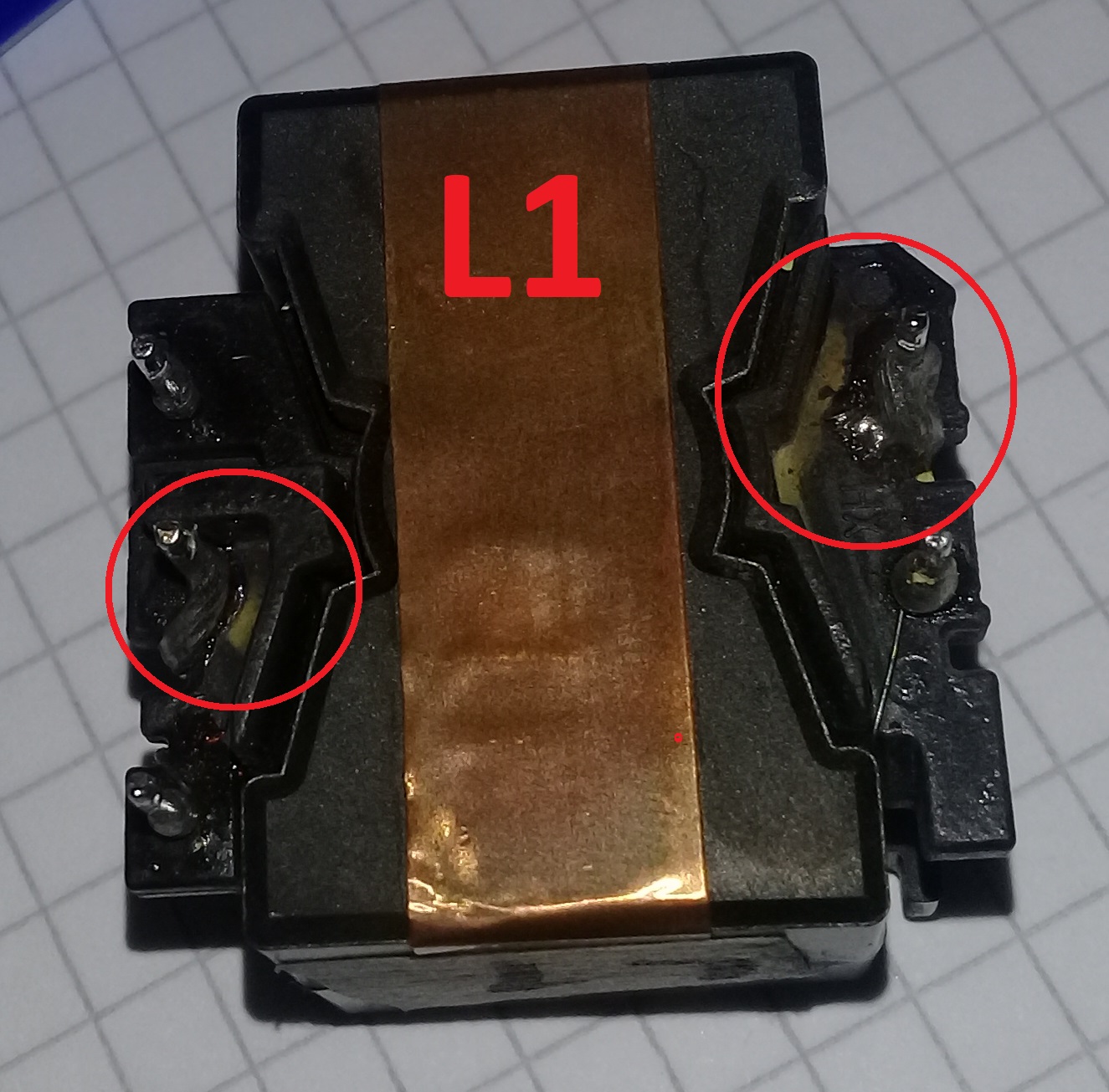

      I did not find shorts in that area. What does it mean to find shorts in operation? the short with respect to what should I measure? HV-?
      Q5 I did not find a short G D S, D11 also does not have a short A-K, the diode measures 0.377 in circuit.
      Take out the circuit T1 T2 L1 L2, in L1 and T2 I found marks, I am going to solder the cables just in case and I will try on the ps4.
      I measured the resistance:
      L1-> 5-3: 0.1 / 4-1: 0.1
      L2 -> 4-2: 0.1
      T1 -> A-B: 0.1 / 3-2: 0.7 / 4-1: 2.3
      T2 -> 1-3: 0.3 / 4-7: 0.1 / 5-6: 0.1
      Do you recommend any type of load test? to see if I can locate if it fails the 5v or the 12 or both.
        L2 -> 4-2: 0.1
        I solder it again L1 L2 T1 T2 and nothing
