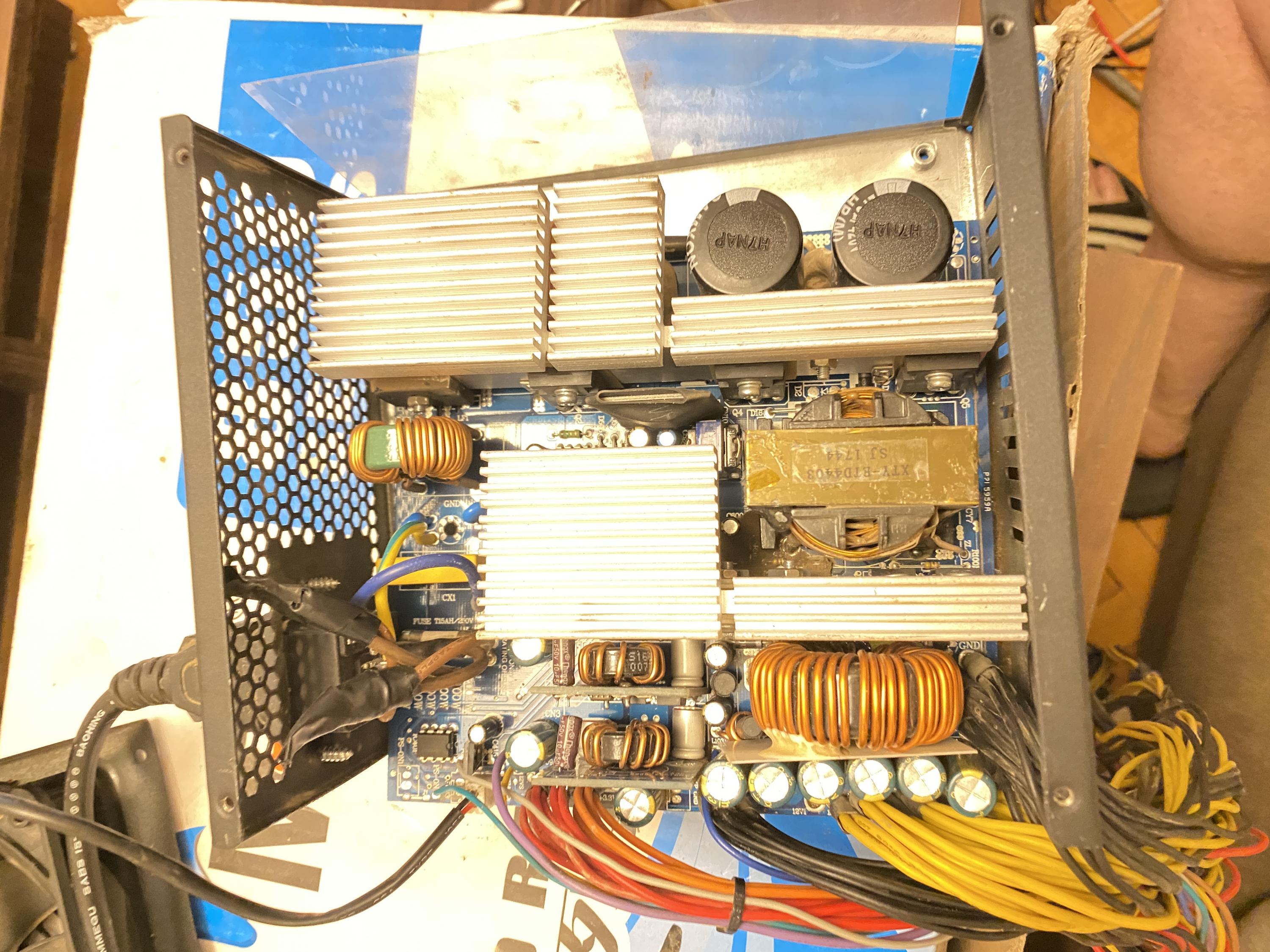

    Hi All:
    I have a 1600 watt PSU that does not output PGO. I thought it is a bad chip first, I managed to get an equivalent, But when I started measuring the inputs of the power supervisory chip I found that PGI signal is also zero. could that still be a bad chip? where it shorts the PGI pin?
    if not what supplies the chip with PGI signal. where can I get schematics for this power supply? There are so many types of power supplies
    The chip is ( 1. HY510N <=> WT7510 <=> ST9S313 <=> PS113 <=>RT7501 ) and i got WT7510 as a substitute.
    your help would be appreciated.
    Thank you in advance.
    The brand of the PSU is SURMA, 90 plus gold.
    Note: All voltages on the 24 pin connector are available except PGO and all the cables have 12v and 5v to it.
    Photos of PSU are in the attachment.

      Re: NO PGI signal to ATX power supply.
      here are the pictures.
      I guess i did not wait till they uploaded .
