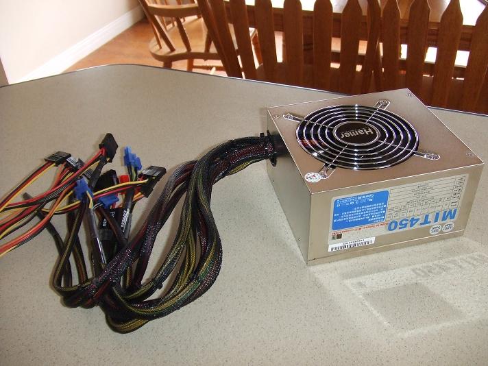

    Anyways lets start with an overall shot of the whole unit.
    Shiny. Very nicely sleeved cables going into the unit. 20+4 pin connector, 4+4 pin cpu power connector, 2 6+2 pin pci-e connectors. Strange a 450W has two 6+2 pin pci-e connectors. It also has 6 sata connectors, 4 molex's and a floppy.

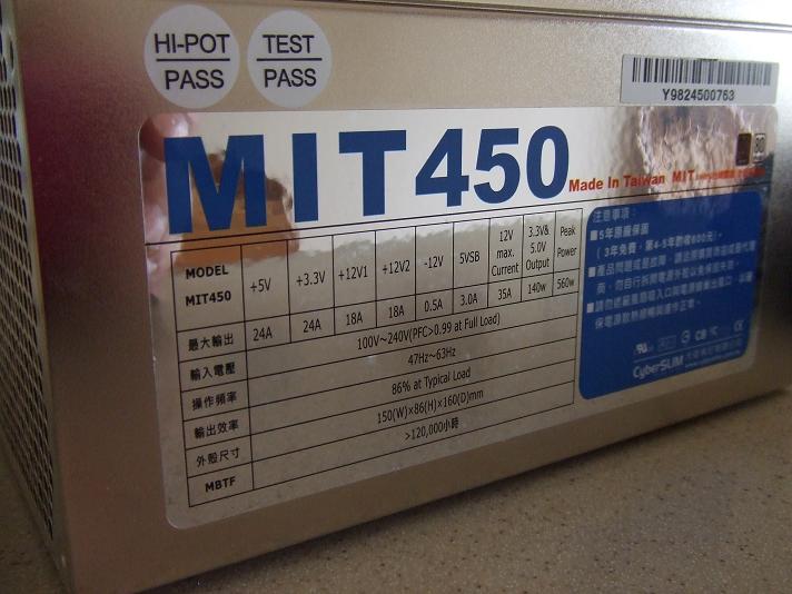

    Label shot.

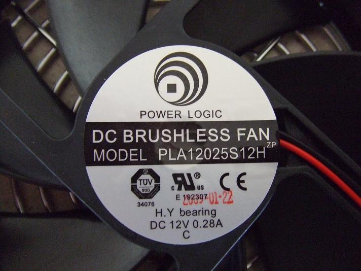

    Powerlogic fan. Pushes 107.58 CFM @ 2600rpm and uses a sleeve bearing. This fan is not that silent, has a faint whine to it while running. Not too noticeable though.

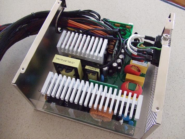

    Overall internal shot. Know who built it yet? They're not really well known but they are kind of big and make a pretty good product. The transient filter is pretty impressive with 4 X caps, 3 coils, and 6 Y caps.

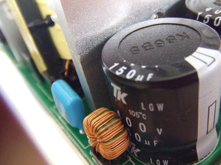

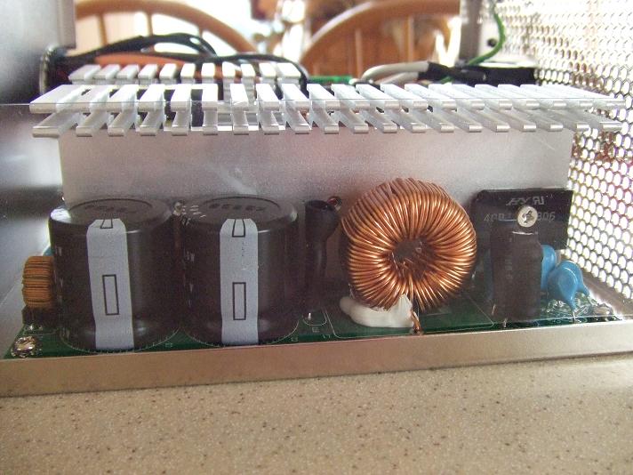

    Bridge rectifier bolted to the primary heatsink is a 8A, 600V part followed by the APFC coil. The primary caps are TK LGW rated at 105C, 400v, 150uf each and they are connected in parallel.
    Another shot of those caps
    Secondary caps are all UCC. Well, that means this is 100% japanese caps. Those two cards sticking up there are the 5v and 3.3v vrm cards. The caps on those are UCC solids.
    If you haven't figured it out by now, it's made by Impervio. Overall a pretty nice unit. A 450W with good bronze 80 plus certification, all japanese caps with lots of connectors and good built quality.
