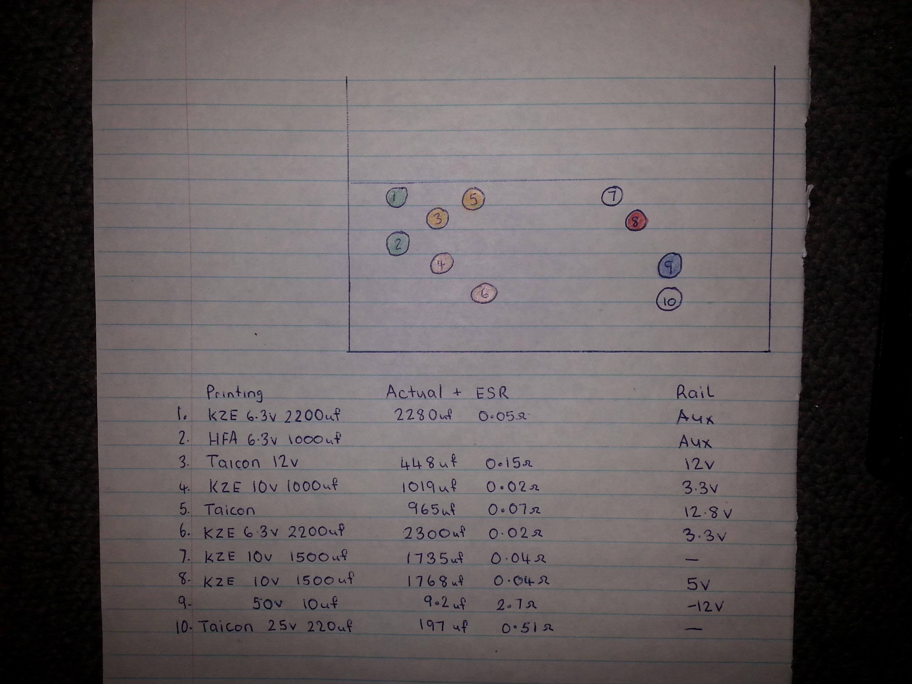

    I removed the 25V 470uf Taicon PW cap that was on the 12V rail
    It measures , according to the 328 transistor tester, 454uf and 0.42 ESR (or 0.83 ESR using a dedicated ESR tester)
    The datasheet says that it should have an impedance of 0.273, so if "impedance" = "ESR" then it's out of spec.
      Actually, the datasheet says 0.065 (looked at the wrong column), and i meant 0.083 instead of 0.83
      and it now measures , according to the 328 transistor tester, 454uf and 0.2 ESR (or 0.080 ESR using a MESR-100 ESR tester)
      (Possibly due to a change in temperature)
      I trust the MESR ESR meter more, as it lines up better with the datasheets and other newer capacitors that i brought
      So i replaced it with an OST RLP 1000uf (actually 860uf) that has ESR 0.027
        Yes, impedance spec @ 100 KHz is equivalent to ESR.
        Cap may not necessarily be out of spec, though - you also need to consider the ambient temperature too.
        And isn't there something else filtering the 12V rail too? 470 uF seems way too low. I think you might be looking at the -12V rail cap. 12V rail should have at least 1000 uF (but almost always more for PSUs that have a 4-pin 12V CPU connector.)

          Also checked the Taicon (probably a PW, as it's the same colour as the other Taicon on the 12v rail) 1000uf, 12.8V PSU rail cap, and it's not bad - 872uf 0.044 ohms (i just de-soldered the +ve leg, and tested it, because it's got tough glue on it and it's in a tricky spot)

                                        Re: Compaq PDP-121P - Baked MOV
                                        I've now measured all of the rail capacitors that are on the the main board and they don't appear to be bad (forgot to put the other AUX rail measurement in, but it tested good as well)
                                        While turning the PCB over, the black wire to that heavy (filter?) coil broke off (i assumed that they would be soldered on to the coil very well, and could handle the movement of me turning the PCB over and back over again)
                                        This coil is between live and an AC terminal of the bridge rectifier
                                        It's a long shot, but could broken stands that were going to the coil result in the power supply not getting, (and maintaining under load) enough voltage? Hence the computer shutting it down.
                                        Can i cut the yellow plastic tape, and reattach the wire to the coil? (hopefully there is no windings inside of it)
