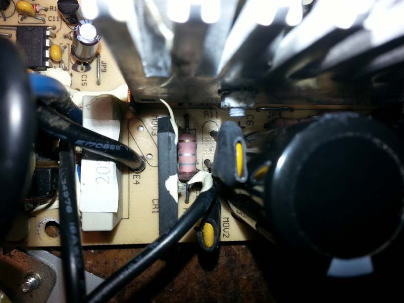

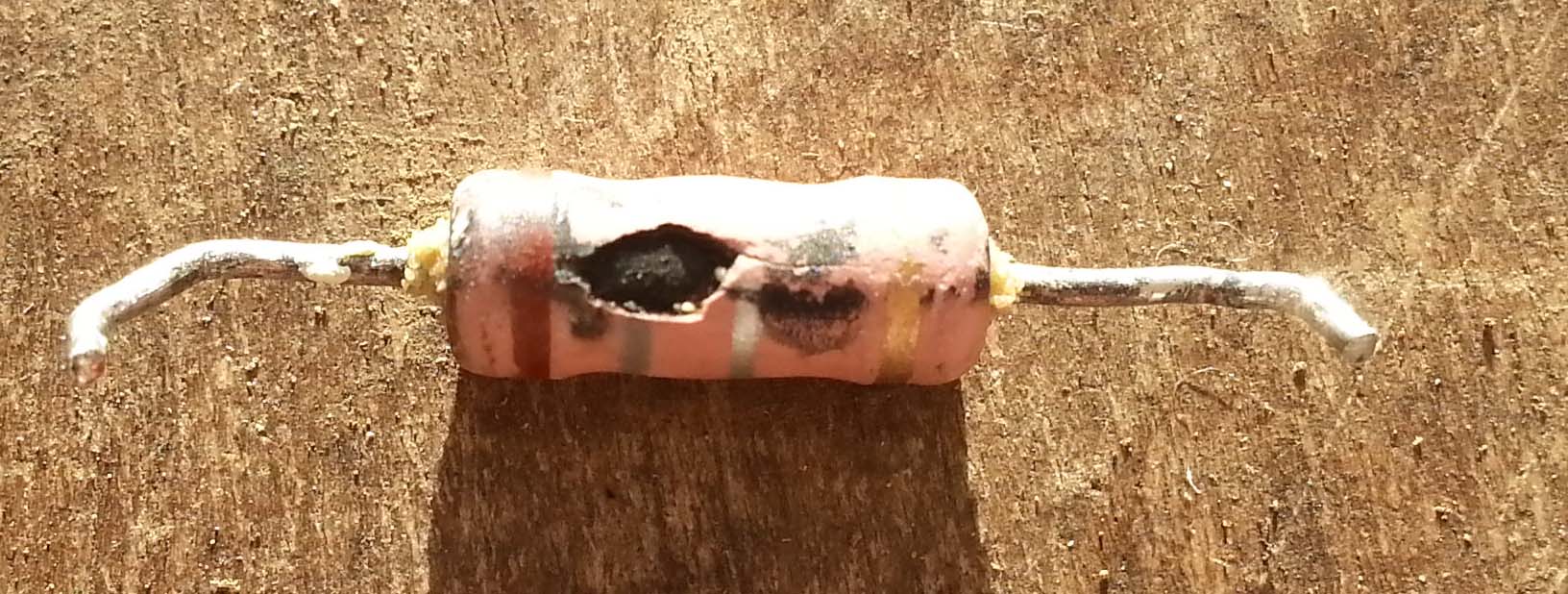

          and i get 28K ohms from MOFET source to ground, and there is a suspect looking resistor in between, that looks like should be 0.28 hms
          There is 0V on the voltage feedback pin - I'm guessing that that is because the MOSFET is not being turned on, and therefore there is no feedback from the secondary to regulate the UC3845 chip?

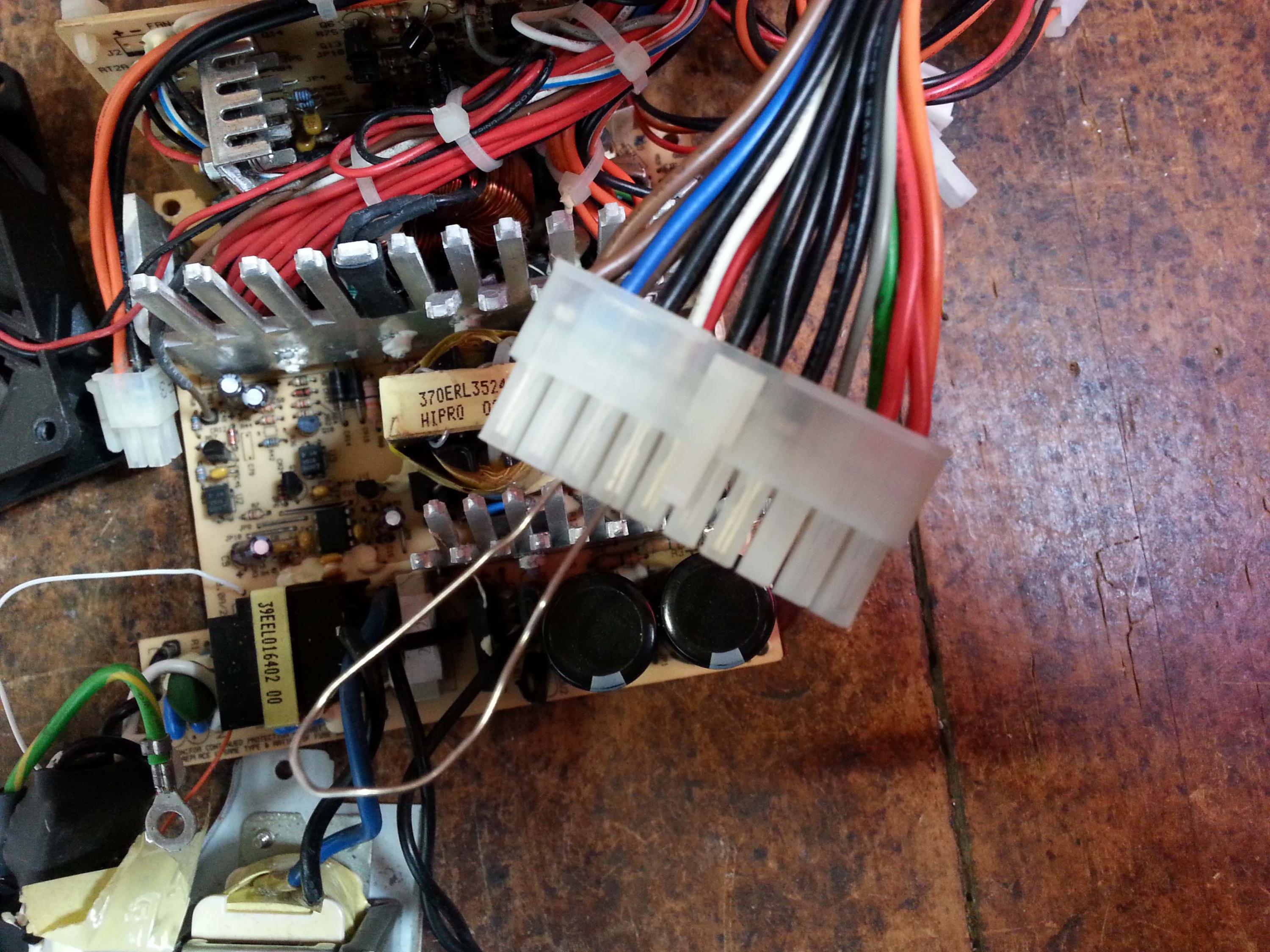

            (i'm farly sure that the ATX pinout is normal, as they have just used different colours
            i wouldnt be so sure.
            see if the pints on the board where the wires go are labelled.

              Re: Compaq PDP-121P - Baked MOV
              i don't think that drinking ale and working on PCBs go well together.
              But yeah the labels on the board confirm that the connector pinout is the usual one.

              • R_J
                • Jun 2012
                • 9607
                This is way too high for a source resistor, they are usually less than one ohm. The resistor is likely a metal film flameproof, There is usually another resistor between the mosfet source and the drive ic's CS pin. When the source resistor goes open it is very likely the ic has been damaged.

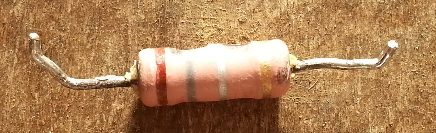

                  i could only find a 0.15 ohm heat-shrinked, grey-bodied, non-glossy, 14mm, resistor - is it OK to use that? (the 328 transistor tester shows it to be about 0.20 ohms, after subtracting 0.17 ohms when shorting the test leads)
                  The original looks like it's a 0.28 ohms and is about 11mm.
                  Is there any significant difference between the pink-bodied and the grey-bodied resistors that you find on ATX PSU boards?
                        Looks like a 1.8 Ohm to me (and that's a standard value for E12/E24 series 4-band resistors.)

                        Is that resistor a fusible resistor?
                        Likely yes.
                        Yeah, that should work fine.
                        Again, I suspect your old resistor is 0.18 Ohm (brown, gray, silver, gold) and not 0.28 Ohms (red, gray, silver, gold.) Perhaps the brown/red band on your resistor is a bit lighter, hence possibly why you think it's red.
                        But even if it is 0.28 Ohms... the 0.15-Ohm should work OK too. Only difference will be during an overload / over-power condition: lower resistance will allow more power to go through before the IC detects the overload condition (which may or may not be detrimental to the rest of the circuit, depending on how over-built it is.) That said, if your resistor really is 0.18 Ohms and you put in 0.15 Ohms... that's about 15% difference roughly... so you can expect the overload limit allowed by the IC to be increased by roughly just as much.
                        Given that we are dealing with a HiPro PSU here, I don't think that's going to be a problem, as they tend to be built quite well.
                        None.
                        I've seen them used interchangeably. Both are metal film type / metal oxide - you can tell by the non-shiny "eggshell" finish. On the other hand, Carbon film resistors are usually shiny.
                                    OK, i plugged in a motherboard that i don't care about too much (as it seems to produce a smell in the vicinity of the northbridge) and also connected a hard drive - didn't plug in the 4pin CPU connector
                                    After a few touches of the PS-ON to Ground (where the fans just twitch), the PSU fully starts up and the CPU fan spins but revs at a rate of about 1hz, voltages are good.
                                    The PSU wont start up (it's fan just twitches once) if i also connect the 4-pin CPU connector (but that could be due to an issue with the motherboard)
                                    So without the 12V CPU power connector, the PSU starts and the voltages are good? If so, then you were impedance-limited by the series bulb on the AC input on the other tests for sure.
                                    And again, with the series bulb(s), you just *cannot* put too much load on the PSU and expect it to work. From what I've been experimenting on lately with low AC input / series power limiting and ATX PSUs, the general tendency appears to be that you can pull only about 1/6 to 1/8 of the power rating of the series limiting device and still have the PSU work. So with a 60W bulb, you might be able to pull about 10 Watts from the PSU, tops.
                                    As for the fan on the motherboard revving with 1 Hz... that's probably the motherboard boot-looping and restarting, because the CPU power is not connected, so that may be normal. And of course it not starting with the series bulb in place when the 12V CPU connector is inserted is expected.
                                        All that i can think of is maybe the computer is sensing high ripple on one of the rails because of a bad output cap, despite good and stable voltages.
                                        Is that a known possibility?
                                        Yes, that's a possibility.
                                        Which is why I suggested to check output caps with ESR meter.
