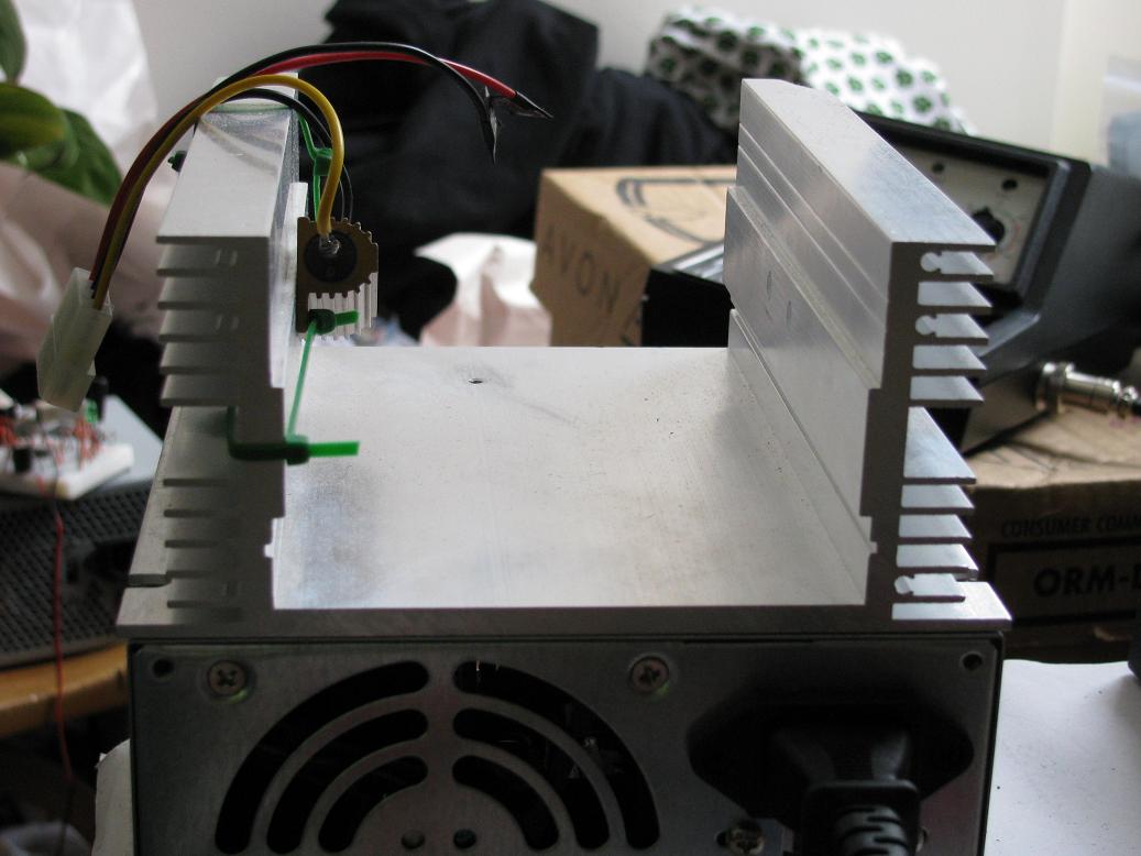

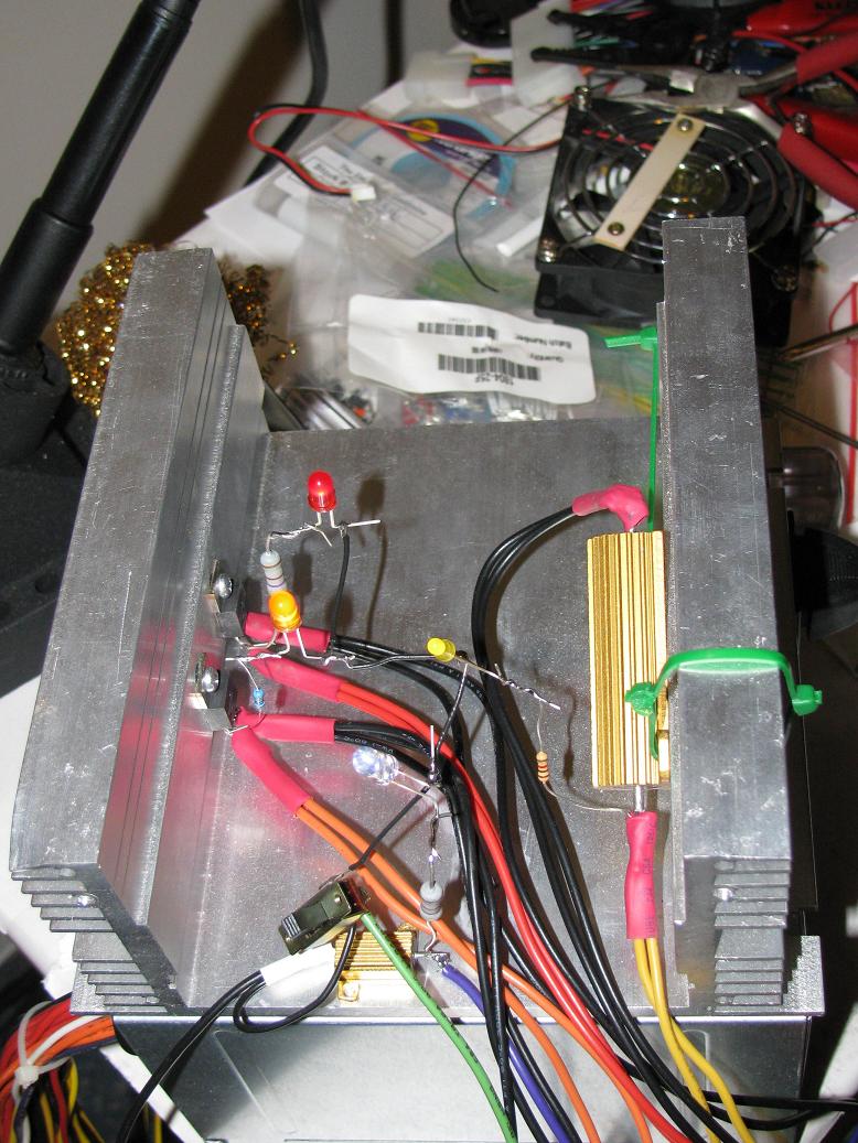

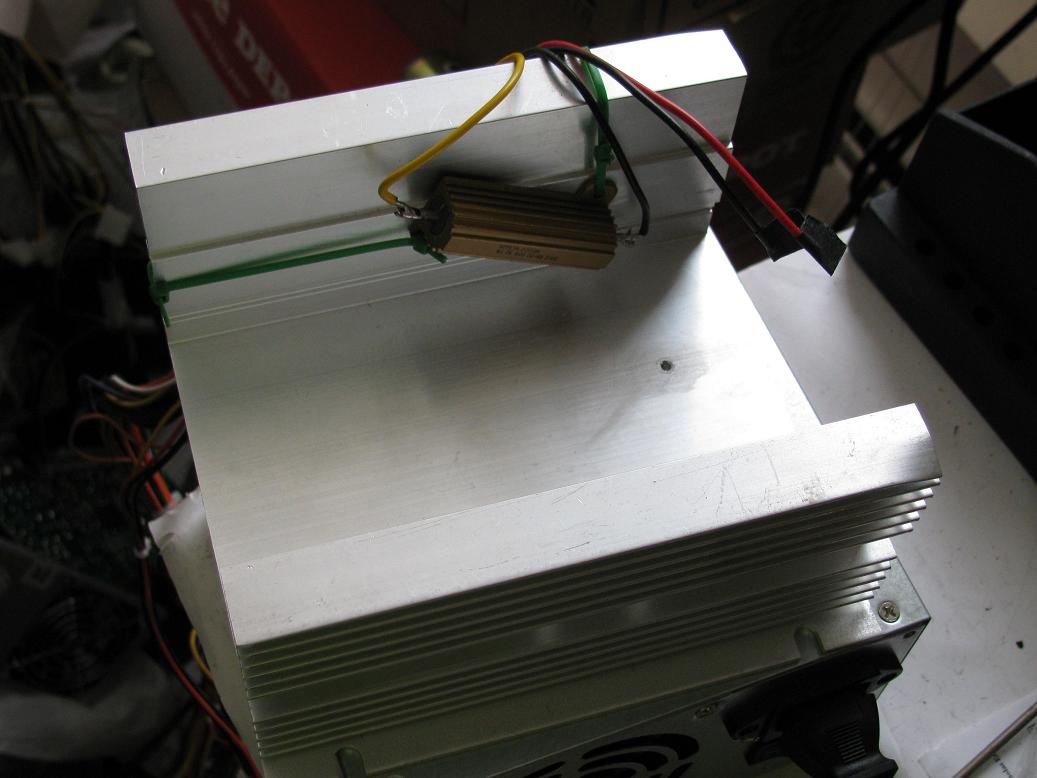

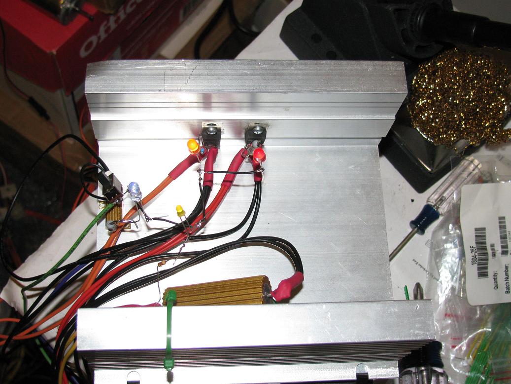

                    Well I have a sort of update for this - I made a small dummy load for testing/loading power supplies. Originally, it was just the big resistor zip tied to the heatsink. It was connected to a molex connector, and ran the 12v line at about 4A (it's a 3 ohm resistor). This worked well enough, but would crossload the PSU VERY heavily (I couldn't even draw an amp on the other rails). It's not attached to the PSU, that's just a convenient place to put it while it's in operation.
                    Here's a picture:
                    And here's another picture:
                    So, I ordered two 1 ohm resistors, to load the 3.3v rail and 5v rail to several amps (3.3A on the 3.3v and 5A on the 5v). They're thick film resistors in TO-220 packages, so they mounted very easily to the heatsink. I also added a 15 ohm resistor for the 5vsb, so it will draw 1/3 A from that rail. So the total power draw is as follows:
                    3.3v * 3.3A = 10.89W
                    5v * 5A = 25W
                    12v * 4A = 48W
                    5vsb * 1/3A = 1.67W
                    for a total of 85.56W.
                    Not a real heavy load, but enough to make sure things are working properly, and the load is even enough for the voltages to be happy. I also added an LED for each rail. As I was searching through all my LEDs, I found that I could match the LED color to the color of the wires that carry that voltage. So there's a yellow one on the 12v, red on the 5v, orange on the 3.3v, and purple on the 5vsb. These let me know which rails are working, and are a good indication of whether or not the heatsink will burn me if I touch it (all 4 on = hot, only purple on = cold). The whole thing is powered from the ATX connector of the PSU. I used 2 wires (18 gauge, from an old power supply) for each power rail (except the 5vsb), and 6 ground wires. The switch shorts PS_ON to ground, turning the unit on and off. I know having the LEDs unprotected like that is very unsafe, but I didn't really want to put a whole ton of effort into making some nice LED board, and I think it looks pretty cool with them all floating like that
                    Here is an after picture:
                    Here is another after picture:
                    Currently it's plugged into my 350W L&C that I recapped. The DC load is around 85-90W (the voltages are almost spot on), and it's drawing 124W from the wall, for an efficiency of about 70%...ouch!
                    What do you guys think?
                      • 31002
                      Re: Choosing resistors for loading
                      i think you should drill a couple of holes for the resistor before it melts those cable ties.
                      • Khron
                        • Sep 2006
                        • 1350
                        • Finland
                        And try to keep the heatsink fins vertical; helps with the cooling
                        Khron's Cave - Electronics - Audio - Teardowns - Mods - Repairs - Projects - Music - Rants - Shenanigans
