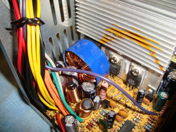

I'm trying to modify this psu (Diamond 500w)

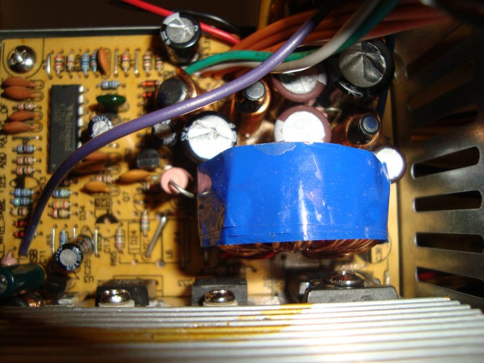

    Check for any solder whiskers or bridges you may have inadvertently created.
    About the 200V 16A schottky, I have a keerda ATX-3000A (logisys 575W) with a very similar design to this which had a 200V, 30A Fast Recovery type on the 12v. I replaced it with a 60A, 45V schottky, and it worked just fine. Infact, etnietering has a logisys-keerda based off the same design that had an identical 16A, 200V Fast Recovery type on the 12v, and he tried replacing it with a 20A, 250V Fast Recovery type, and it tripped the short protection. He replaced it with a 60A, 45V schottky from ONsemi, and it worked fine after that.

      Well, i cleaned the best i could, and still...no start.
      The +5vsb reads 5.01 volts, between +12 and ground i get 43 ohms.
      To the side of the x cap i installed, there was a jumper J1 i didn't remove, i don't know if that is causing problems.

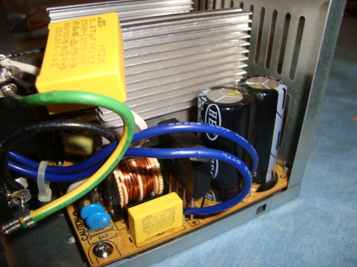

        Re: I'm trying to modify this psu (Diamond 500w)
        J1 is necessary, it gets half the AC wave to the bridge rectifier. 370 is correct about my Logisys/Keerda unit. Completely baffling...
        Check for shorts between the other rails and ground, as well as across the output diodes.
          Problem solved.
          The mospec f16c20c was missing a plastic washer in the screw, lol.
          In this last test, at first the psu lasted like one second on, then shut off. When connected to an old mobo, it started ok.
              I'm recapping now, but i have a question, ¿is ok a Rubycon 6.3v 3300uF for the 5v rail?
              • etnietering
                • Apr 2009
                • 379
                It should be alright. If you have 2 places for it (one before the inductor, and one after), put it after the inductor. The voltage here will be much smoother, and less likely to have spikes over 6.3v.

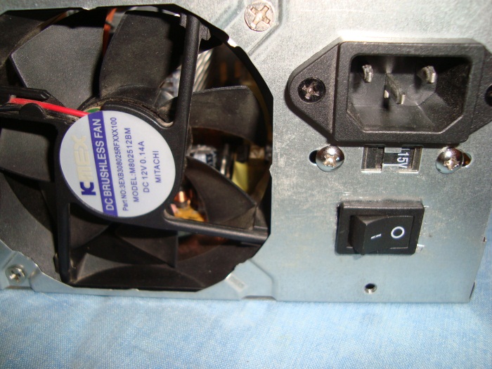

                  Psu semi-recapped and almost ready for another test.
                  Almost all caps in the secondary are Rubycon's from a Sega psu, except two KZG from a mobo, and one Teapo for the 5VSB.
                  I also added a .47uF x-cap and a on/off switch to the case. Next time i'll see if i can find a good schottky for the 12v and good caps for the primary.
