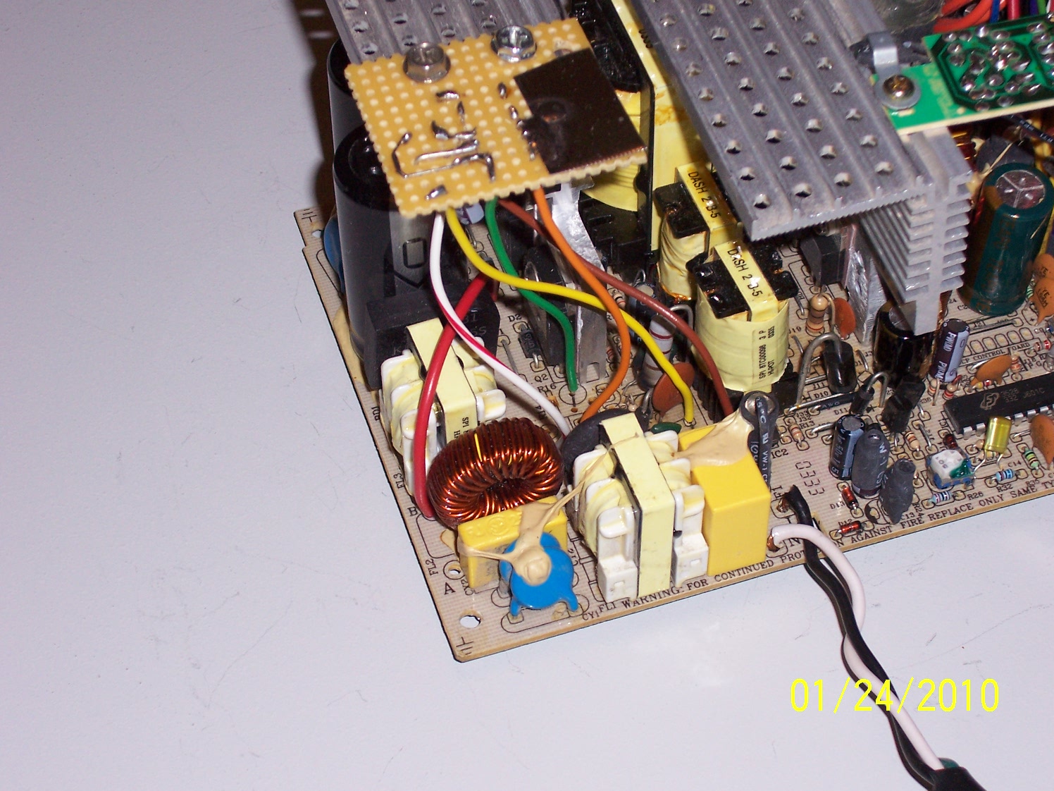

    Last week I got a Fortron FSP300-60ATV, same pc board but not burn damaged. Symptoms were same - 5vsb dead. The main switching transistor was shorted, and the other transistor was blown apart.
    I found this power supply to be most interesting. The brand - Fortron - is the favorite of i4004. The 5vsb uses the two transistor circuit design, but does not have an aluminum "critical" capacitor in the usual location. So this circuit should not have gone overvoltage. Again, the main switching transistor was shorted, and the other transistor was blown apart.
    I decided that since replacing the critical capacitor would not be a fix (it doesn't have one), and due to bad transistors and probably other parts bad, I installed my DM311 mod. On power up, the 5vsb still did not work. Troubleshooting found the problem to be a leaky diode D9 on the secondary side of the 5vsb transformer. Now the 5vsb was up and running.
    Next, I removed the two capacitors which form the pi filter for the 5vsb. Both are 1000 uF/10V OST. I was going to replace them with new Nichicon PW 1000 uF/10V which measured esr = .06......but the two OST capacitors both measured esr = .02.......so I left the OST capacitors in the circuit.
    Voltage measurements after repair:
    12v = 12.16 volts
    5V = 5.18 volts
    3.3V = 3.35 volts
    5vsb = 5.23 volts

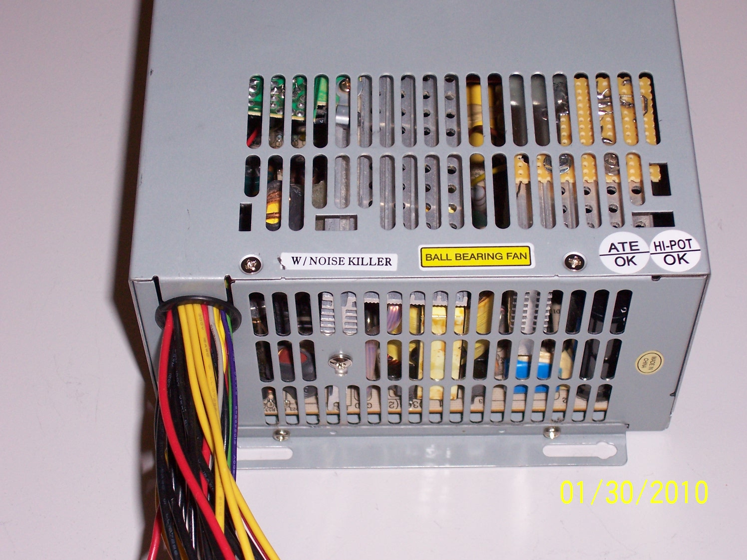

    Photos attached to show repaired board before putting it back in case. Also photo of back side of transistor blown apart.

          One more photo showing pc board back in the case. Modification can be clearly seen inside the case.

            I have a second Fortron FSP200-60ATV, no 5vsb just like the first one, but not burn damaged. I checked ZD1 the zener diode across the 5vsb, and it was shorted. That makes two Fortrons, same model, same problem. ZD1 is located next to diode D9. I removed the diode, applied power, and everything works fine. In my opinion, this is sufficient proof that putting a zener across the 5vsb is NOT a good solution for 5vsb circuits that go overvoltage. It simply shorts zener diodes.
            In the Fortron FSP300-60ATV there was no zener installed at the ZD1 location. The diode D9 was shorted and took out the two switching transistors. So looks like diodes D9 and ZD1 are a good place to start when troubleshooting these two models.
            Two of the psu had shorted/blown switching transistors. I had email from pieti requesting information - his transistors were blow beyond recognition and he needed part numbers. They are:
            FSP200-60ATV: Fairchild FPQF 3N60 and H945
            FSP300-60ATV: ST P3NC60FP and H945
            The 5vsb circuit looks the same for both models. I tried to repair the two transistor 5vsb circuit on the first psu I worked on, but only succeeded in blowing out the transistors again. Repairing this circuit is tricky! So I put the DM311 mod in it and have had no further problems.
