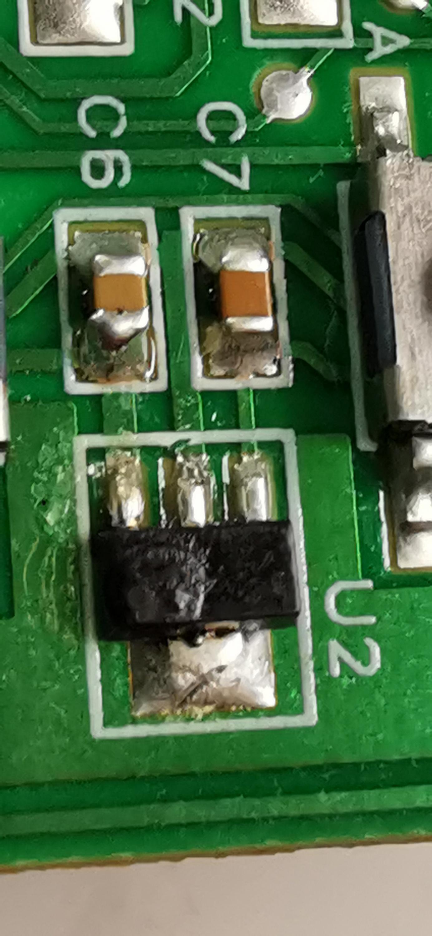

 How do I check this U2?
 I put DMM in Volt mode, put black on common pad, and Red on each lead:
 Left one reads 23Vdc
 Middle and Right ones read 0Vdc
 *left side is bulged..Comment
 Re: Tefal GV8962 Pro Express steam iron - no power
 I just googled to learn more about LDO. If the picture is a correct pinout of a LDO, then it measured input is 23Vdc, and output is -0Vdc.
 Does this mean this LDO is faulty/open?Comment
 https://www.badcaps.net/forum/attach...9&d=1603871079
 It looks like it is blown up when the high Voltage dump occurred.

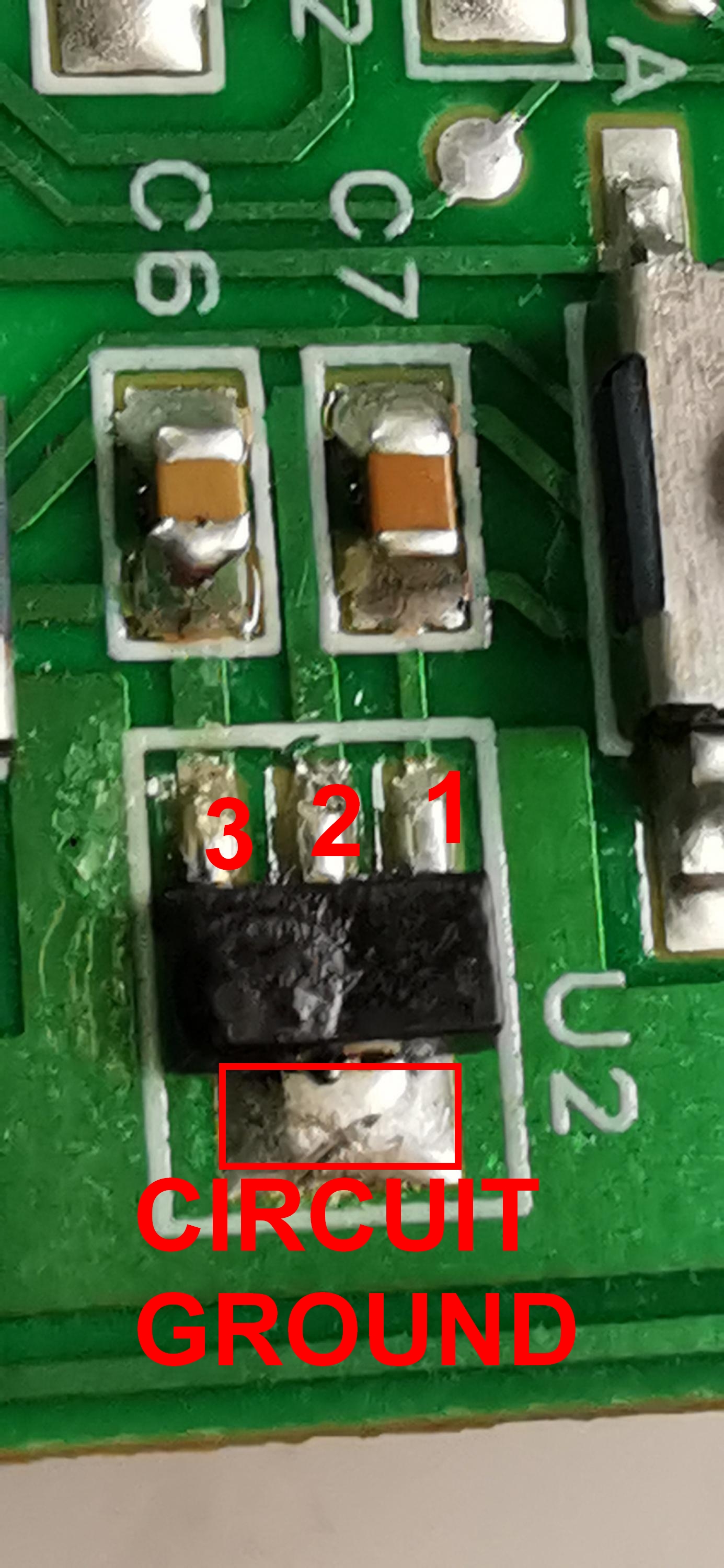

 Circuit ground for your probe will be the Negative leg of C2, then test Voltage on each leg of that U2.
 It looks like the center pin is ground, if that is the case then will not be the same as typical 1117 regulator. You can verify if center pin is connected to circuit ground or not by checking the resistance between C2 negative leg and center pin of U2 to see if it shows <1 Ohm or not. You should also check the resistance of the two outer pins against ground.
 If you cannot read the print then it will be hard to figure out what the output Voltage should be, it may rated as the same Voltage for the IC's VCC.Last edited by budm; 10-28-2020, 01:43 PM.Never stop learning

 BTW, look real close at C6 and C7 soldering joints connected to U2 pin 1 and pin 3, they do not look right.Never stop learning
 Black probe on C2 -Ve, Red probe onhttps://www.badcaps.net/forum/attach...9&d=1603871079
 Pin1: 23 Vdc / 146 ohm
 Pin2: < 1 Vdc / < 1 ohm
 Pin3: < 1 Vdc / 14 ohm
 Black probe on Pin2: Red probe on
 Pin1: 23 Vdc / 152 ohm
 Marking on U2 is completely not readable.
 *** Just to be clear: Pin1 is on the left and Pin3 is on the right of the picture I attached.Last edited by beetle1303; 10-28-2020, 10:25 PM.Comment

 As shown in your picture: Pin 1 (Right pin) of U2 is connected to C7, Pin 3 (Left pin) is connected to C6.Black probe on C2 -Ve, Red probe on
 I do not understand why your readings show Voltages. Are you checking the resistance of C6 and C7 with POWER applied to the unit while doing resistance test?Last edited by budm; 10-29-2020, 12:57 AM.Never stop learning
 http://www.badcaps.net/forum/showthread.php?t=24809Comment
 Sorry for not stating it clearer, I powered on to read voltages, and powered off to ready resistance, and recorded them in the same row..
 So my reference of Pin1 & Pin3 is reversed. Based on your picture:
 Pin3: 23 Vdc / 146 ohm
 Pin1: < 1 Vdc / 14 ohm
 Pin3: 23 Vdc / 152 ohm
 Pin1: < 1 Vdc / 14 ohmComment

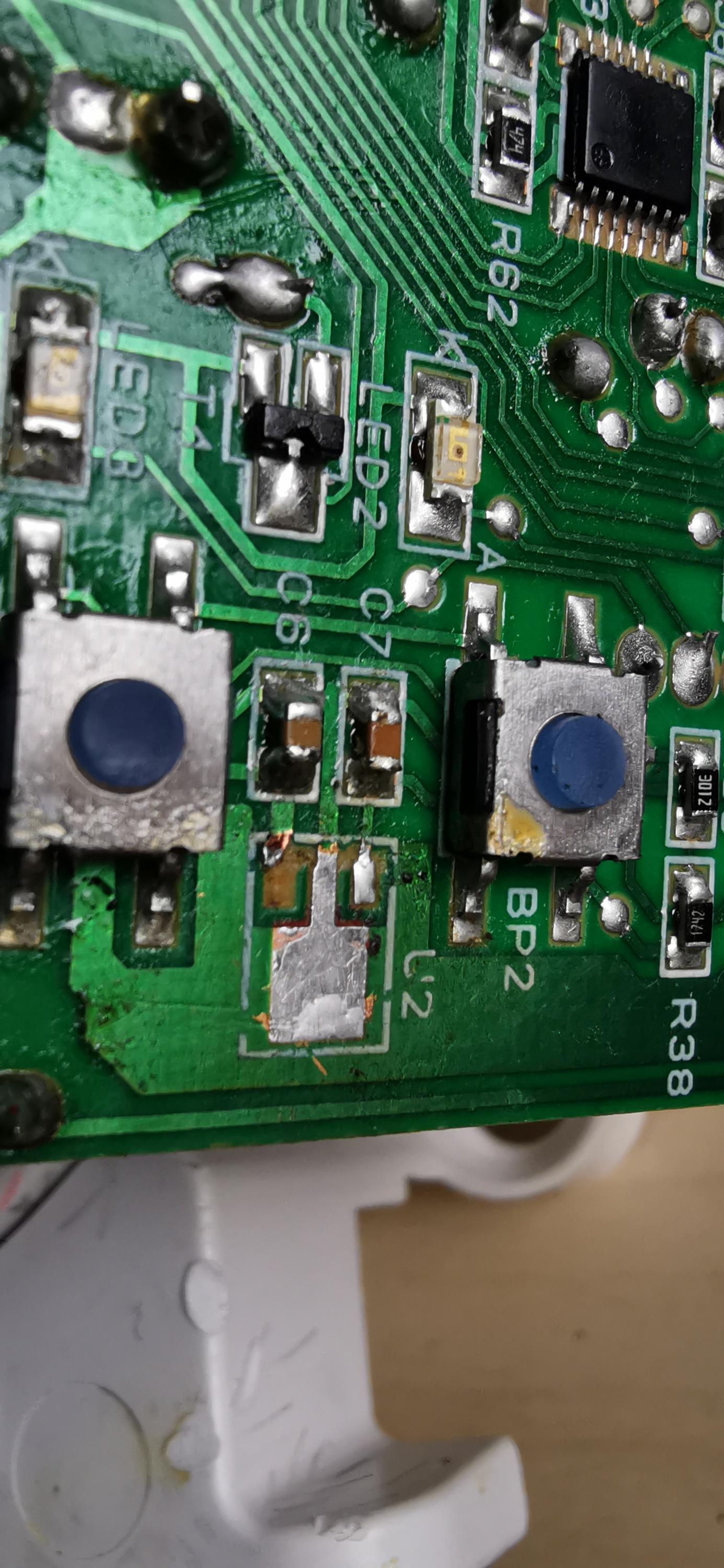

 I removed U2 (I don't have a proper tools and skillsets, and damaged Pin3 pad).
 With U2:
 C6: 178 ohm / 0L on capacitance
 C7: 14 ohm / 0L on capacitance
 Without U2:
 C6: 539 ohm / 103 uF on capacitance
 C7: 20.8 ohm / 0L on capacitance
 ** Pin1 resistance now 20.8 ohm vs 14 ohm previously.Comment
 Now check the resistance between GND and VCC pins of the IC's.I removed U2 (I don't have a proper tools and skillsets, and damaged Pin3 pad).
