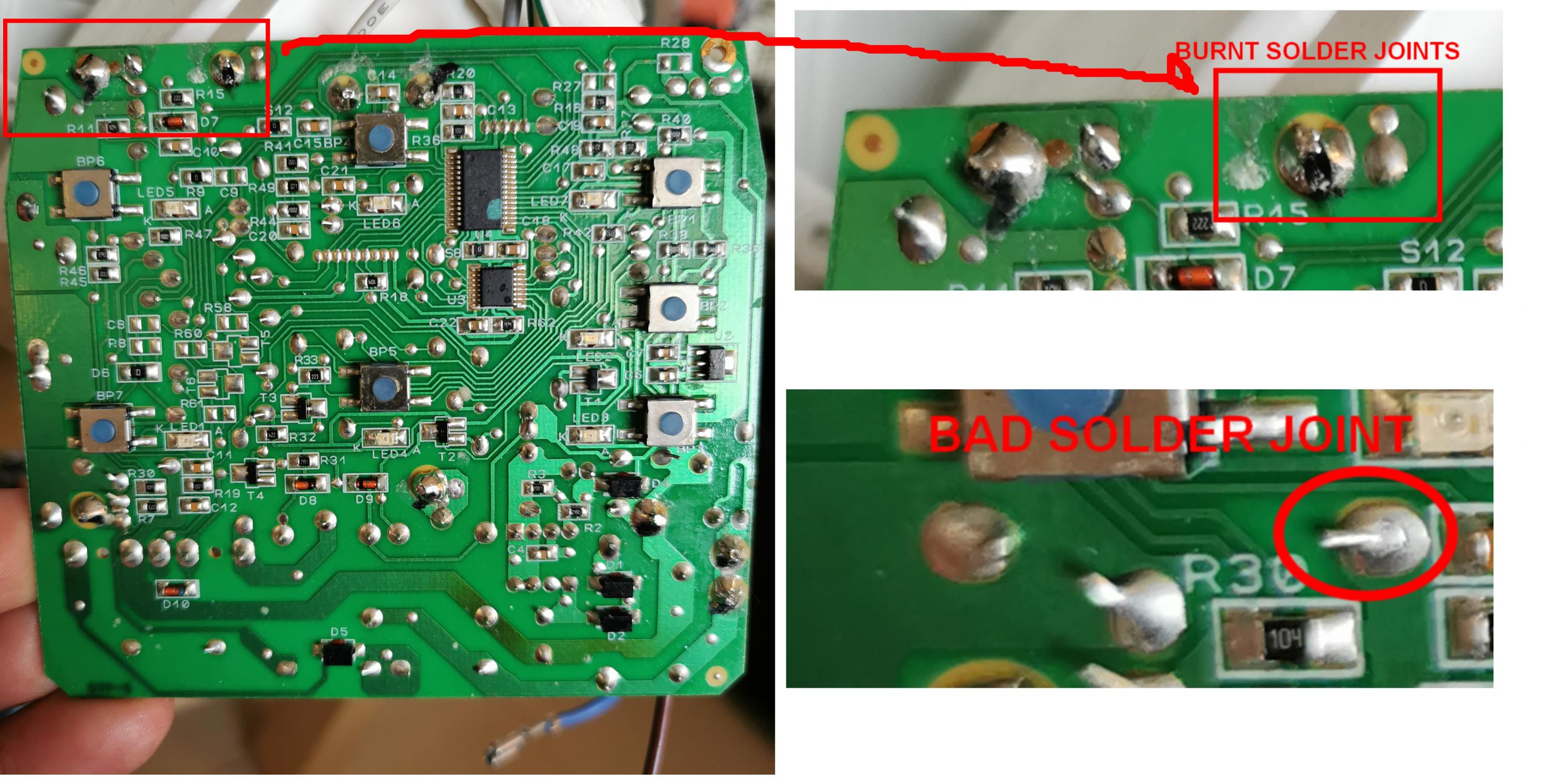

          Arh... indeed, one end of R1 solder joint is done poorly.. Reworked, and now D pin & C1 (I believe not C4) get 325Vdc, and C2 gets 24Vdc.
          But pressing the power on/off button still no led light..
          *Noted on R1 being a 100 ohm resistor, should get a 2W 8-10 ohm replacement?
            At this point you can leave the 100 Ohms resistor for testing for now.
            So the 24V buck converter is working now, now we need to trace out the other power supply section for low Voltage that is used for running those IC's (U3, U4) next.
            So look up the part number of some of those IC's so you can look up the spec sheet to locate the VCC pin of the IC then you can find out if the VCC is present or not for the IC's to run.
            Check Voltage of U2, it looks to be LDO Regulator IC.
            I also see some bad solder joints, one looks burnt, others you can see ring developing around the joint, so look for ring around the solder joints and resolder them.
            BTW, that small white connector, what is connected to that connector?
              The black color that looks burnt is permanent black marker ink, on the the joints that have wired soldered directly onto. The ring around the solder joints - except for the huge wire joints with black marks, practically all the joints has some sort of indentation. Some looks like a ring, most are just dings. I re-soldered most of them.
